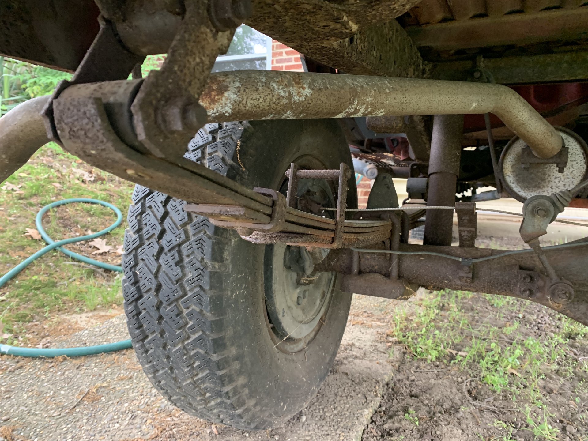

I have a few other things I am contemplating, but given the fact that this one will likely be sold, I don't want to go crazy. I'll post some pictures of the suspension, but something doesn't look right. I would love to do some kind of restoration on the camper shell, but I have no idea where to start. I'll do a few things that bug me (like the 22RE sticker), like the gas cap, air filter, and radiator cap.

Can anyone help me identify these springs? Is that an "add-a-leaf" under the stock springs?
Probably an add-on. I've never seen a spring like that on any mini I've owned (lost count) or worked on. Here's my '88:
