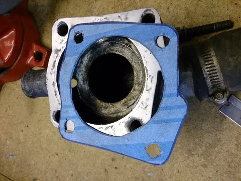

Take a piece of sand paper and lay it on a smooth flat surface. Place housing on sand paper and sand smooth until you have sanded away any low and high spots. Do both sides of the housing. Should fix the problem.
This. ^^^^ if you want to find the high and low spots, go over the surface with sharpie first.

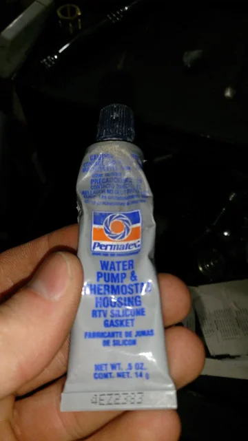

Also put a layer of waterpump/thermostat housing sealant on both sides of the gasket. The thicker the gasket material, the more it will conform to surface imperfections; if the factory gaskets are thin, consider getting a roll of gasket material and making your own.
I did cut my own! It was absolutely perfect. PERFECT.
I think ill take the housing off and put it on our re-surfacing machine. Make that baby flat as a pancake. I shoulda done that before.
Good idea with the sealant. Ill do that too.
