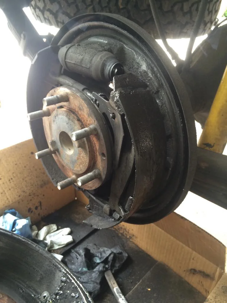

Well. You were ALL wrong!
Master works great. Rear wheel cylinder blew out.

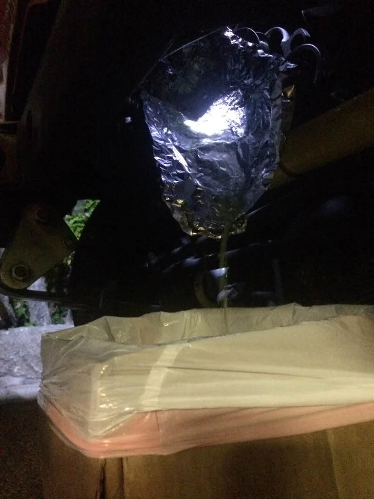

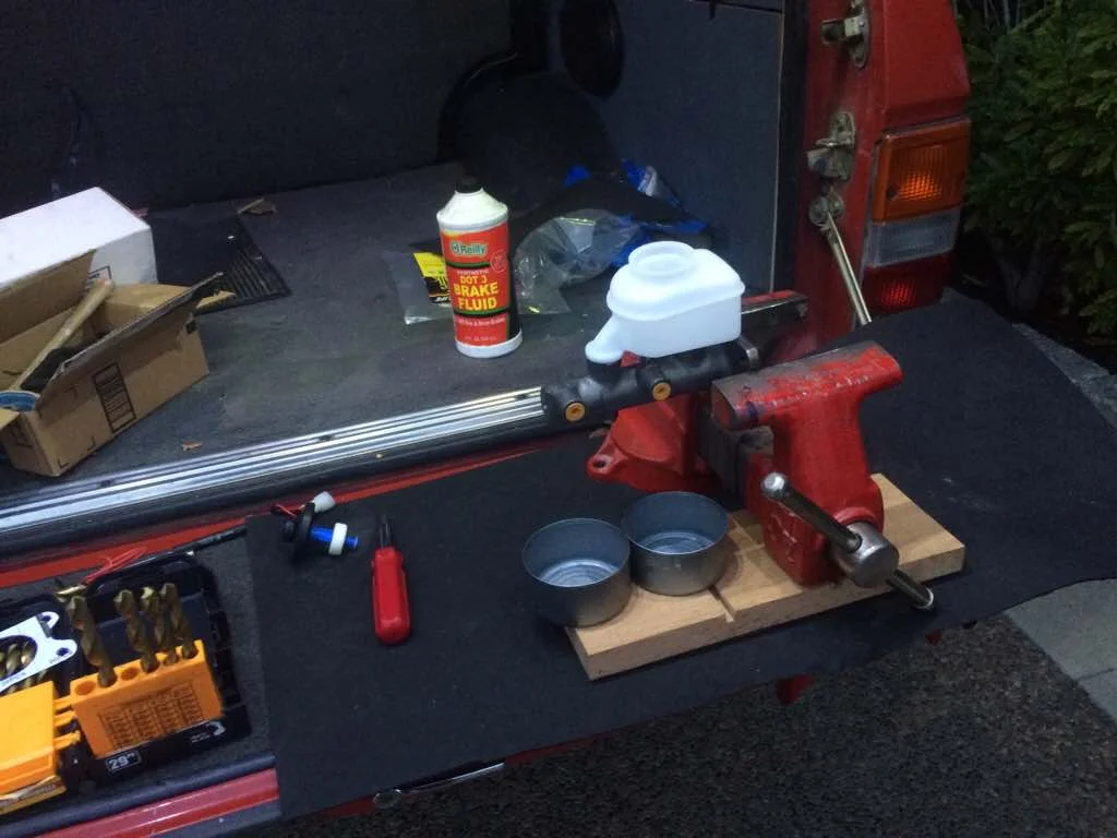

I'm going to be doing a total hydraulic overhaul tomorrow.
New
-brake master (80 series)
-rear wheel cinders-both sides
-clutch master

I should have mentioned in my original response that you should go around and check all of the tires for brake fluid spray. I have had a rear cylinder bust out as well with the same symptoms. Good idea doing an overhaul... It seems like once one part goes out, they all tend to follow the leader.
Talk about a day!
New everything!
