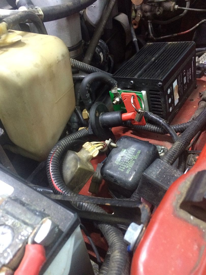

Back from college! Thought Id do some work on the rig. When I went to fire up the truck (itd been sitting for a while) the battery was dead. It turns out that the fan that automatically keeps my inverter cool had been drawing down the battery a little at a time without daily driving.
So I added a battery shutoff. Its simple and works great. I now have a simple kill-switch also.

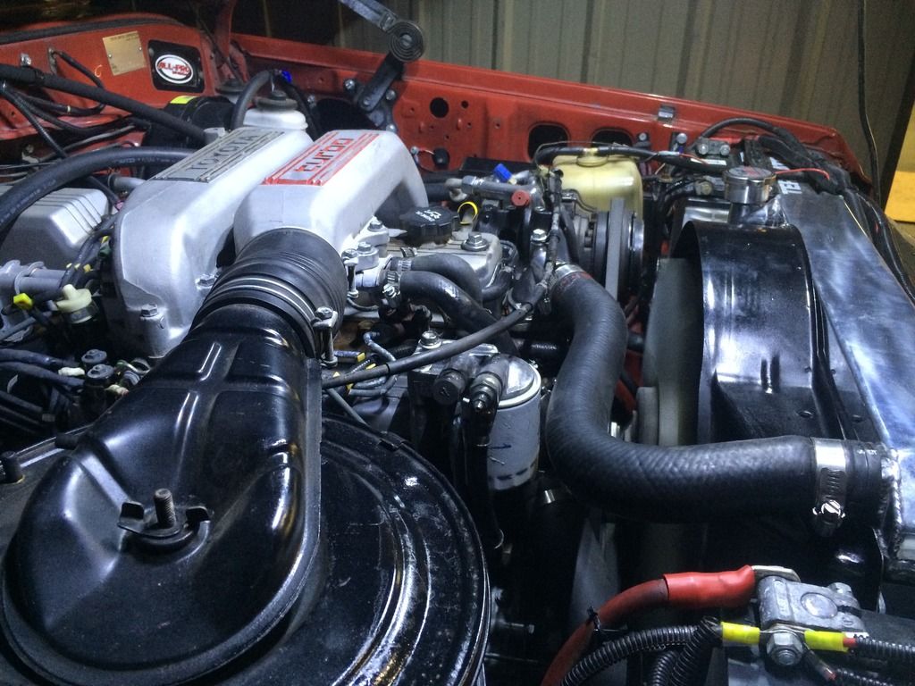

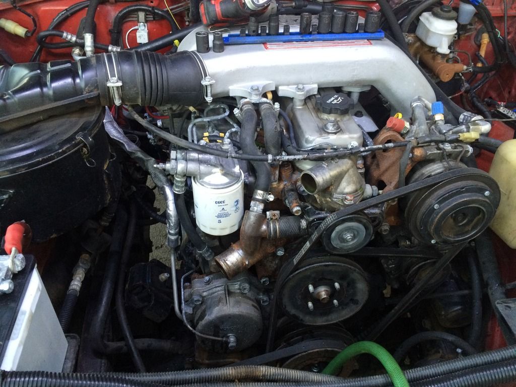

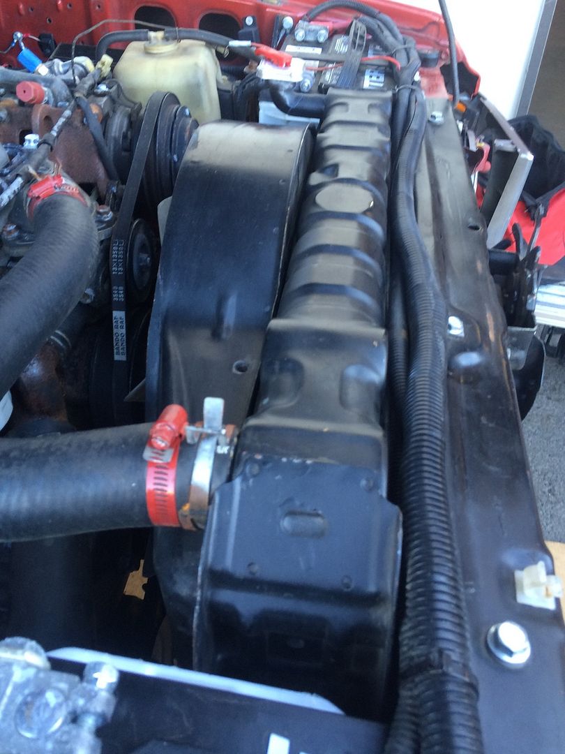

Finally got a chance to put in my new radiator.
My parents drove my truck while I was at school, drove it through some flooded parts of our town, and got some salt water on my components. I hosed off the entire undercarriage and it was fine, but the engine bay definitely saw some corrosion. I took the opportunity to pull the radiator and wire-wheel/sand blast and re-paint some parts that got rusted. Luckily theres no serious rust, its all just surface corrosion and light surface rust, but for me.... it was almost a travesty. Anyway. Its all in now and looking much better.
Here is the old radiator
Some of the corrosion and surface rust I was talking about
This is the engine pre-cleanup
Post-cleanup

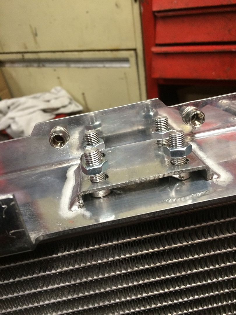

At this point I hit some roadblocks. Champion didnt do the best job of testing their radiators in a truck, and it really showed. For one thing, the studs werent threaded in a common toyota thread. We didnt have anything in the whole shop that would fit the studs, nor did the hardware store. It turns out they are some metric extra-fine thread. (we didnt even have a tap for the thread size in our 200 piece set).
So I re-threaded ever single stud to 3/8's fine. It was really close and didnt take much. Unfortunately champion did a s*** job of tac welding the studs, and a lot of the welds broke and had to be properly welded. I was pretty underwhelmed with that portion of the project. But eventually it all came together.
Great work on the engine bay. Next winter i am going to clean up my engine bay.
I didnt have any issues installing my champion radiator.I guess they don't make them all the same. But at the pricepoint, It is worth a bit of elbow grease

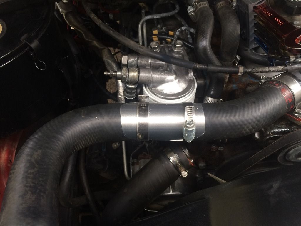

I did another little mod today : Armored my radiator hose.
It sounds odd but it turned out great.

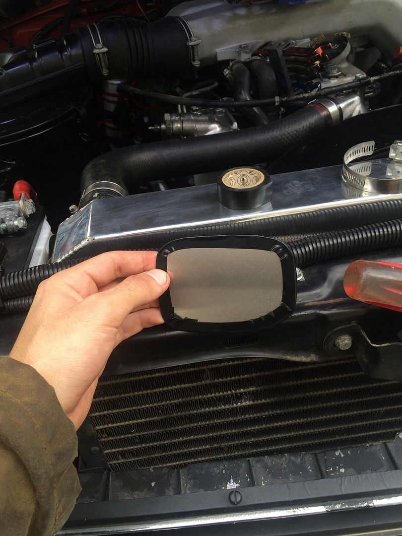

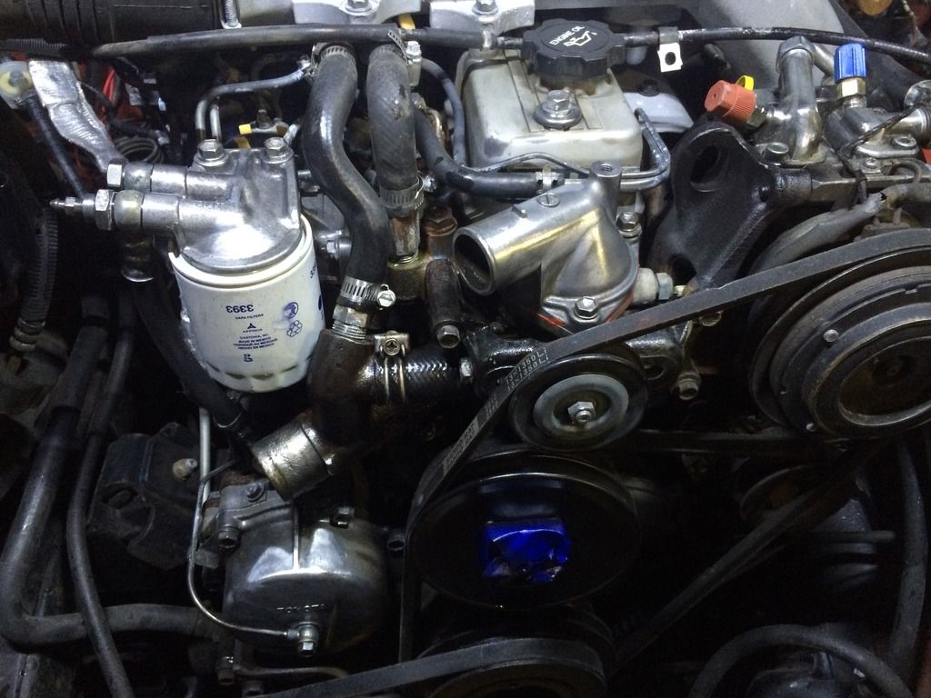

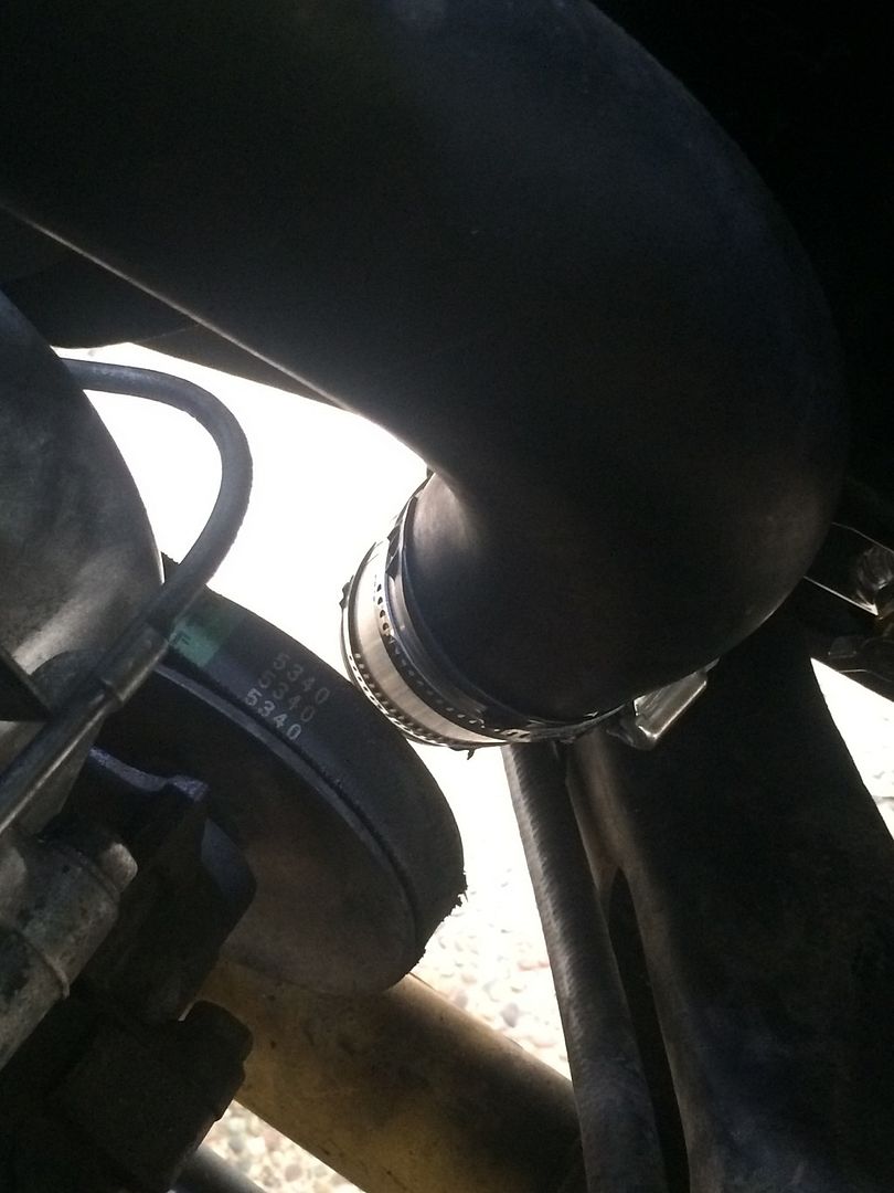

Basically, with the new radiator, the outlet hose is moved more towards the center of the radiator, and the hose came in contact with the power steering belt and pulley.
There was so much contact that I had to trim off almost an inch and a half of the original outlet hose to get a quarter inch of clearance between the belt and the hose.
To give myself a little extra insurance, I cut a thin piece of aluminum sheet, cut off any corners or edges, taped the rim, and hose clamped it on.
Here is the piece mock-fit to the inlet hose to show how it works.
Here it is in its final place. It doesnt look like it, but there is over a quarter inch between the pulley and the plate. It shouldnt rub at all.

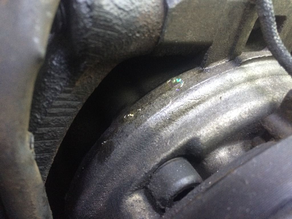

I found something of interest that is a little.... disappointing
While working on my truck the other night, it was dead silent. I could hear this tiny little gurgle or hiss, just barely audible.
I leaned over to my AC compressor and it was a little louder. Just a tiny little escape of gas. I couldnt pin-point the leak, but today i did. I saw a tiny bubble near the compressor clutch wheel.....
Im afraid I may need a new compressor someday. But for now, almost 4 months after filling the AC, it still blows ice cold. With 134, I figure Ill have to completely drain the system almost 20 times before it equates to the cost of a new compressor.......
Does anyone know if the 2F compressors are common to the 12HT? I dont know much about the AC compressor compatibility.

Looking good dude and still jealous of the diesel. Strange that Champion screwed up so badly with the radiator, did you do the welding yourself or did you take to someone?
We have a fabricator at our shop and he just put 3 new tacs on the studs that broke off. We had all the mig gear and stuff.

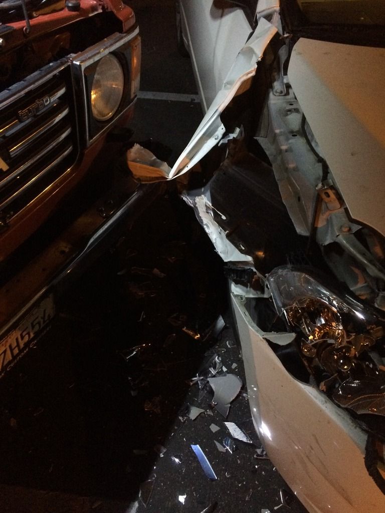

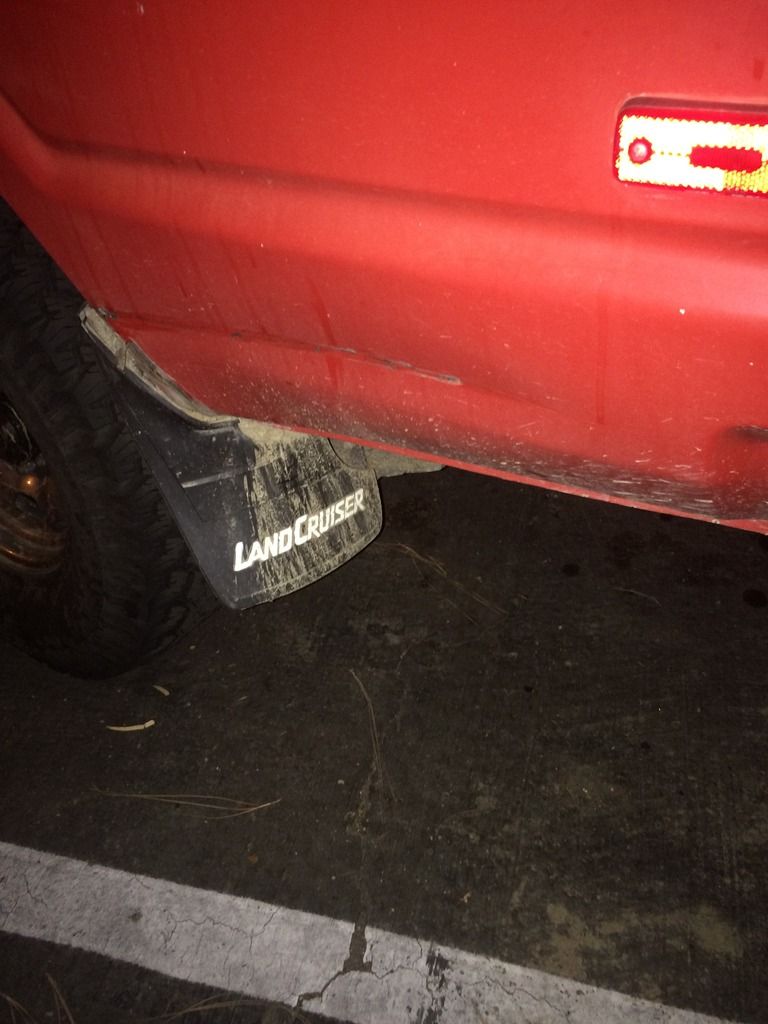

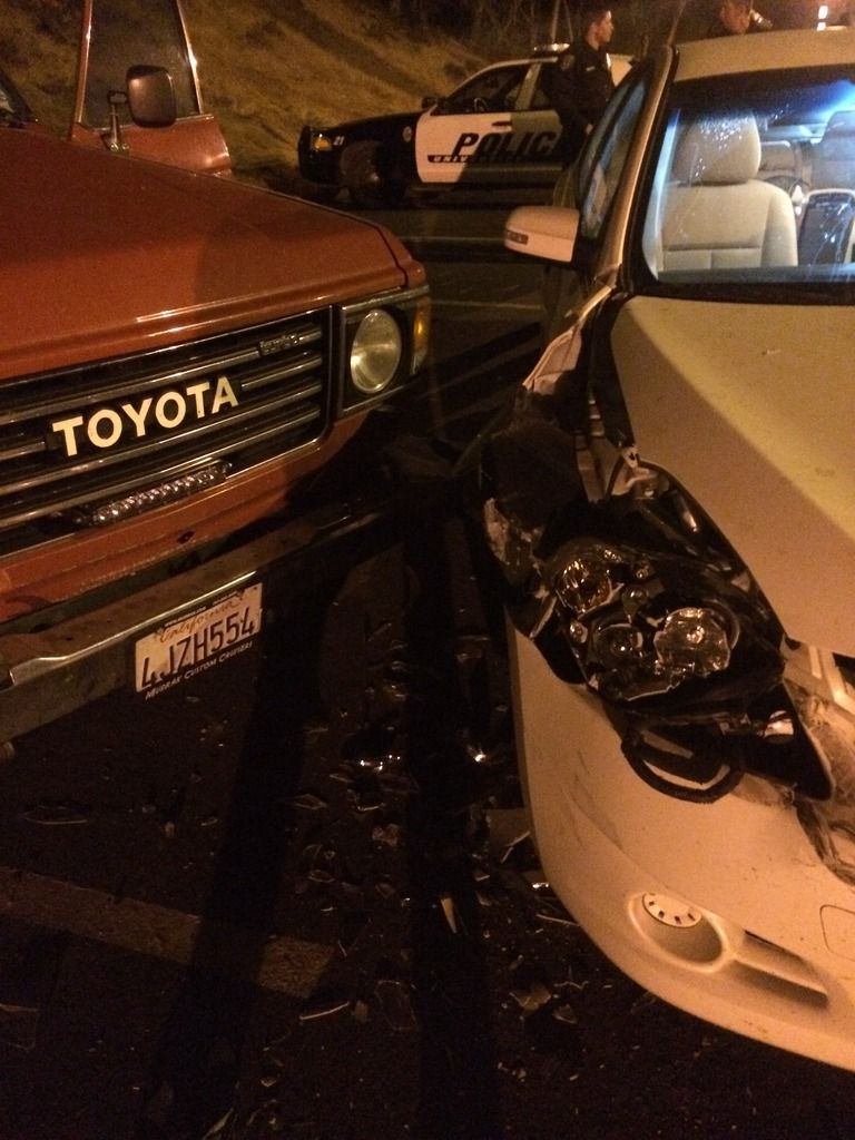

The cruiser took its first real body damage yesterday. I was all packed up and ready to drive home from college, and the cruiser was parked in my college parking lot. I got a call from the PD, and they told me someone had hit my car in the parking lot.
Sorry if the pictures are terrible. It was 10:30 at night.
The front bumper took almost all the impact. And her car was so messed up they had to tow it. It wouldnt even start. The cruiser didnt take too much damage, the biggest dent is in the rear quarter panel. The front fender also got a bit messed up, and the bumper might be toast.
Will update with fixes.
