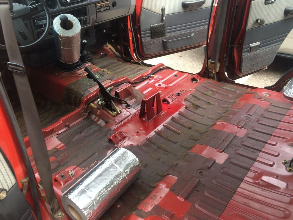

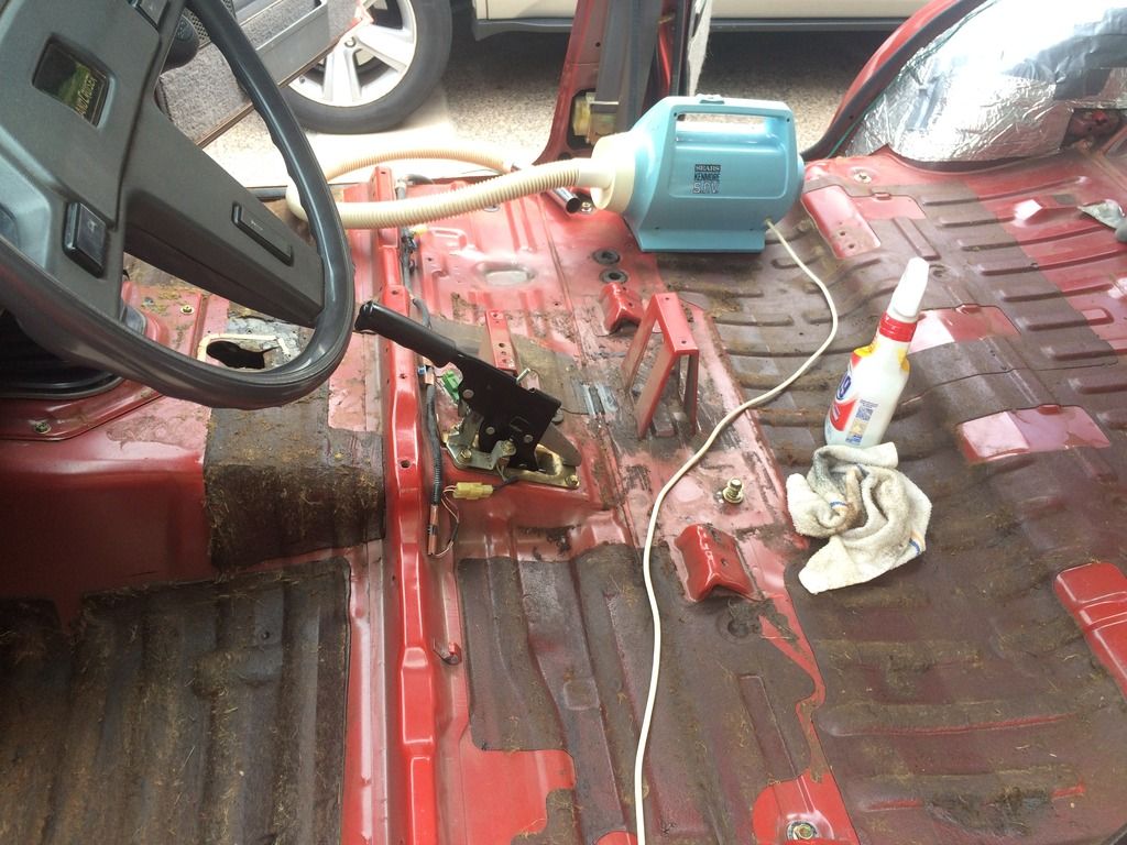

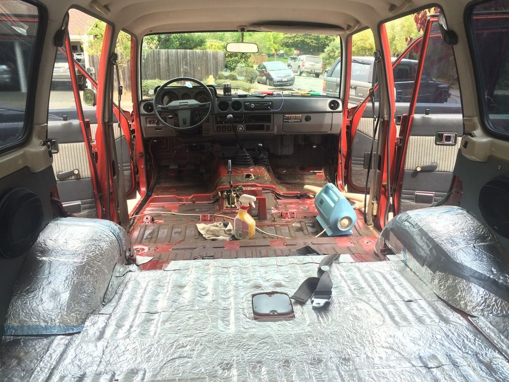

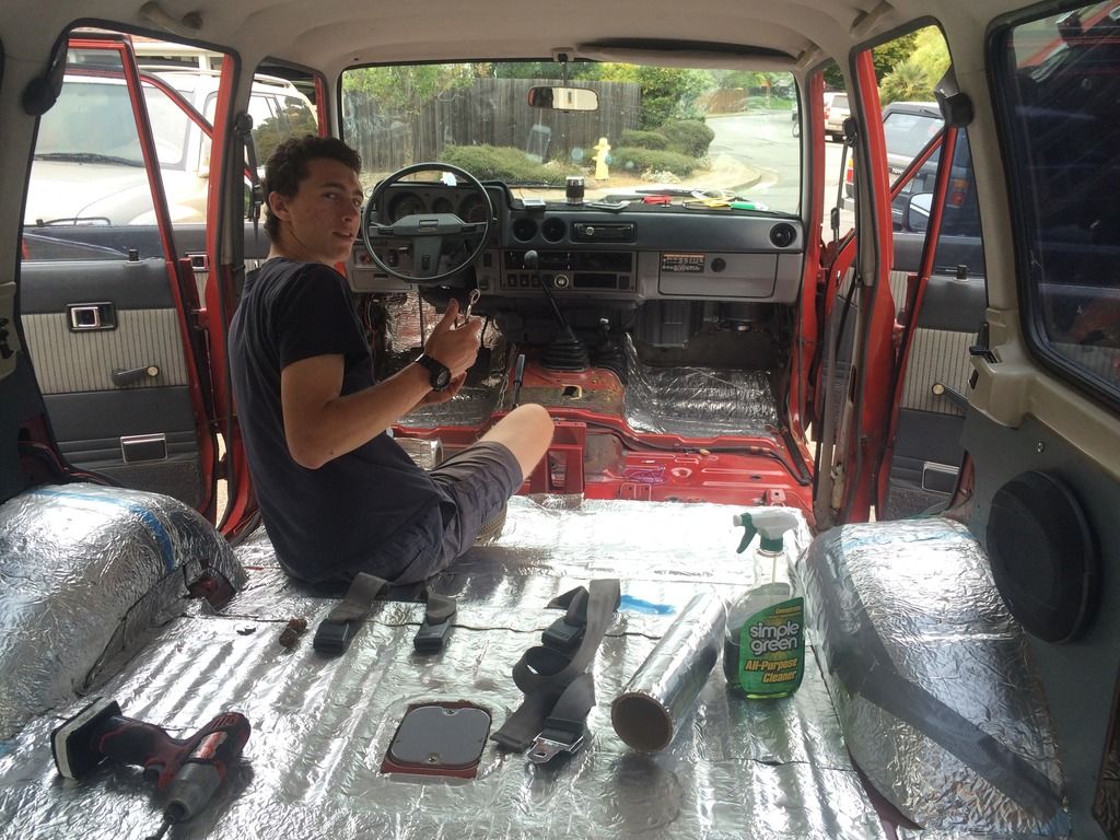

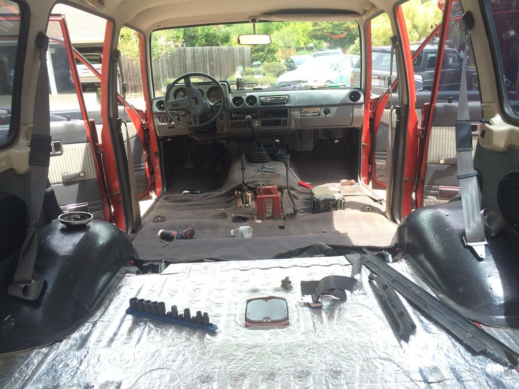

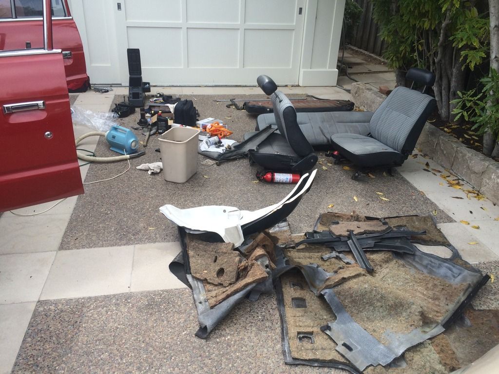

Removed all the old the old carpet and padding from the front and rear of the car today. Pulled the front and rear seats, stripped out all the old jute padding with wire brushes, cleaned it all with denatured alcohol, then applied the new deadener.

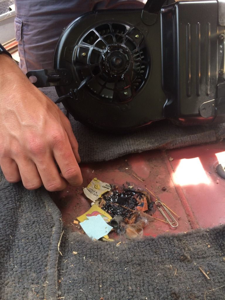

Chris and I discovered some lovely 25 year old things under the carpet and seats. One discovery was a very old, melted candy/food of some sort that was puddled under the rear heater. We also found loads of other tasty things.
After a solid vacuum and scrub, it was time for sound deadener.

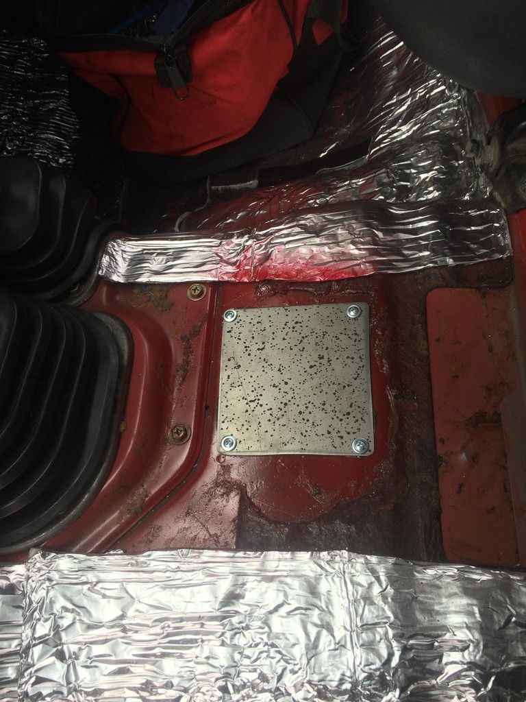

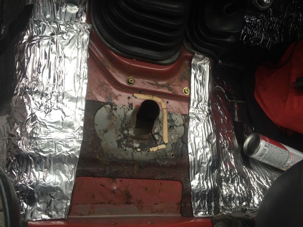

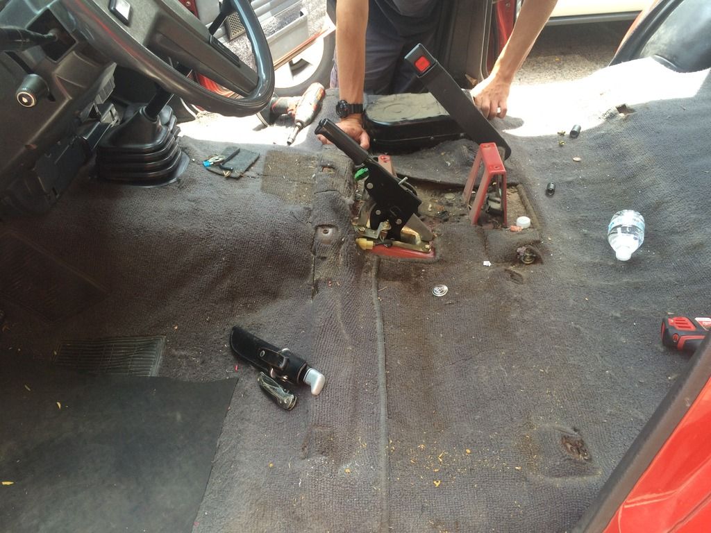

I found this mystery hole under my carpet. The previous owner must have cut this for some reason. Why, i dont know. But its just this ragged hole down to the transmission that they covered with duck tape and carpet.
I put a patch plate over it with 4 self-tapping screws and some super strong apoxy glue that sealed it up really well.

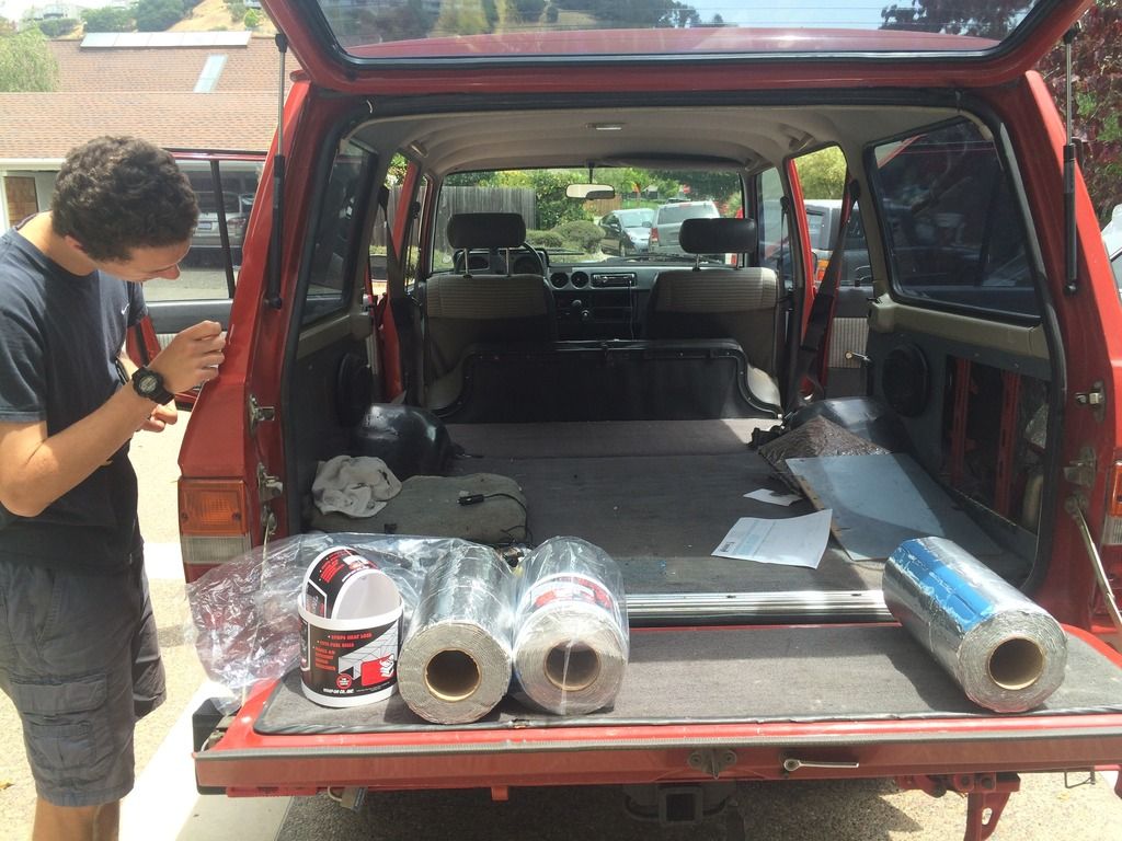

@KeepCruzin what is the deadener that you put down? Looks like the stuff from lowes/home depot but cant quite tell.
Heres the stuff. I got it at Goodmans Hardware (a local place). But it was only $20 a roll. It took about three rolls to do the front half of the car, and another two to do the back one layer thick. *the firewall is double, the transmission dome is tripple, and the rest is single layer.
