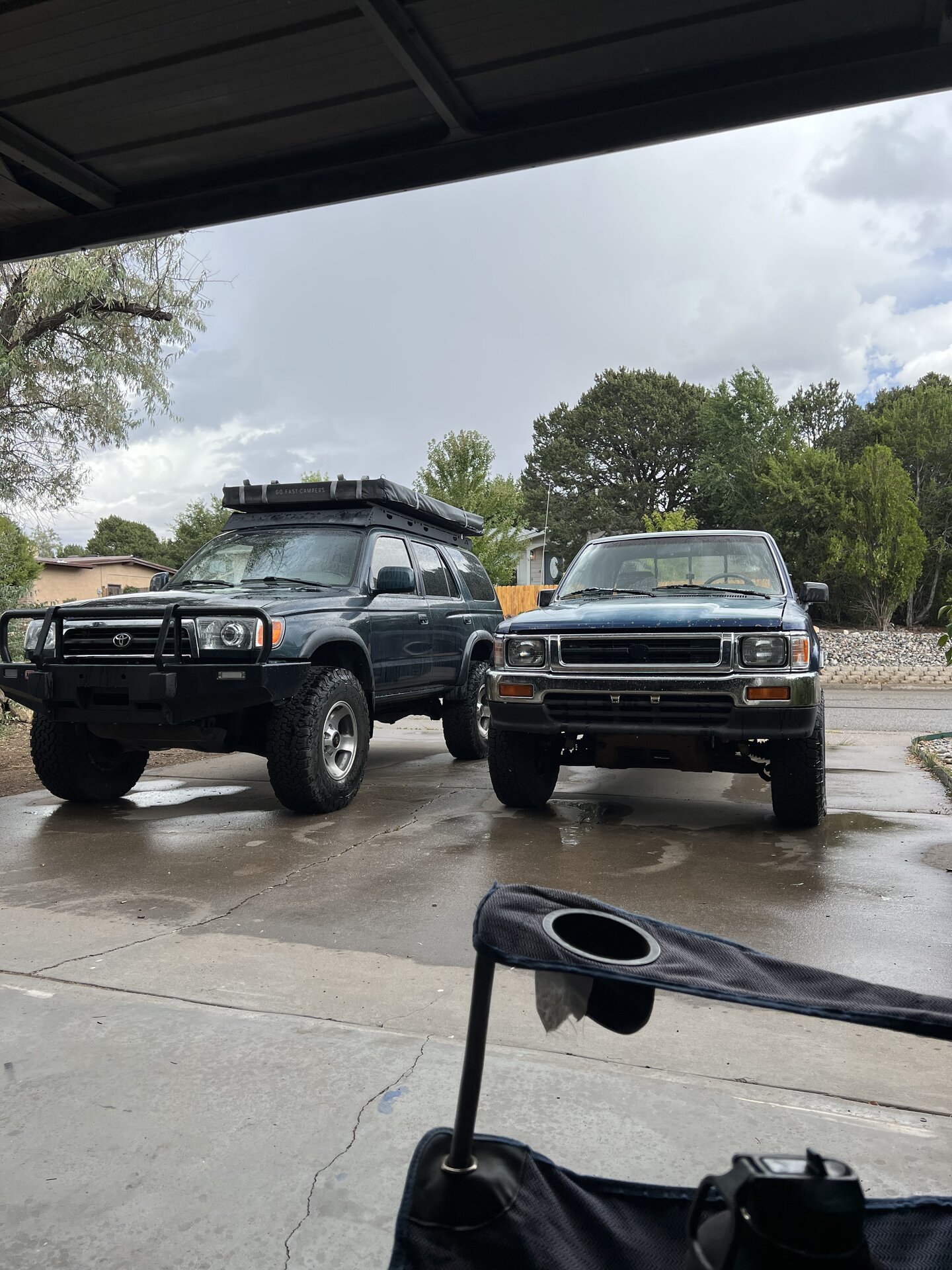

So this low mile 1994 3.0 truck that’s been abused has shown up at my house, dumping fuel and making soot like a diesel. It’s a friends and I’m trying to help him get it going View attachment 3431279View attachment 3431280

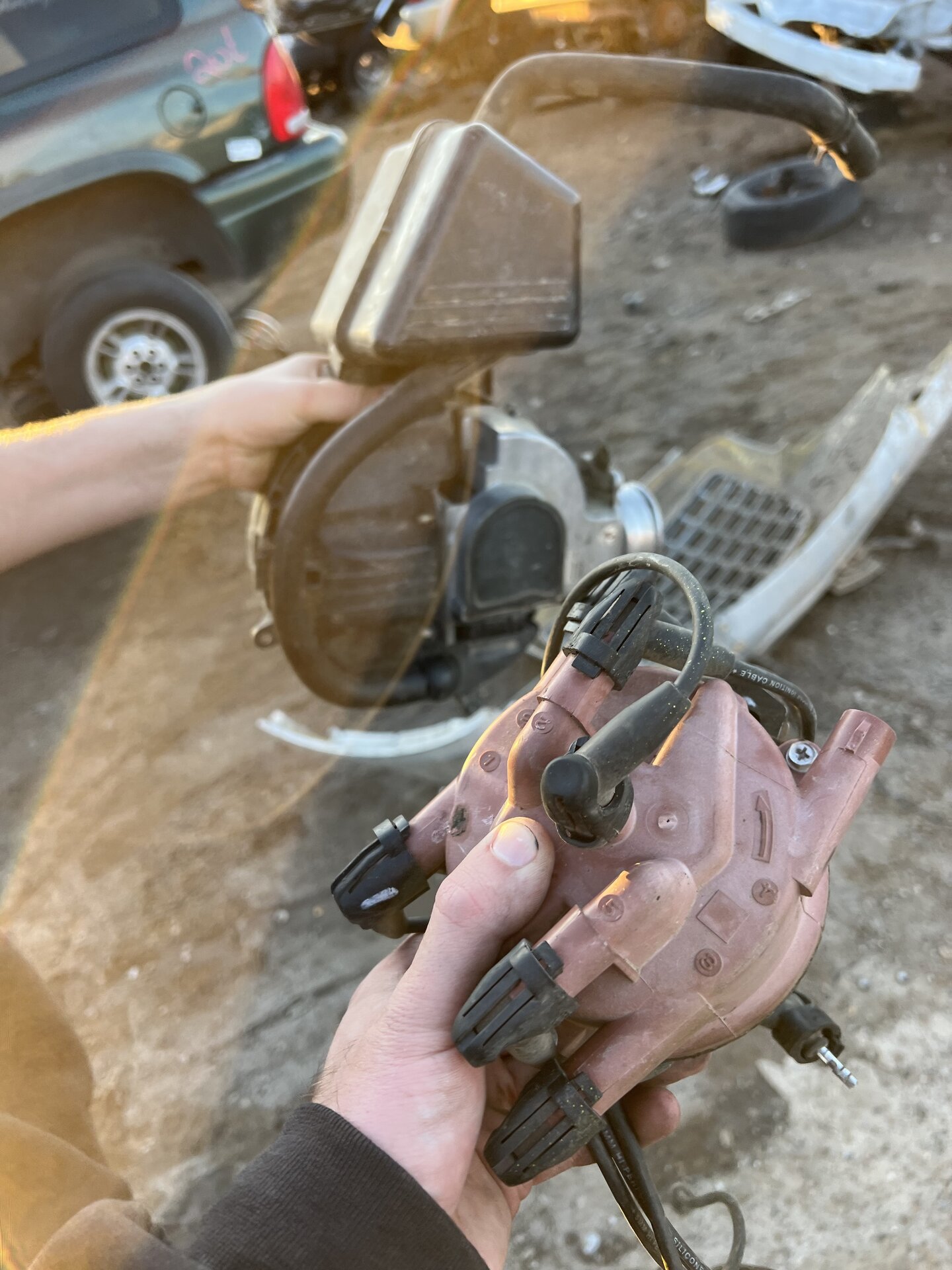

About a month ago I found a 3.0 4runner torn apart in the junkyard and someone had already pulled the afm and the distributor and left them in the back, easy enough for me so I grabbed them.
Today got it put in and timed, truck runs great for how bad the plugs look. My friend who owns the truck wanted to learn to work on cars so I just supervised and helped as needed. The distributor immediately fixed it even with the timing eyeballed, hit it with the timing light and got it dialed in.
About a month ago I found a 3.0 4runner torn apart in the junkyard and someone had already pulled the afm and the distributor and left them in the back, easy enough for me so I grabbed them.View attachment 3501981
