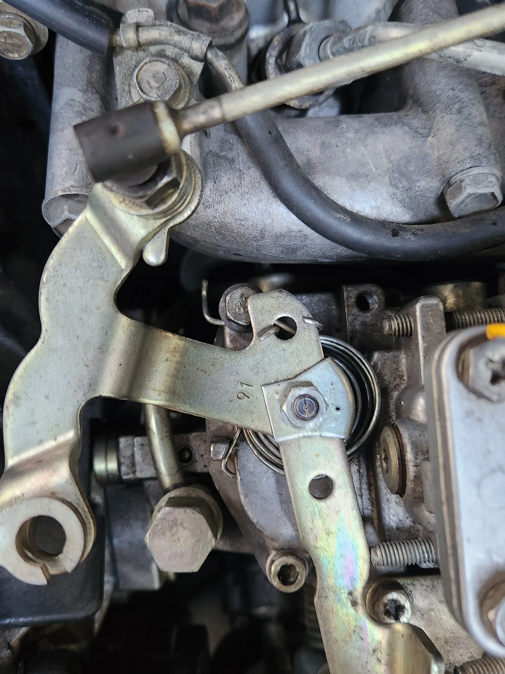

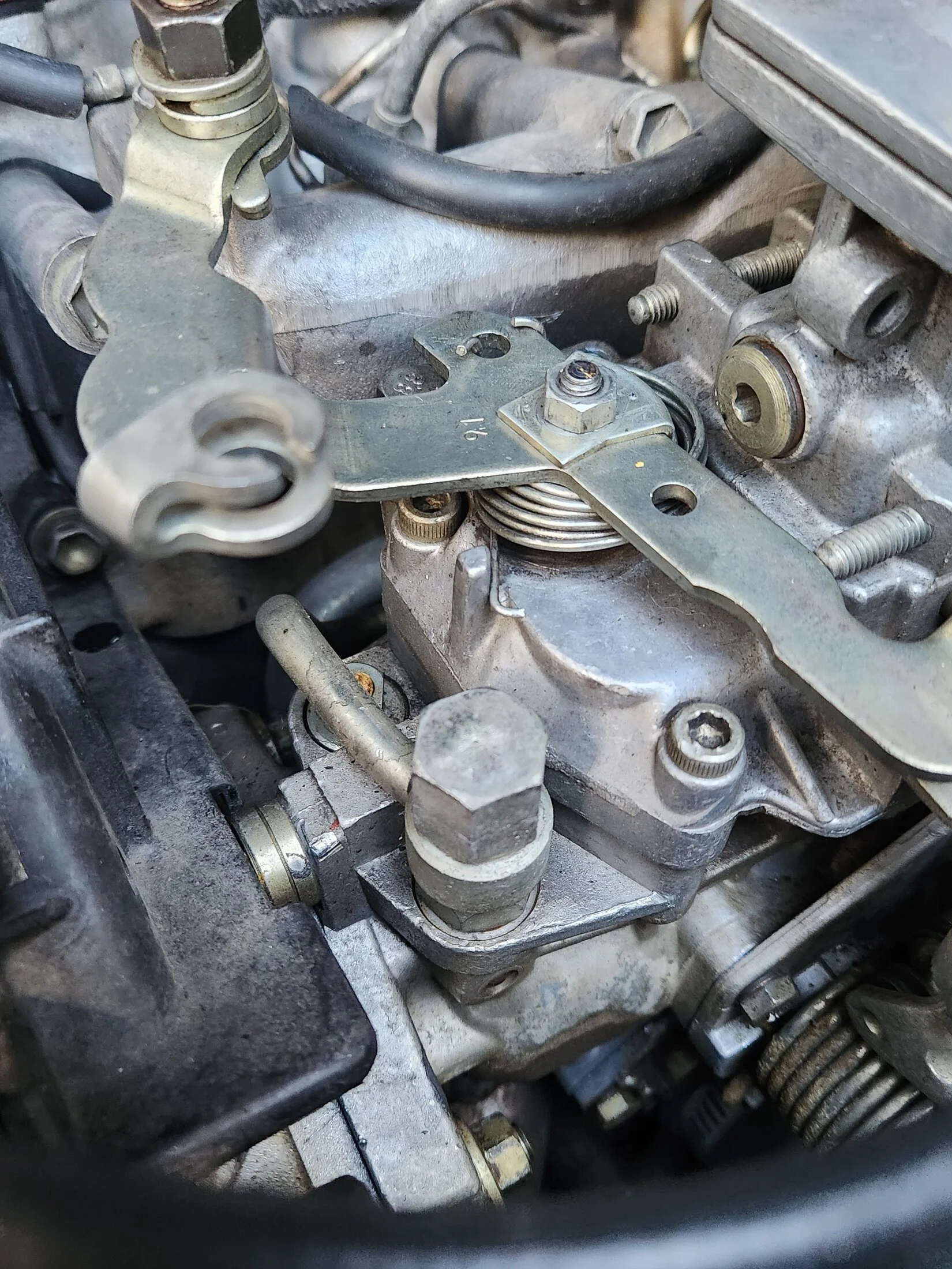

Anyone out there who is familiar with this style fuel pump , can you take a look at this spring ?
It seems like it's possible not installed right and has some play in it.. . I see on the parts blowout there are two different size springs in there. Is this how it should look ?

That’s how my VW Rabbits injection pump spring looks, it’s the same style. If it’s functioning well right now I wouldn’t touch it, those were a pain to reinstall.
Looks fine to me. Play is usually in the ball joints.
Lol dude don't jinx me . It's all allegedly been done and is in more than road worthy condition . This thing is a sleeping beauty just waiting for me to give it the beans
Good to know. I made the horrible mistake of messing with that hooked end and thought it was supposed to be around the post. I managed to set it back before realizing I shouldn't touch it.
The cable and linkage leading up to this also have a lot of play but I suppose I wont mess with it

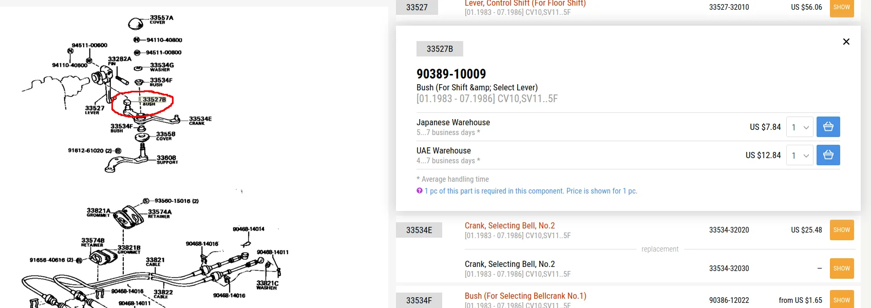

there are rubber bushings on the end of the shifter cables that can wear used to be a company selling all brass replacements for the MR2 crowd, also if you take apart the linkage on the transmission there is a square piece that rubs on two sides. you can turn it 90 degrees and get some more life out of it or replace it. will tighten up the shifter alot. good idea to grease it up too.
They still do make them! I had these on my my AW11, but eventually replaced them with the bearing style.
Ohh interesting, thanks or sharing. OK so this isn't something inside the transmission causing the slope, its more likely the linkage? Good to know.

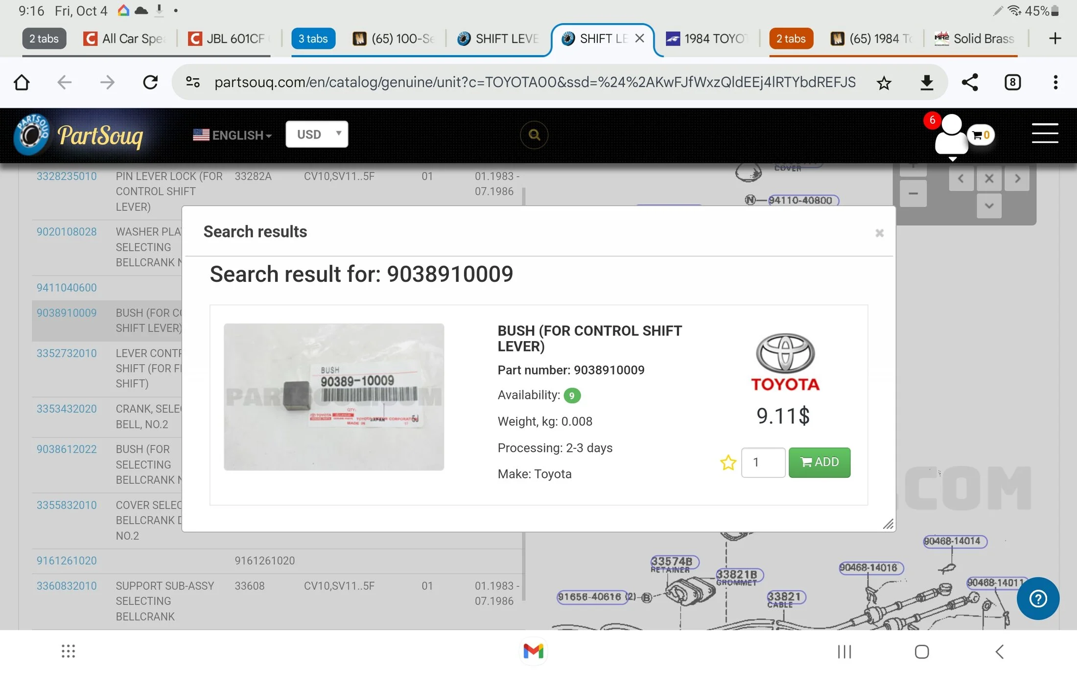

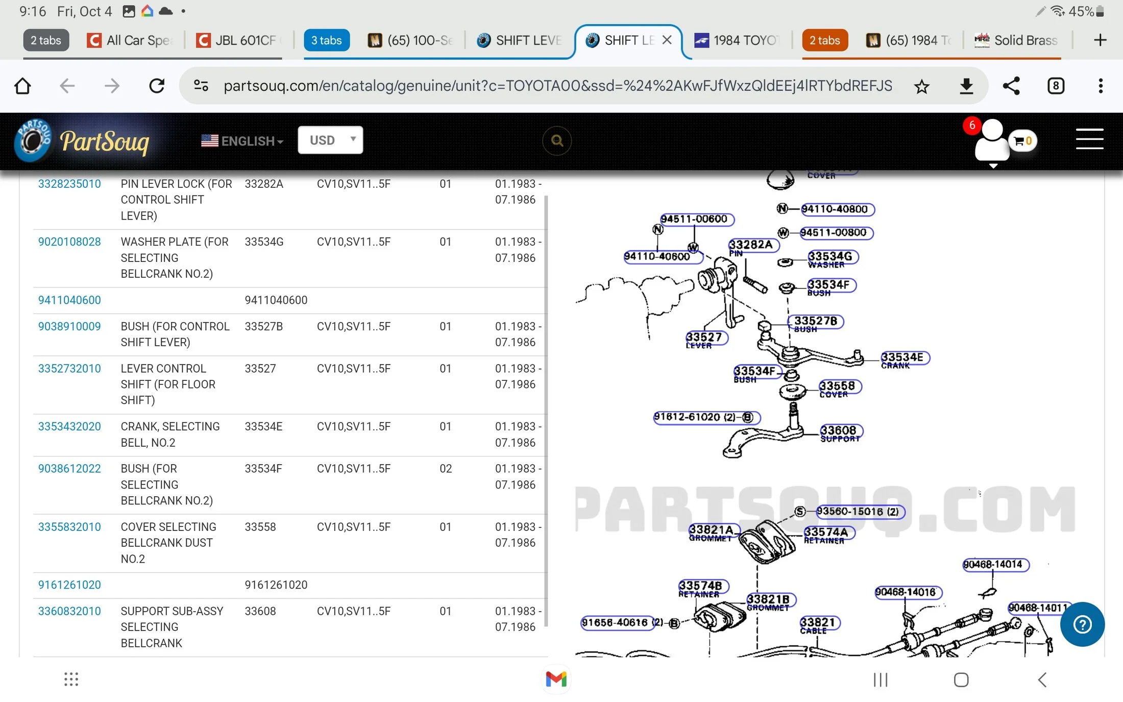

So I'm trying to make sense of what I need to look for to tighten up the slop in the shifter. Looks like someone linked to cable bushing that will work but you also mentioned some square piece , see below. Is this it?
I've got to get eyes down on the transmission and see how hard it would be to replace. The shifter cable is shiny and looks new , I was told it got replaced after I broke recently , I wonder where the slop in the shifter is coming from
Yup! That's the same one I find on Megazip for your car. I never replaced mine, but turned it 90 degrees like @TheBussman said. It helped alot as it was worn a good amount.
