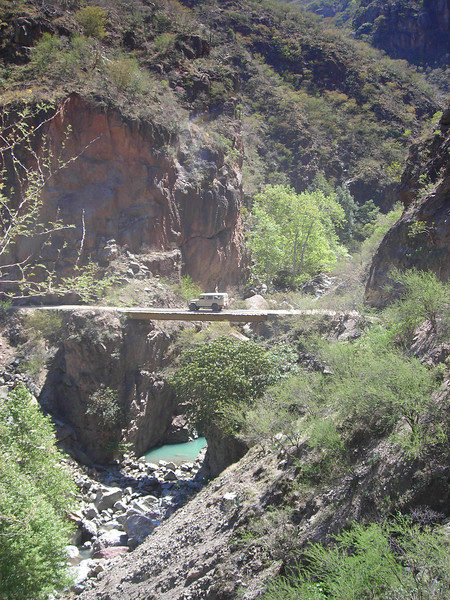

I kindof had to drive the Troopy through Mexico and the back way into the Copper Canyon region...
It's a Cruiser, right! She needed to get out and stretch her legs a bit....

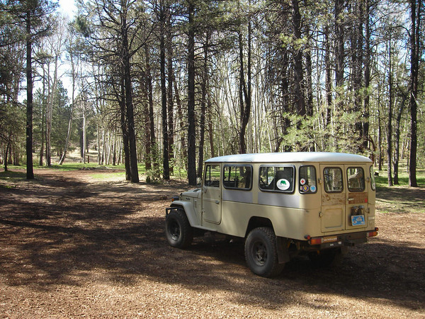

Teaser Shot!

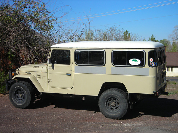

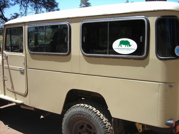

....and today, I finally made the decision to help with some of the heat and security caused by the copius amounts of clear glass...
TINT!
Front and center windows are 32% 3M film, with the rear windows 14% 3M film....
So far, I like it. It looks darker than it is. Much cooler in the cab, and it provides a bit more security from prying eyes!

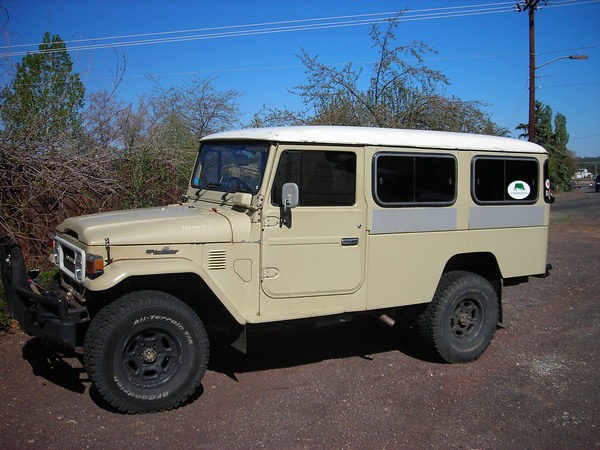

Other than lubing up the hood release (yes, this year model has an interior hood catch...so the hood locks when shut!), I decided to give the cans of matching paint a try.
So, the windows were masked off and I used the lower window line as a marking point, as well as the body/top line, and went to it!
It turned out so well that I think I'm just gonna order another 10 cans of matching enamel and rattle can the whole truck! I haven't done any blending, and it's difficult to see where the new paint is, other than a bit more shine!

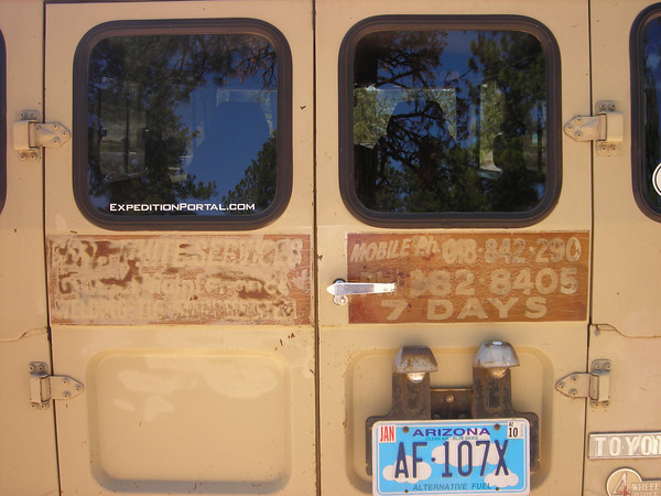

The rear advertising has been left for old times sake, and given a fresh spray of clearcoat.
One color!
