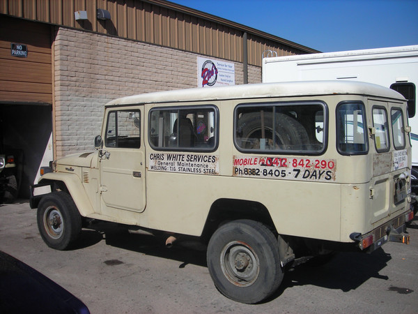

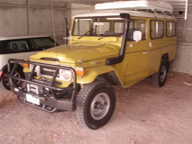

She arrived at the Port of Long Beach on a ship from Brisbane in August. 312K kilometers on the clock, and in really good condition for her age. Runs great and shifts smoothly.
The build up will begin shortly after a title company is done doing the importation and title stuff...

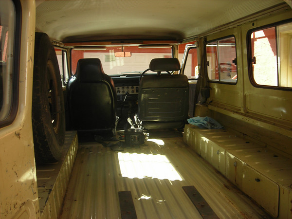

Interior Seating/Cage/Storage/Water etc.

throw in a couple rows of the IPOR bench seats in the back. It'll look real nice.
Love the Troopy H.. Congrats on the purchase.
On the Q-Tech seats.. Bestop i assume? In my researching replacement seats for my son's rig i'v read where a considerable amount who have purchased those complain of a bar that runs horizontal at the base of the spine.
I read where alot of guys like the WJ Grand Cherokee Heated seats from 99-04 are very comfortable.. and reasonable.

1. I can't figure out if there are lift springs on it or not...front pack is 7 springs and rear is 8...slight arch on the front, very good arch on the rear with Dick Cepek shocks....barely (within 1") clears my 7' garage door.....
Anyone have rocker panel measurements for a stock 45Troopy?
If its currently stock, I've gotta keep it that way to clear the garage, if lift springs....I'll likely just order a new OME setup, as the ride is pretty harsh, and I'll only be carrying about 1000 lbs of gear fully loaded, with a swing away tire carrier, water tanks, etc....

So...I guess that answers my question....I'm at 83" with 31s and the springs that are on there.....they're not stock, giving about 4" of lift....:eek:
I'd actually use an OME kit as a "lowering kit"....:rolleyes:

True. Judging from the advertising on the side they put overload springs on that bad boy. So when empty you are up that high..

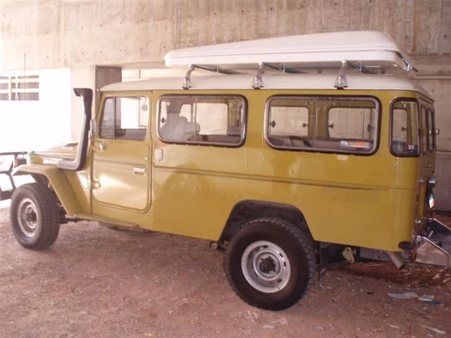

no way does that have 4inches of lift in it. If anything it looks pretty close to stock to me. Altho feel free to prove me wrong
mine at stock and 31's
And troopies, atleast here, came out of the factory with the equivelant of 32.6' tyres. That pic doesnt show it to well but 31's look a bit small. 33's match the truck's size.

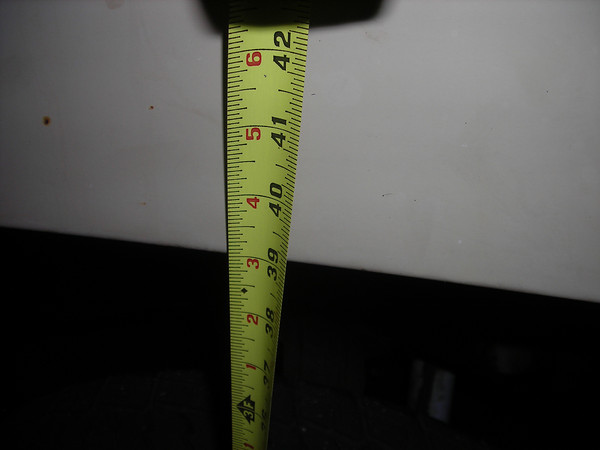

From the ground, passing through the centerline of the hub, and measured at the middle fender cut, is 39", the front fender, also measured through the centerline of the hub, is 37"....rocker panel/step is 22"...
I can post pics if necessary...

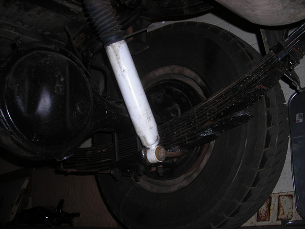

Just so we're clear....The spring packs seem to have much too much arch to be stock...but this is my first 45...otherwise I've had 40s...
The spring packs in the rear:
And the measurement to the rear fender:
And the measurement to the front fender:
