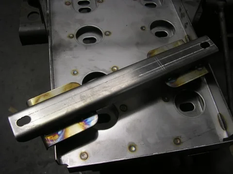

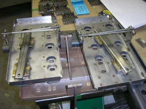

Here you can see the stock tray (with rubberish coating removed, bead blasted and flash rusting). I copied the hole patterns, stretched the length, shrunk the width and moved the hole patterns around to optimize the limited space under the hood.
it fits!
mounted on the bracket - with one bolt anyway :hillbilly:

Those battery brackets are GORGEOUS.
You should put those in the classifieds, and they SHOULD sell like hotcakes. A group 31 battery is simply too awesome (notice that's what I used--but my battery tray isn't near as nice as that). They're probably a lot lighter than the one I ended up with (I made it out of 1/8" steel).
How do your battery T-bar hold downs fit into those hinges once they are welded? I ended up using hose clamps that I can unbolt to attach my T-bars to the tray, but I like your way (the way the factory did it) better.
Dan
Dan
There is a guy making them already = Stainless Steel Battery Trays for TOYOTA LANDCRUISER
The prices there are quite good. But if anyone wants something completely custom, I could fabricate it.
I welded (or rather made someone else do it) the T-bolts together in the already formed strap part because I didn't have the battery height measurement handy when I was ready. It would be easier to have the t-bolt done first and slide it through the strap before closing the strap.

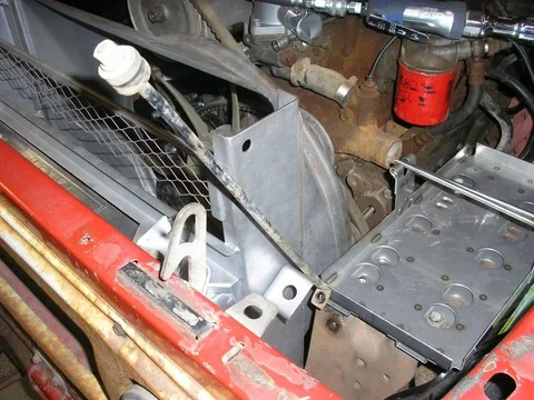

Another task... rad bracing. I had one that worked for the other side but had to alter one from the 2F setup to fit the left side.
Juuuuuuuuust a bit long...
Chopped and re-attached, ground and bead blasted
et voila! Note, this is the "L" bracket that I rotated earlier to accommodate the rad moving back.

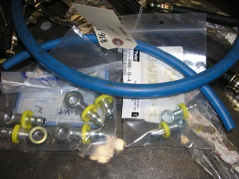

I did not get the vacuum pump oil lines with my motor and I would have had to replace them anyway. The OEM lines are either too expensive or no longer available, can't remember which. So I called around trying to find a supplier for the banjo fittings and ended up going with Parker push on type fittings and hose. The hose is rated for petroleum products, 250 psi, and 150C.
These are borrowed from Hilltop Cruisers
The goods
Installed
