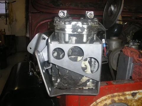

This pic is dark but I am trying to show the York compressor on the left. A while back I made the mounting bracket for it but didn't show it.

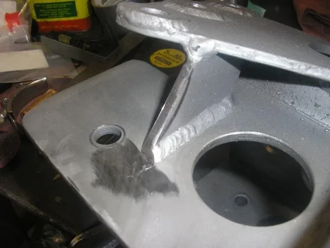

The bracket

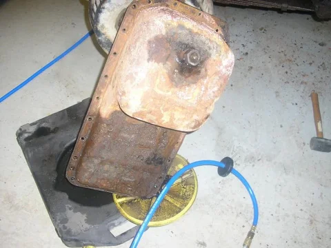

The turbo oil return will go to the pan - so I removed the pan in order to weld in a fitting of some kind. I wanted to see the bottom end anyway. I was apprehensive of the internal condition of this engine given the corroded exterior including the pan.
A tad rusted...

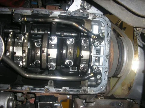

But inside is spotless :clap: I found nothing but oil inside - no metal shards, flecks or sludge at all. I picked up this engine as a core only with the intention of a complete rebuild. All I was told was "I think they parked it cuz it was seized". Well I already established it was not seized cuz I can turn the crank pulley back and forth with one hand.
With no history at all I am pleased to see oil droplets still clinging to the bearing caps and cam shaft. Could have been all dry and rusted with metal chunks all over.
So I suppose I will take off the bearing caps one at a time and check for wear. What else should I look at to determine the condition of this engine? I guess a compression test would tell me a lot. I don't have the flywheel or clutch installed so I could put the oil pan back on and spin it up with the starter if I put the flywheel back in. I have never done a compression test on a diesel before. What do I need to do? There is no fuel line attached - no fuel tank for that matter :hillbilly: But I don't want to start it, just spin it right?
I'm sure I can borrow a test kit from the locals. I'm guessing I remove the glow plugs, reinstall the pan and oil, dribble some oil over the valve train, hot wire the starter and spin? What about the injection pump? Can I cause any harm to it spinning it without fuel? There is fuel in the filter. Unless I get real high numbers I will still rebuild but I need the numbers to decide.

Had to clearance my York compressor bracket for the oil line.
York bracket reinstalled.
