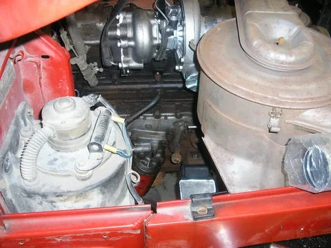

Okay - I went back out to the garage and did some thunking about the air filter arrangement. I was wanting to put in a Donaldson system but where to mount it? I quite like the look of putting it on the fender outside the engine bay. Makes it look very utility or "militaryish". BUT... I want a full snorkel (In fact I will be building my own Safari knock off). The pictures below show there just isn't room for the 8" -10" dia by 16" long Donaldson - but the factory housing could (and has for others) work.
I can fab up a nice transition from the filter to turbo with a bit of tin bashing.
If I make the header "right" I can keep the down tube from scorching the firewall.
If I relocate the inlet into the filter housing I can still have the charged air go around the housing. Remember, the turbo is just hanging in approximate position in these pics.

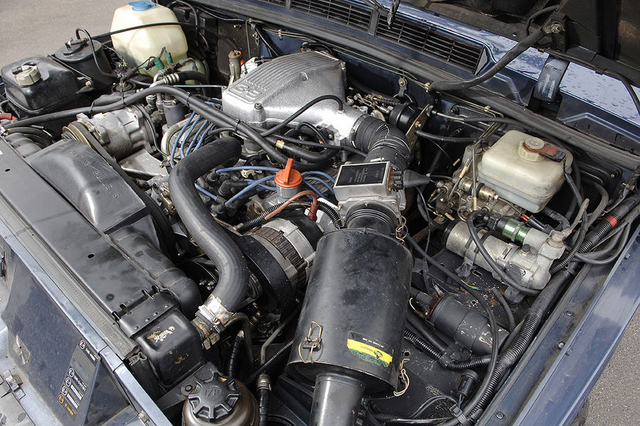

Kevin,
the Rover V8 ( Range Rover/ Morgan plus 8 / Landrover V8 and some more british cars equipped with this engines )had a round air filter housing, looks a liitle bit nicer ( I think ;).... only my opinion :D ).
If you put it on the outside of your fender, or if you have enough space you could put it on the inside on your right fender and mount your snorkel on it.
see pic:
Cheers
Peter
if you want measure this housing....
your nearest Land Rover dealer ;)

Thanks Peter. Thats a compact unit for sure. Interesting the inlet and outlet are on opposite ends.
I am going to alter the original air cleaner from the donor BJ42 by relocating the inlet and changing the outlet. I will make every effort to make it look clean after powder coating to preserve the original look. I will try this approach first because it doesn't cost anything and I believe I can pull it off.

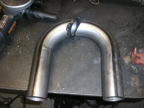

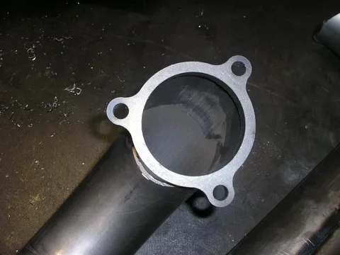

I bought a 2.5" OD U-bend from a local speed shop...Eye-balled the angle I wanted to get the hot down pipe away from the firewall so as to not test that nomenclature...
Welded the flange from the turbo to it...
And down pipe done - for now. I have yet to add a post turbo pyro bung and likely another bend into a flex pipe.

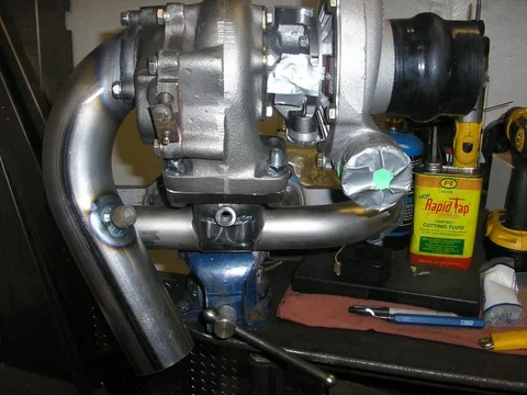

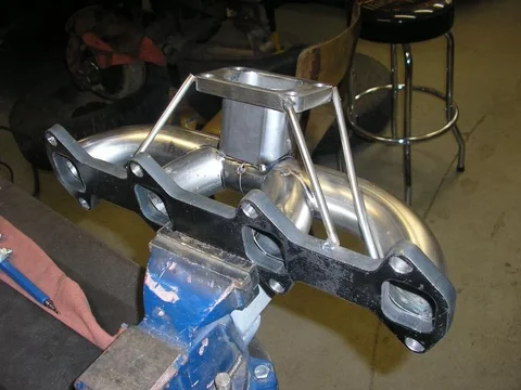

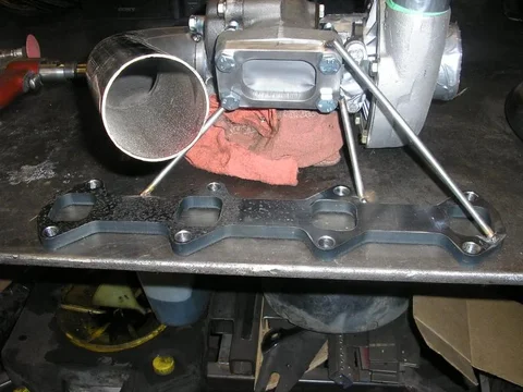

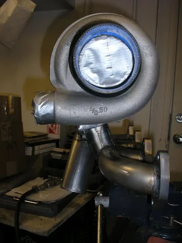

I hung the turbo from the ceiling and positioned it where I wanted it. I had to consider exhaust flow, inlet/ charge flow, turbo oil feed/return, water lines for the turbo (I got the water jacket type center section in an attempt to extend the operational life through supposed quicker cool down and lower temps). Also clearance from the firewall/ hood/ air cleaner/ battery/ alternator etc. etc.
Once I liked the position I took some 1/4" round bar and tacked the turbo inlet and manifold plates together to maintain their relative orientation.

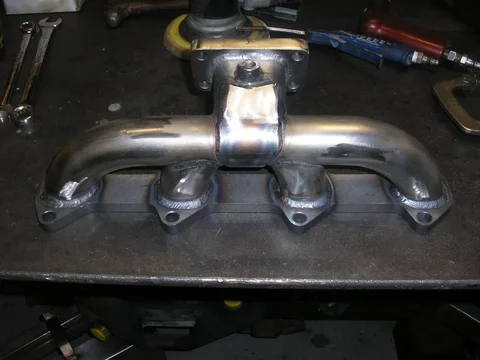

Then off to the bench to hack up some 1-3/4" U-bends and build a manifold...
I had visions of a fancy twisted up equal length runner manifold but then I realized the fact that this is a low rev(flow) diesel and not a race prepped V8 so just a simple set up will do. Plus there isn't enough room to get fancy with the radius on the U-bend I got.
I made the rectangular section at work from two halves.
You can tell by the welds that I didn't weld it :hillbilly: I did however clean out the inside with a 6" long carbide bit for that extra 1/10th HP :p Pre-turbo pyro too
A few before bolting on to the engine

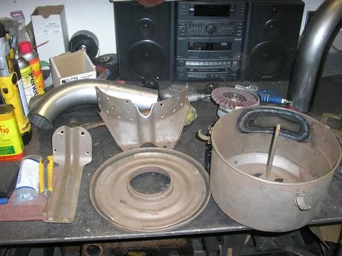

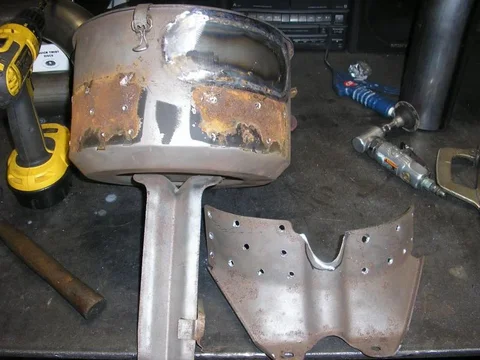

So having decided to use my original BJ42 air cleaner assembly I'm going to alter it....
.... a little...
I want it 1" lower, 1/2" closer to the fender and rotated 20 degrees CW to fit better in the space left.
So off with the main bracket... a bit of rust and black primer
and the support... more rust

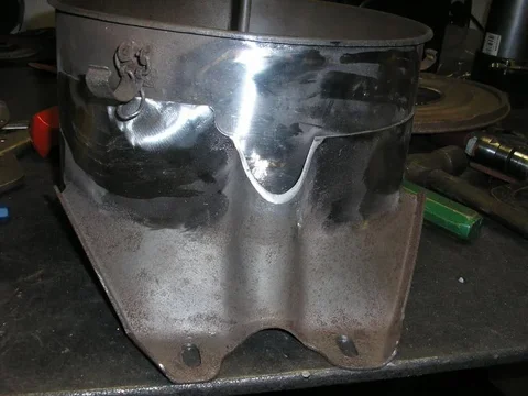

you can see I have already cut off the outlet tube from the lid and removed/ capped the inlet
1/2" closer to the fender - to clear the charged air outlet better
1" lower - to clear the hood
20 degree CW rotation - so the three spring clips clear obstacles
Shortened and re-attached bottom support - the air cleaner assembly still bolts to the factory holes.

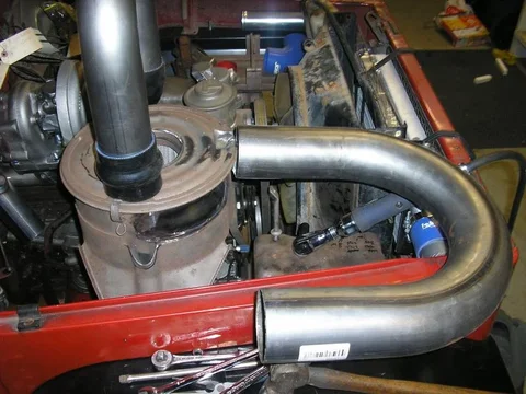

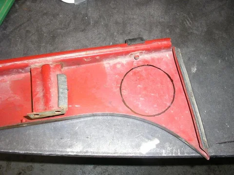

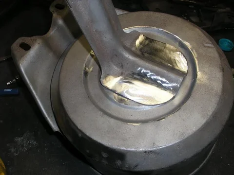

Marked and cut a 3.5" + hole in the apron to give me a target to fab towards
Cut and shaped a section of 3.5" U-bend for the inlet - couldn't see what I was doing so I removed the fender and apron and worked on the bench (work smarter not harder :D)
Last two for today
