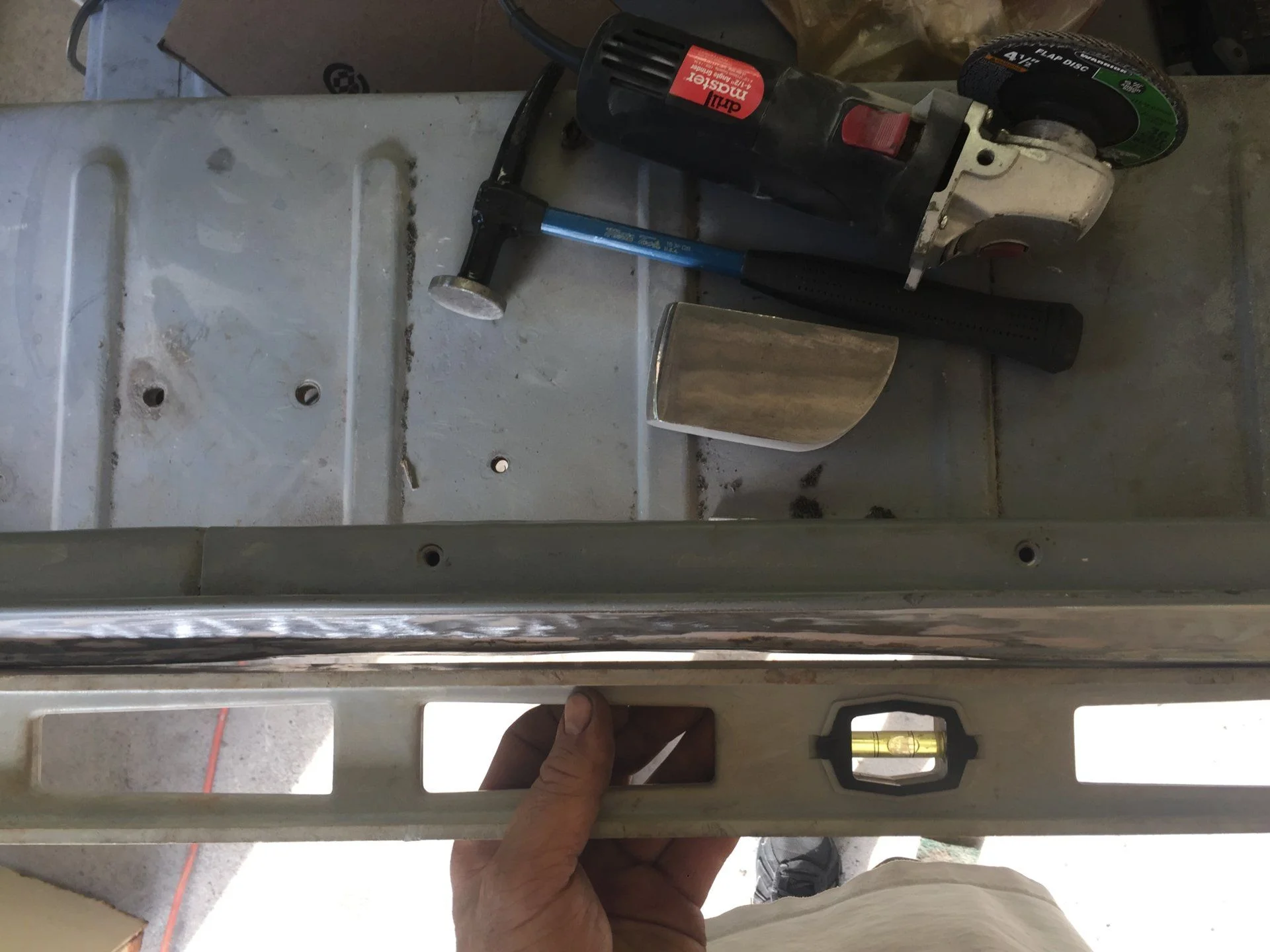

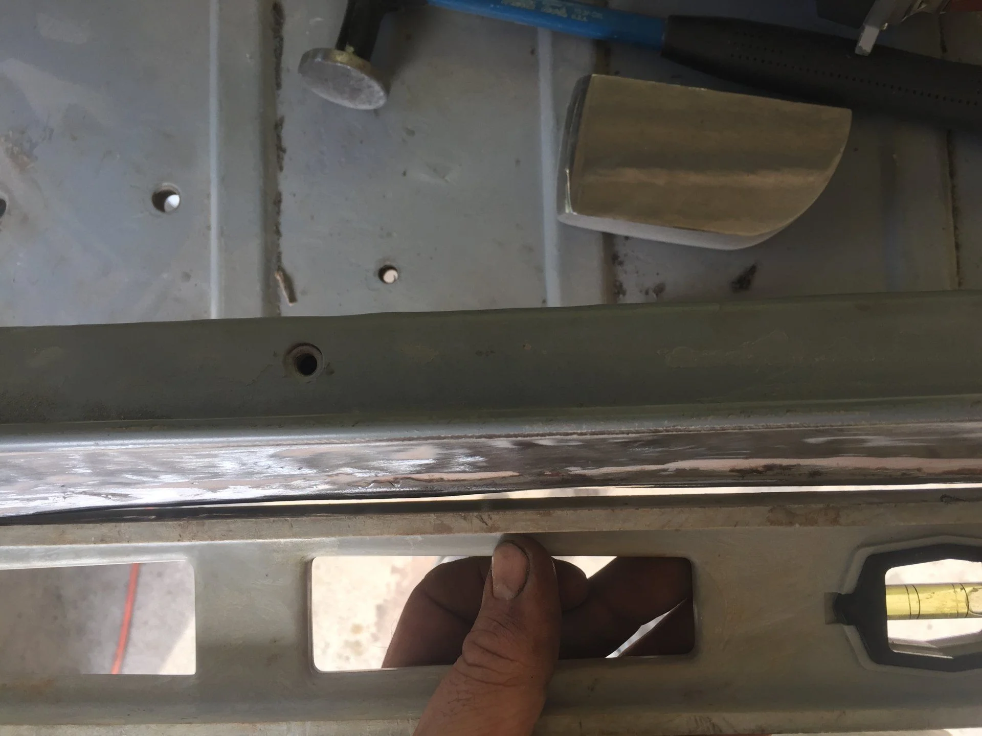

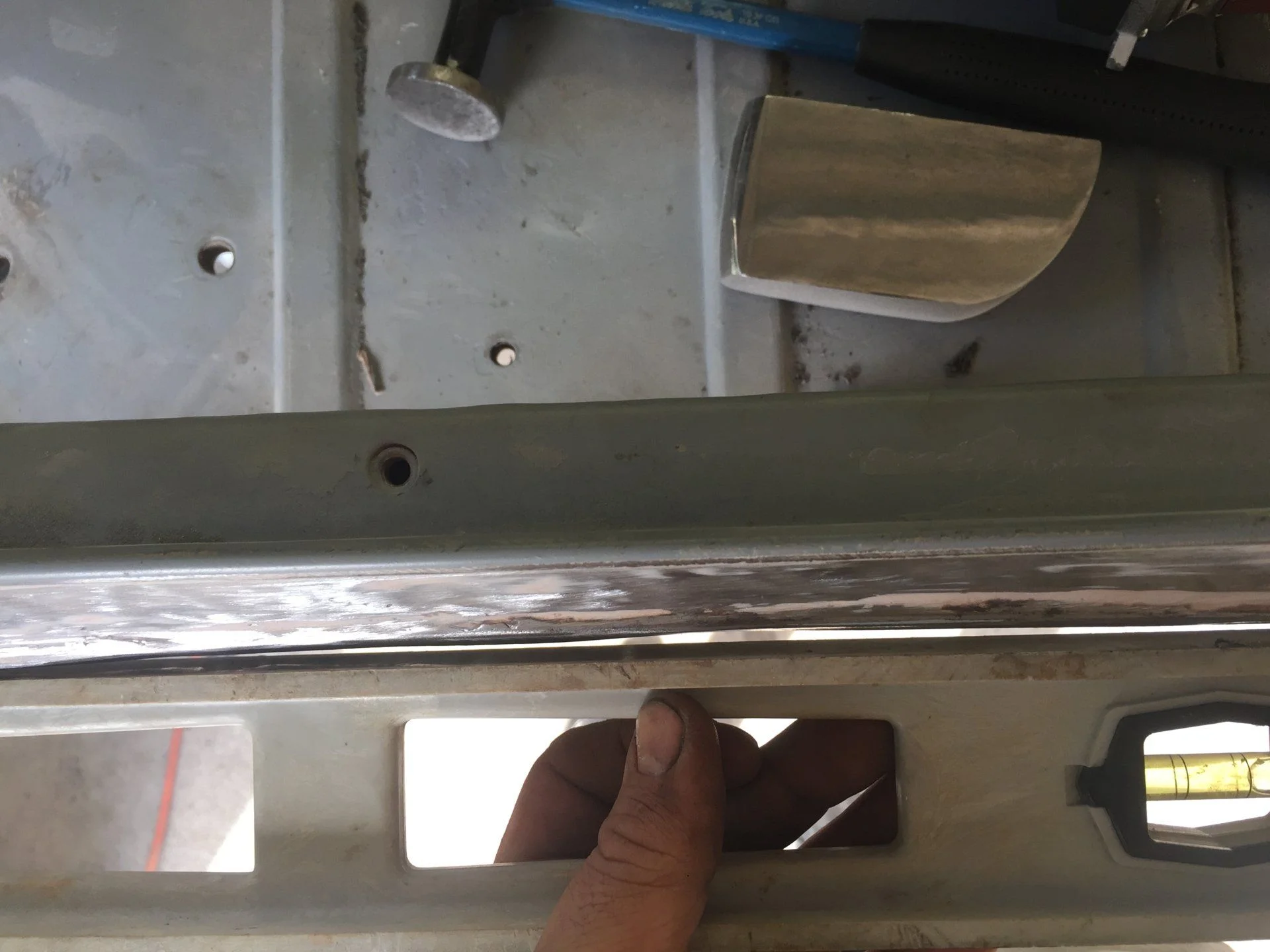

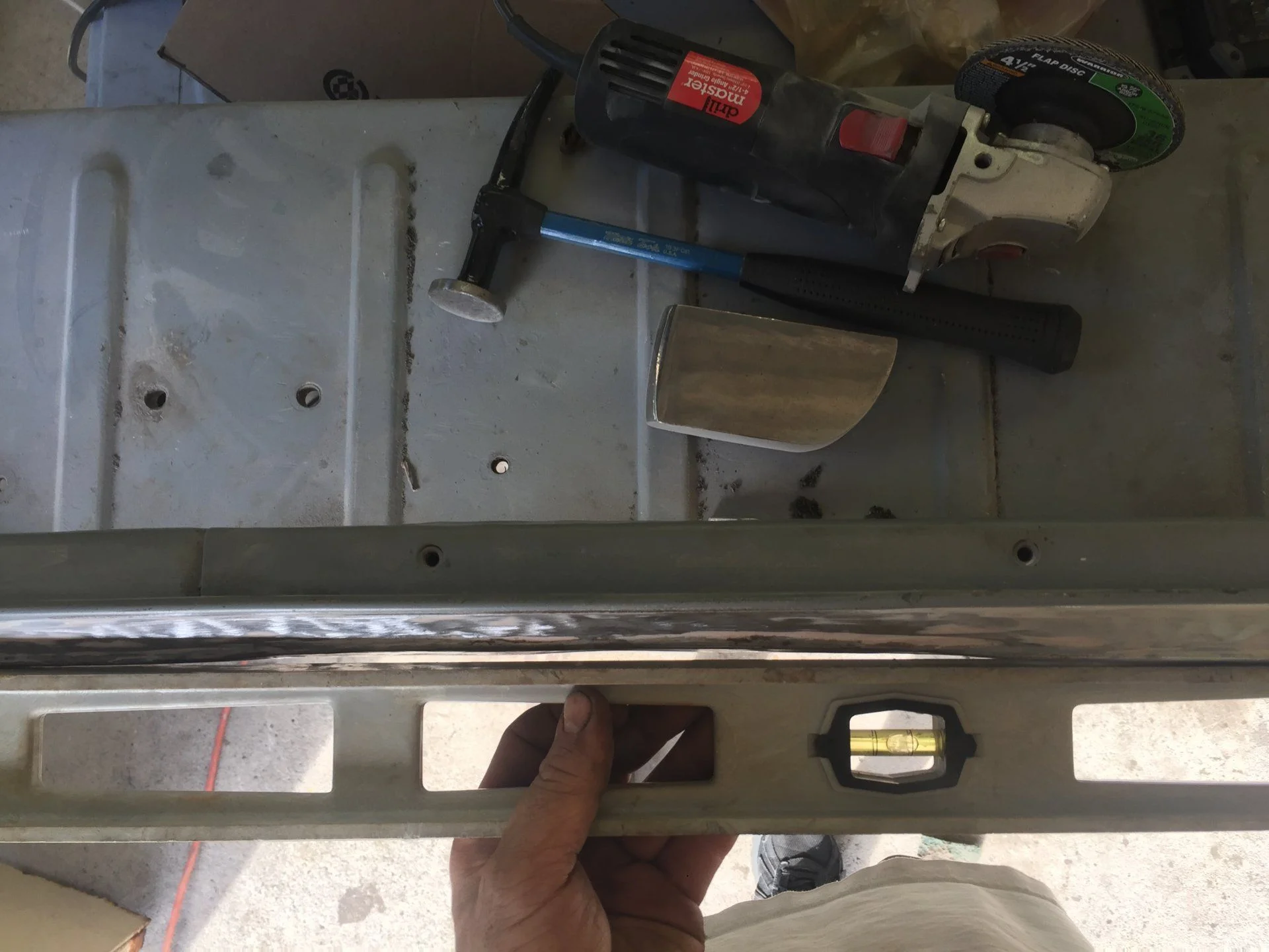

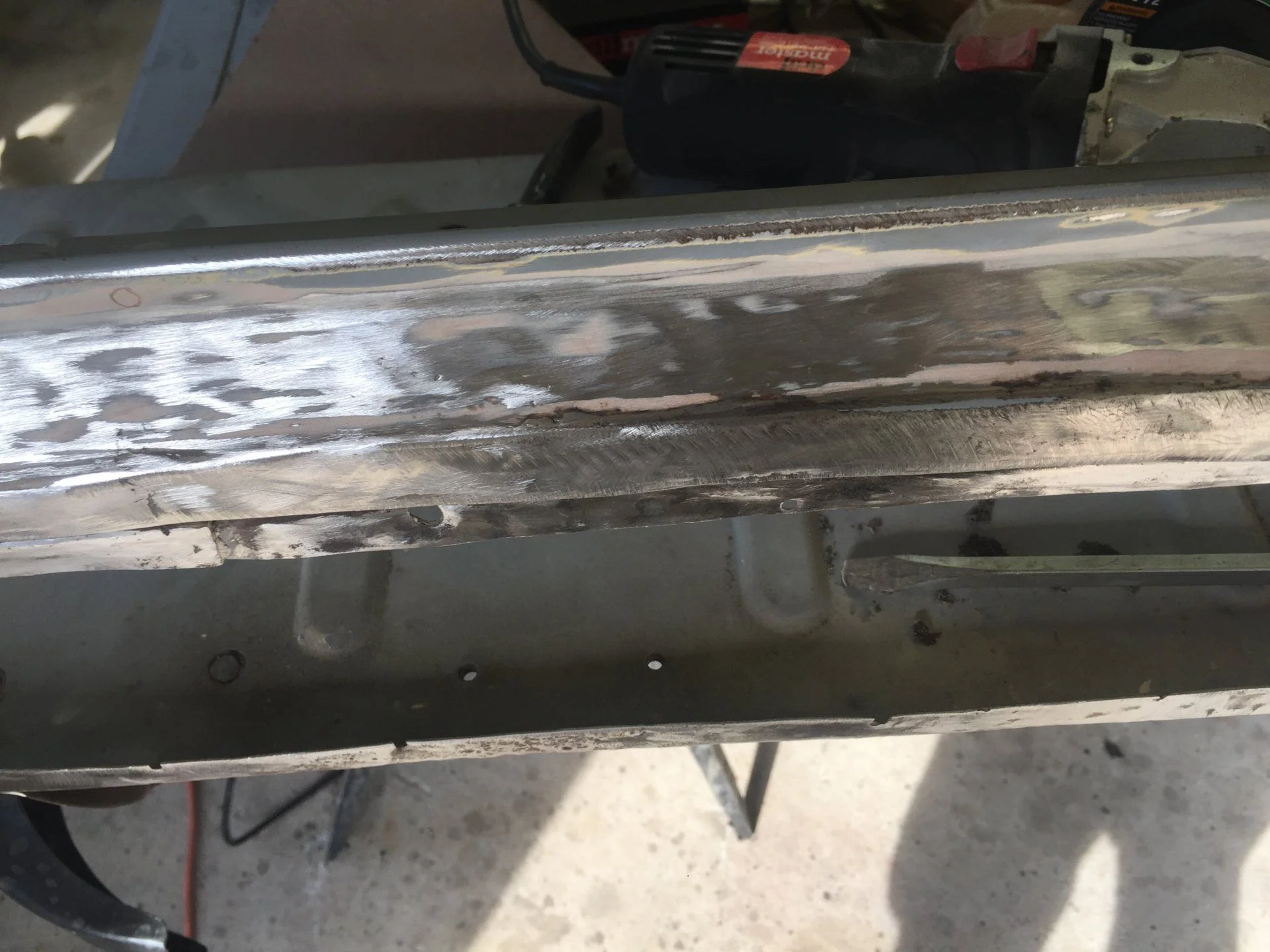

I now know why there was an inch of filler on a brand new panel. This tub must have been hit or side swiped. The top of the quarter panel has about a 12 -14 inch long dent. The rail is straight, but the panel is bent in. You can see light about 1/8 of an inch when I put a straight edge on it. I need to figure out a way to bend this back out????
Any suggestions?

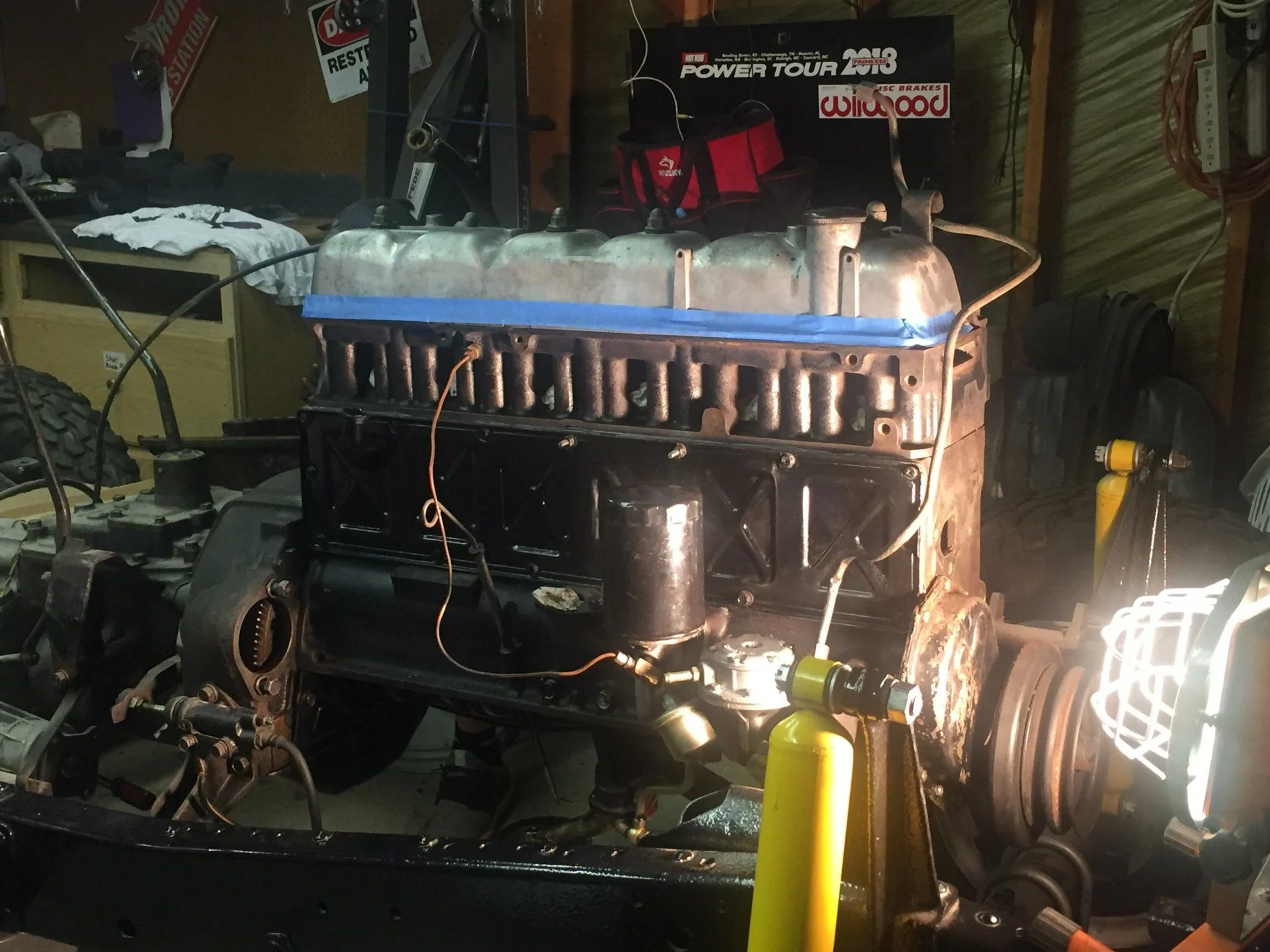

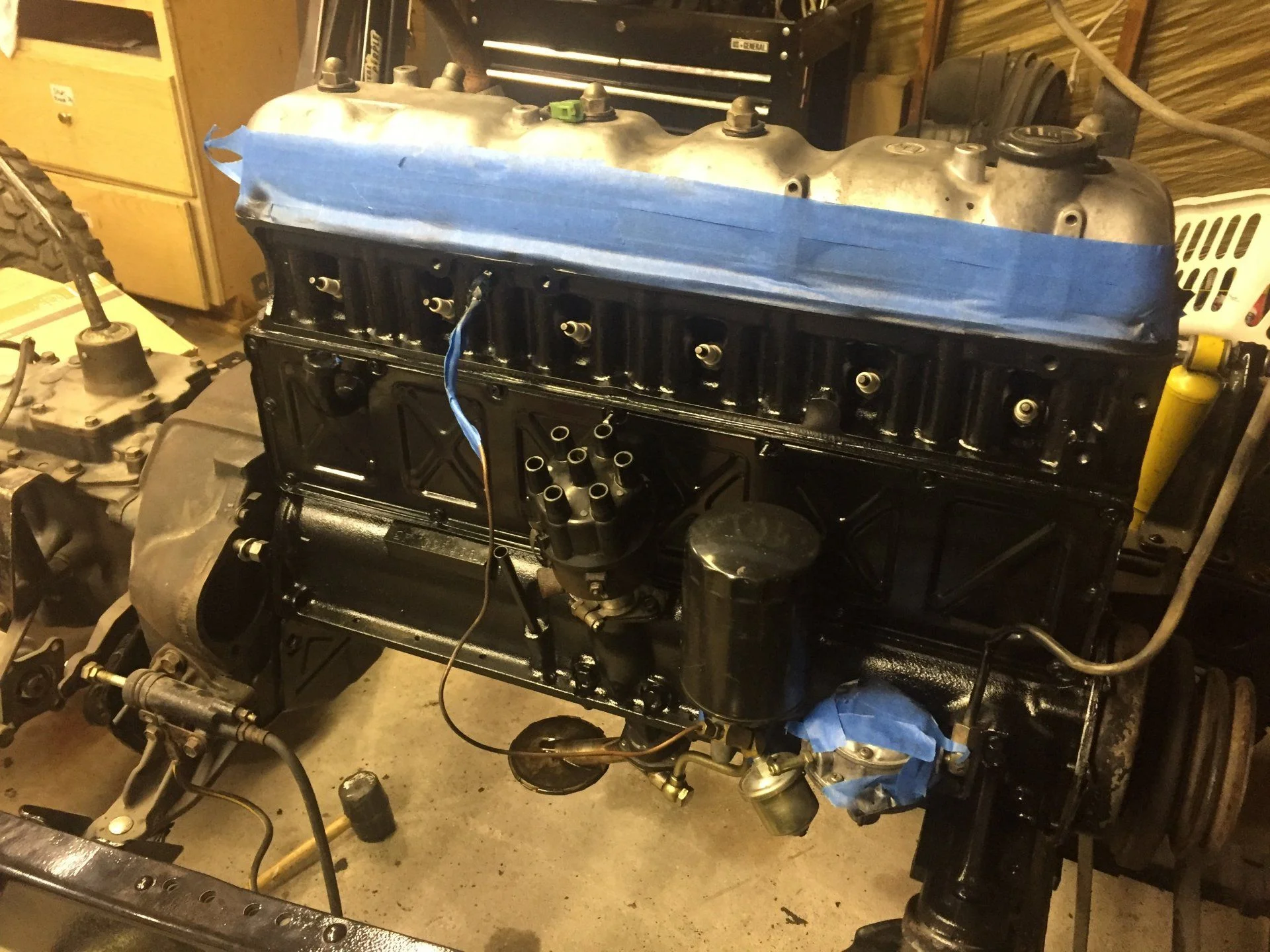

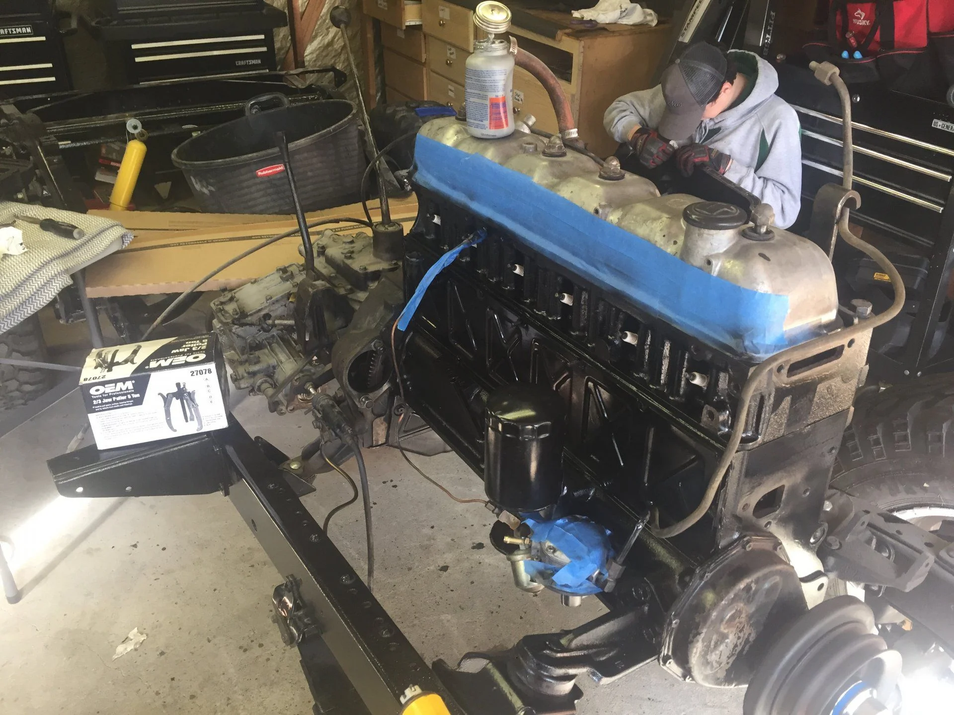

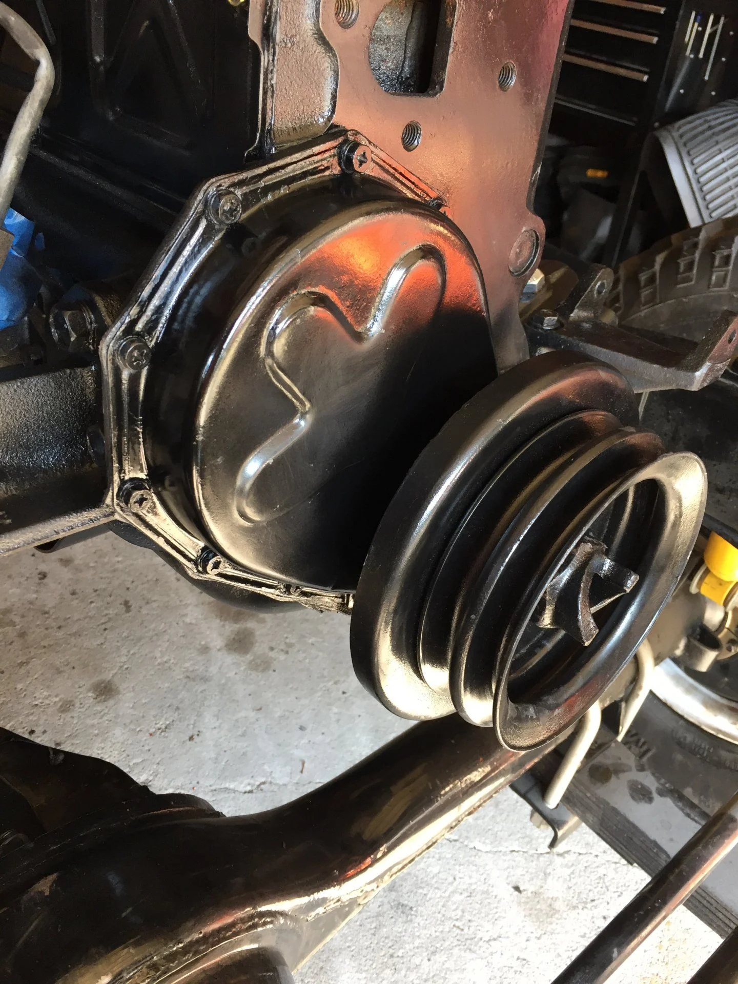

Decided to take a brake from the body and work on the engine today. I got the Fel-pro gasket kit and started replacing all the gaskets and painting the motor. It was a pretty good deal at AutoZone. $90. I had a $20 credit and a coupon. I got the whole set with everything for about $70. I am working on the video for YouTube now with all the details.
I pulled the push-rod cover off, cleaned it, painted it, put it on with a new gasket.

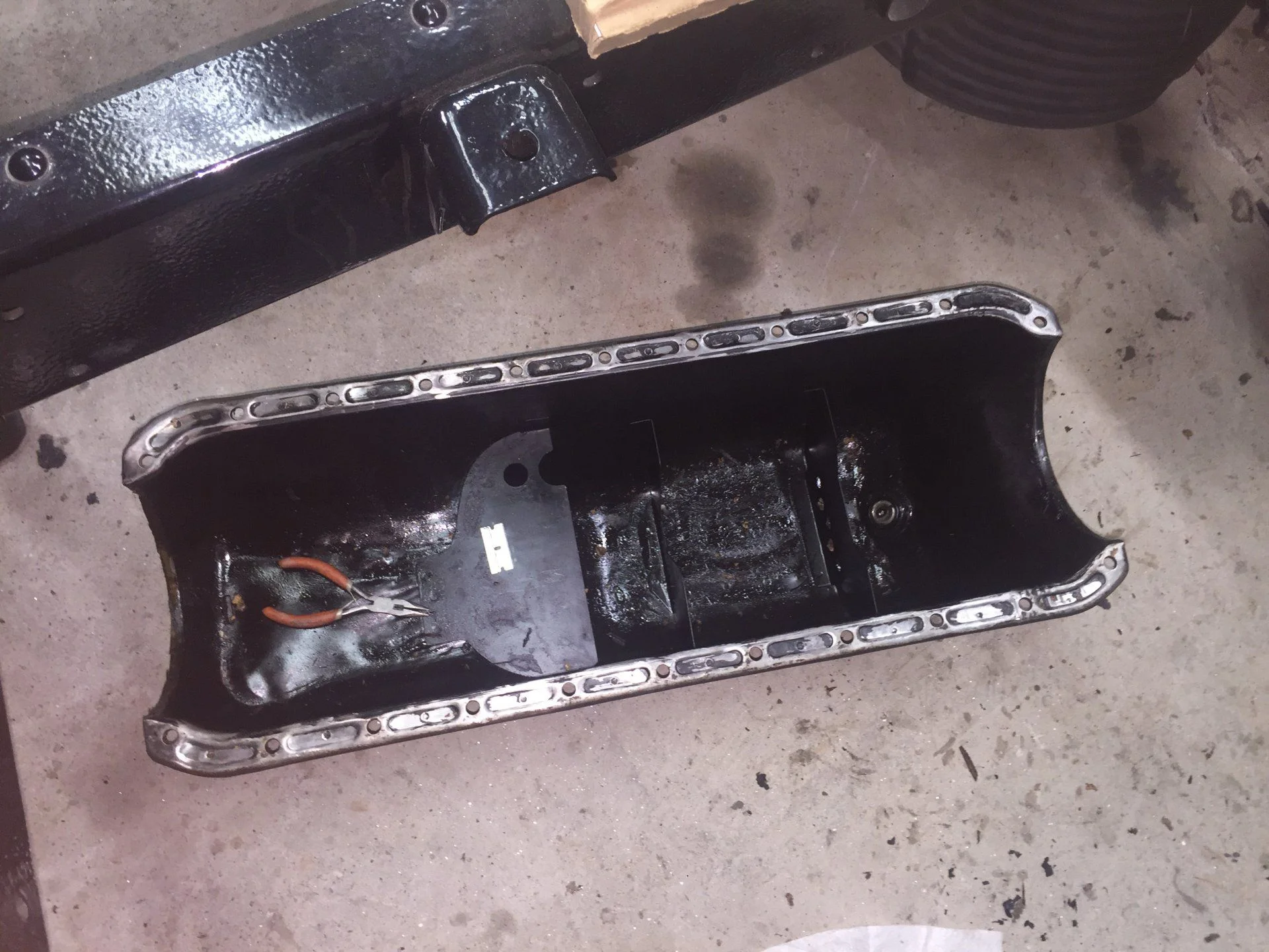

Pulled of the oil pan and I am planning to do the same (clean and paint it).

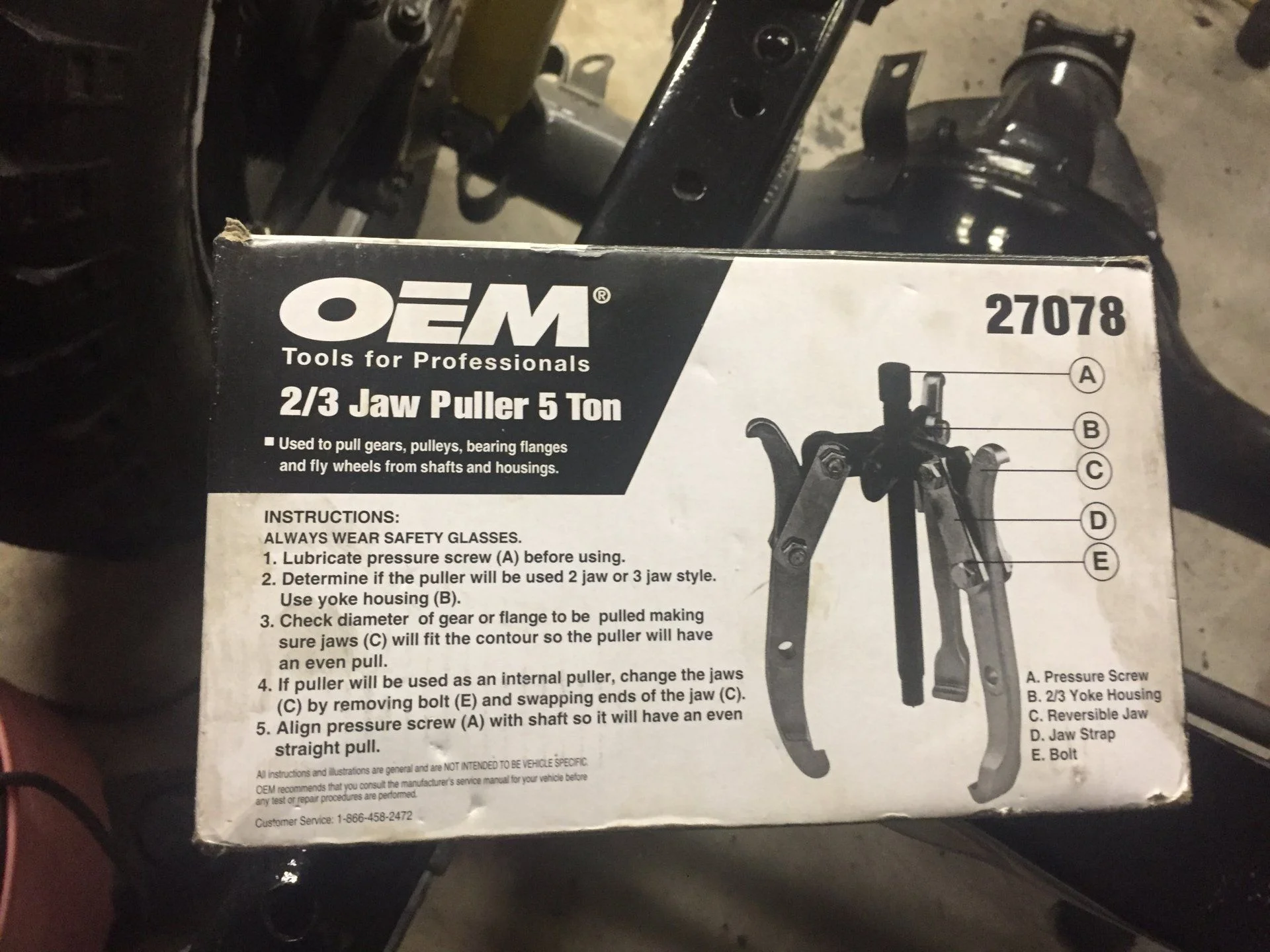

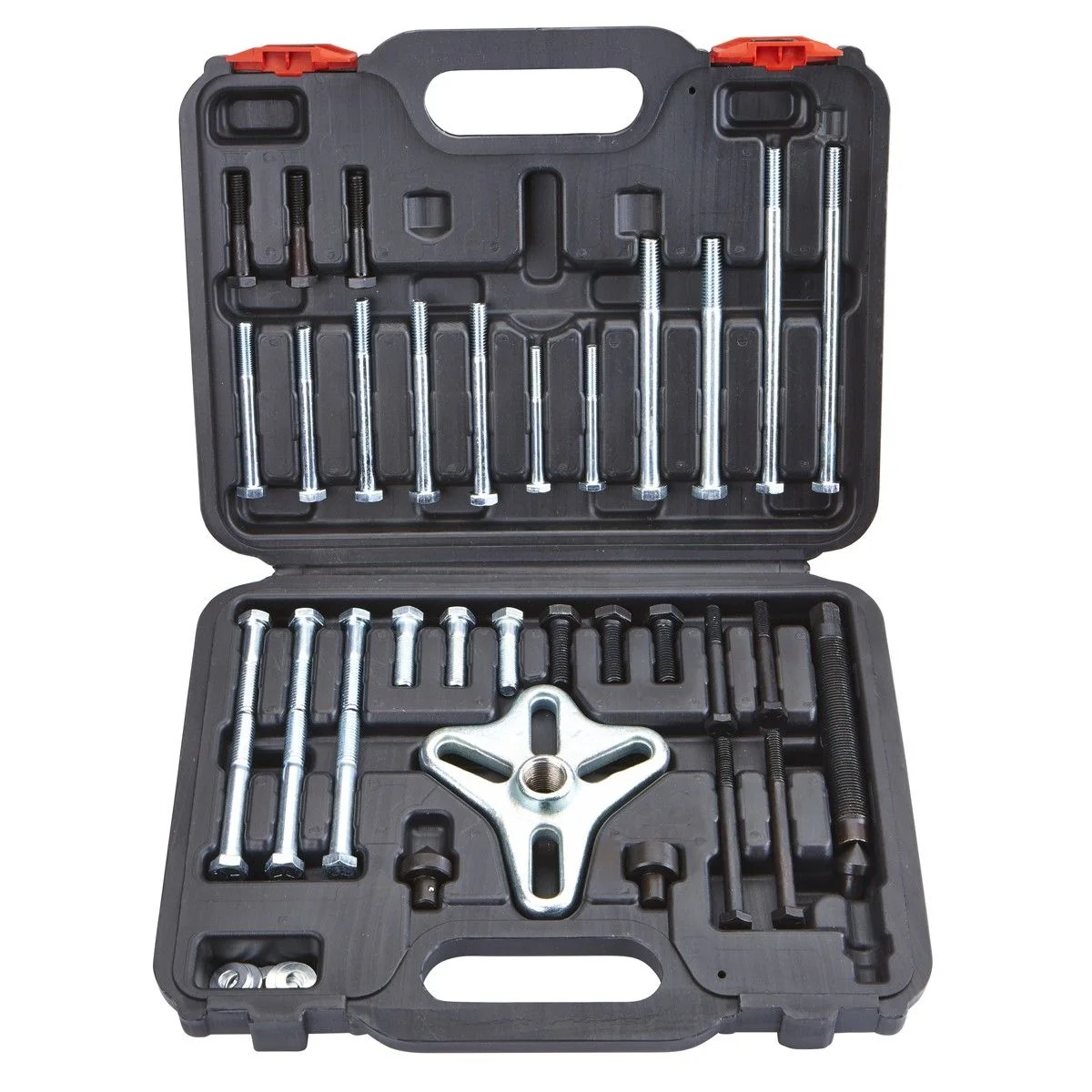

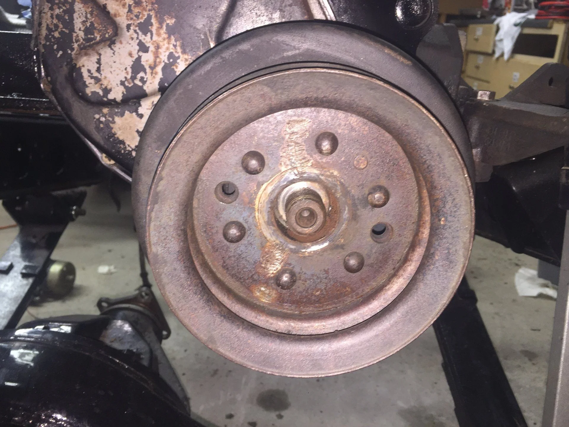

I was planning to pull the harmonic-balancer in off and replace the front seal and timing gasket, but I got the wrong puller. I will need to get the correct one tomorrow.
Here is the is the puller I should have gotten. I will get it tomorrow.
I'd recommend using the Toyota one-piece oil pan gasket instead of the Fel-Pro gasket.
The Fel-Pro gasket is one piece... do you still recommend the Toyota one?

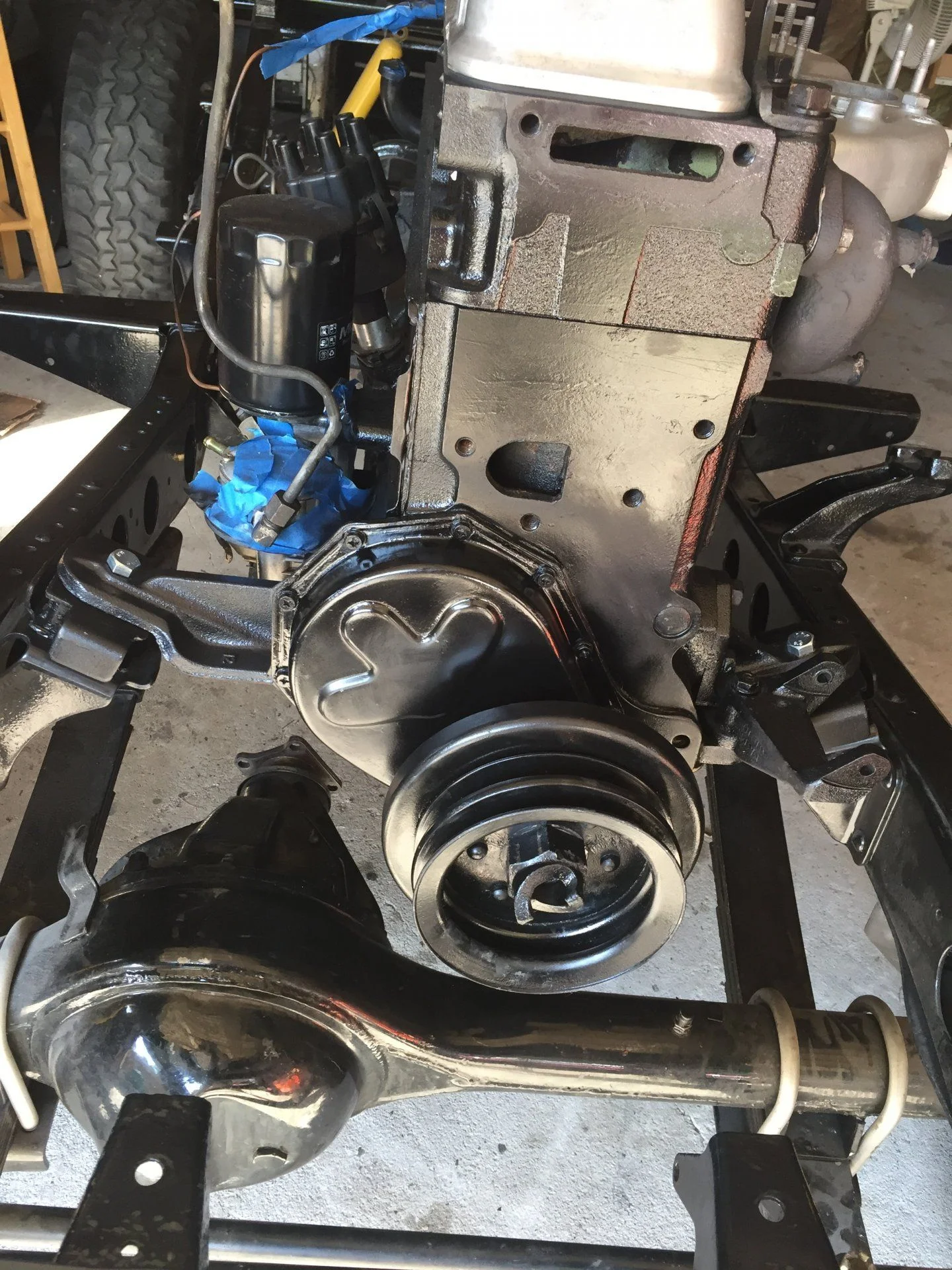

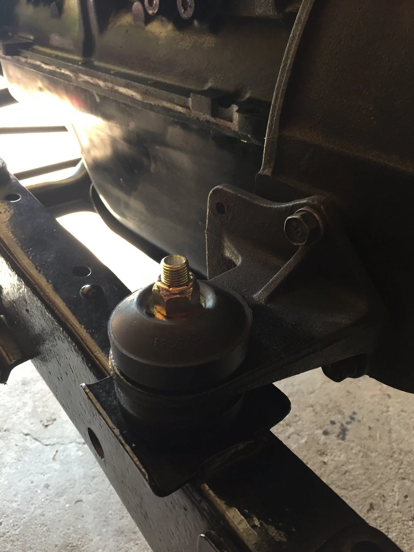

I had to replace the timing cover gasket twice because I committed the common mistake of tightening the bolts too tight :( I know better than that and still got impatient and didn't use a torque wrench. This was a good lesson for me and my kids to remember that it is better to do the job right the first time and not have to do it a second time. I also installed the new motor mounts I got from SOR and scrubbed the trans and transfer case and coated them with new coat of paint. I will add some more pics later today.

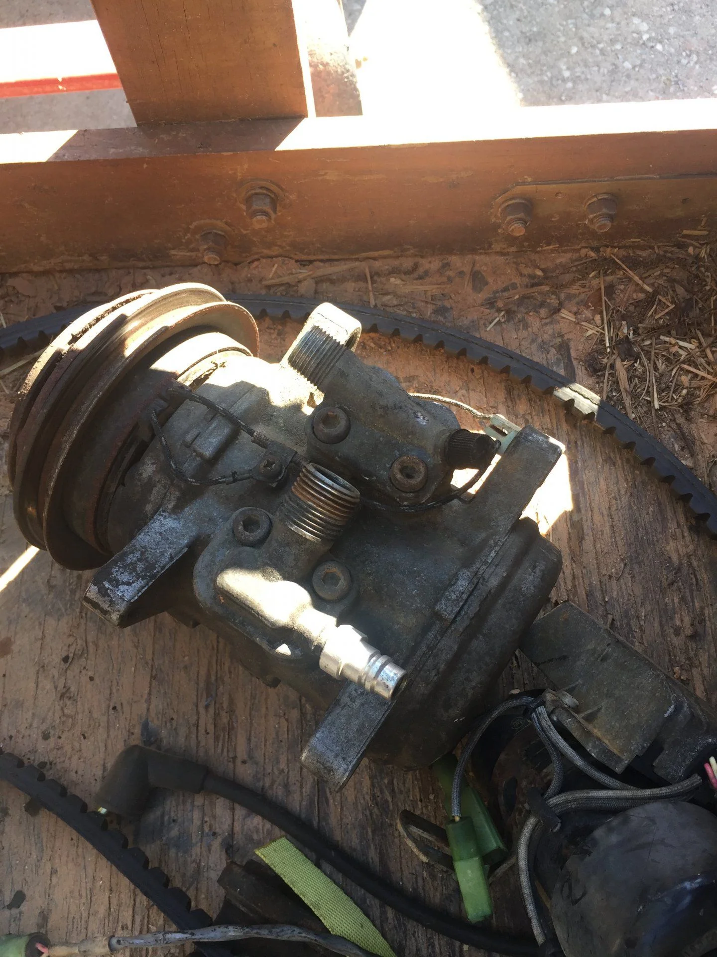

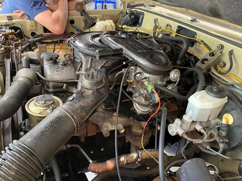

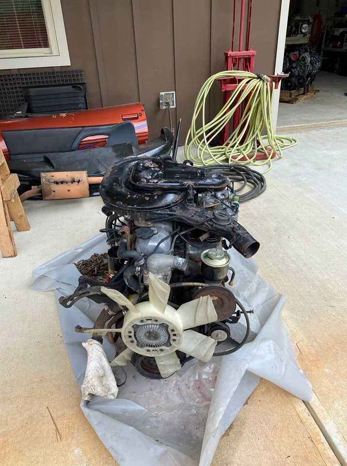

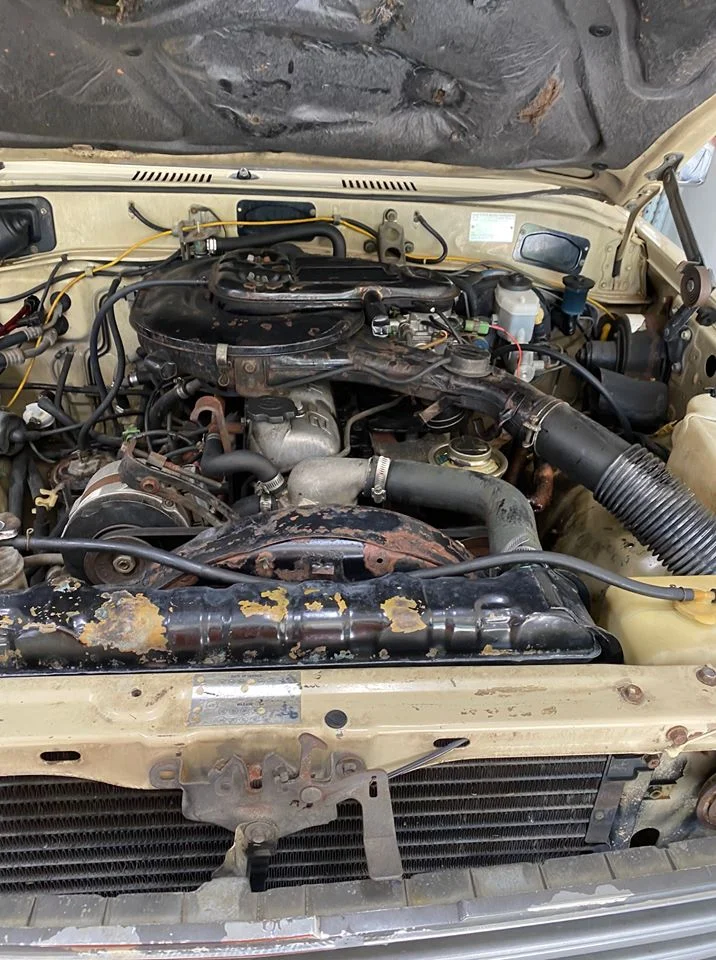

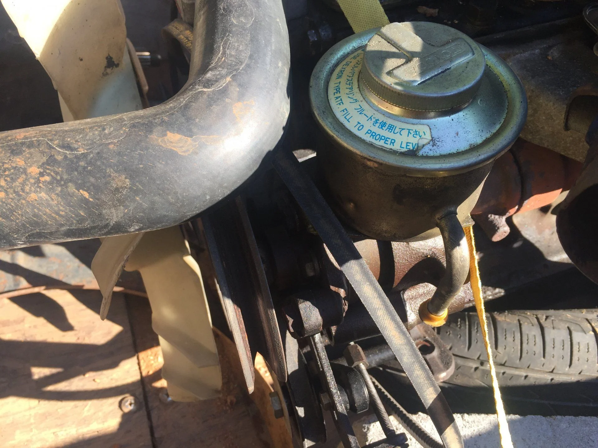

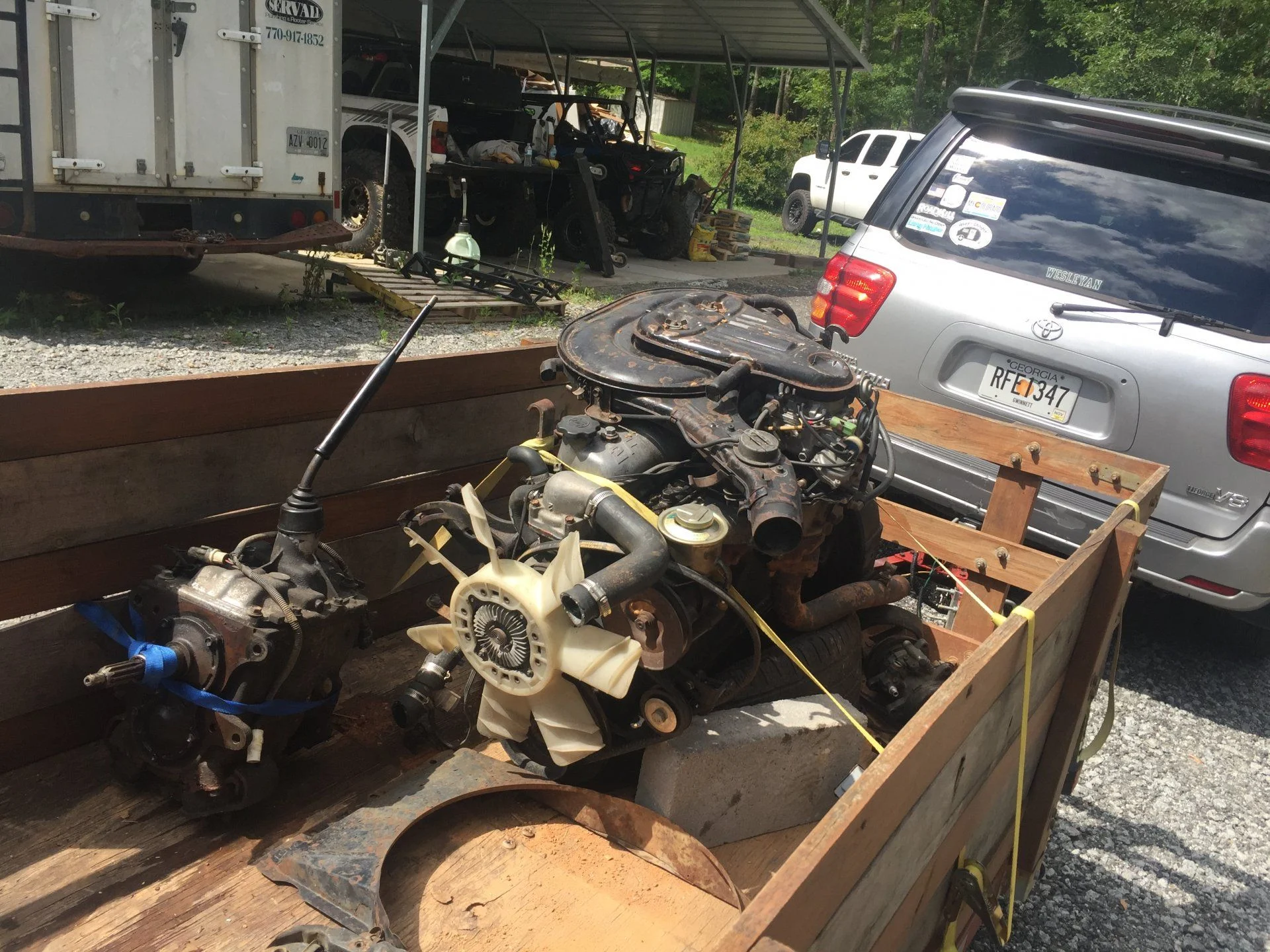

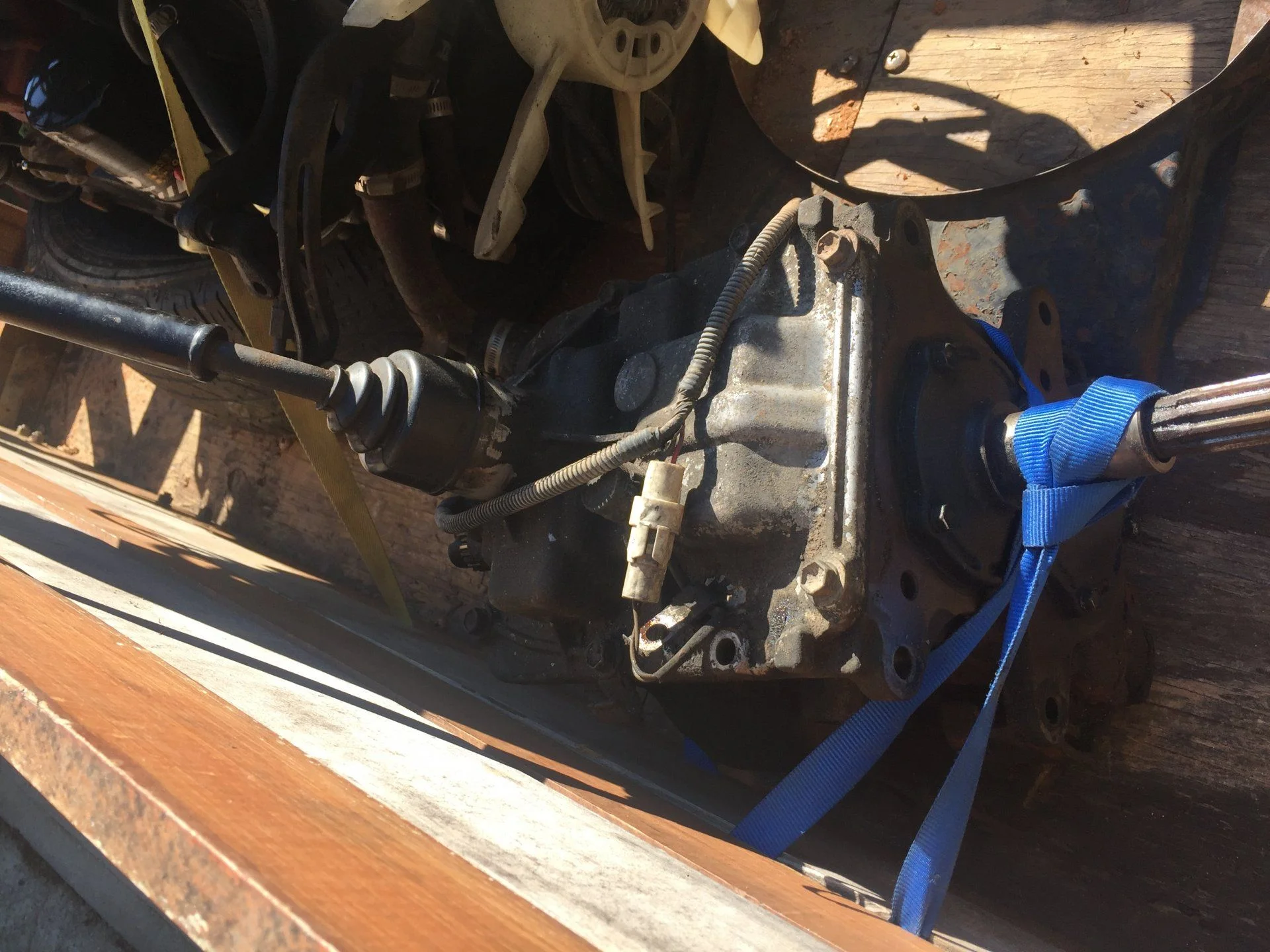

I got a "back up" 2F motor. My plan still is to get the original motor running, but when I get ready to rebuild it, I can put is and pop this one in so I can keep the FJ40 on the road while I am rebuilding it. This one runs and is from a 1984 FJ40. I got the motor, 4 speed trans, (I did not get the transfer case) and all the goodies. I also got some free parts with it.
Here are a few pics.

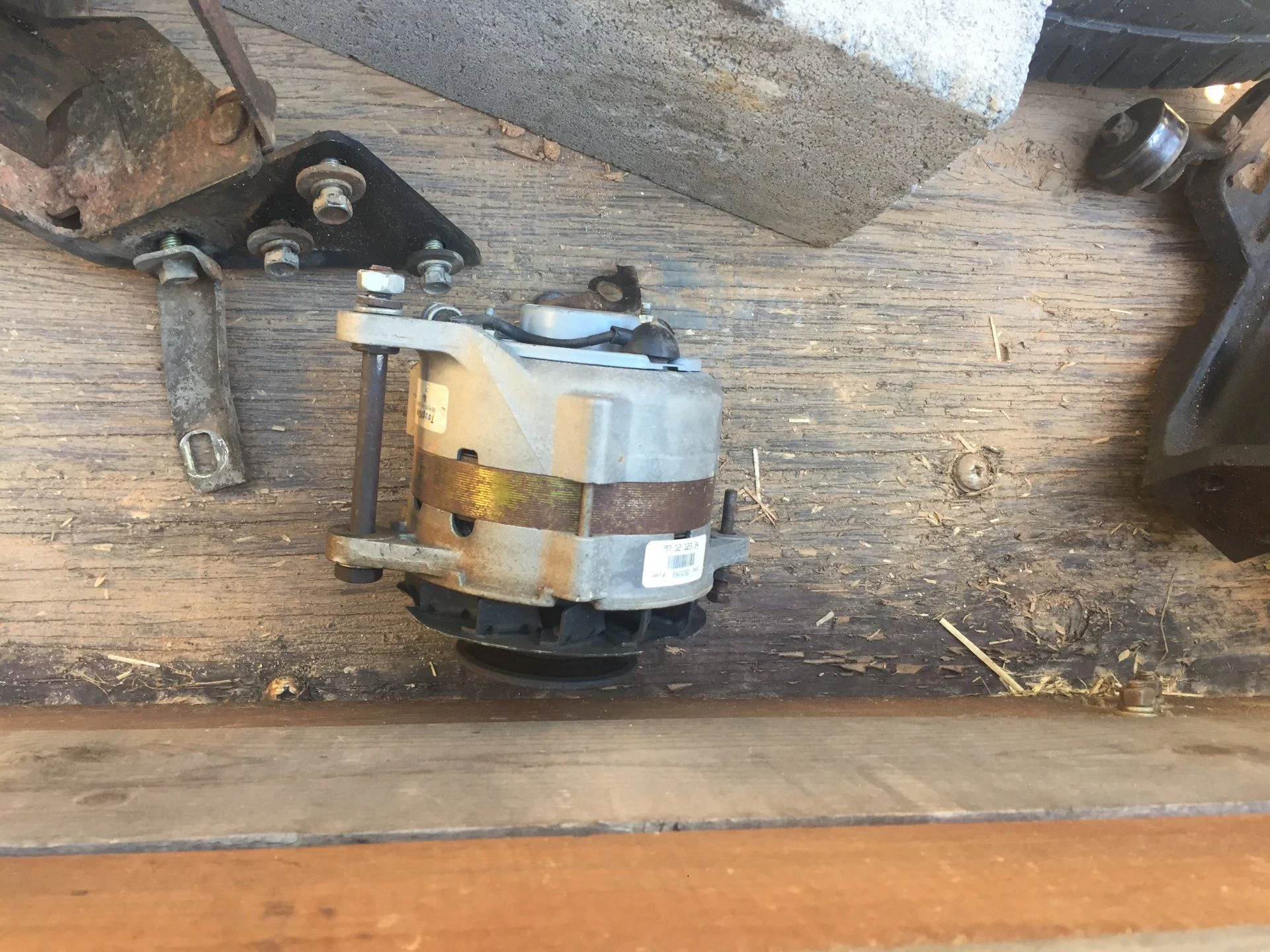

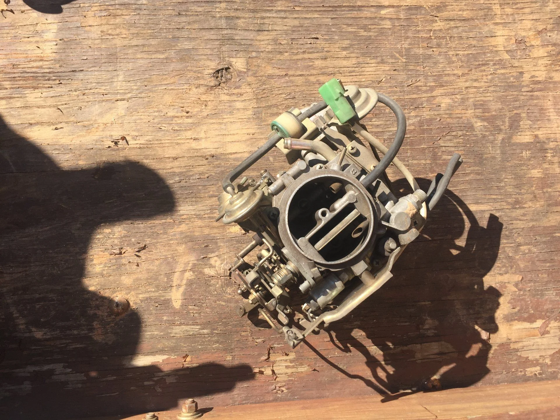

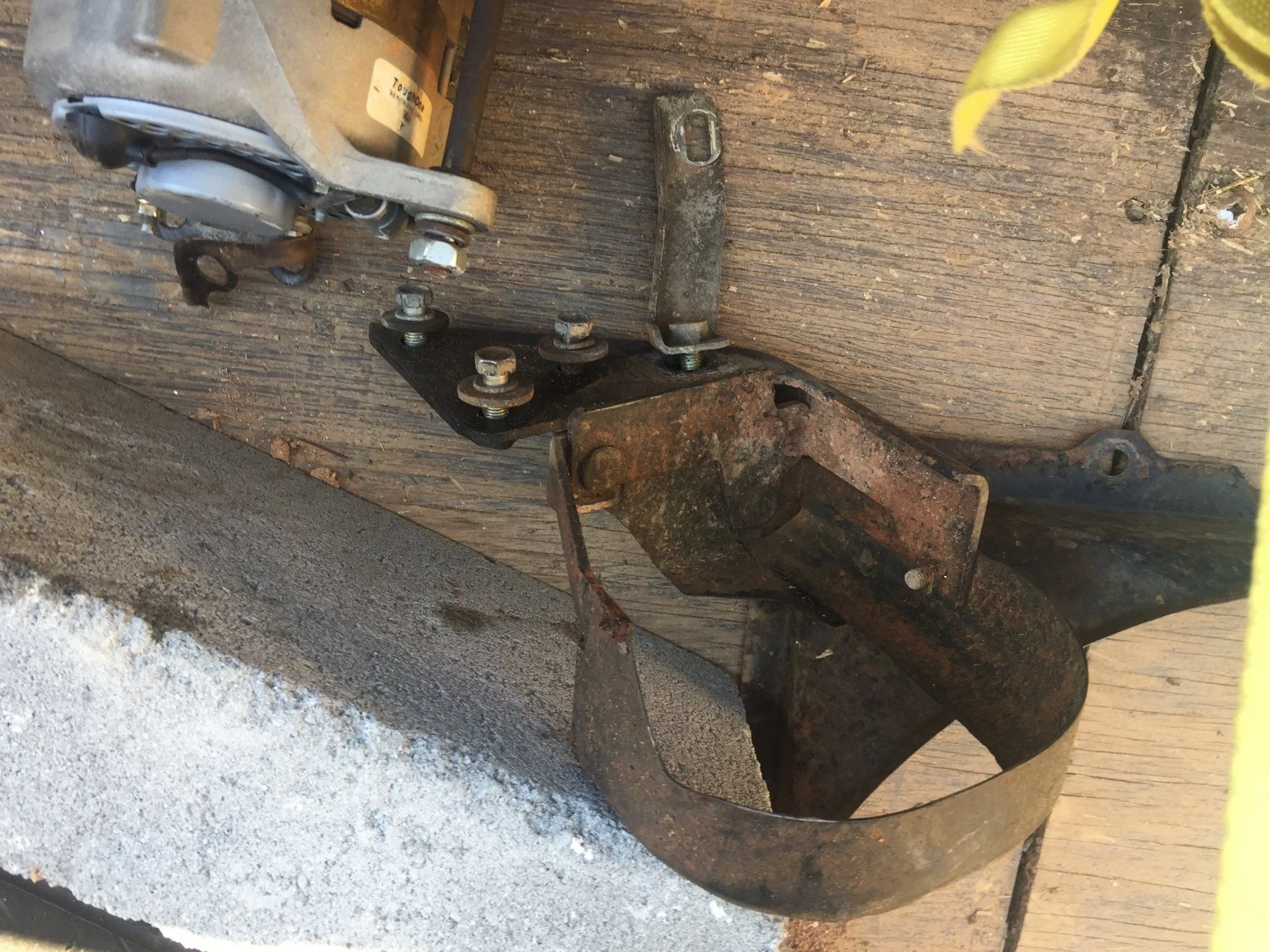

The guy I got it from had some left over parts that he gave me for free. He is putting a 6.0 LS motor in the 84 FJ60 he pulled the 2F motor out of. I am planning to sell the FJ60 4 speed transmission, radiator, fan shroud, AC compressor, extra carb, and maybe the power steering pump and bracket to recoup some of the money I spent on the motor.

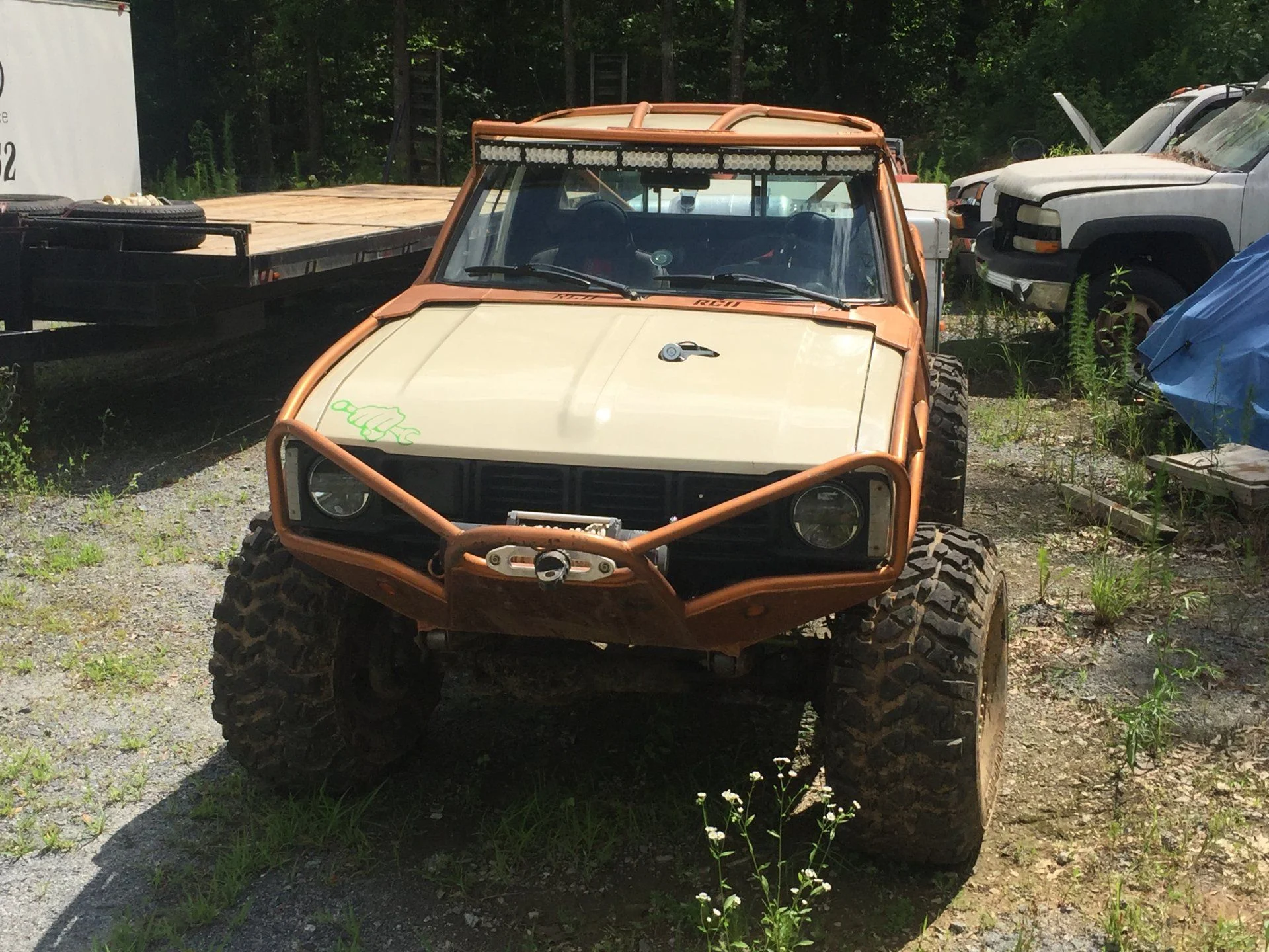

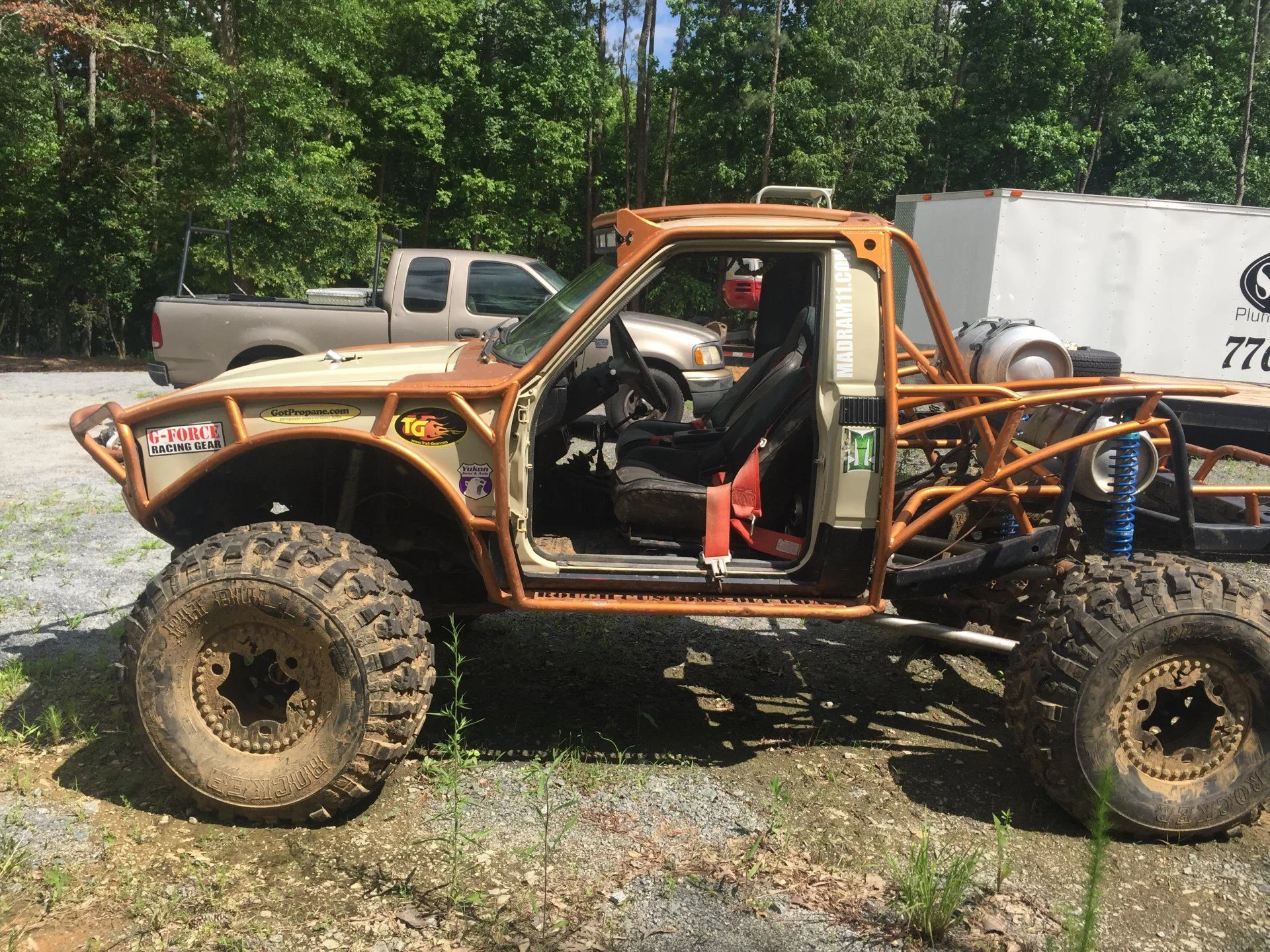

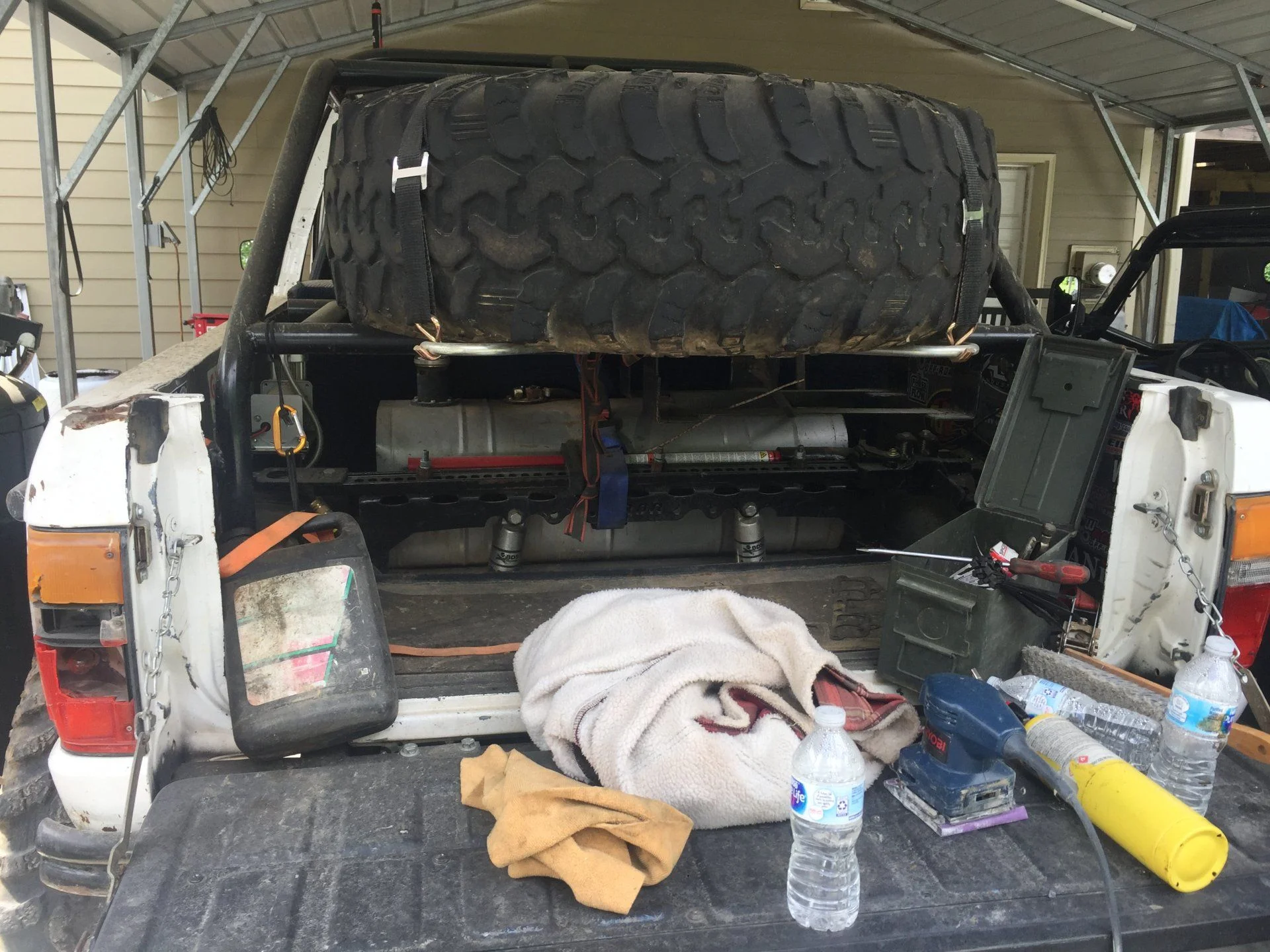

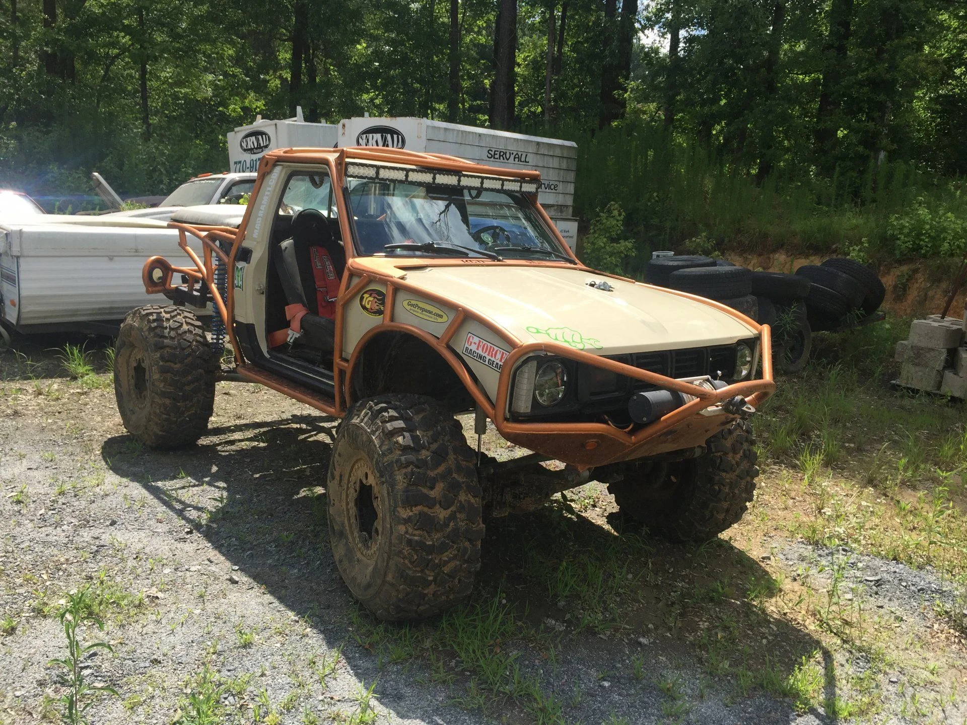

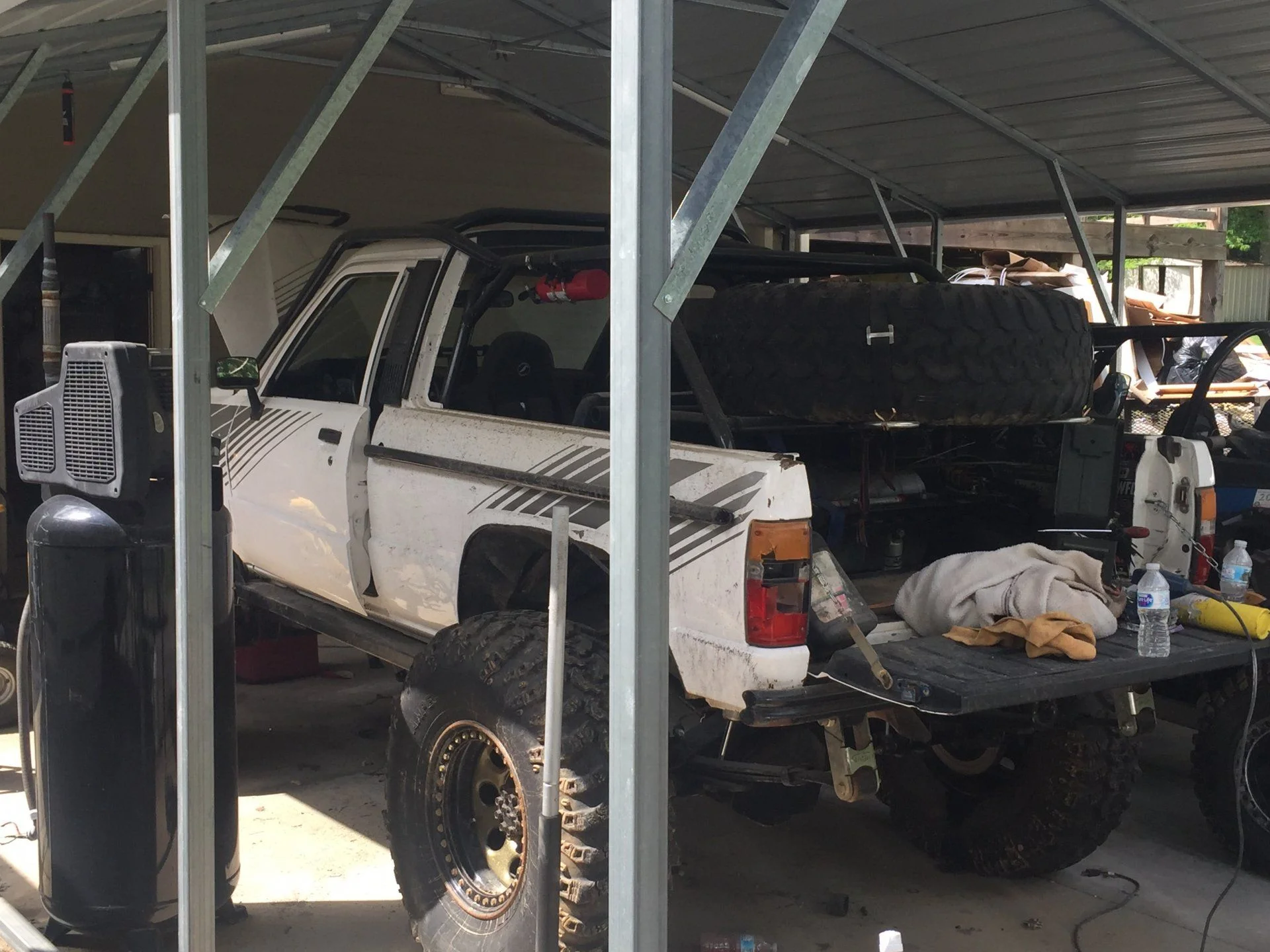

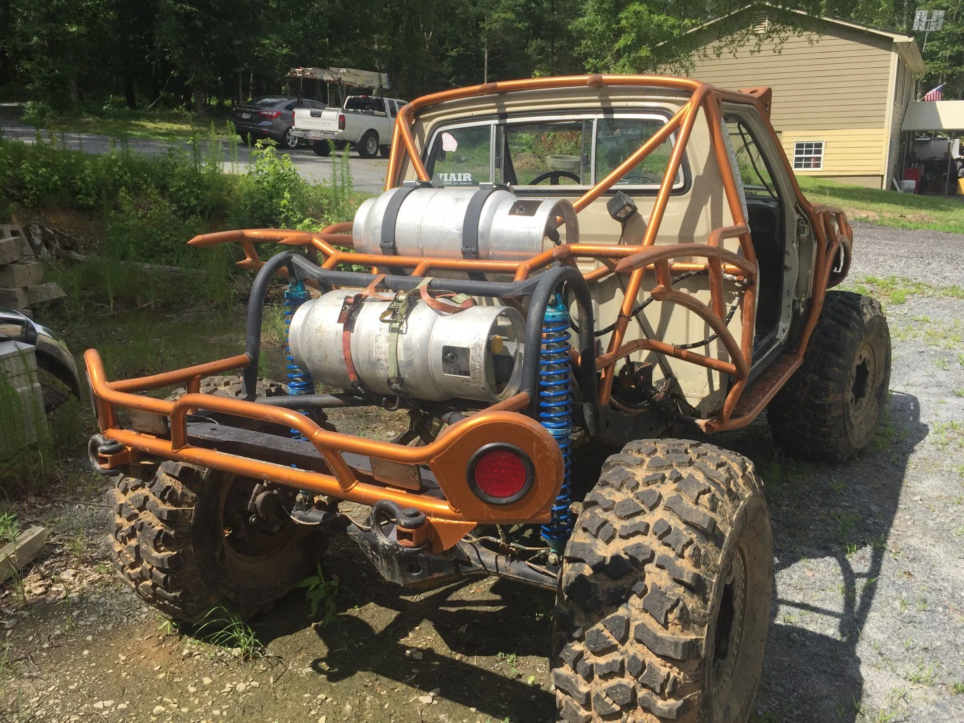

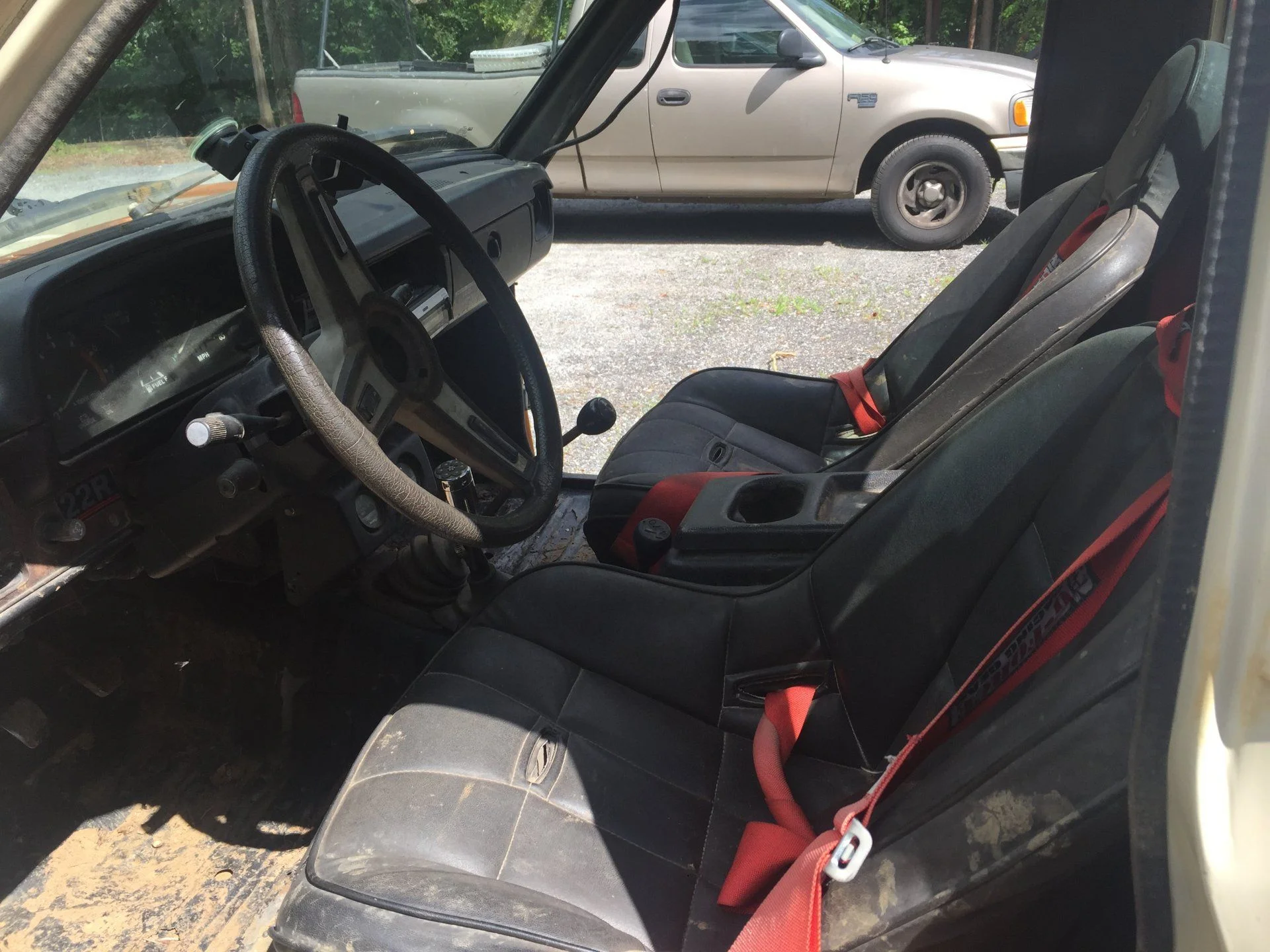

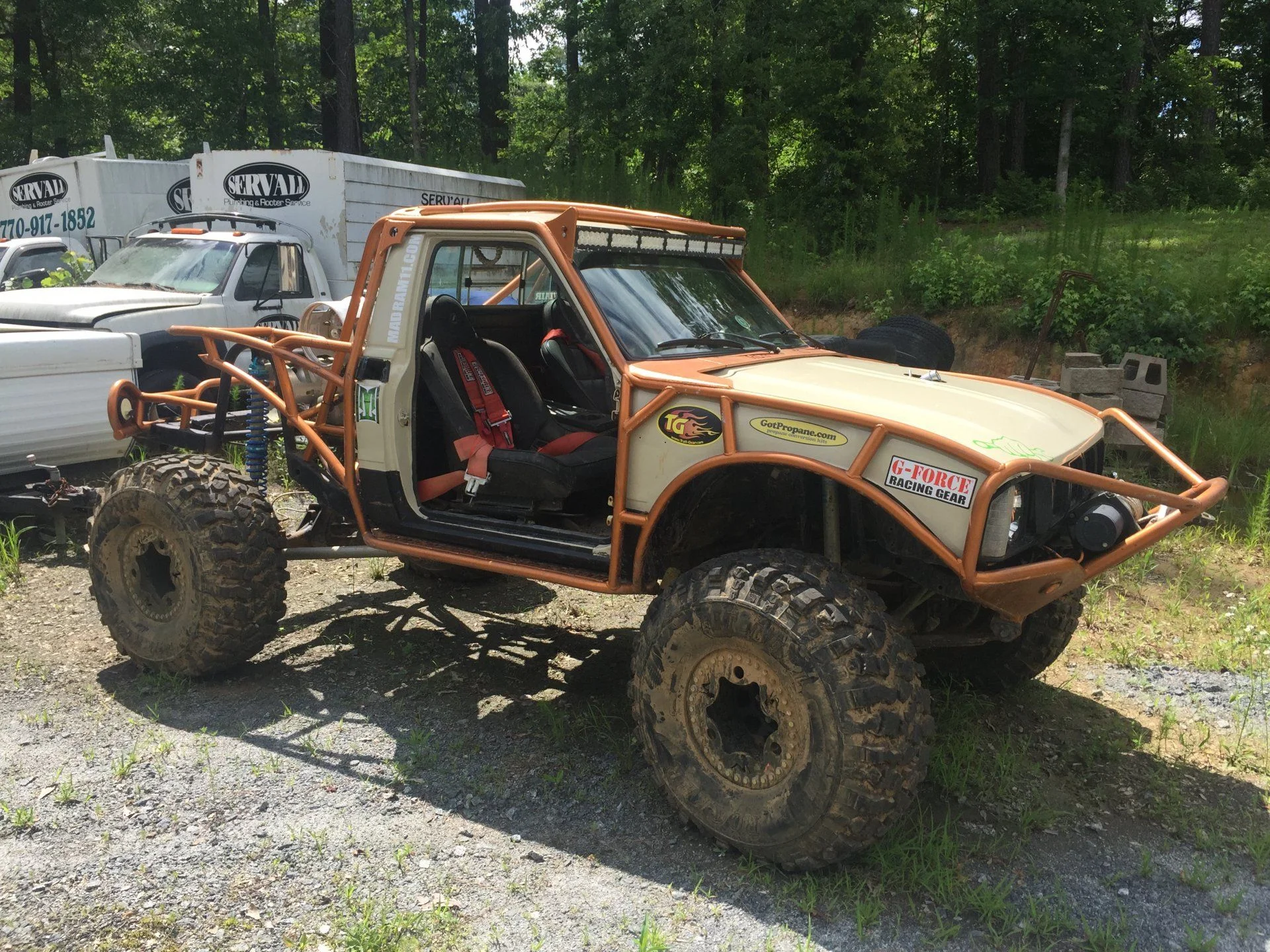

The guy I got my 2F motor from had some AWESOME Toyota rock crawlers along with his FJ60 LS 6.0. Here are a few pics.
More pics...
1 gen 4Runner :)
