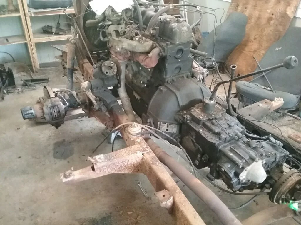

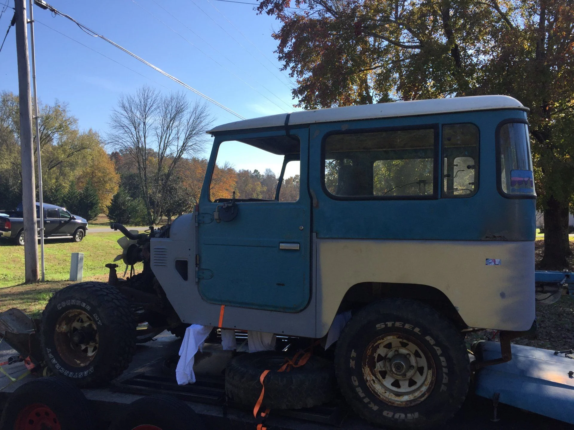

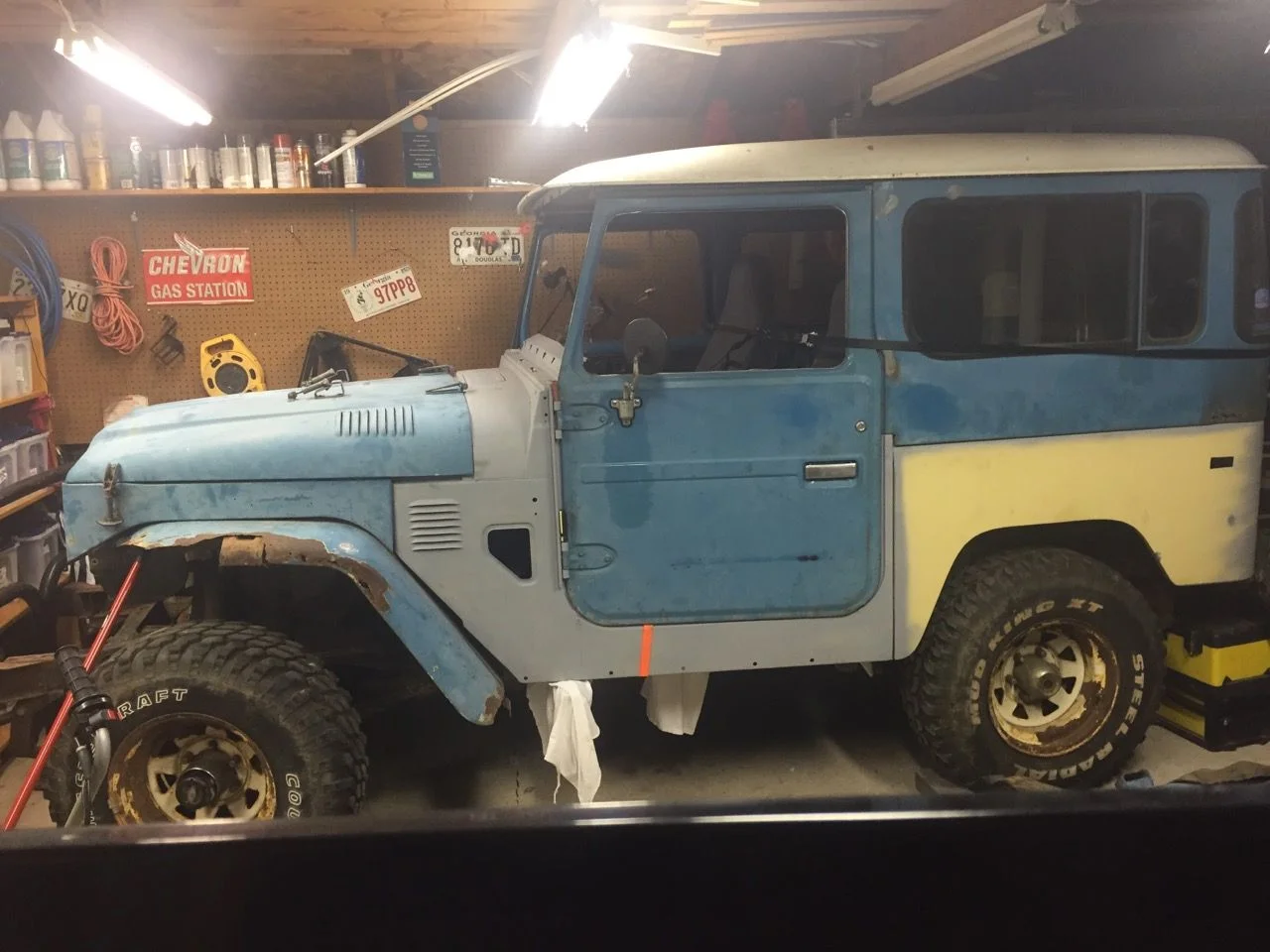

Here is how it looked when I showed up to get her...

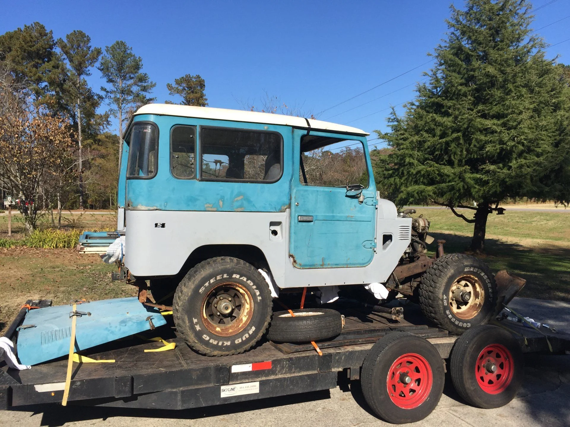

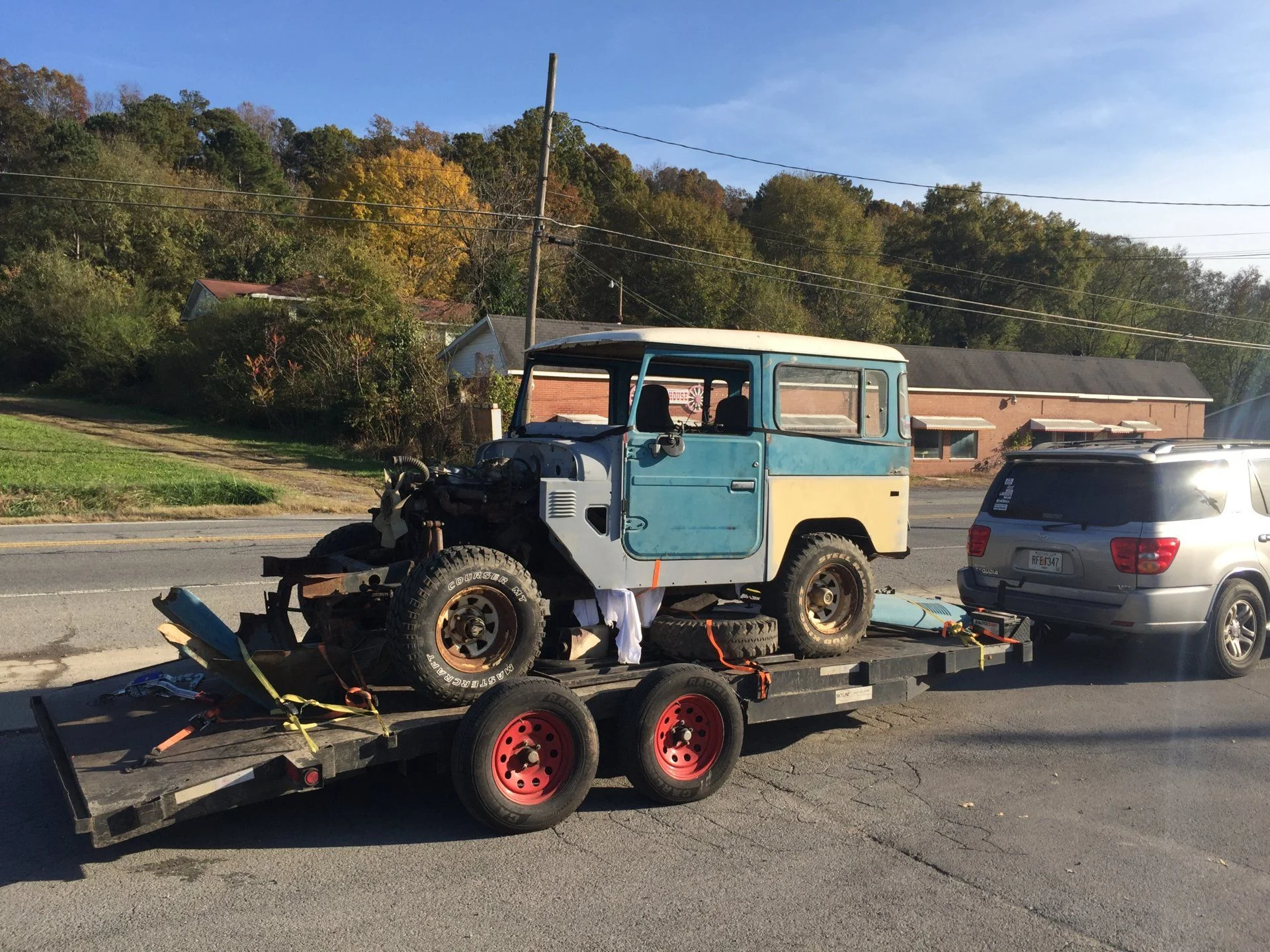

I live in Atlanta, GA and it was up by Chattanooga TN. I rented a trailer and drove about 2.5 hours away with a good friend who is restoring a 1980 FJ40 and his son to pick it up. We had a great time and had some of the best BBQ I have ever tasted (Thatcher's BBQ). We also created some good memories which is goal #1 :)

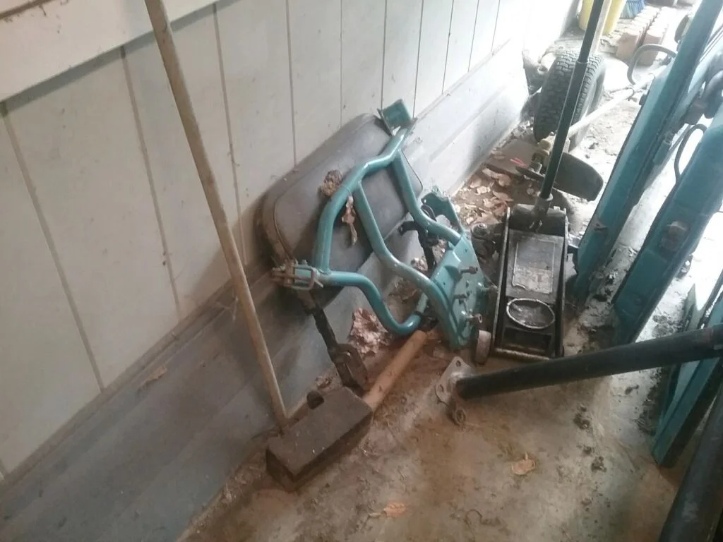

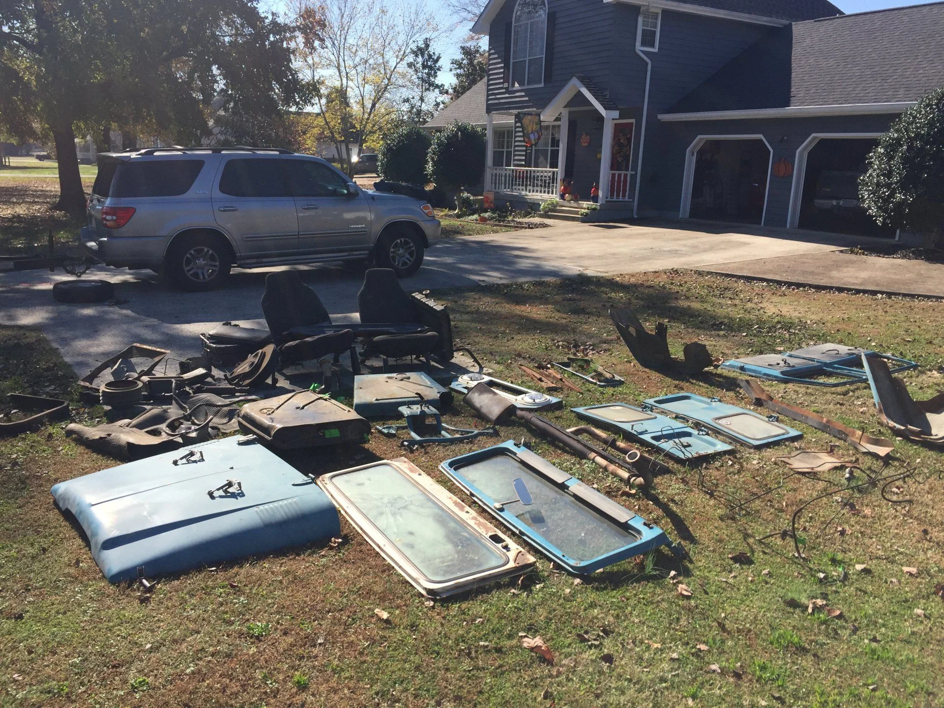

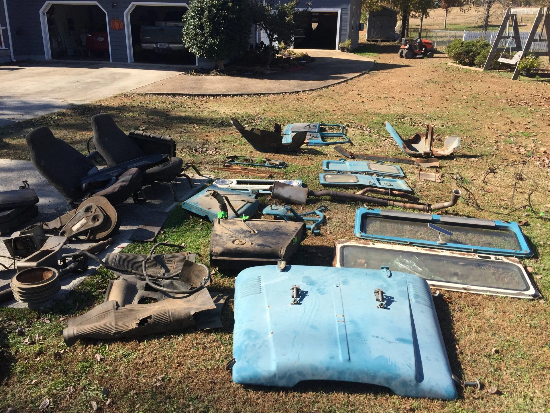

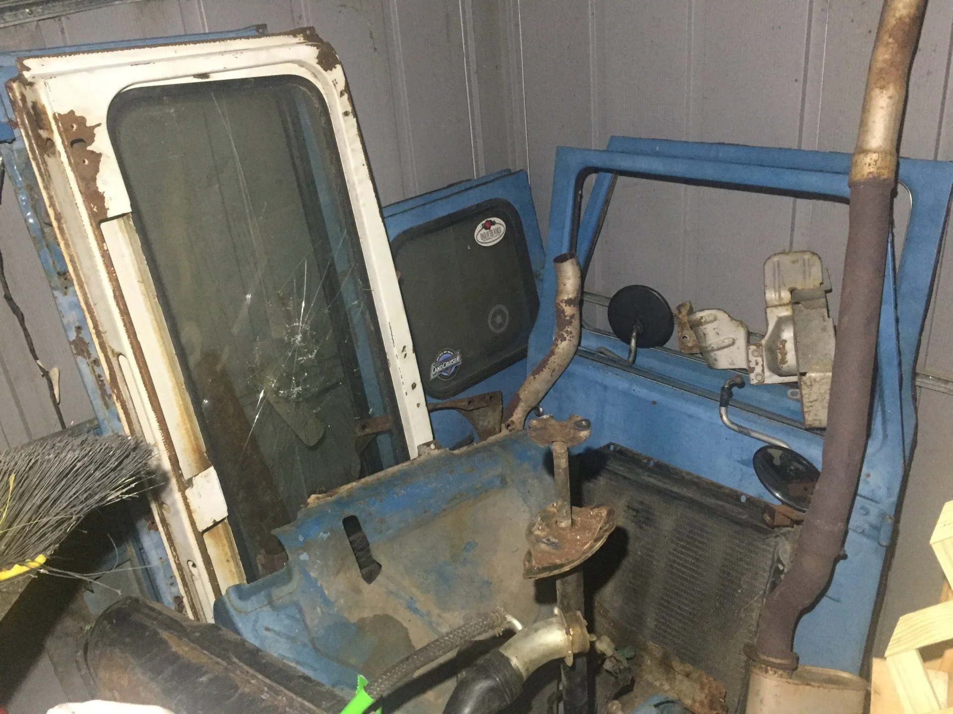

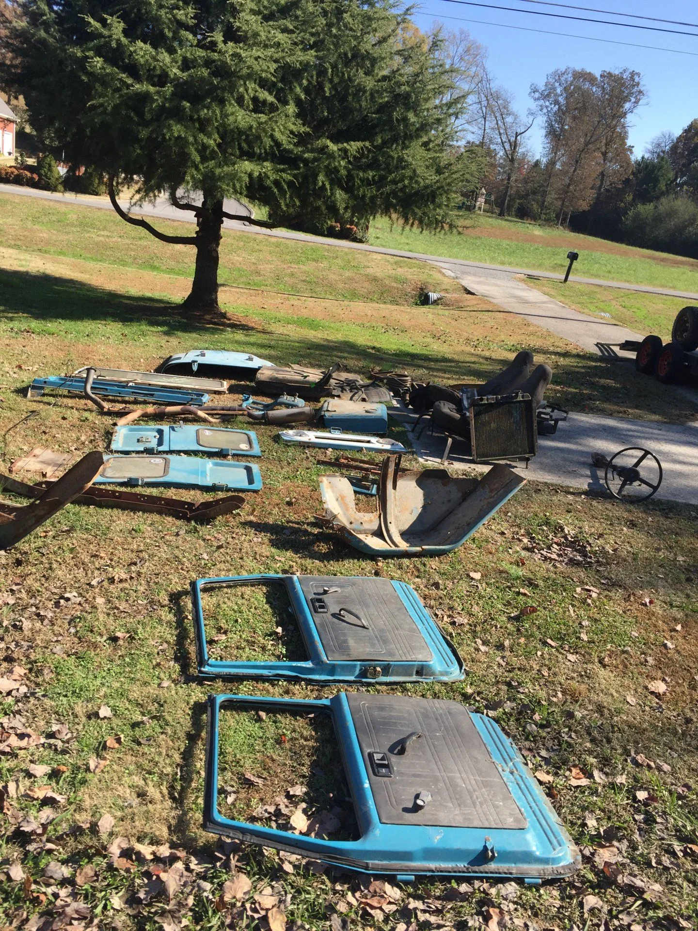

Here is what it looked like when we got all the parts out of the shop and into the sun light. It was like Christmas for me!! :)

We put it back together enough to load it on the trailer and ratchet strapped everything down. 2.5 hours back home with a short pit stop at the BBQ place!
PS - My Sequoia pulled it like a champ!!! That is the first time I have pulled something this heavy and it did great. I don't have electric breaks so I made sure to leave lots of room in front of me, but it stopped GREAT. I drove about 65 on the highway and you could hardly tell it was there. The only time I could really tell is when accelerating from a complete stop. I had to give it a little extra gas, but no problem at all. I LOVE TOYOTA!!!

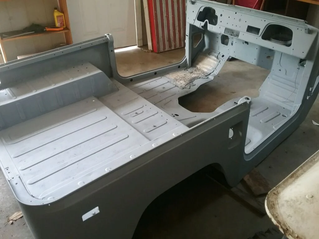

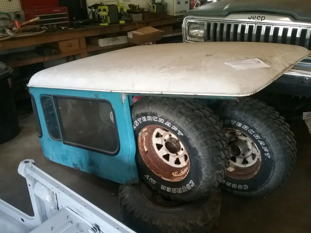

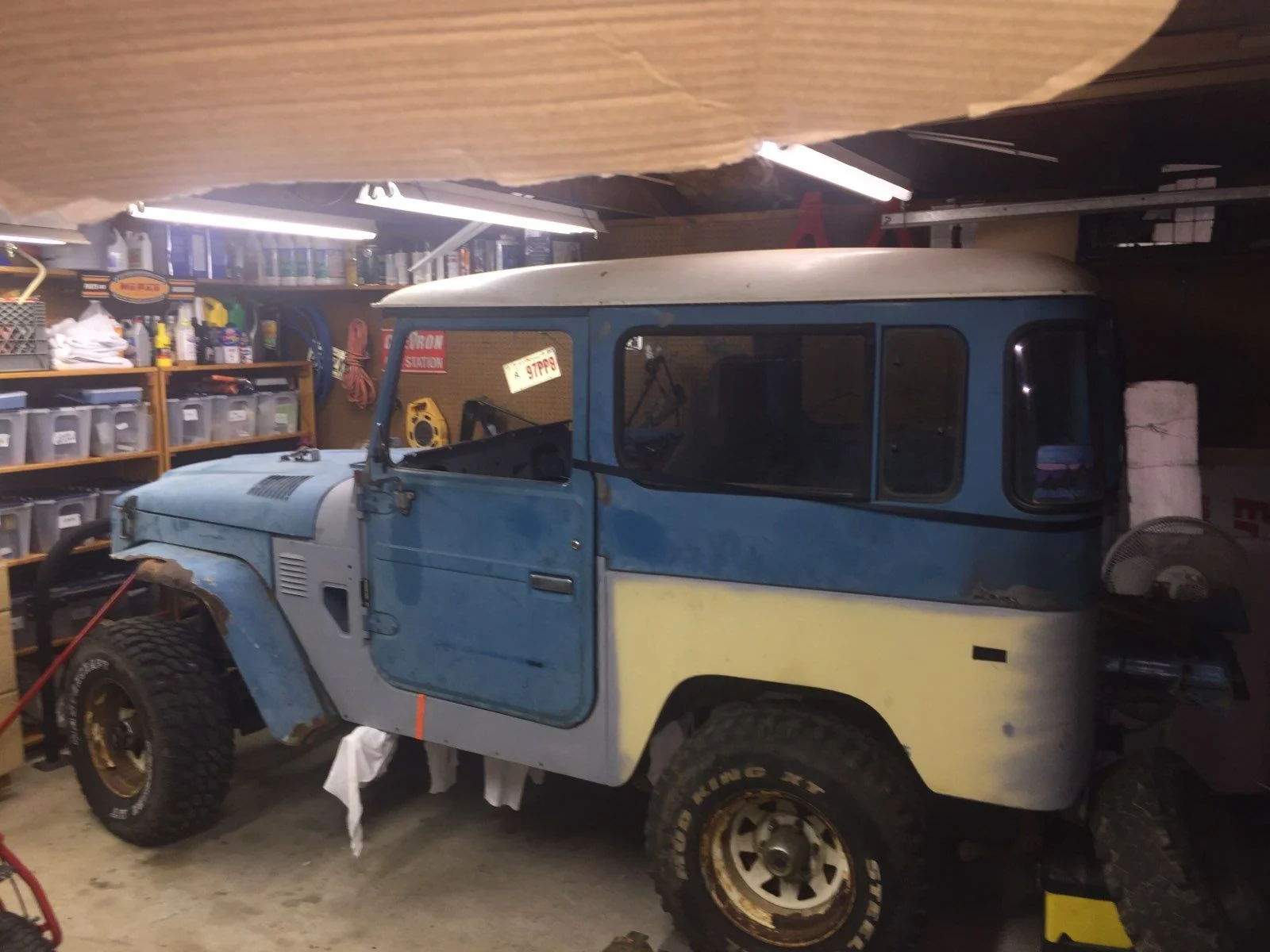

Once I got it home and in my shop, I set one of the fenders and the hood on it to get a pic or two of what "looks like a FJ40" before I blow it all apart and start the frame up restoration.
I had to clean up some stuff, get rid of some stuff, and make room for my new toy ;)
PS - My shop has a 7 foot ceiling and I have been planning to raise it to 10 feet. I guess I better do that soon if I plan to put that 2.5 inch OME lift kit on it (Hahaha!)

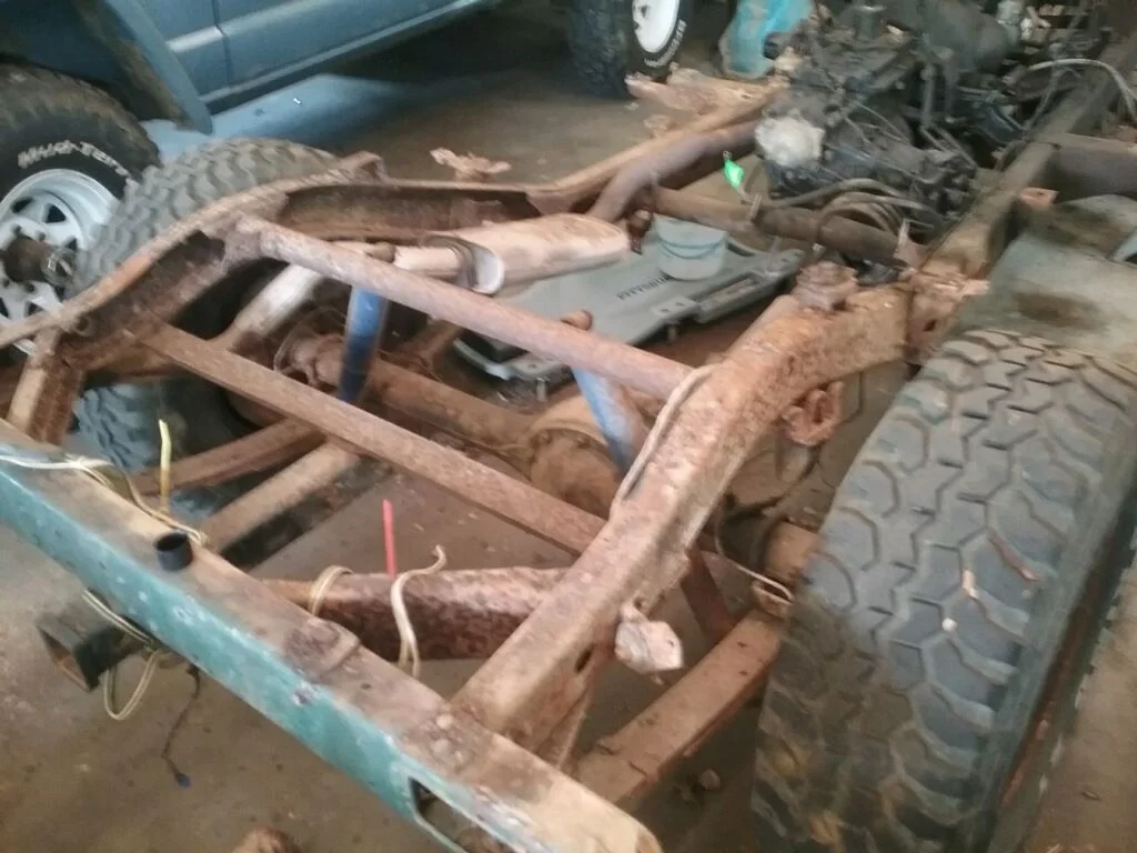

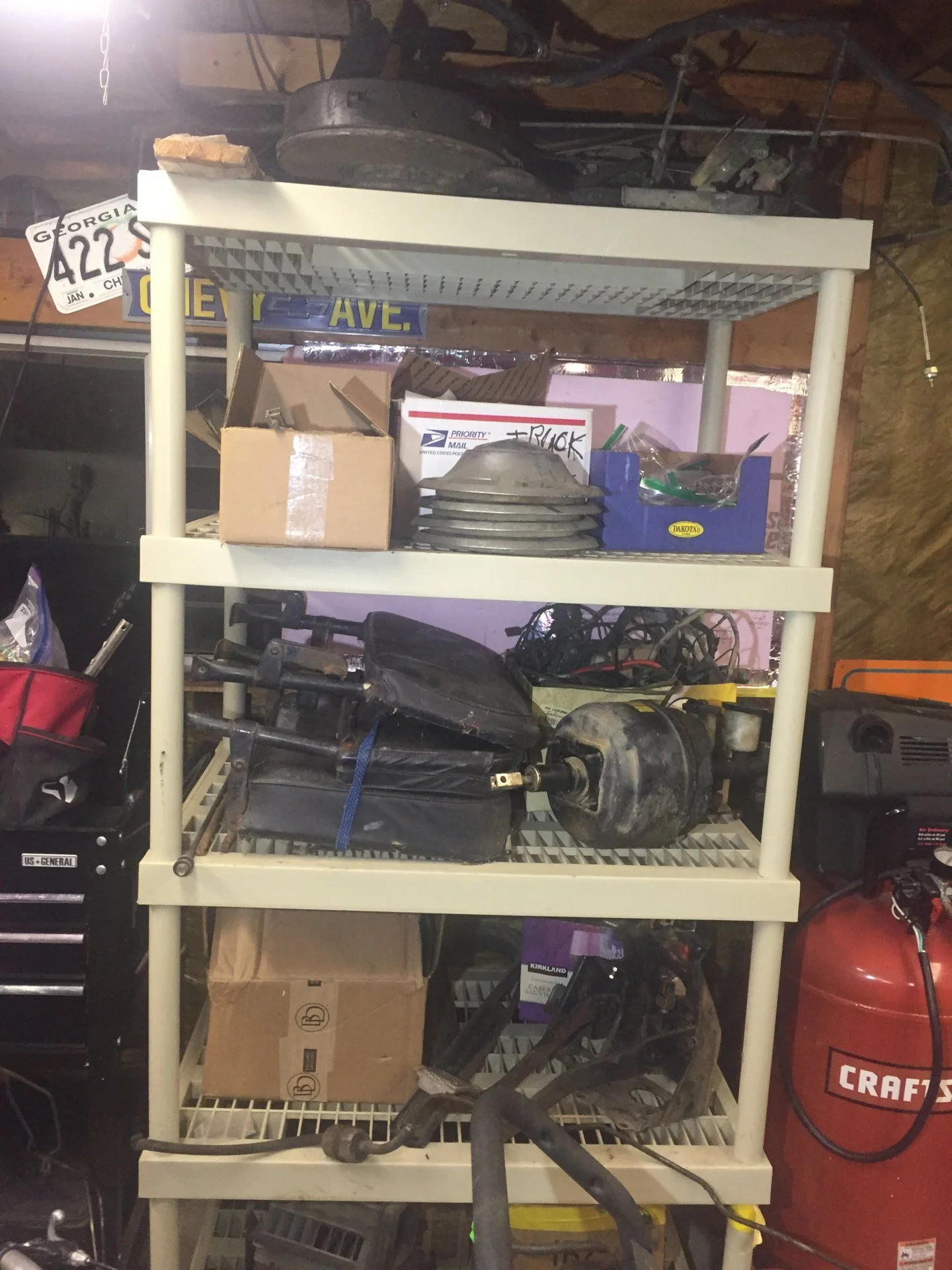

Today I went through all the parts and boxes. Luckily the PO "bagged and tagged" most everything. I organized everything and I have started making a list of things I need. I'm going to strip down the frame and get it sand blasted and painted.
To save money my plan is to only spend money and fix things that will be too hard to do later. For example, I am going to sandblast and paint the frame, but I will clean up the original leaf springs and "rattle can" them because that can be swapped out later. I will replace the tie rod ends, and all the bushing, etc. now.
Anything that is a safety issue, or can't be done later, I will do now...
What do you guys think about the clutch and rear main seal??? Should I go ahead and do that with the engine out?
What else would you suggest that I do now?

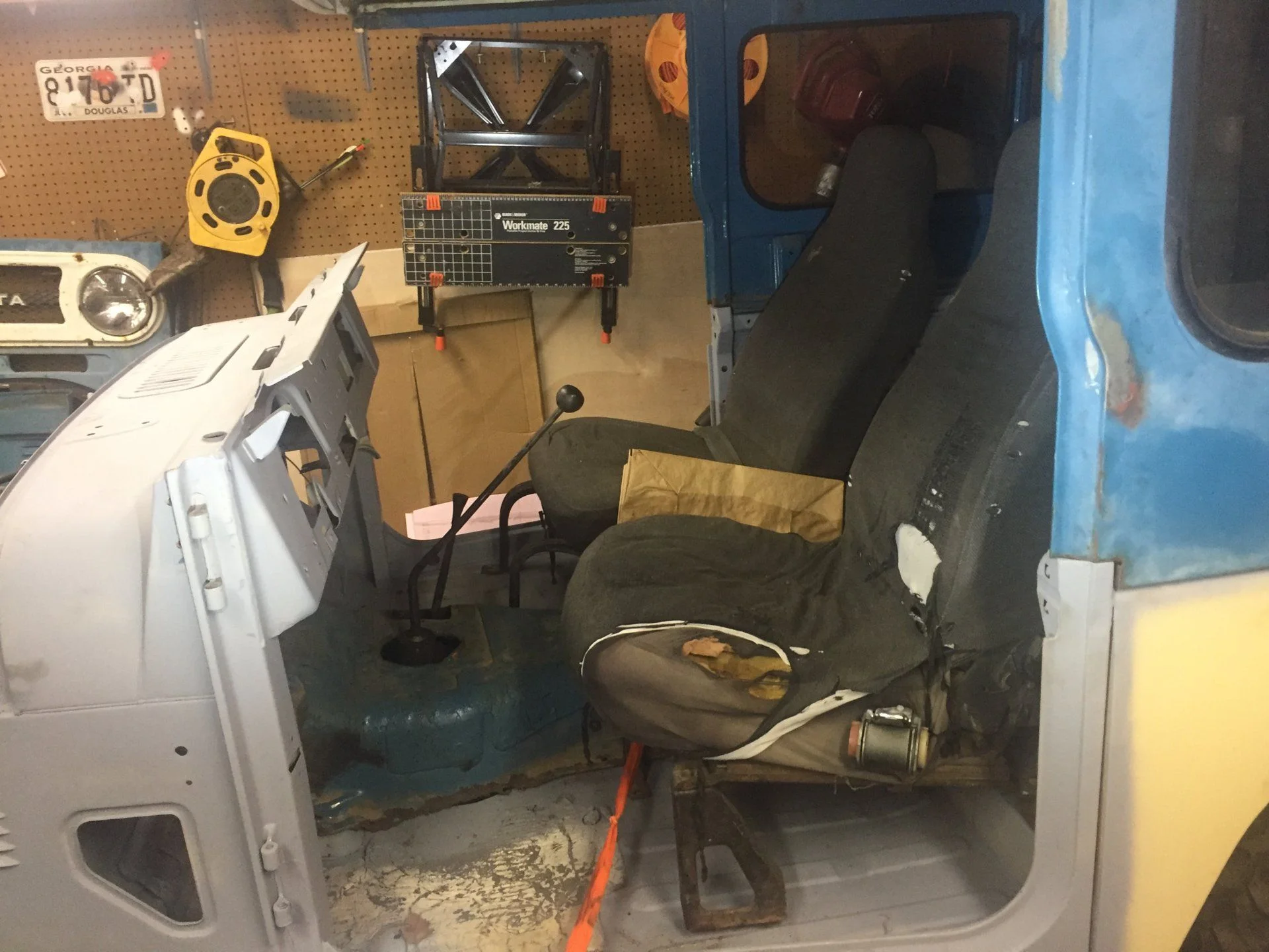

Here is a pic of my organized chaos :)
I also set the seats in it so I could sit in it for the first time!! I can't wait to be driving this thing!!!!

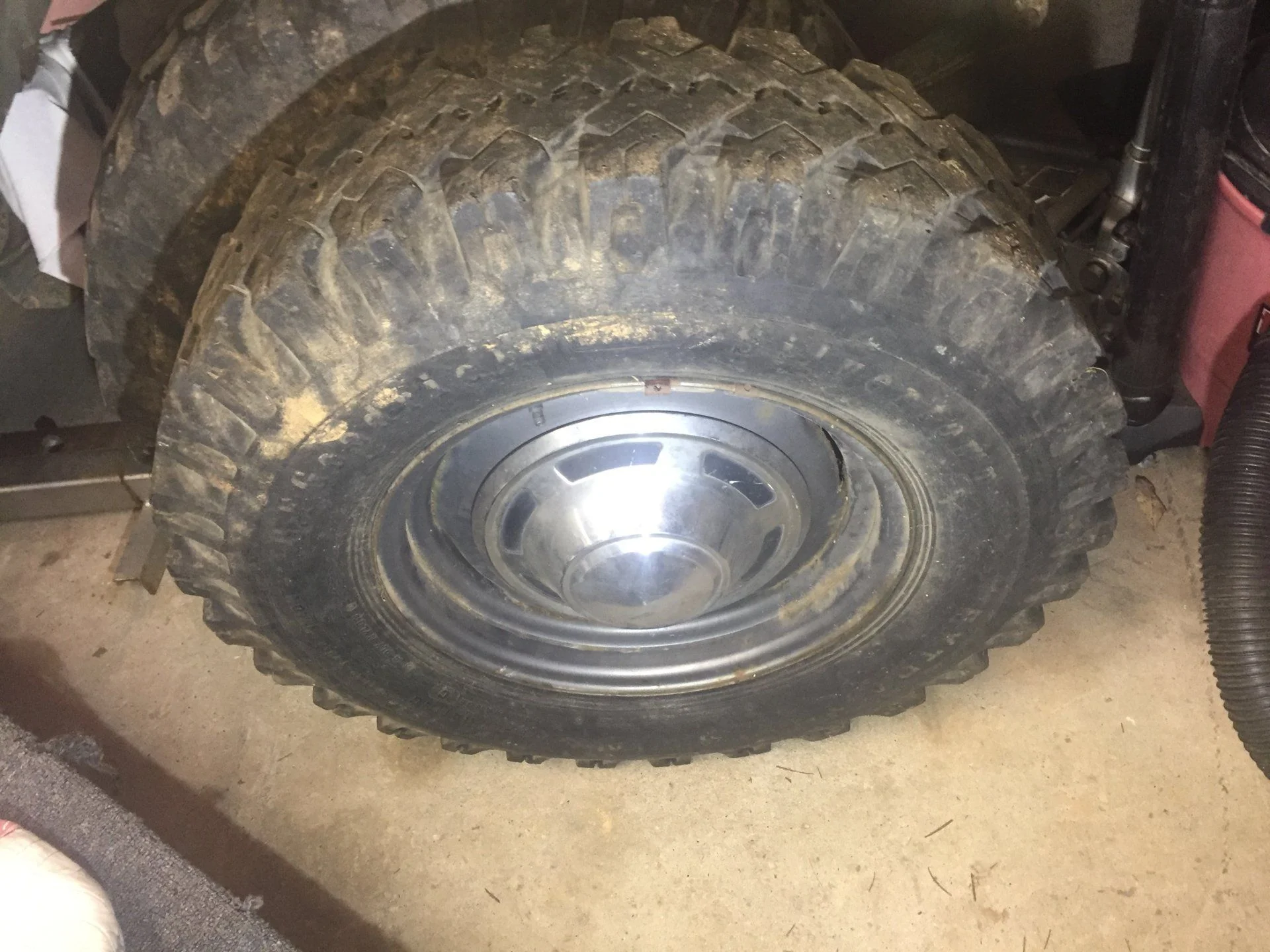

The spare tire is an OEM rim. I also got a complete set of five hubcaps, and I am pretty sure that this tire is original. The rim looks BRAND NEW and the tire is not dry rotted too bad, but I would probably not try and drive on it. It has probably been on this rim in a garage its entire life of 41 years!!

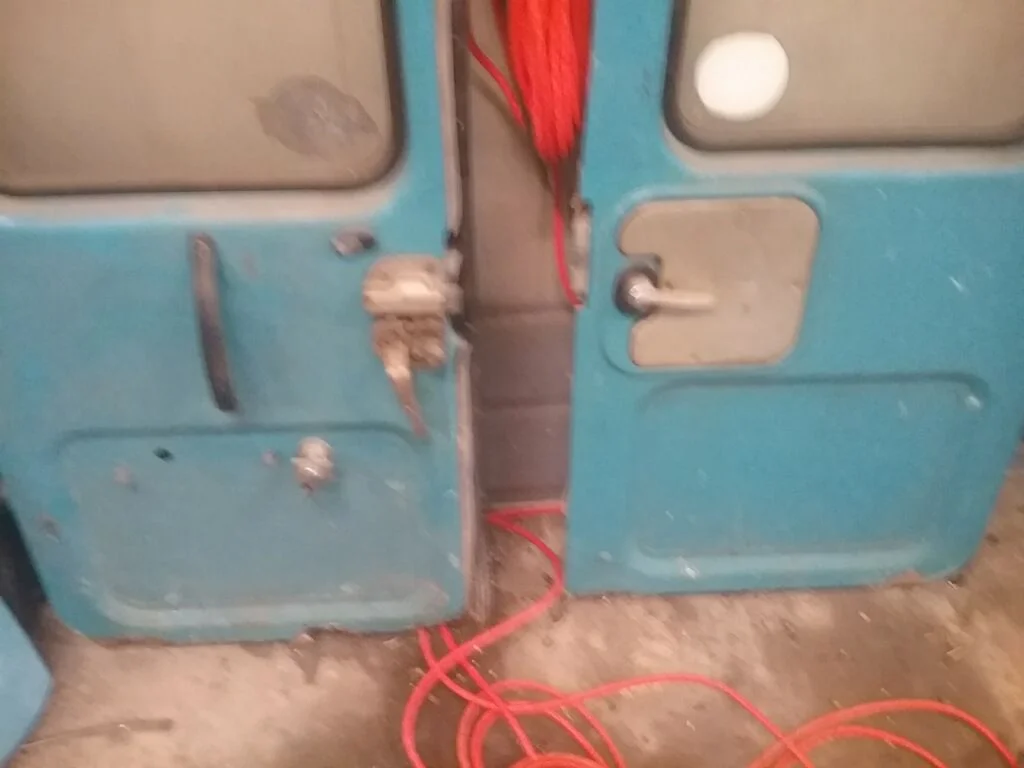

The bracket for the the tubular spare tire rack is there. I just need to drill the holes. I am not sure what I need to do about the back door hinges. I will have to fix that. Is there a bracket I need to weld in with the nuts on it like the tire rack?? I need to do some research.

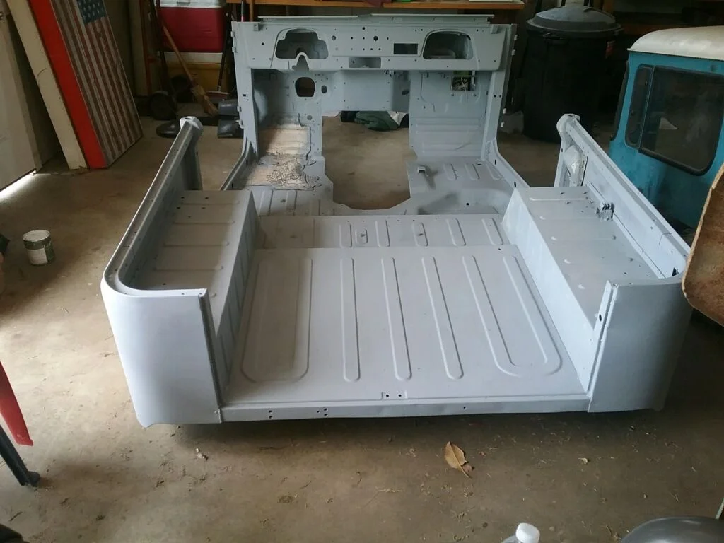

I also want to clean up some of the welds on the the tub and some small other "clean up" items before it is ready for paint. Note the spot weld holes that were not welded and the roll bar bolts that need to be removed.
There are a lot of little things like that, but nothing major.
