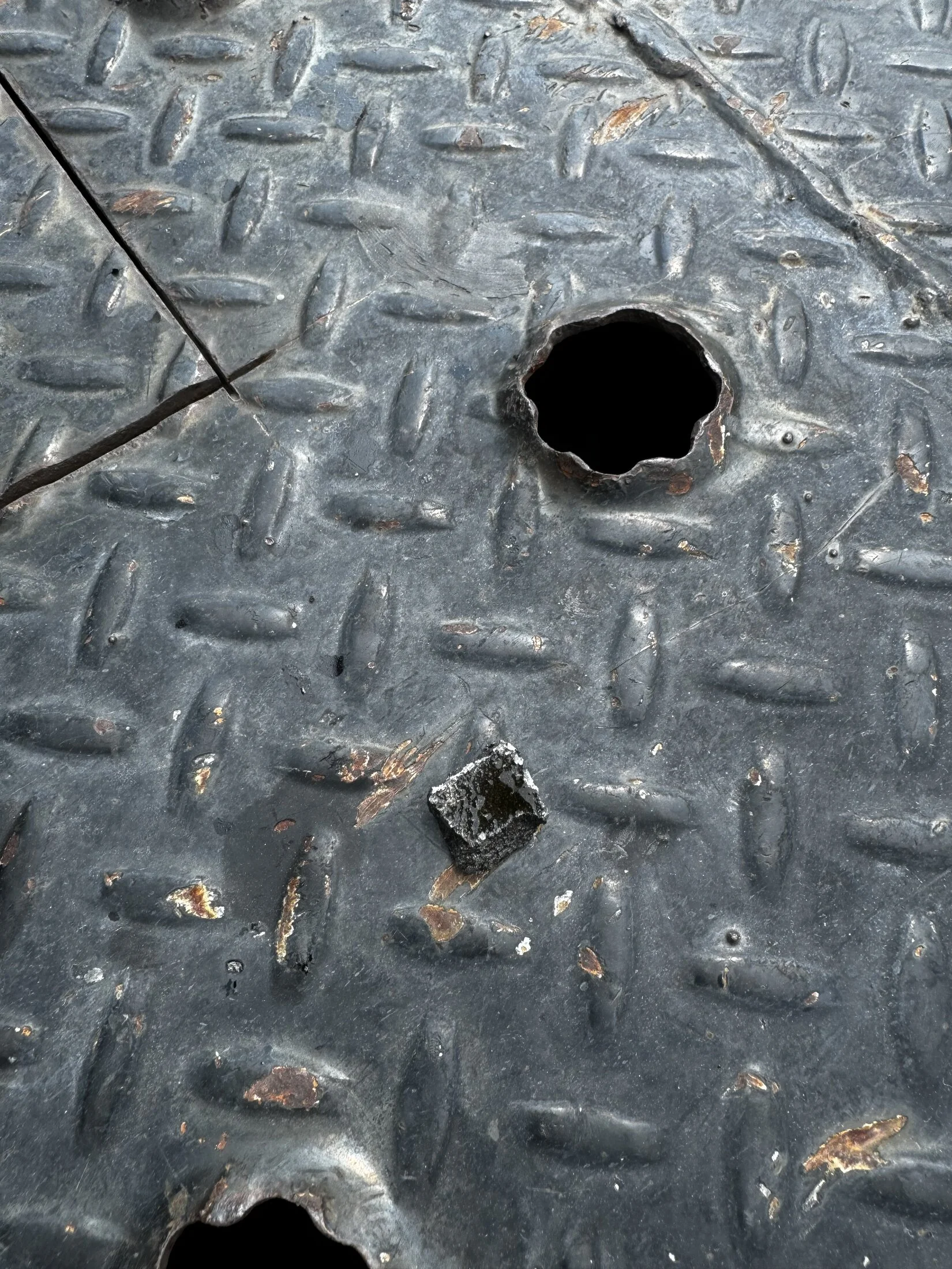

Damn shame. It looks like the hole is in the front of the pan.
¯\_(ツ)_/¯

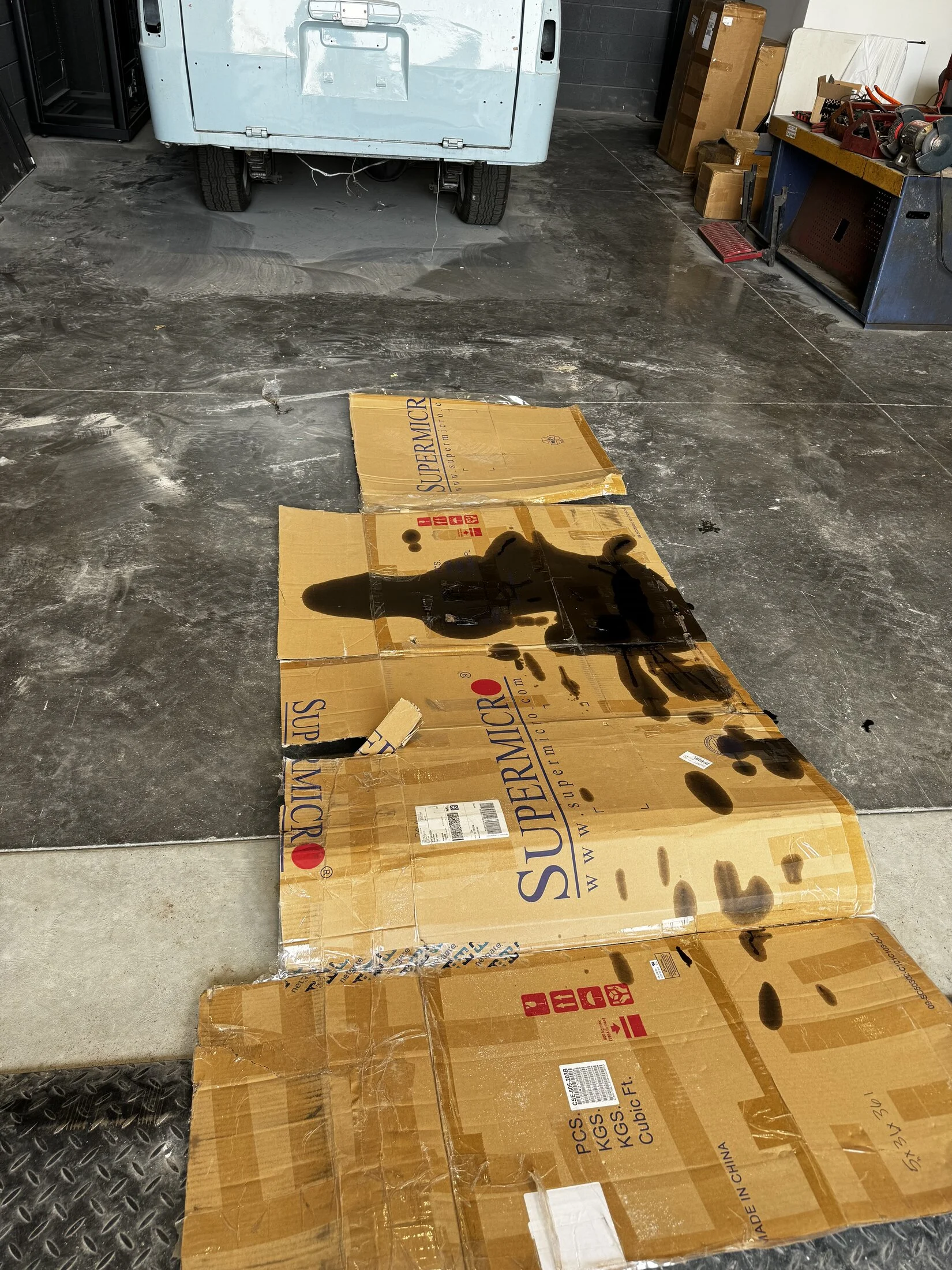

It was wanting to build a ton of EGT on the way up the grade from Golden to Genesee. I saw 800F once. I normally keep it under 650F, so I was feathering it pretty closely and gearing down. (6% grade in there.)
We had just exited I-70 and were on the off-ramp when it let go. Didn’t make a bunch of noise or clatter. Didn’t lose oil pressure. Still has oil in the sump.
Current theory is that the #1 or #2 rod separated close to the crank while the piston was near TDC, but I’m not gonna know until it’s out and the pan comes off.

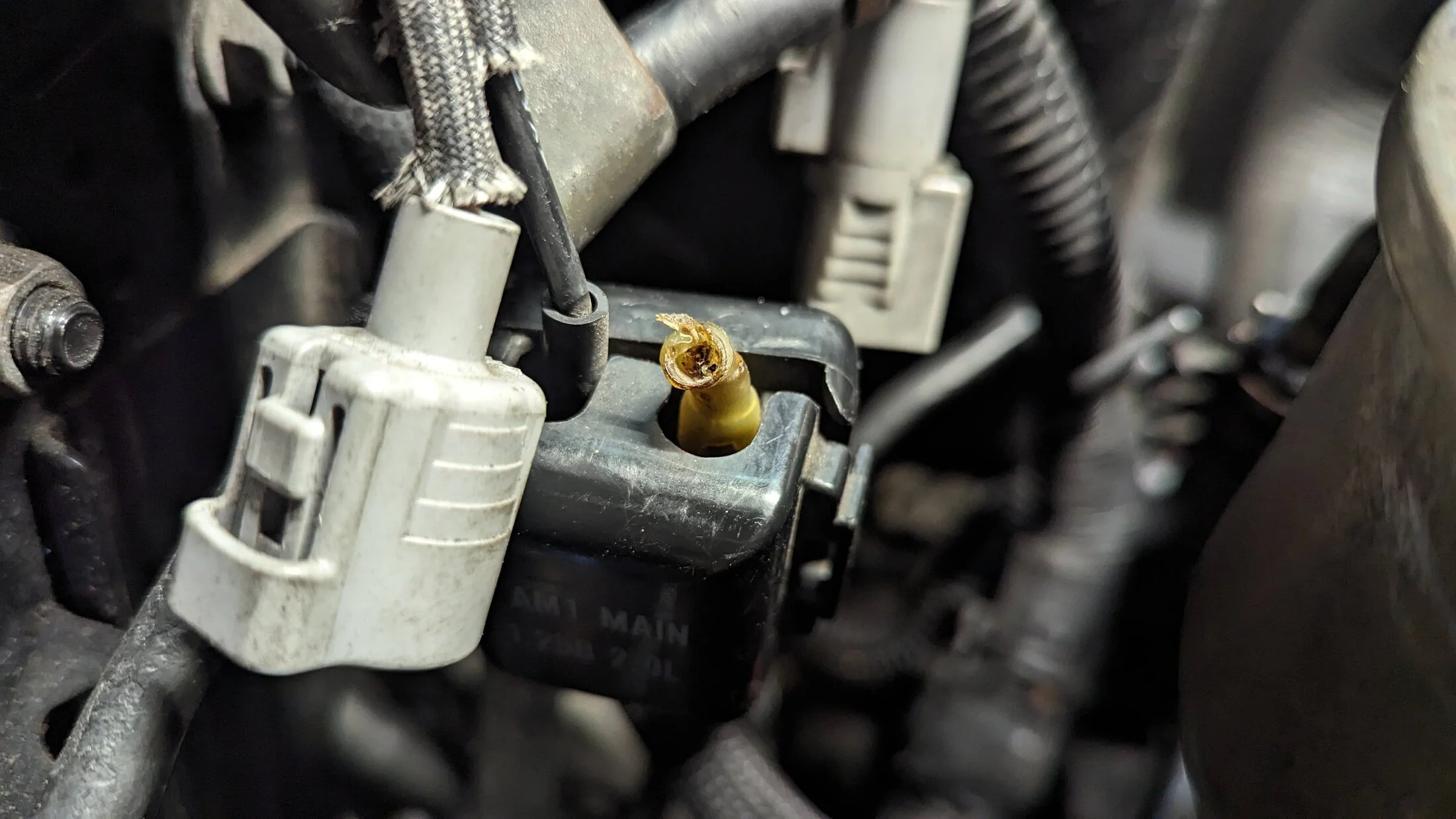

Which they did. Sorta. I took delivery of it (this time in Austin) about a year ago, drove it to Denver, and we got it to pass emissions last August, but it has some harness problems, and I didn’t like the way the wiring was done. (Remember: this was the owner’s personal truck.)
The lx450 had new new exhaust (y-pipe, cats) when it went to MD. What came back was a rusted mess that developed a series of exhaust leaks. Until I bought the kid a stainless y-pipe and stainless CARB-compliant cats. He had the muffler shop down the street install that, but they didn’t install the second cat (idk why), which, it turns out, was plugged. So at some point a couple months back we put it on my lift and replaced every exhaust gasket and the second cat I order to make the exhaust leaks go away. So at least one of the two cats supplied by that shop in MD was plugged. Yup, they picked up any junk they could find from behind the shop.
And then it developed a no-start. I thought I’d solved it with a new modulator, and in the process found the FPR hanging by the harness in the fender. So I bought one of those new and did my best to repair the s***ty splice job wrapped in duct tape that I found in the process.
Then the no-start returned.
So I handed it to Johnny at @Cruisers and Co and he found the no-start pretty quickly. A bad connection at what was left of the old fusible link junction.

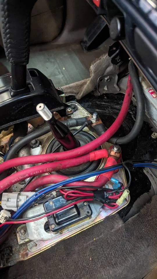

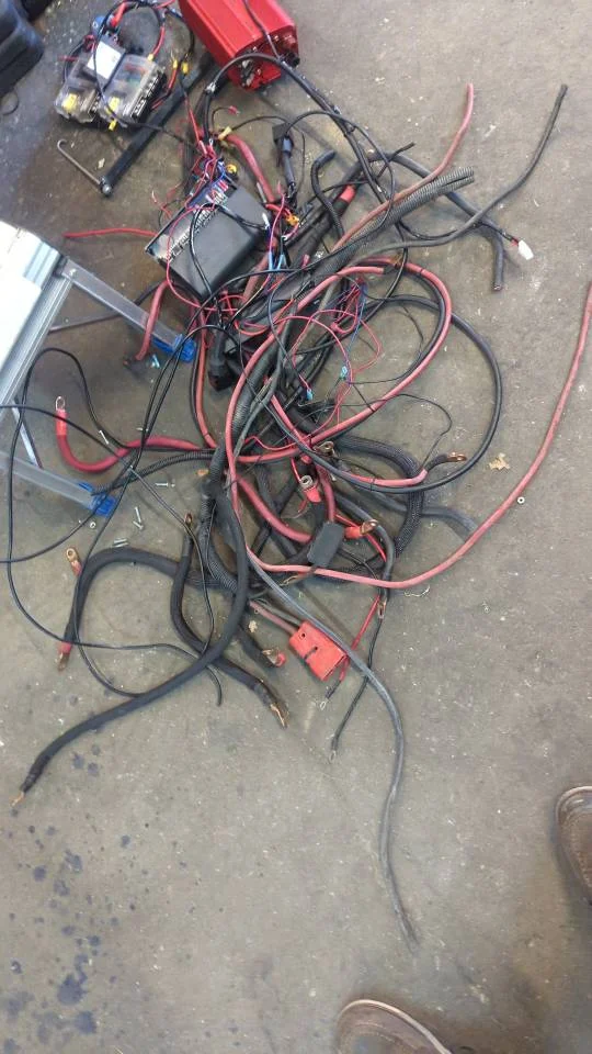

We’d already agreed that he could go through the rest of the truck. Well, what he found was, in a word, disgustingly dangerous.
1/0 uncovered under the center console is good right? How about 1/0 across the front of the radiator, nevermind the uncovered studs on the circuit breakers, 100A circuit breaker in place of the fusable link, etc? Want to discuss the batter with the Positive terminal by the fender? No? Me either.
Johnny tore it all out to start over.

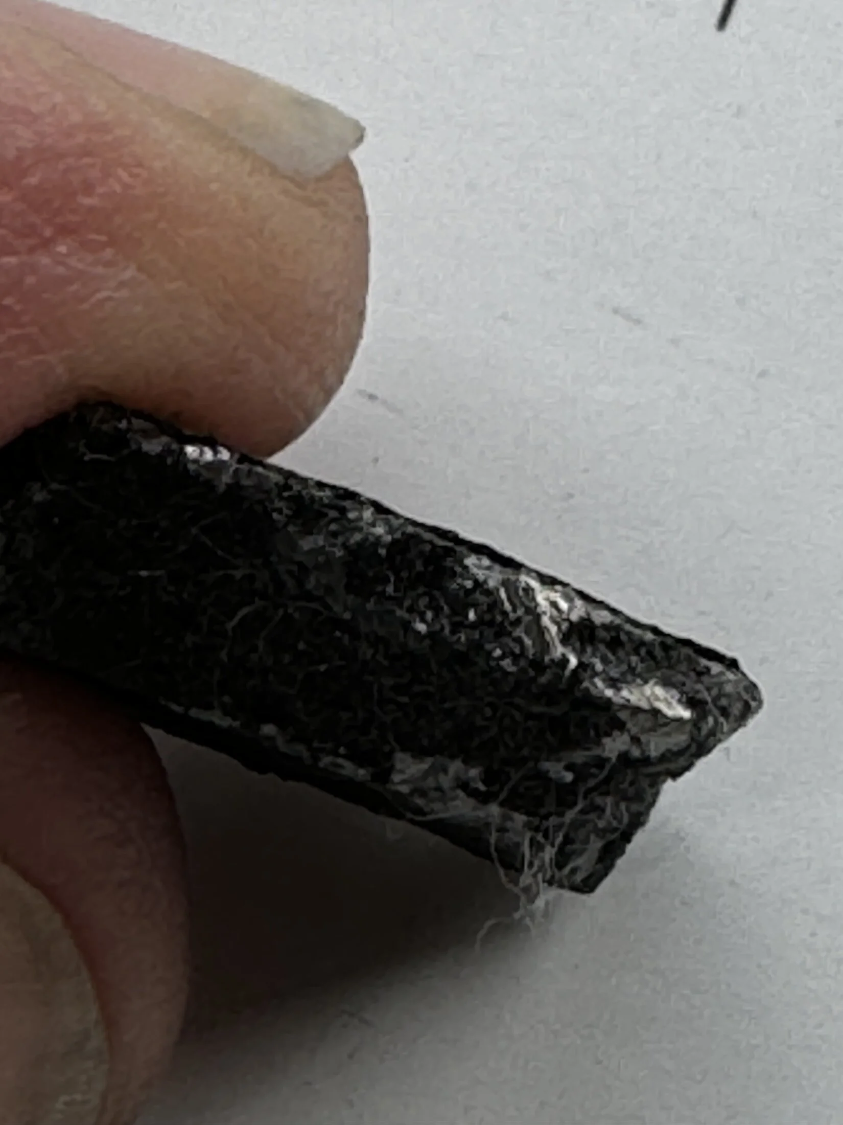

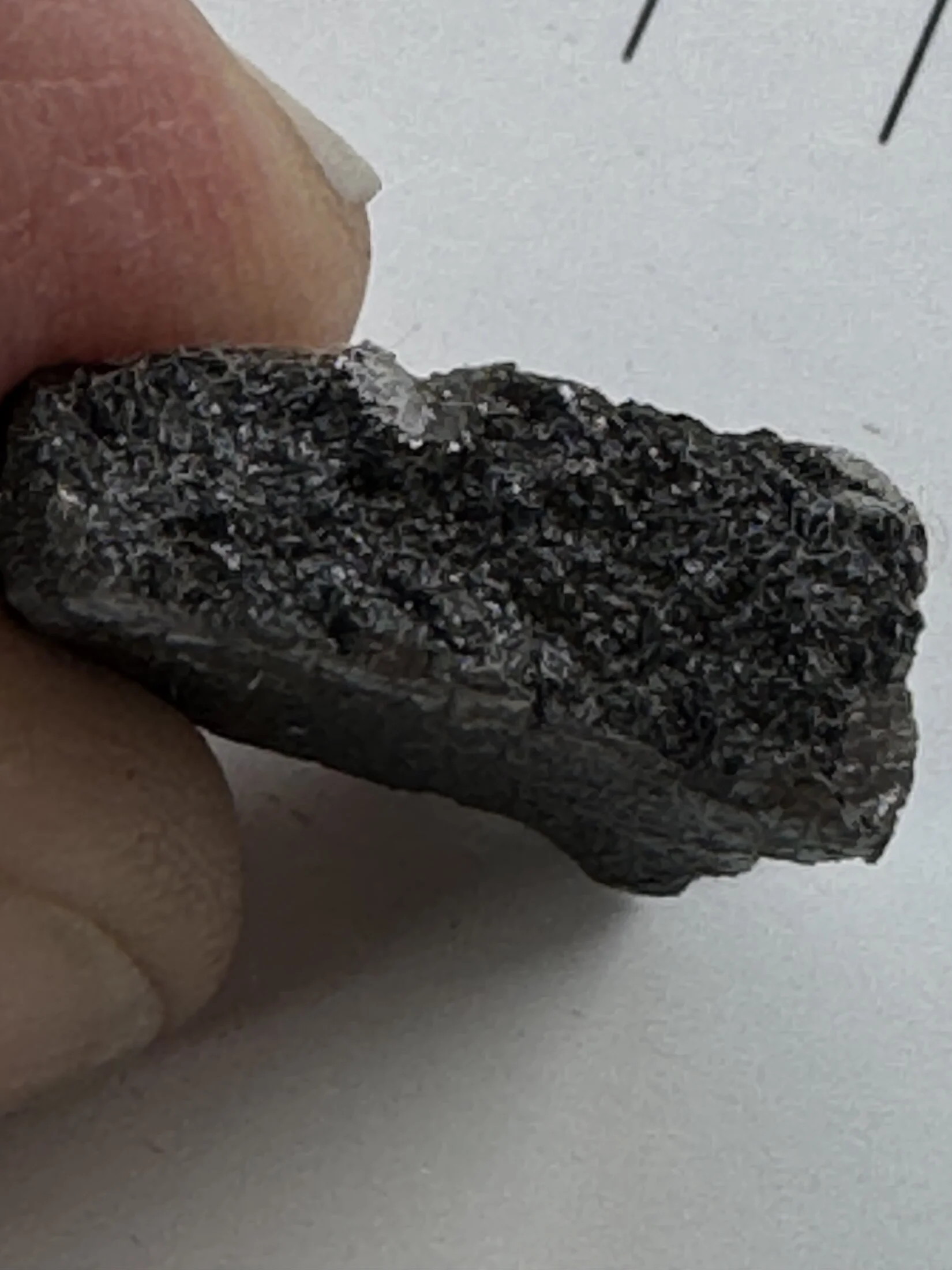

on its way to @samc2447. That’s how much oil it dropped despite the rag I stuffed in the hole.
Cleaned off the pan (brake cleaner) and taped it up so it doesn’t blow oil all over the dude’s trailer.
Got a souvenir off the rag. Grenaded at least one rod by the looks of it.
