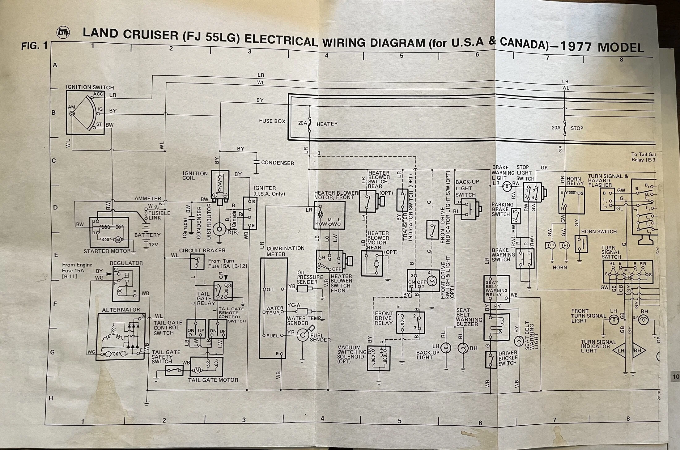

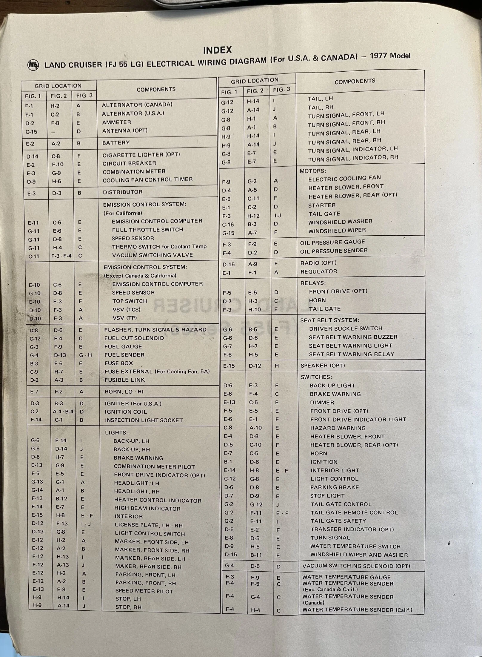

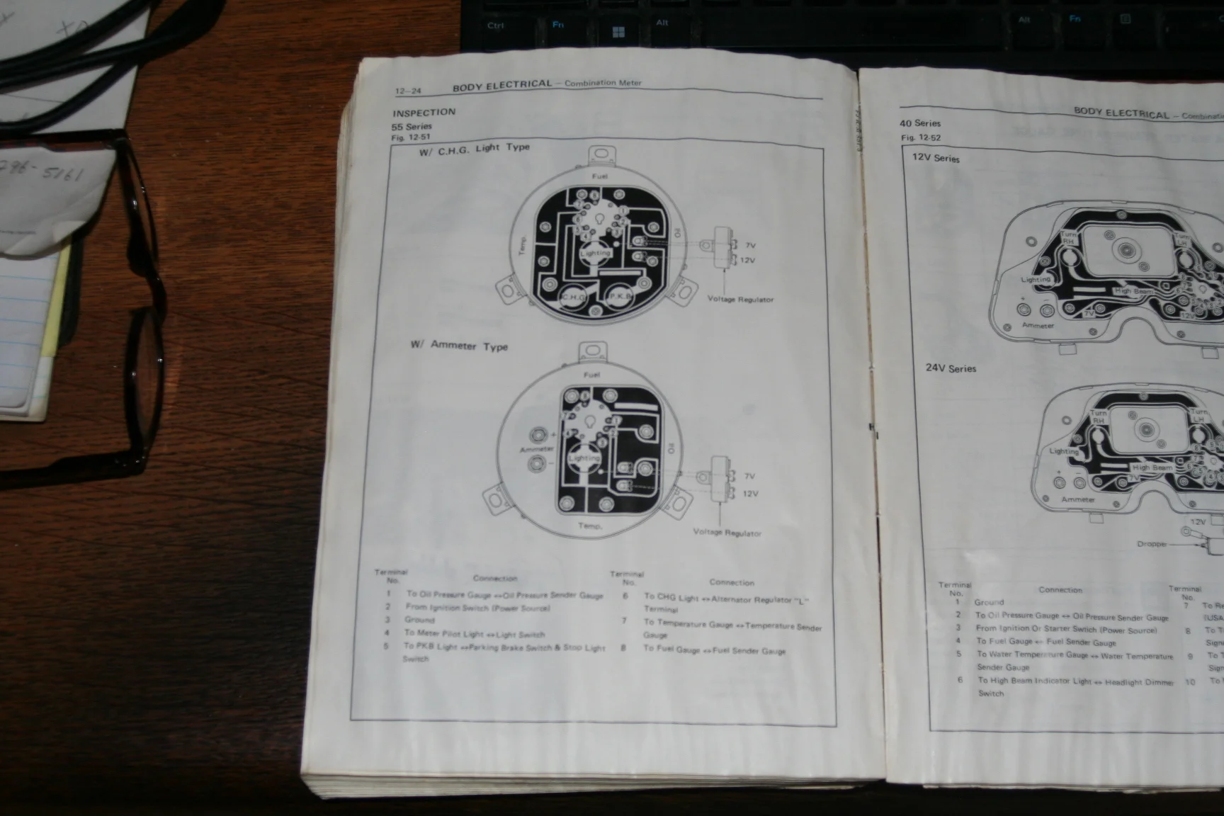

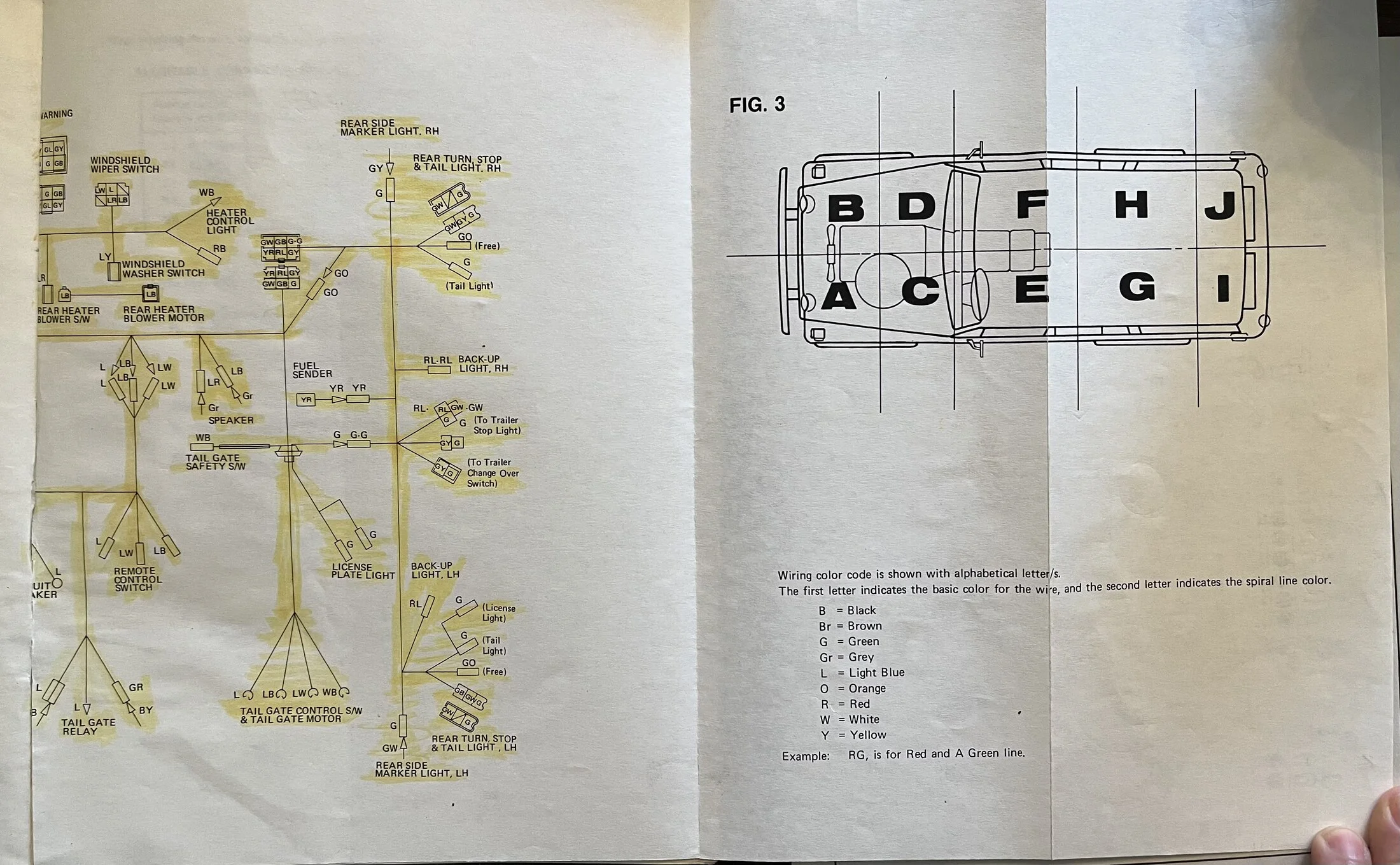

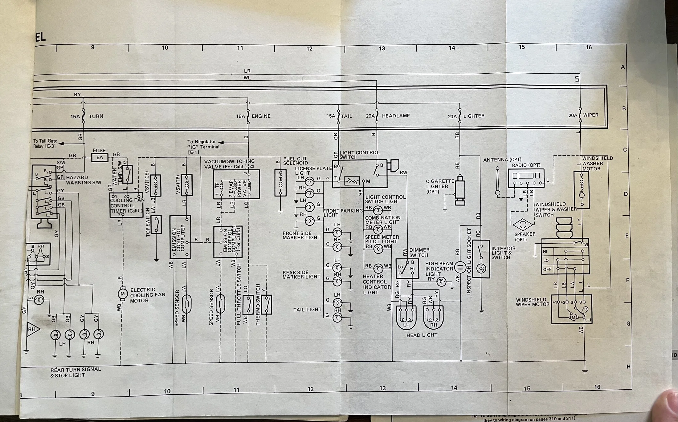

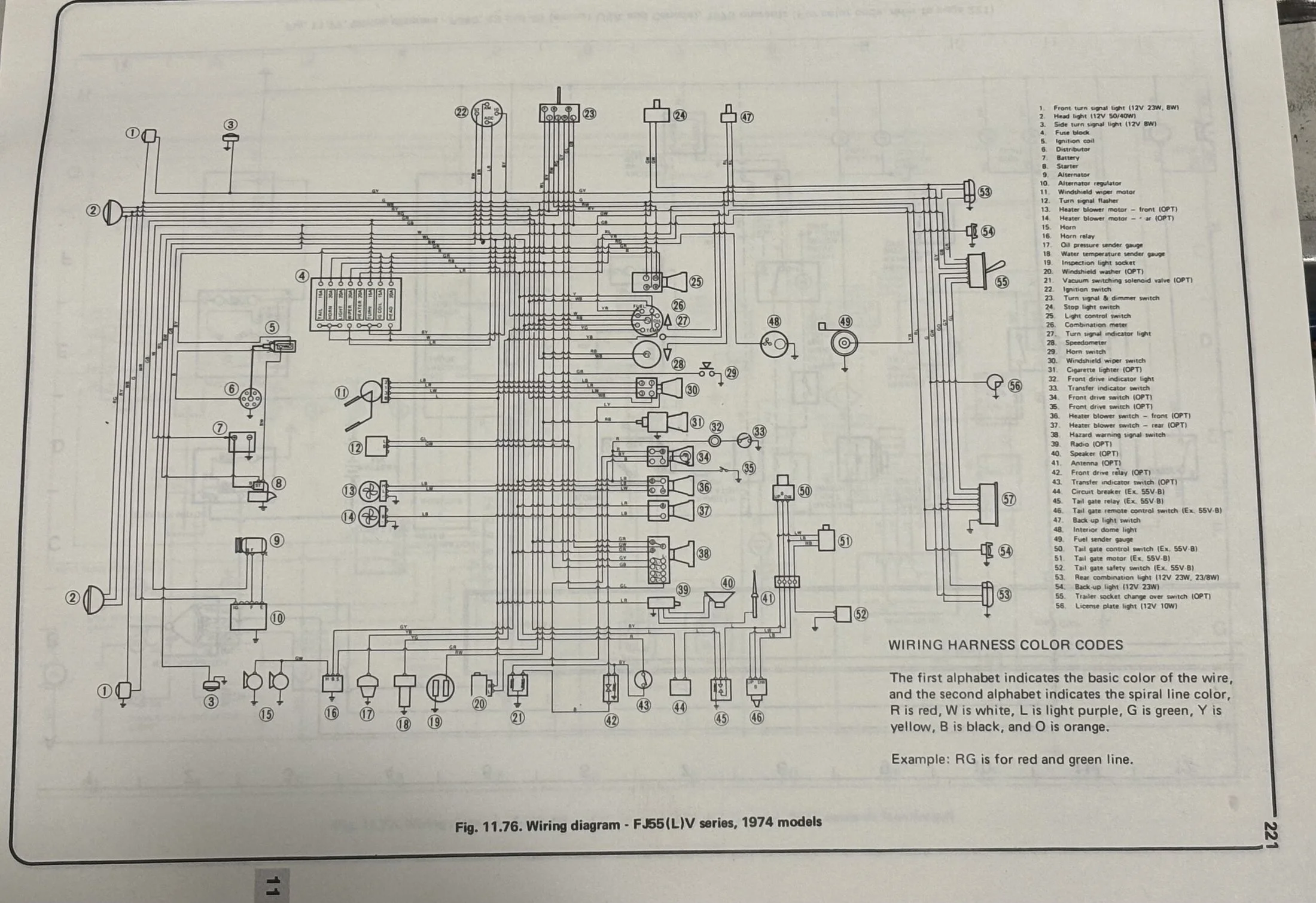

I'll upload some pics from the OEM 1977 all models wiring diagrams service manual for the fj55.
Thank you everyone for the information. You’re all awesome I think with the shared diagrams I am dialed in now.
