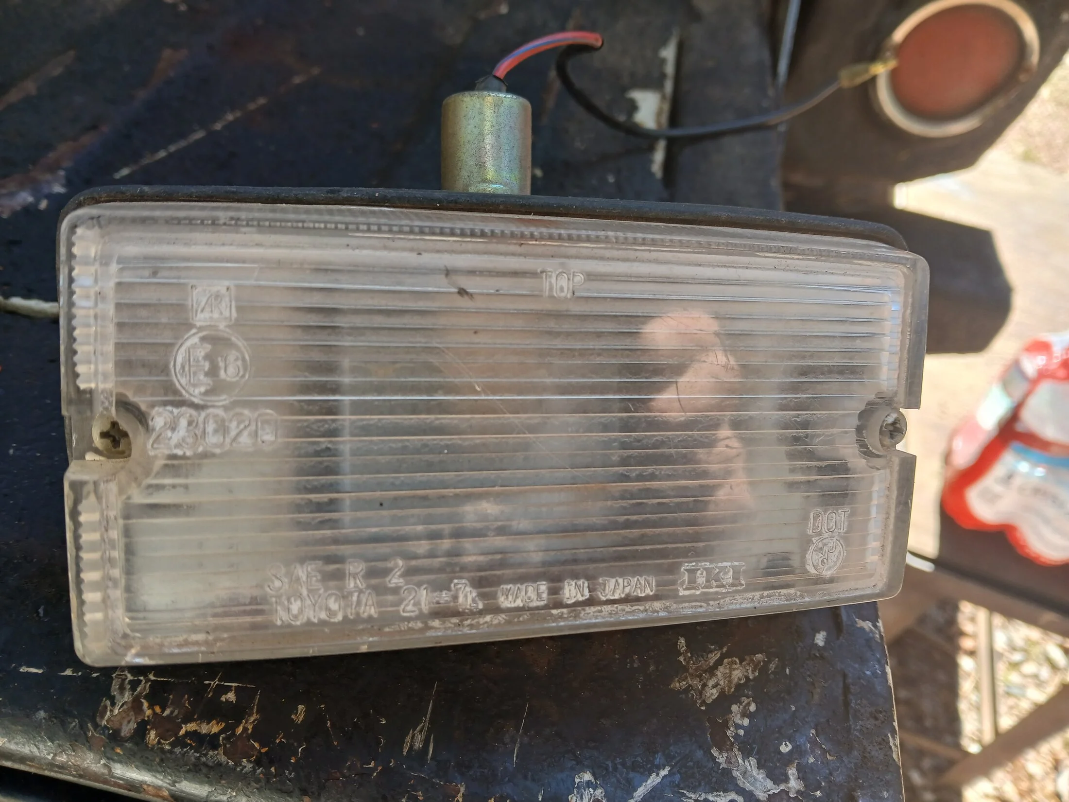

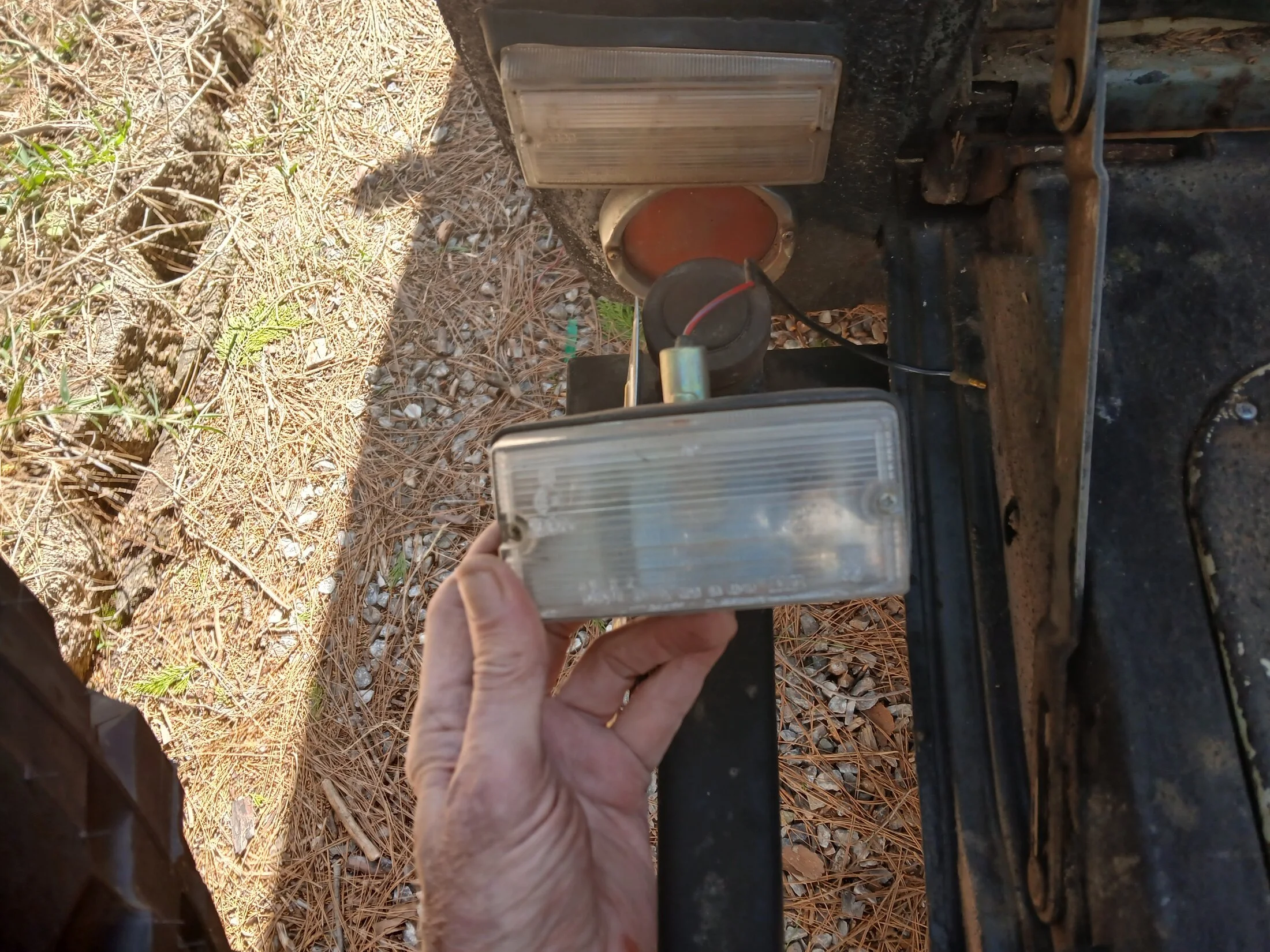

I shattered by reverse light lens and I am having trouble finding one.
forum.ih8mud.com
I see they look similar but it says 69-73 so I thought they must be a little different. I will look up through Toyota and get a part number to see where that leads me. Thanks!There is a bunch of reverse light lenses on eBay but big $$$. eBay also has the entire reverse light that might actually be still available from Toyota. Not sure when the reverse light changed though. Mine is the earlier style and is the stand alone rectangle and that is what I see on eBay. Is 74 different?

Thanks!Same part number for all years as far as I can tell. Most of the parts are RH or LH; just FYI.
81670 LAMP ASSY, BACK-UP, RH 81670-60050 1 81670B BULB(FOR BACK-UP LAMP) 99132-11230 12V 23W, 12V 23W 2 81671 LENS, BACK-UP LAMP, RH 81671-21040 1 81674 GASKET, BACK-UP LAMP BODY, RH 81674-60050 1 81680 LAMP ASSY, BACK UP, LH 81680-60010 1 81681 LENS, BACK-UP LAMP, LH 81681-21030 1 81684 GASKET, BACK UP LAMP BODY, LH 81684-60010 1

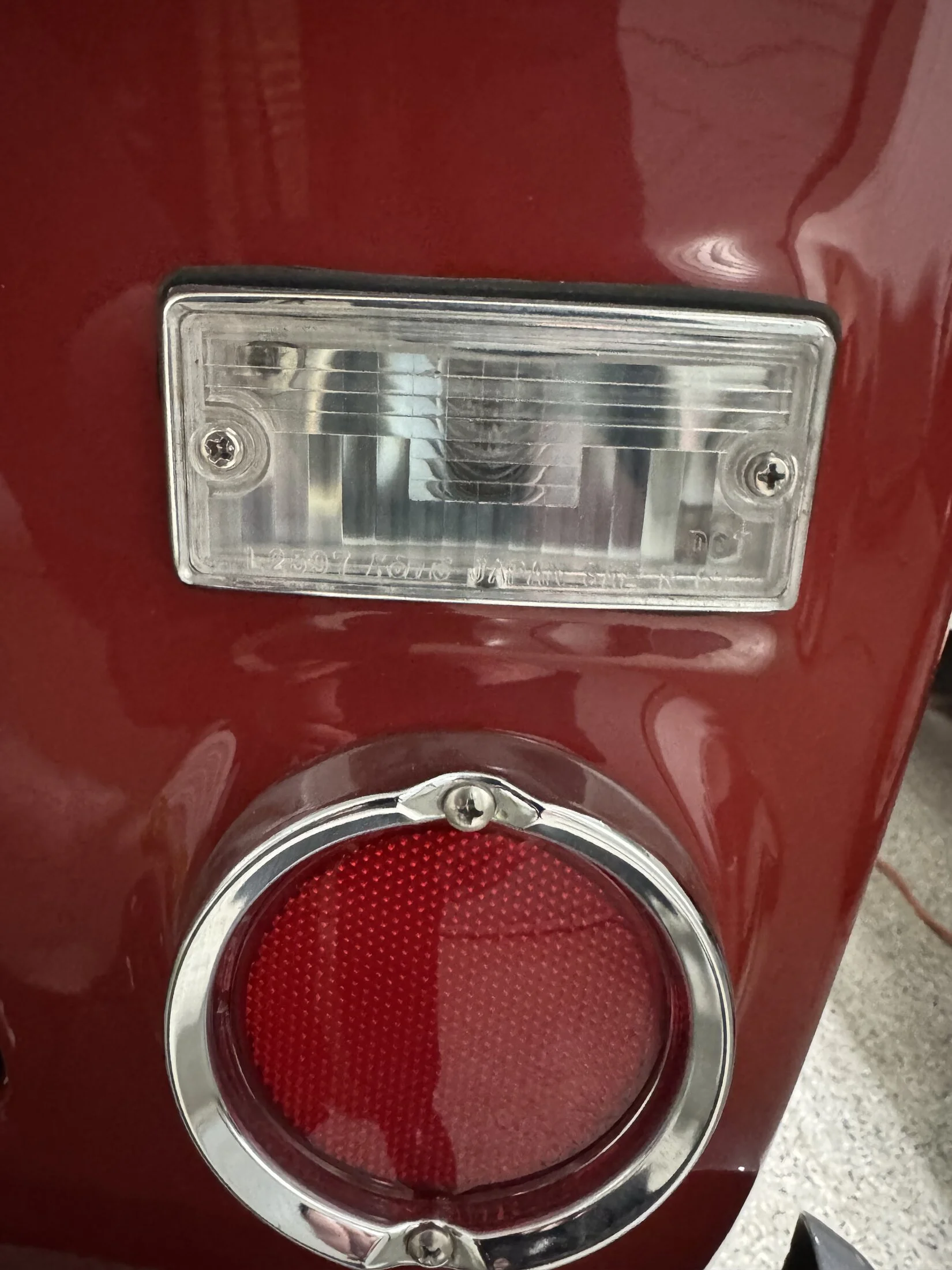

Looks like it's worth a shot.View attachment 3844285$10 and it’s yours
How do I pay you?Looks like it's worth a shot.

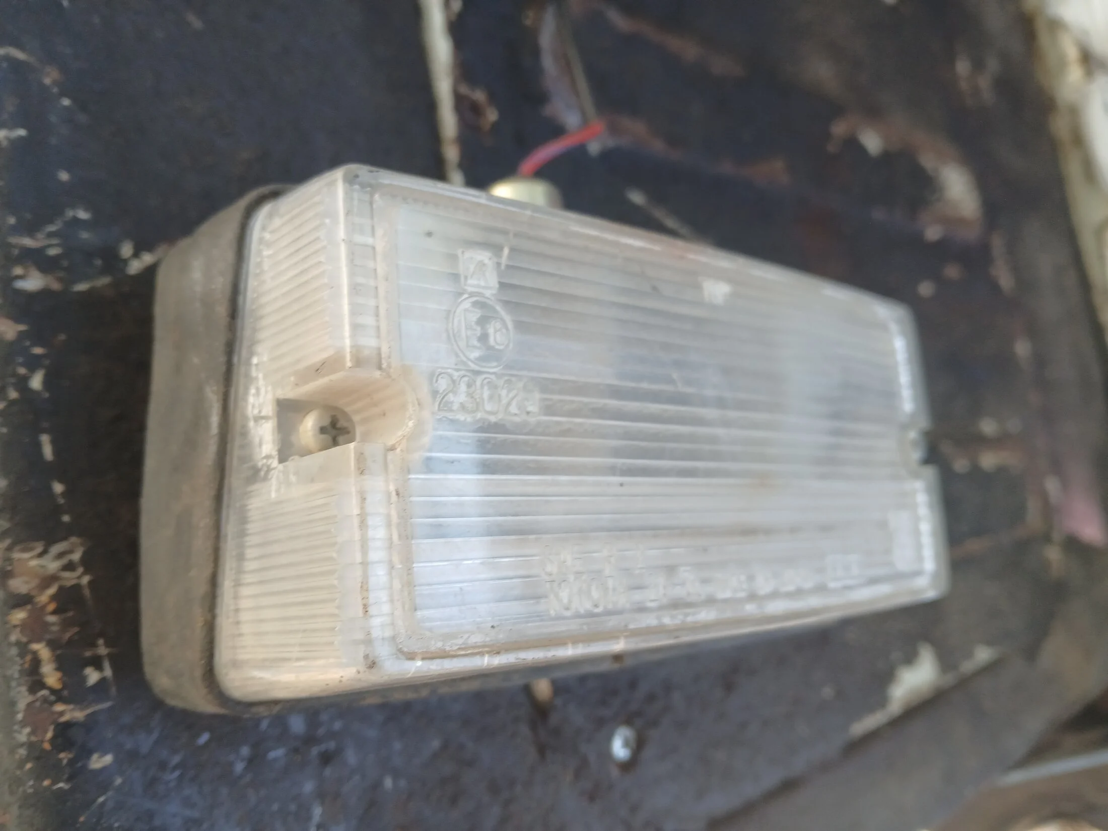

Mine is gone. Shattered.Is it same lense numbers on yours? I just replaced these on my wife’s 55 bought all new housing and such when I painted it.

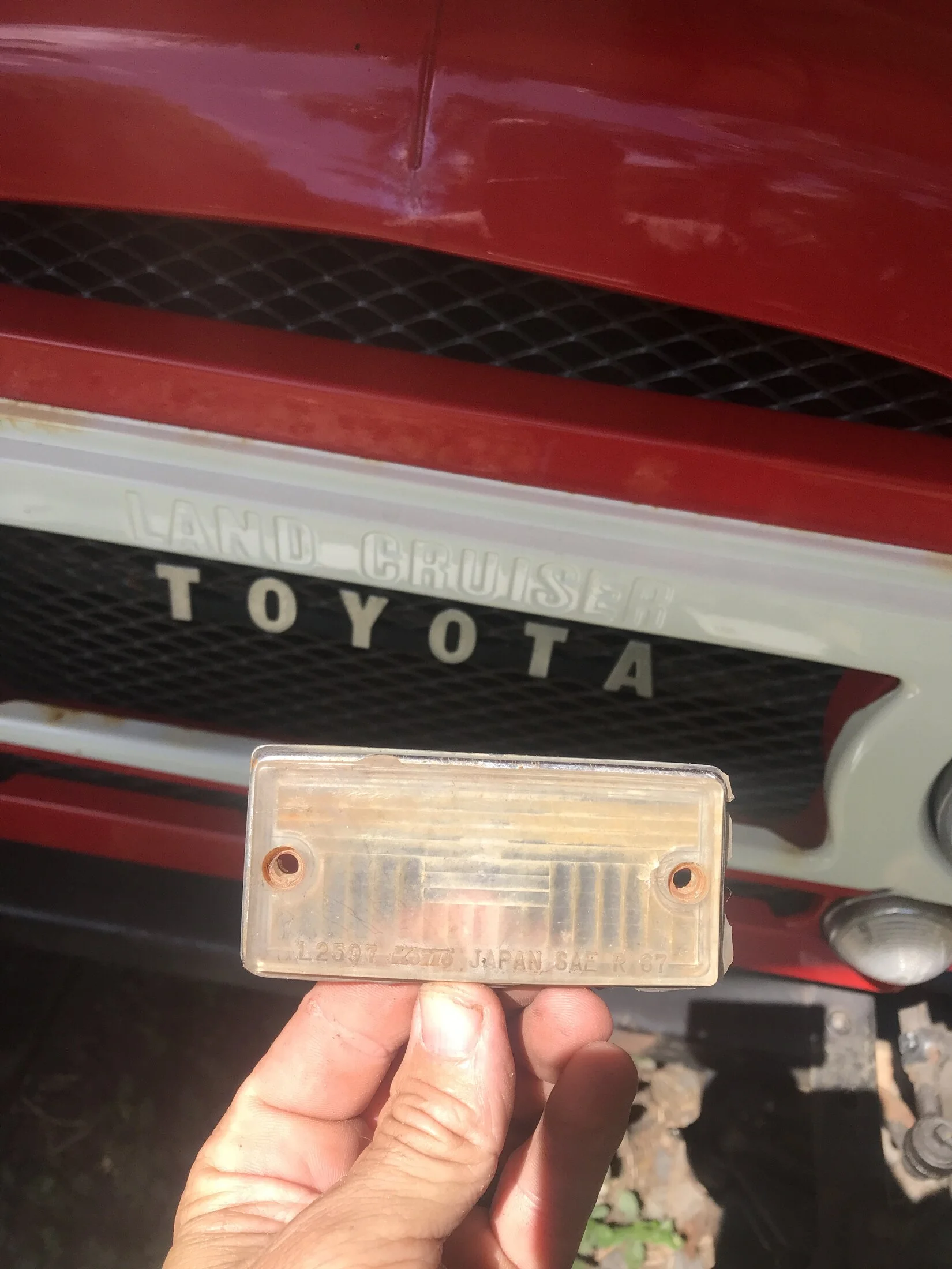

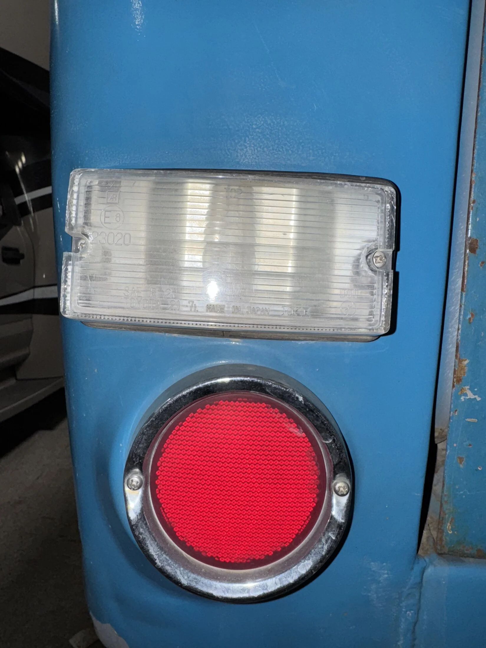

This is the other side
Yours looks like the smaller oneLooks like it's worth a shot.
Which side? I got the Driver side...I shattered by reverse light lens and I am having trouble finding one.
