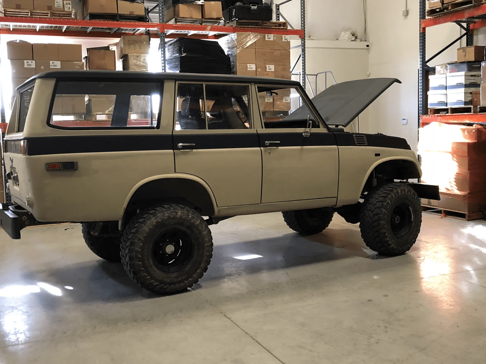

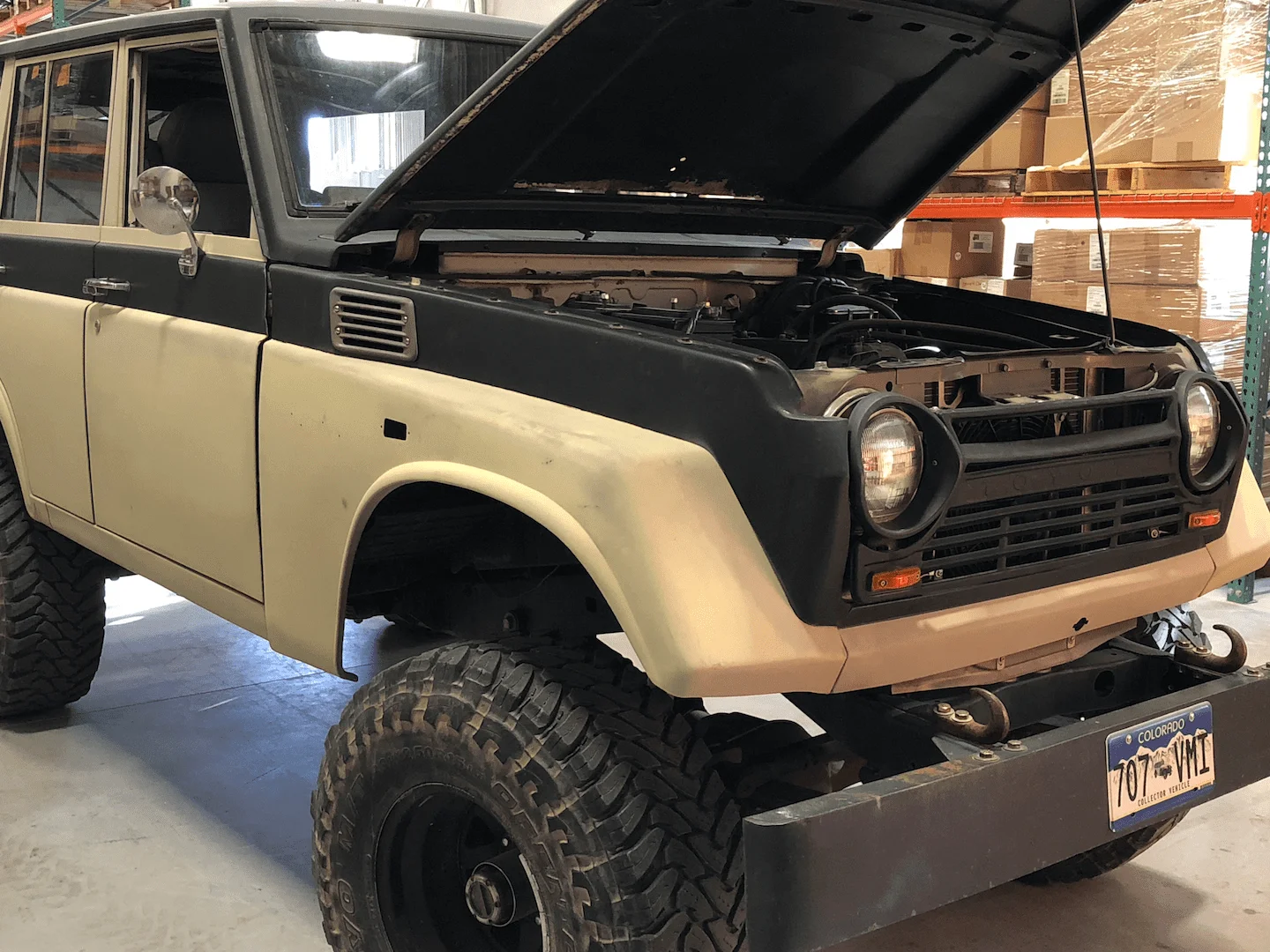

Update. Trying to get this on the road, as I've had it since May.
For the past 6 months, I've been collecting parts for the tailgate innards (still missing one window channel), the front window regulators (@Pastafarian welded wrenches in as window handles), and a set of door hinges to rebuild.

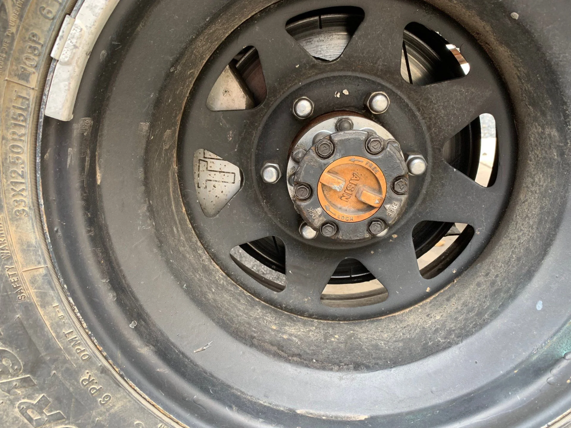

Recently done: Added disc brakes to the front axle. Used a TLC 4x4 (Jonathan Ward) setup I had on the 62. Pics soon.
Finally found the electrical gremlin that has been discharging the battery. Fusible link was burnt. Now it doesn't make a spark when you connect the battery, so fingers crossed that the issue is closed.
Next on the list is to fix the e-brake and horn. With luck it will pass the Texas State inspection without the front fender marker lights (are these the same as FJ40 fender marker lights?) and reverse lights. @Cruiser Innovations removed the reverse lights and blanked the hole where they used to be. Josh had a plan to locate bu lights where the reflectors are, but a) I don't want to cut the body and b) I'm thinking I can put them in a rear bumper.

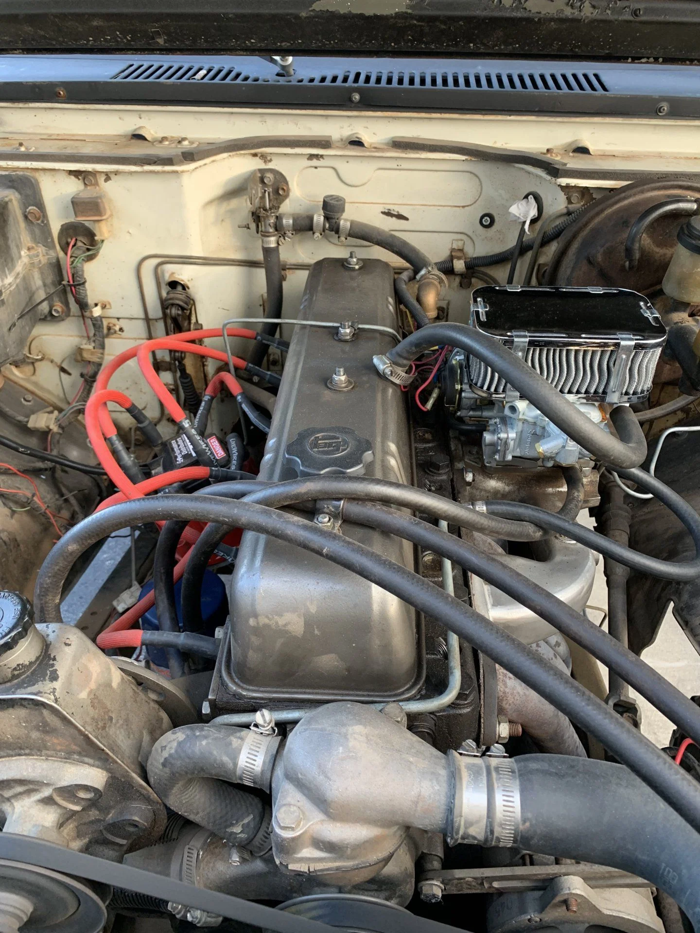

Forgot to mention above that the pig got a new carb. The old one had a hole in the float. Also disabled the electric fuel pump (pulled the fuse) and took out the pressure regulator.
The mechanical pump is still in-place and works great. The pig runs strong with the F in her.

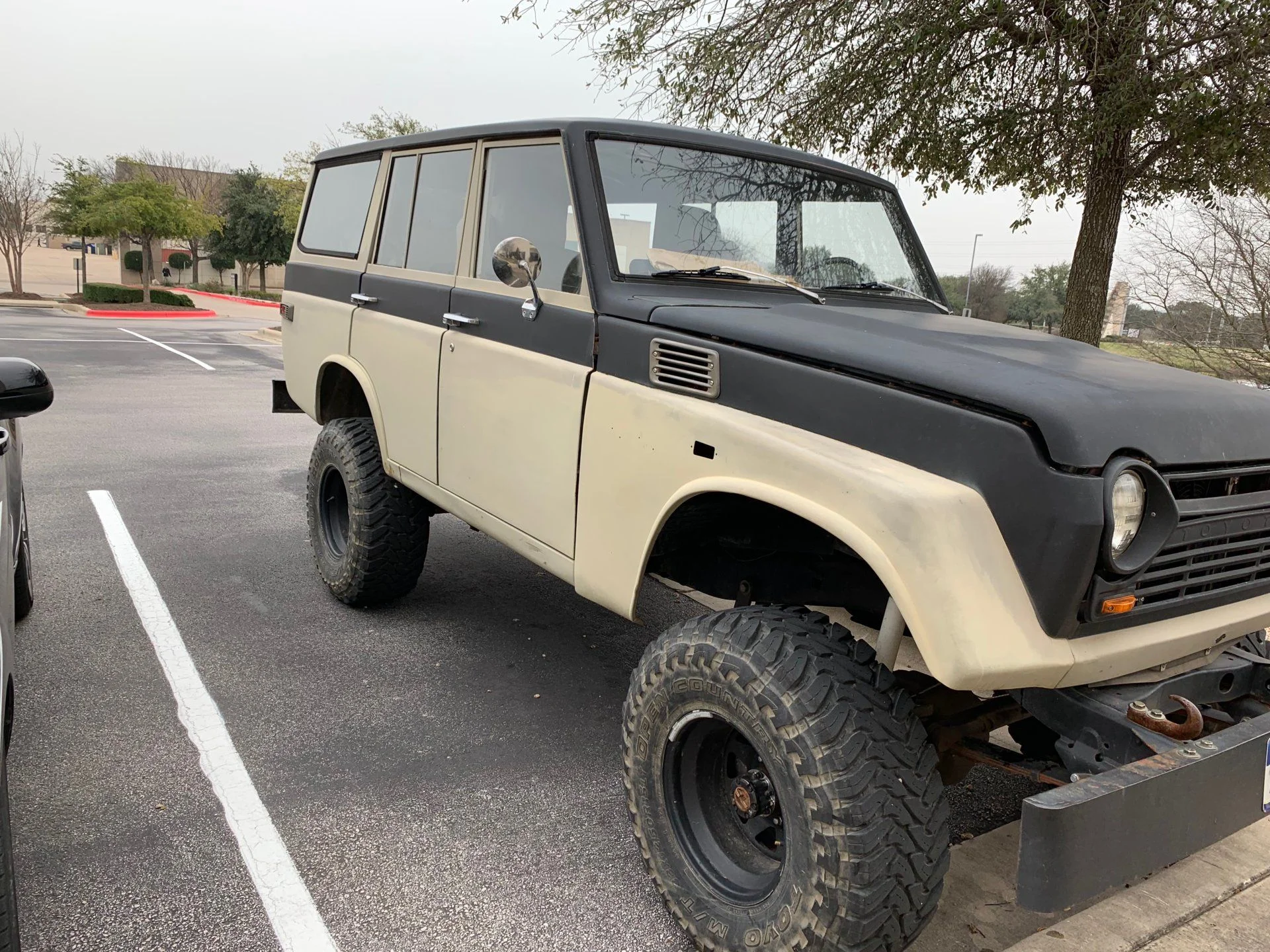

Wow. Just got it out of that shop, and... that truck is *so* much fun to drive. It didn't run that well when I bought it, but it's solid now.
I'm still smiling.
Pic of the TLC calipers & slotted rotors attached.
