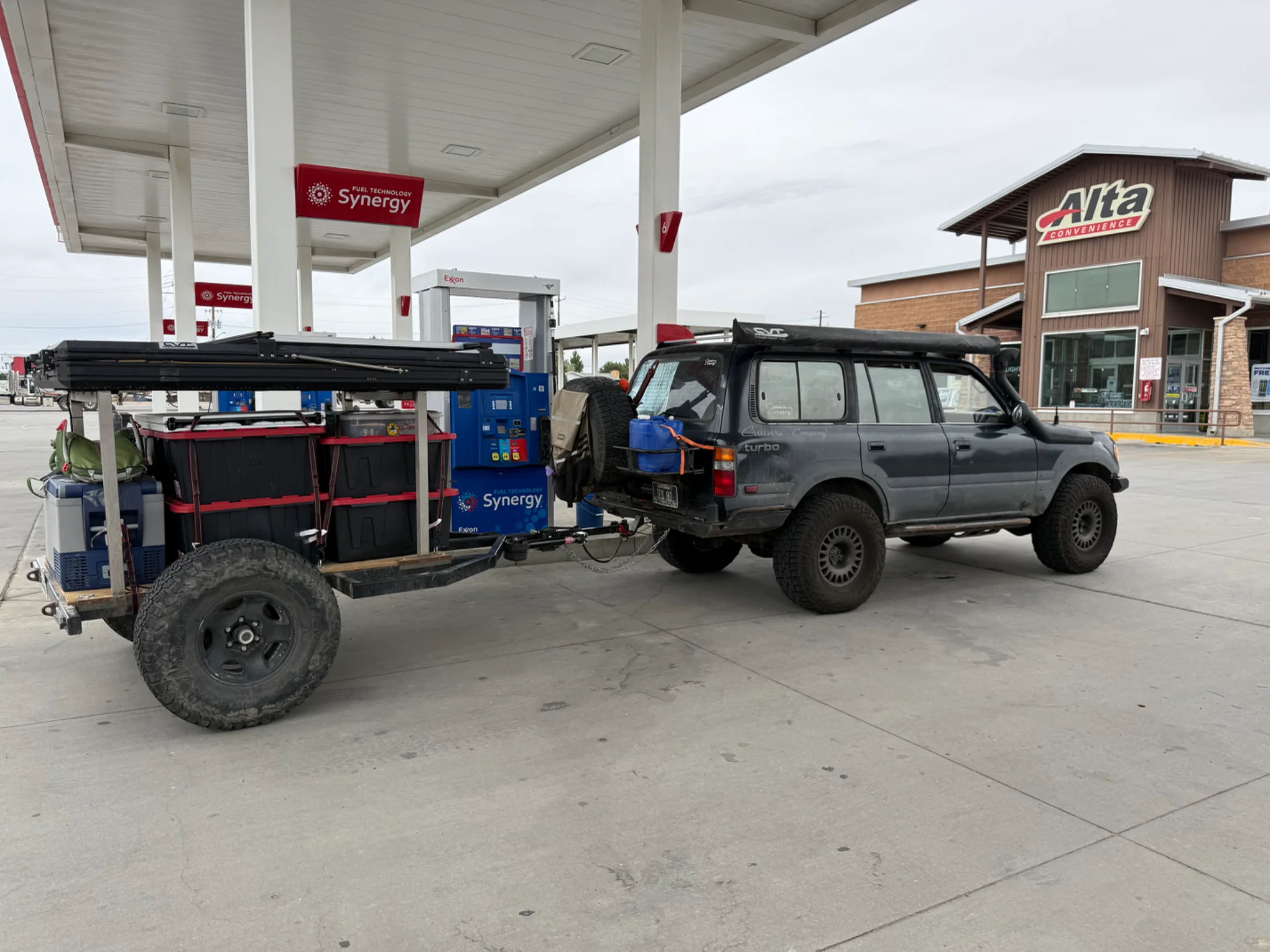

Drinking gas headed north… will see it in a week and start knocking out the rest of the lunch list…

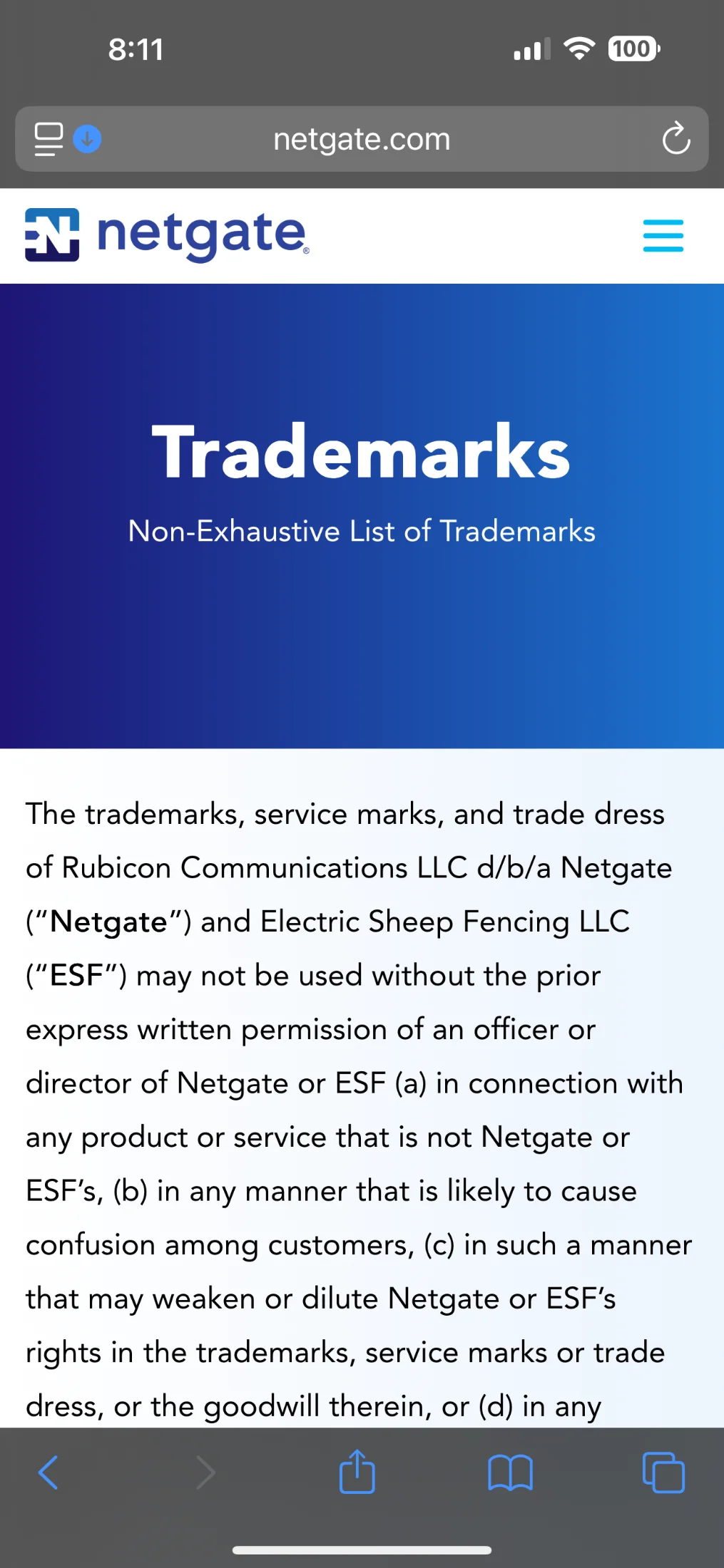

Yeah, my company is called Netgate and the affiliated company (also mine) is “Electric Sheep Fencing”, (a Phillip K. Dick / Blade Runner reference.)
One day I ran across this (they used to claim a trademark until I wrote a nice letter to them.)

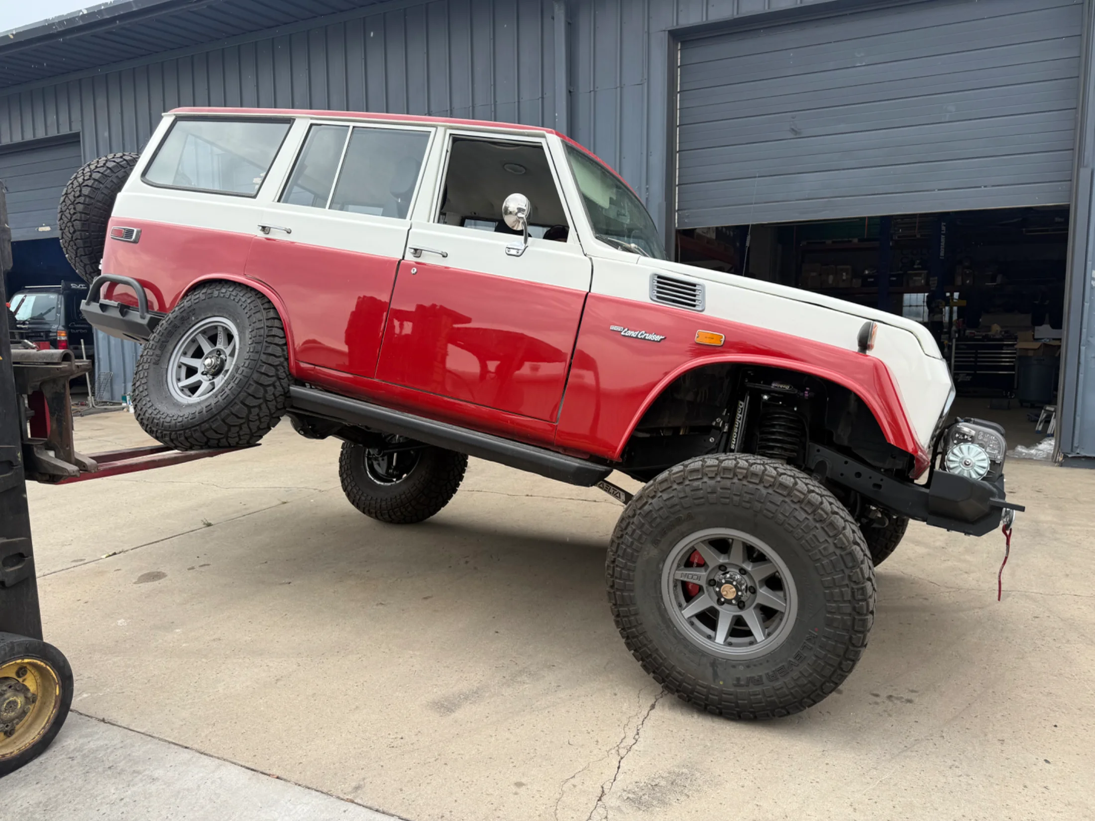

1733075188533-jpeg.3783554

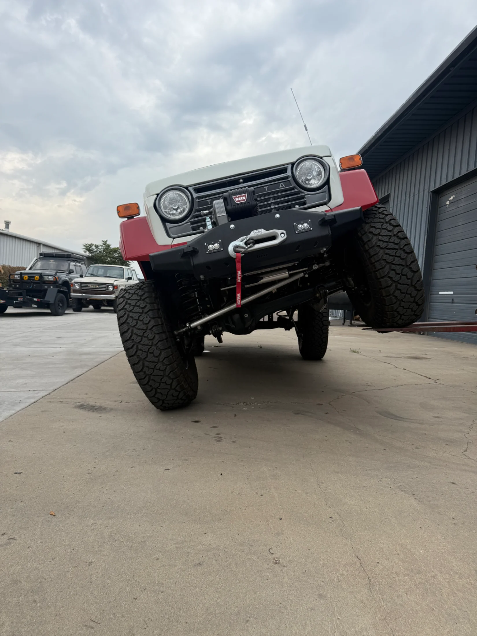

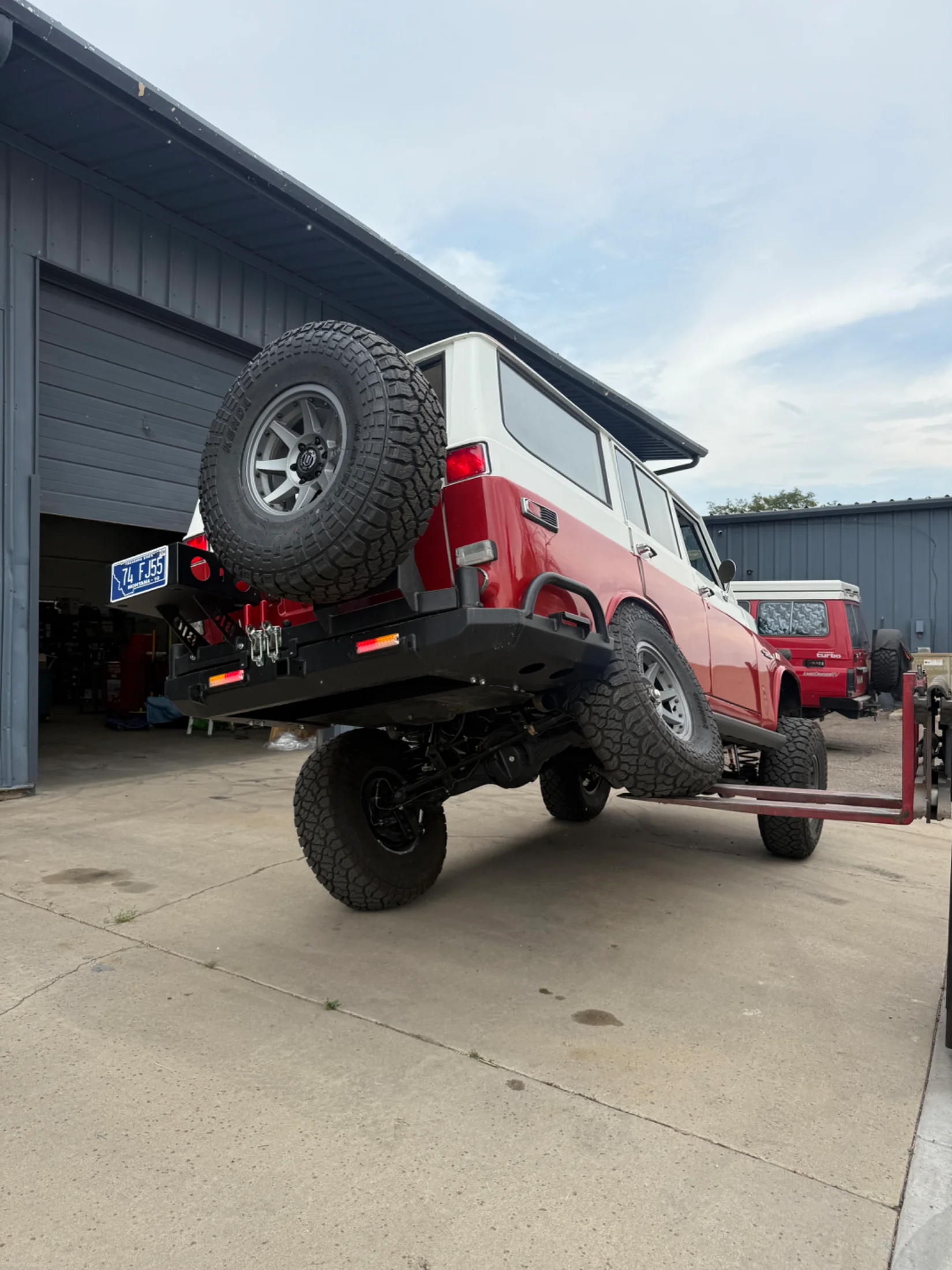

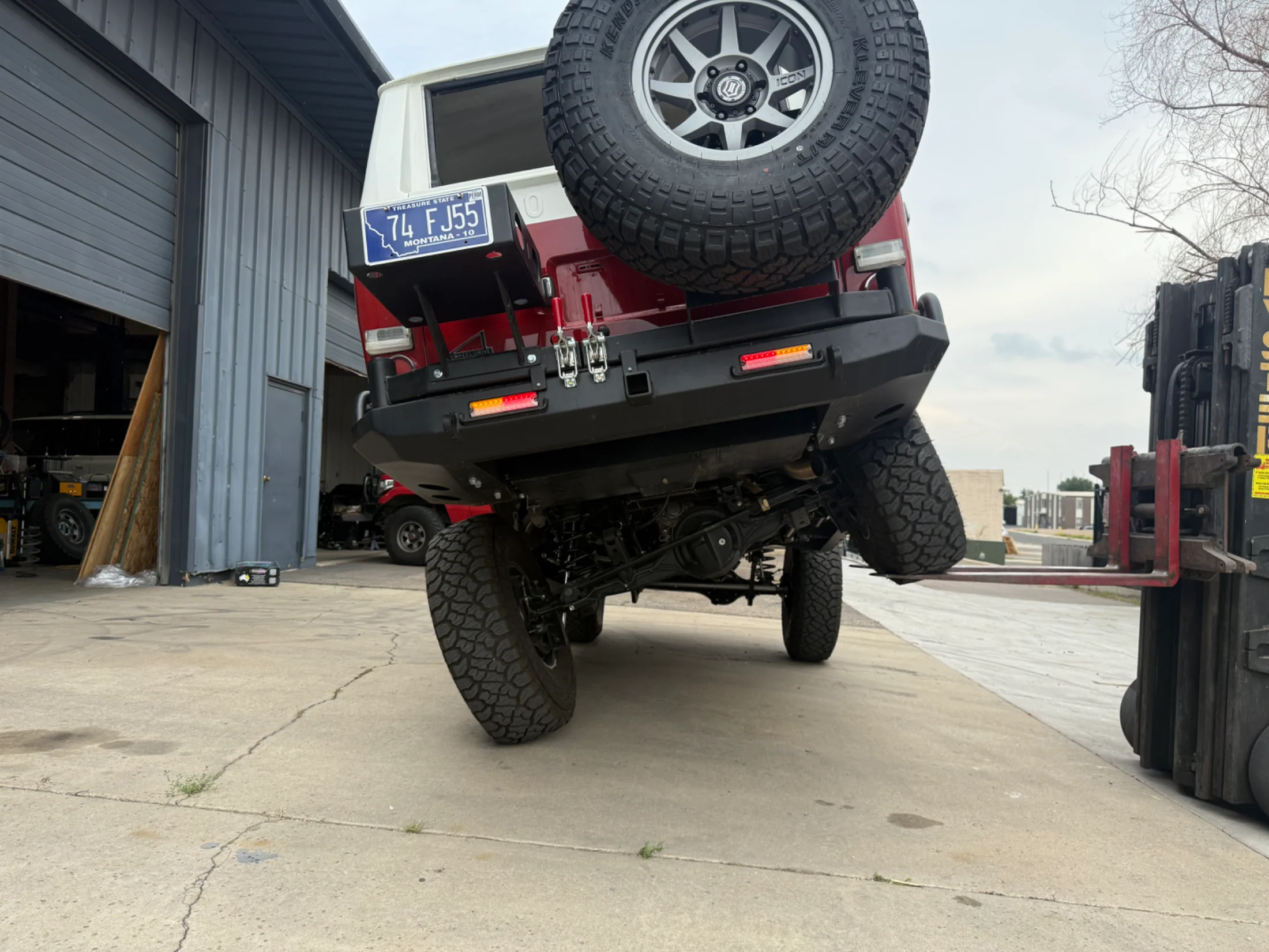

Nice. So is that the point where the tire hits the rear wheel arch? Or does it not hit and that's where the front tire starts to lift? Just curious how you know when to stop lifting as I've never tried that before; not that mine would ever come close to that much articulation. 😂
You stop when the tire is in full conflict with the wheel well or when a tire starts to lift or when it gets to the point of way to sketchy and then you hop in there to measure for bump stops. We had an idea on what it would need at the minimum and it is actually better than I had hoped. That is almost the true amount flex on the rear, front could be pushed further.
Thanks. Not sure what you mean by full conflict but I would have thought you would want to stop just before first contact? Again, I don't rock crawl so maybe some or even a lot of rubbing is fine as long as it doesn't damage the tire??
A bit of rubbing just means you’re racing!
In reality slight rubbing is fine as long as it’s not chewing up the tire or body. It’s also a rare event full stuff actually happens.
