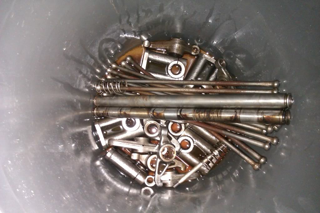

Anyhow, it's been a while since I started this project. I got stranded far away from the ALS Restoration Compound I own up in northern Nevada. Should be back in the shop with Gretta soon. I'll be a heck of a lot more comfy on my turf where the tools and space are ample. While I'm stranded, I figured I'd tinker on the ol' rocker rack and polish the head up. So far I have the head out and am rebuilding the rocker rack.
I almost forgot to mention, I removed the oil pan to have a gander at Mr. Camshaft and Mrs. Engine block and discovered one cylinder was seized. Great excuse to bore her out a bit.
Since I'm not currently at ALS, I'll wait to remove the "good stuff". Soaking her in WD-40 and transmission fluid to losen the rust in the bottom of that cylinder which is only about a few months old (from when I pulled an idiot move earlier this year). Once I get it up to the compound I'll bolt on an ultrasonic vibrator to free the piston as I tapp it out with a block and mallet.
Don't worry, I'll post pictures and video soon of the whole process including the rocker rack rebuild. Be patient please, I want to cover every detail with explicit instructions for everyone who needs them. But for now I guess I'm stuck being a tease.
Just look at those rusty pushrods, what a shame, on me even. Yup, I goofed when I went to pick her up. I had to be the kid at Christmas and peek before it was time. Spillage happened and humidity entered and presto, rust.

[Ex. 1] Rather than take chances with the old pushrods, I decided I will mill new rods on the CNC lathe and refinish the rockers and possibly the lifters if they are also wore. For now I'm soaking the rocker assembly parts in a special oil bath to remove any burnt on oil. You can see in the picture that the rockers are coming out quite clean. Those pushrods are rusty and I don't trust their integrity.
