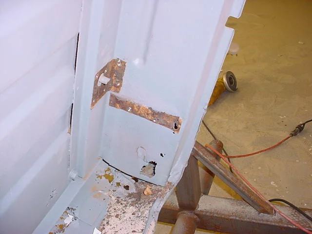

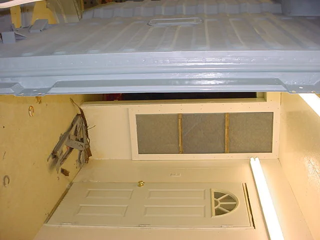

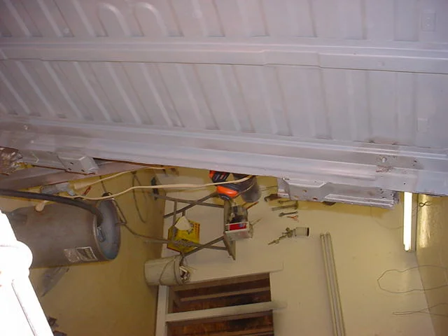

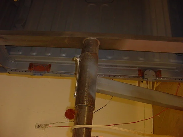

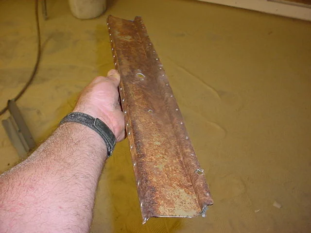

Got a couple hours out in the shop tonight. Figured I would tear into that rear sill that is all bent to hell.

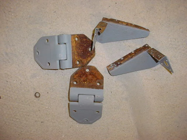

I removed those covers that cover the rear hinges on the sill. I'm pretty sure this vehicle was orginally red on the lower half, always kinda suspected it, but confirmed once I removed those covers.
I blasted the tops of the philips head bolts to get a better bite with the impact driver. I busted the bit in one of them, absolutely rusted solid on all 6 of them. So, I drilled all of them out.

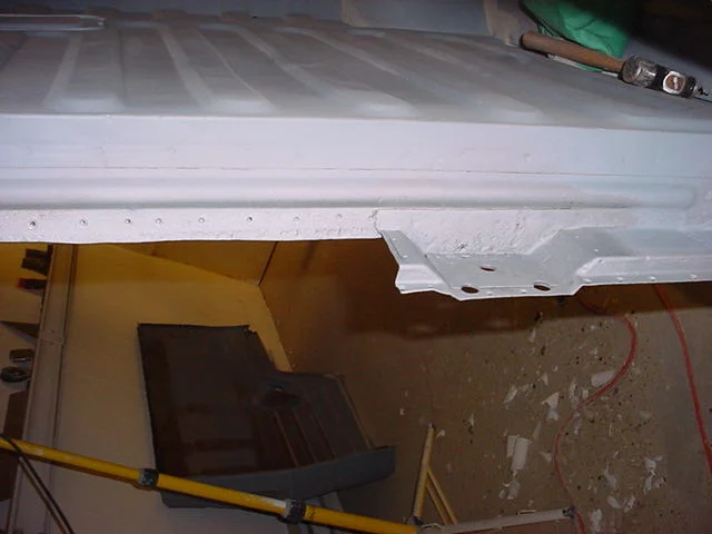

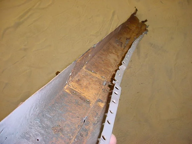

You can also see the spot welds I drilled out on the rear sill, and then cut into a portion of the upper sill on each side of the hinge mounts, it was bent pretty bad in between that area. Sheared along the back side, that was also bent pretty bad, so took all of that off. Figured I would go with all new straight stuff.
Got the rust stuff blasted and primed tonight, so next time I'm out there I can start fabbing and welding in sheet metal :)
Matt

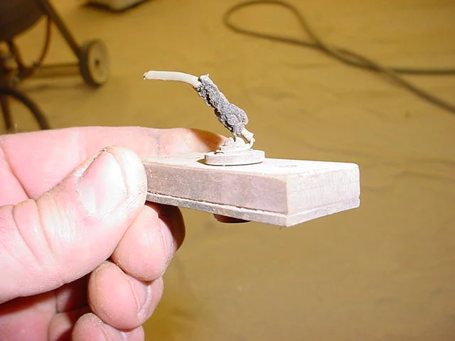

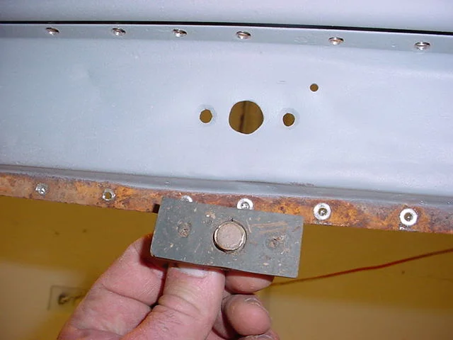

What is this little small part with the wire on it? It was floating around inside the boxed in area in the rear sill? I'm assuiming it bolted or screwed into that rear hole in the sill that I took a pic by a few photo's down????
So, I guess it was a basicly a sound body except for all of the body then............:rolleyes:
At the rate you are going you will have a hand-built copy of the body....:D

I still would consider it a pretty good body as far as rust was concerned. It has/had some rot, but better than some I've seen. Floor for the most part was completely in tact, wasn't to much to do there. Rust in the usual spots for any vehicle that's 40 years old I guess. I would also say that those boxed sections I'm pulling apart with all the rust inside....... Every LV has that inside I bet. None of those parts were treated on the inside with primer or anything. If you have an LV and it hasn't been taken apart to get inside those boxed areas, it's got rust in there. Not saying that everyone should go out and do what I'm doing, I've just got it apart and most of that metal in the back was bent up bad, so figure I'll kill 2 birds with one stone while I'm here. ;)
I would say the biggest problem with this body is how bad it is bent up, and it is bad!! I'm pretty sure it was used in a demolition derby at one time in it's life. I'll just keep straigtening and replacing steel until I'm done. :)

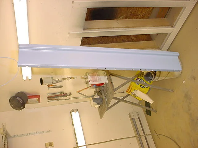

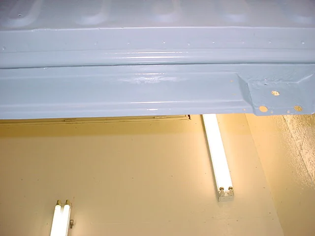

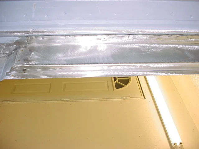

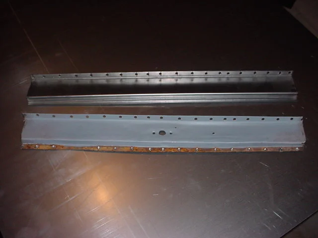

Got another couple hours out in the shop tonight.

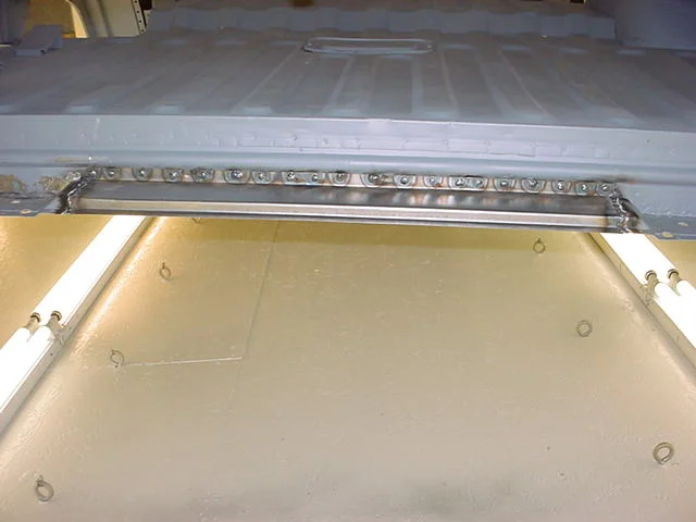

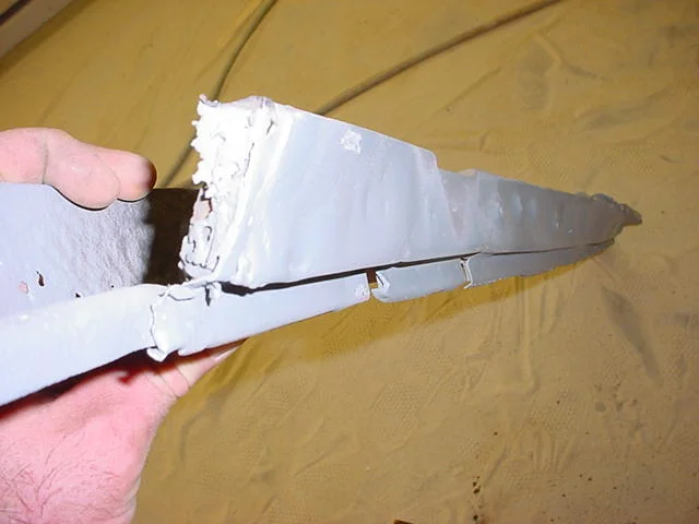

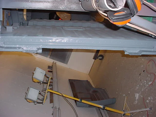

Started by fabbing up part of the new rear sill piece I cut out between the hinge mounts. As I said before it was bent to hell pretty bad, not so much rusty, just bent up as it had been hit in the rear at some time.
Anyway, pics of the new part, welded in ground down and primed. I am very happy with it, after primer anyone would be hard pressed to see what I did :)

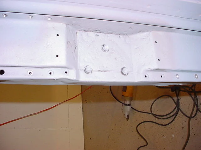

Also started taking apart the hinge mounting boxes that were inside below the sill. I think I will be using one of those mounting boxes and most of the other, just have to bend up a new piece of tin that holds the large plate with the threaded holes. I also cut up and tapped 2 new plates that will be going in there. Pretty basic, 1/4" thick steel, 2" wide, 3 3/8" long with 3 - 8mm x 1.25 holes.
