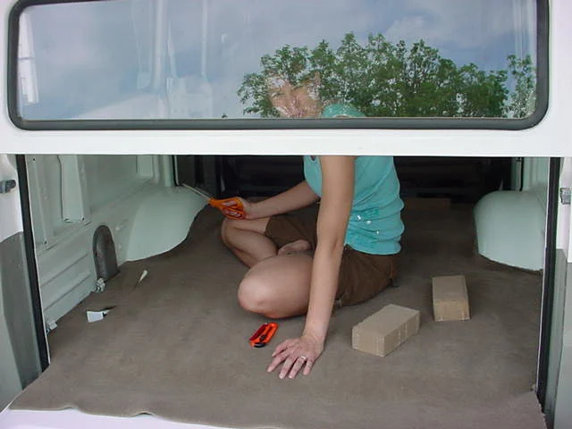

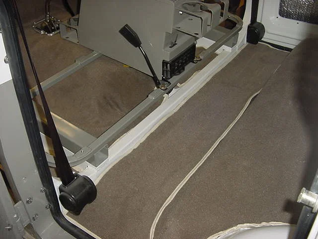

The wife and I took out the carpet again, actually pretty easy to take out without the seats in there. She wanted to go over the binding along the edges to shrink it down and smooth it out.......Iron did a pretty good job doing that.

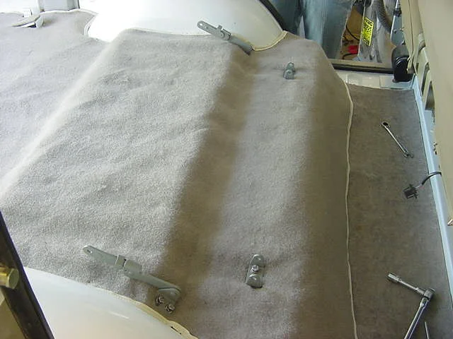

Got the carpet back in and moved onto the seats. Installed the front seats back in again, that was easy. Got out the rear bench that has been sitting around since last January. I had to put a few parts in the back that I got from Semlin and also screw down the backing metal, also had to re-assemble the 2 seat halves. Once that was done it was time to install, but first we had to make holes in the carpet and bolt some brackets down. I positioned the carpet exactly where I wanted it and found the holes through the carpet and pad. I used my butane powered soldering iron and burned holes through the carpet and pad, worked amazingly well. After the holes where there I bolted up the brackets and wedged the seat in there. Lined up pretty much perfect and put all the pins in, fit great...
Had to install the rear seat brackets behind the rear seat below the window that supports the seat, after that jumped right in to try it out.......just like sitting on an old bed spring :D Well, I guess that's what it is, but it was pretty comfortable.

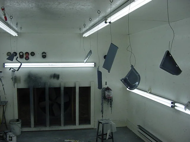

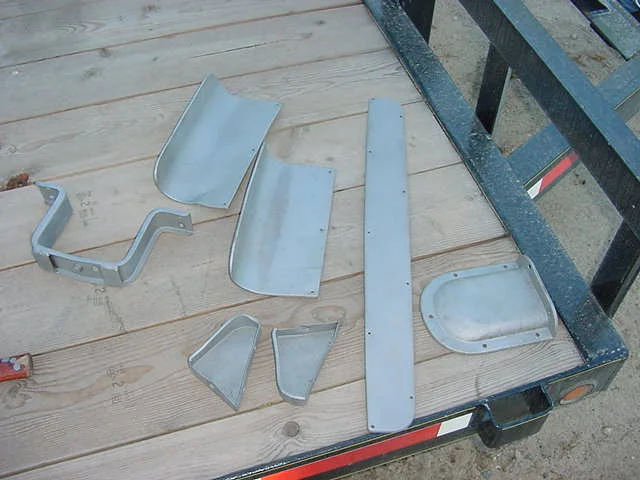

Had a few parts to sandblast and had a few hours to spare so I did that and pounded some metal straight. Hung all that stuff up in the booth this evening and shot a coat of epoxy on everything. Few will need a tad more metal work, but not much. Hoping to get those rear side cargo panels ground down tomorrow and into primer....would like to get some paint on all this stuff before the weekend so I can bolt it on.......Local car show June 10th and even though I won't be done, just trying to get on as much stuff as possible :)
