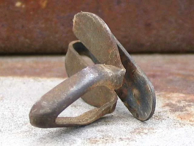

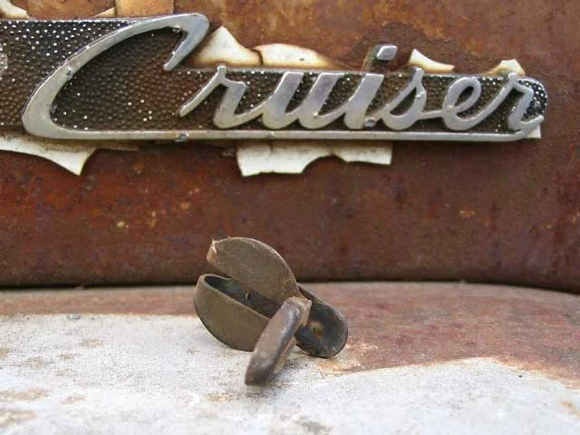

AATLAS1X said:
On a 40 there is a rubber nipple that pushs into the hole on the door so they metal clip fits snug and no water gets onto the fiber board.

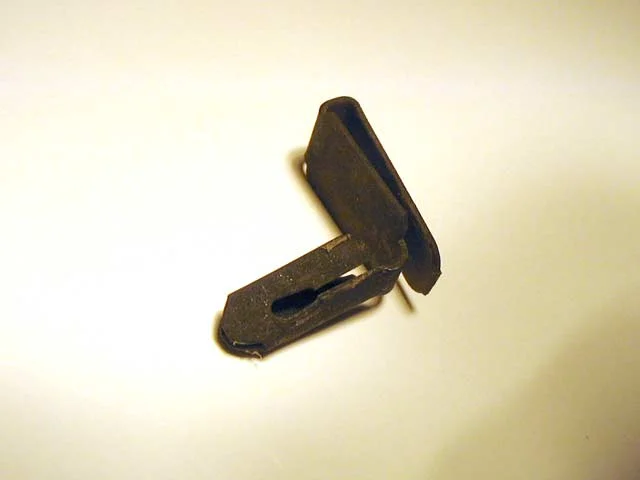

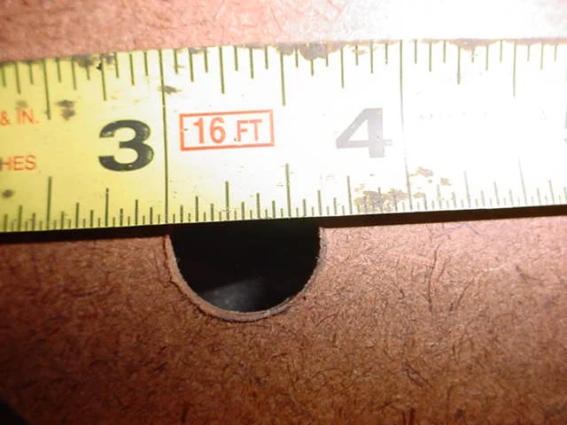

Might be interested in the rubber nipple depending on what cruiserdan comes up with? Have to see about that offset clip he's talking about, but I think I understand. The large holes in the board are lined up, but inboard of each door hole about 3/4".

All is still available, I just bought a bunch thinking I was going to need them.....Did not know that new panels came with clips.

Your clips are offset?
Holes in the fiber board are approx. 5/8".
The are offset from the holes in the door, "on center" approx. 7/8"

I've been following your resto from time to time and have really enjoyed watching the quality of your work and your LV being put together. I made the masonite door panels that you have. Kind of a trip to see somthing I made in my garage, sitting in yours. I have seen several different kinds of panel clips used on the LV panels. I believe the ones that Mike posted here in his pics are the originals, but others will work also. Here's a pic of the ones that came in my LV. They go directly into the hole in the door, without a sleeve going into the hole first like the one in Mike's pics. I do believe that SOR sells LV door panel clips, but I'm not positive on that. Who did you buy your LV from? Just curious to how my panels ended up in your LV.

I'm sure you've got this figured out already, but here's how they slide onto the door panel and why the holes are offset. Note that the part of the clip that goes into the door in the pic above is even with the round part of of the clip in this pic.

The FJ40 clips are still available. The platic cup is a 67772-20021 and the metal clip is a 67771-20022.
Current list on the cup is $.92 each and the clip is $1.09 each.
