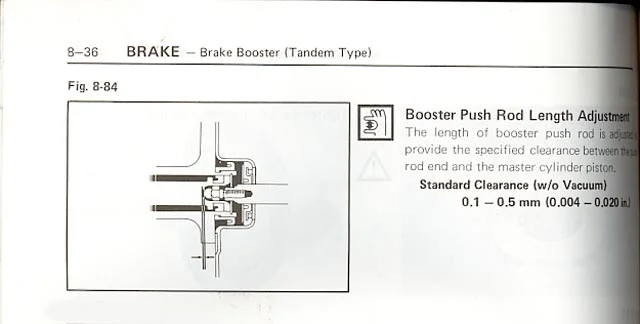

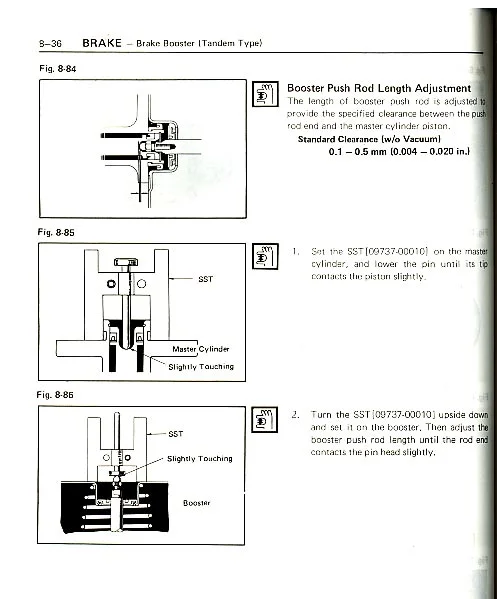

Take the master off the booster and there should be a rod in there. I don't have a FSM handy but the specs should be listed in there. If that rod is too short, the first pump of the pedal is used to take up that slack. Too long....something else happens...rear brakes wont release I believe.
Mike,
If it is to short.....solution? And, have others had this problem? I thought mini truck and forerunner booster conversions were common? Would the rod be to short, or the stroke......solution?
Thanks, Matt
I am thinking myself that the rod might be too short. I remember some time ago lengthening a rod for a vehicle that we did some major change in the brake system. Sounds to me this might be what you are needing to do. Sorry not much help .
Most are adjustable. You will have to get creative to measure it without the SST.

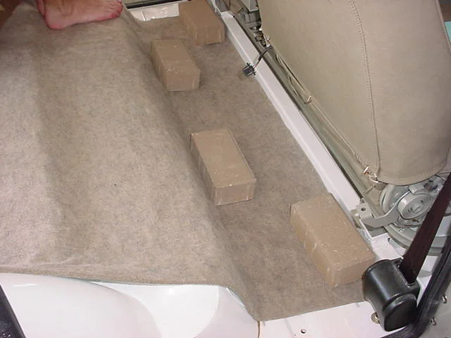

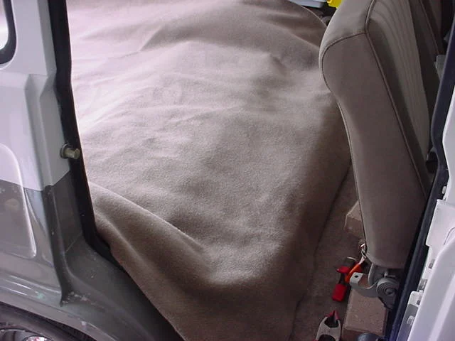

Got a solid 8+ hours in on the lv today, actually the wife was in on all 8 of those also :)
Dedicated the entire day to interior carpet.....not giving up on the brakes. Just had planned to do carpet this weekend with the wife, had blocked out the time for both of us, so that had to happen.
Got started this morning, tackled the back end first. I printed off the pics off of SOR's website and there carpet set. Kinda looked at there stuff as a guide. There were a couple things I changed because I didn't like and a couple things I had to change because of my tranny hump. Layed down the 1/2" sound/heat shield first, that was pretty straight forward. Then layed down the carpet and started marking. I uses some bricks to hold it in place as I pushed the carpet into the corners and marked everything to cut it.
After the pieces were cut we started sewing on the binding on the edges. We couldn't really find a vinyl to match the beige carpet, but could find one that matched the white on the seats. So we decided to go with the white edging, I think it looked ok. Sewing that binding on was a real pain in the ass. Had to staple it on about every 2" so it wouldn't bunch up in the sewing machine. Then after it was sewed, had to sit there and pull out all the staples......anyway, done now and a few pics of the finished product.
Hoping to get my rear bench back together tomorrow and installed, toss the front seats back in also, but that only takes about 5 minutes. Probably try to finish up the trim around the headliner also.
