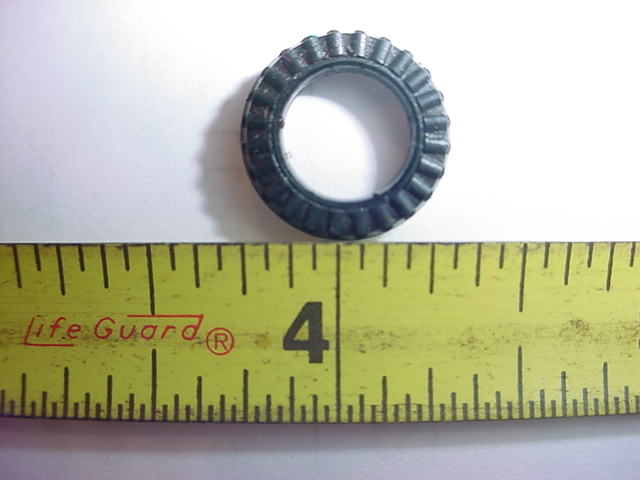

Got my rear wheel brake cylinders from CCOT today, after work got those installed with new pads. Sorry, no pics for some reason, just in the zone I guess.
Mechanic buddy and I got out the air bleeder and started to bleed the rear brakes.........nothing, fluid would not go down in the resevior. So, he's thinking something is not allowing the air to go through. So we pull a few lines and determine it is the proportioning valve below the M/C bolted to the brake booster, at least that's what we think it is.
So anyway, we take that of and pull it apart. It is pretty rusted up in there, take it apart with all the springs and stuff and clean it out. My friend is think the seal in there (see pics) is toast, he thinks it is streched out and isn't going to work....I kinda agree with him. We put everything back together, but without that seal. We think we know it isn't going to work correctly, but we still thought there would be brakes?
We were able to bleed out the rear cylinders now, but even with the rear pads adjusted correctly it just will not get any pedal pressure. Were able to pump up pressure, but other than that it goes right to the floor. So were obviously thinking that seal and valve are important.....but we still thought there would be pedal pressure, just out of proportion from front to rear.
Anyone have any experience with this on 79? Last pic is of my 77 FJ40, same thing.

Found this in a search in an old thread I started
toddster - The residual valve is located in the MC. The one under the MC may be a metering/proportioning valve. The residual valve is supposed to keep 10lb of pressure going to the rear drum brakes...
If you have to pump up the brakes, the pads aren't adjusted, there is air in the lines, or the residual valve in the MC is not working or missing. Why the metering/proportioning valve is even there I don't know. Now that you have fluid going through it, you could probably put those seals back in and it would be fine.
Make sure this wasn't removed ---> http://www.ih8mud.com/tech/residvalve.php

Hi Mike,
The rear pads are ajusted, we know that. Air in the lines, anythings possible, but I think were going to have to rule that out.
I wish I would have gotten a better look at the guts of that valve. I was holding my thumb over the brake line so not to drip brake fluid over the inner fender wells and peel paint. While my mechanic buddy was going through that valve. He tried pushing air through it with the air hose and it was solid, so he took it apart. I know he thinks that seal in the pics is to big, at least that's what he thinks.
Question, in that tech thread, why did they remove the guts of that stuff, purpose?
On another note, thanks for the info and thanks for hosting those pics :cheers:
Matt
it was removed for a rear disc brake conversion. Disc brakes would stay locked up if there was a 10lb residual valve in place. Drum brakes need the valve so you don't have to pump the brakes up each time. The springs on drum brakes are enough to keep the pads away from the drum.
