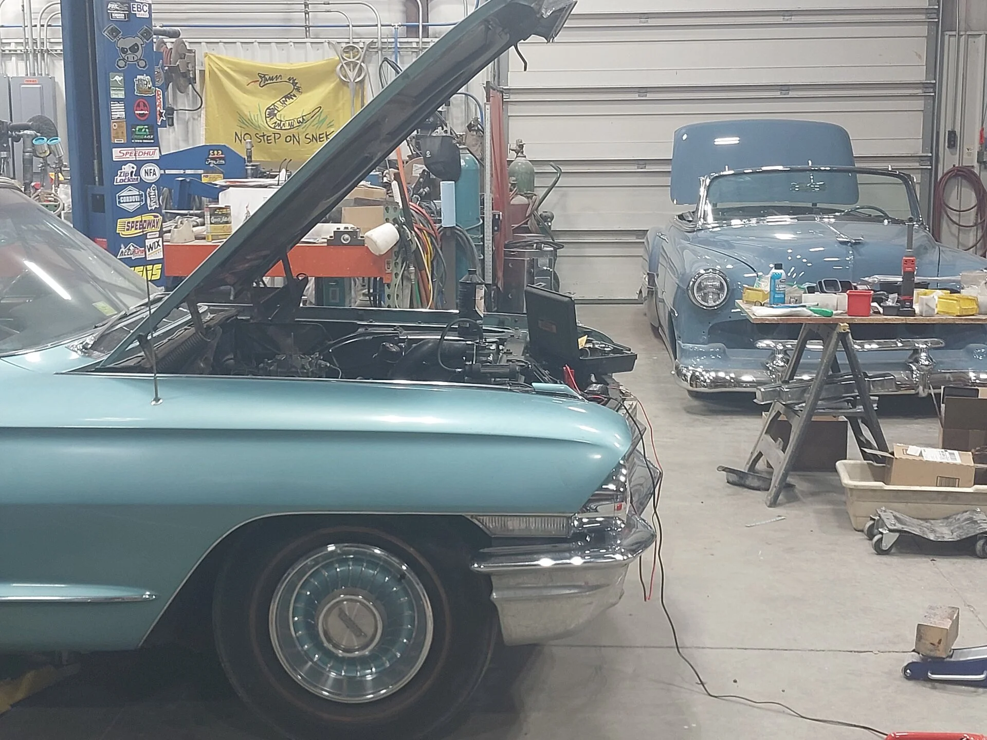

Checking everything over and firing it up for the first time.

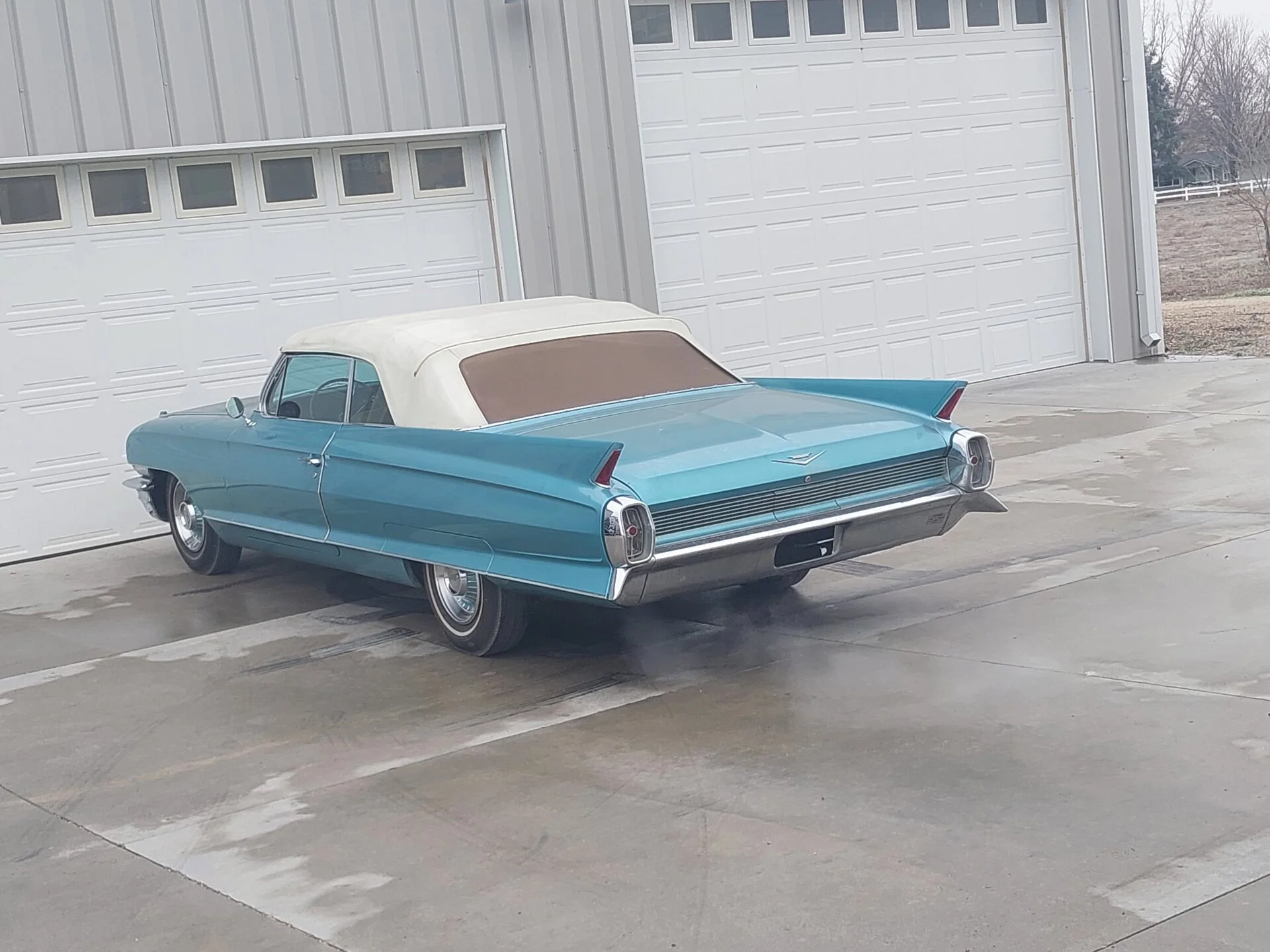

I got three of the four brakes working good enough to Back it out of the shop, I believe this is the first time it's moved under its own power in 50+ years.
Car is back in the shop now and I have a few things to do before I pull the engine and transmission to rebuild them.

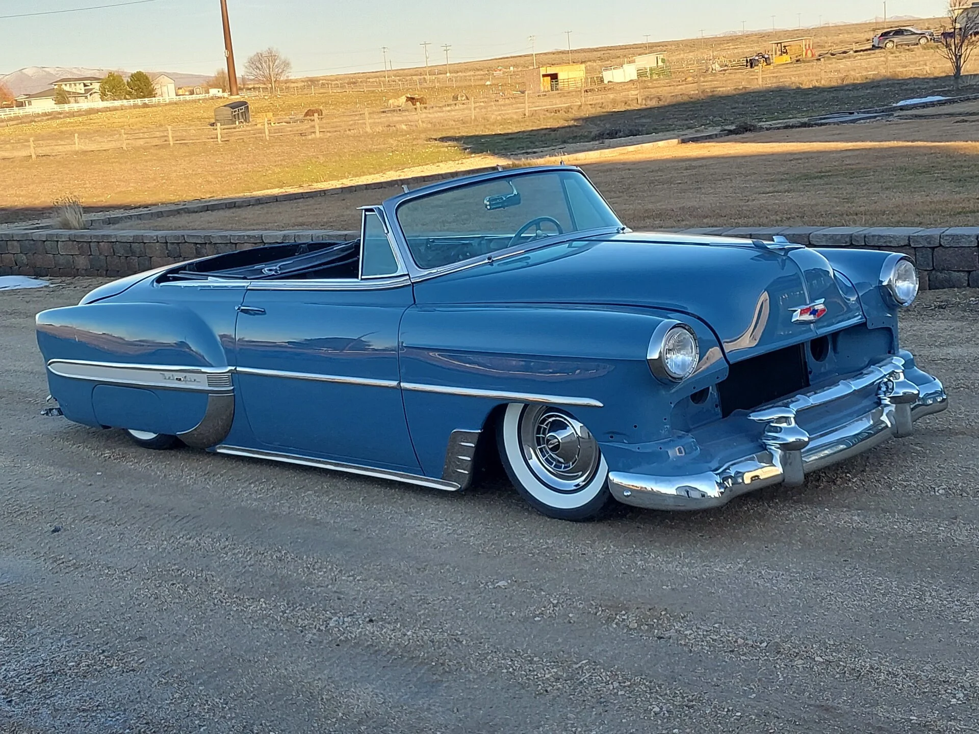

Thanks Bob, Chebby is at the upholstery shop.

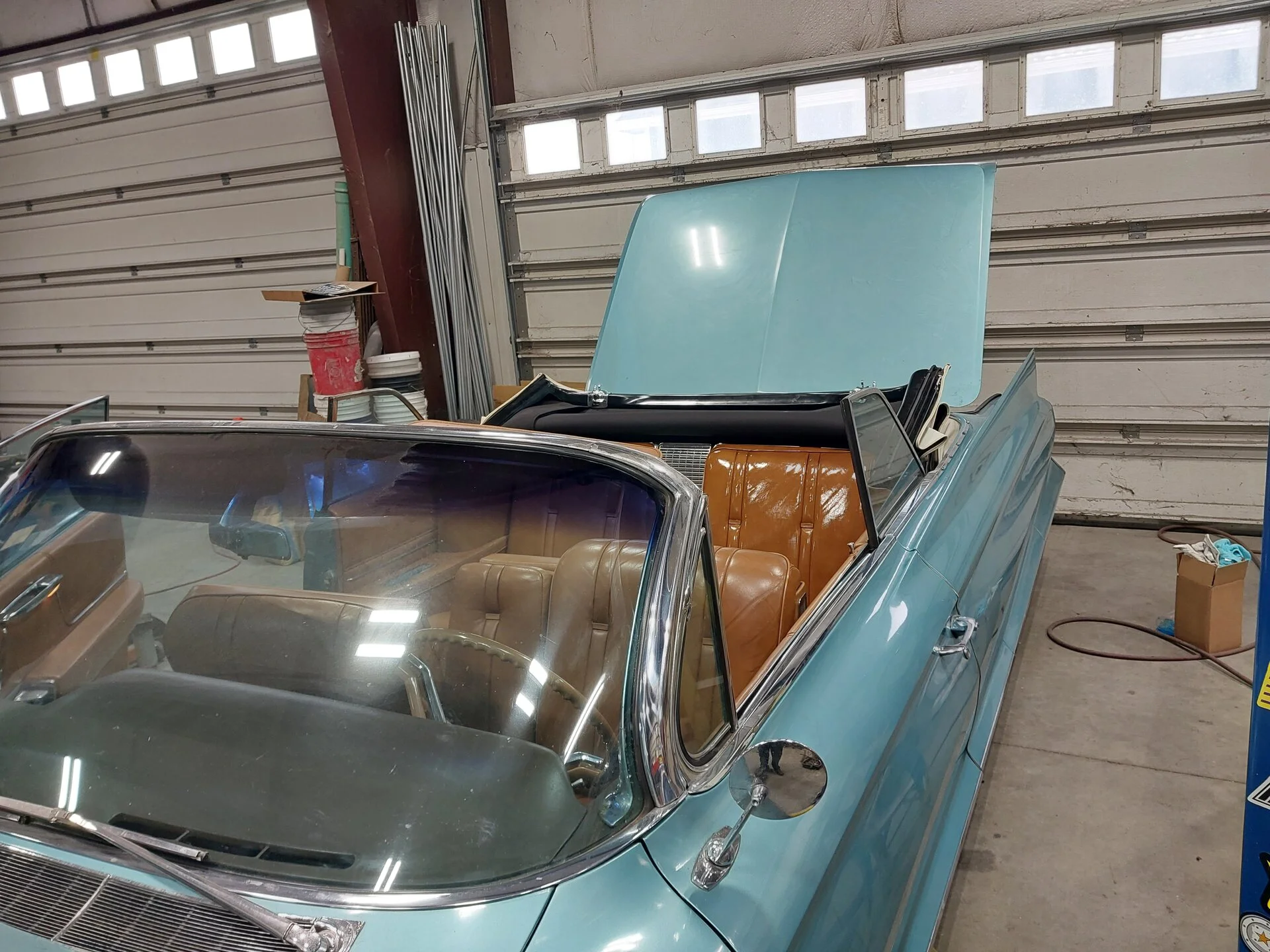

I rebuilt the hydraulic pump for the top and it goes up and down now..

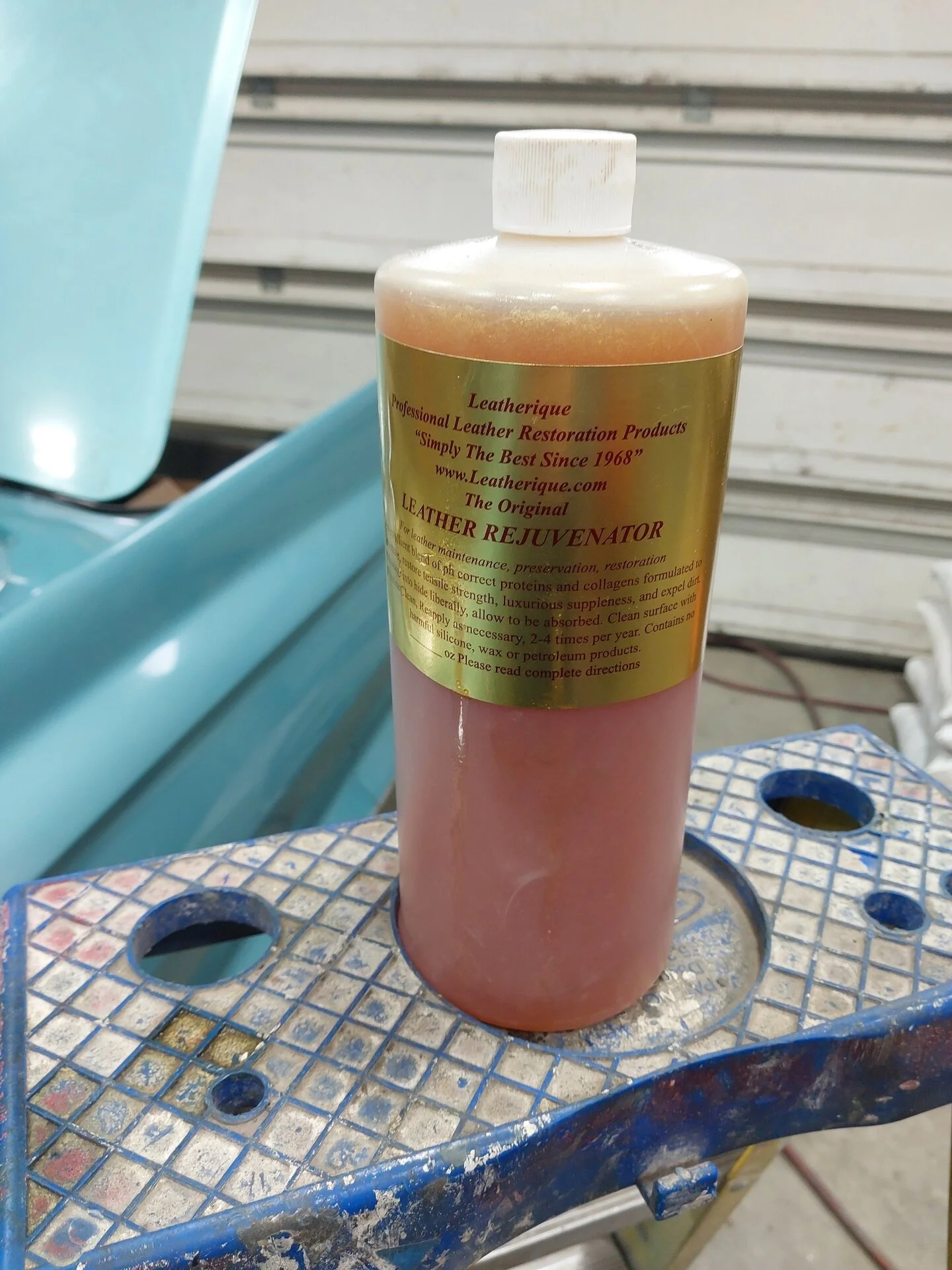

Magic leather conditioner according to my upholstery guy will make the leather like new again.

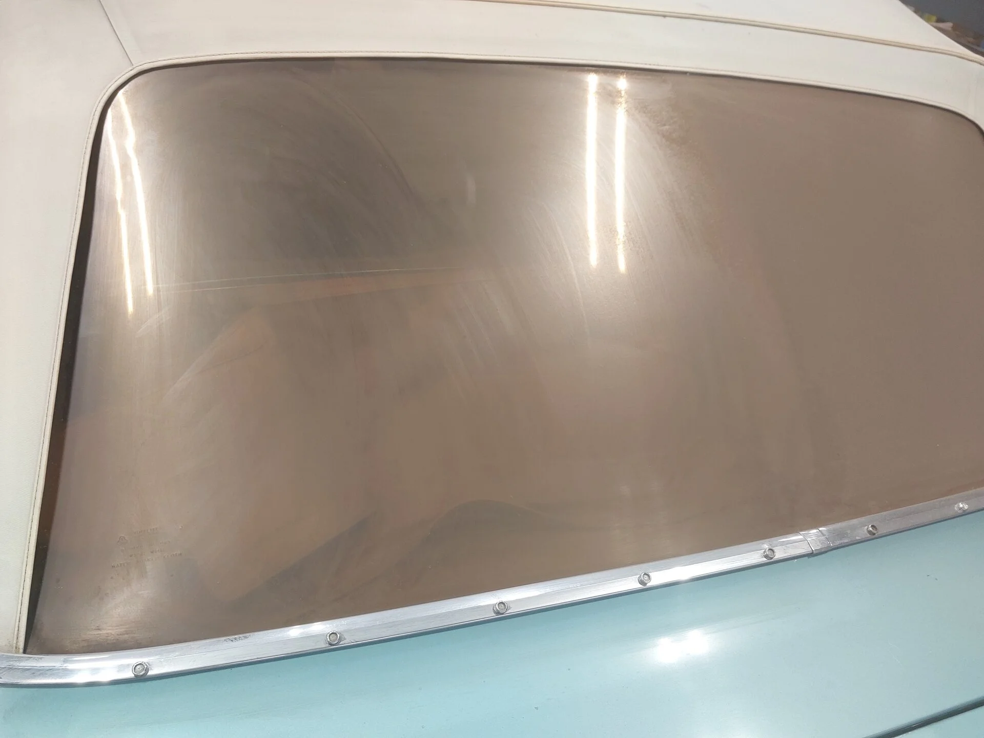

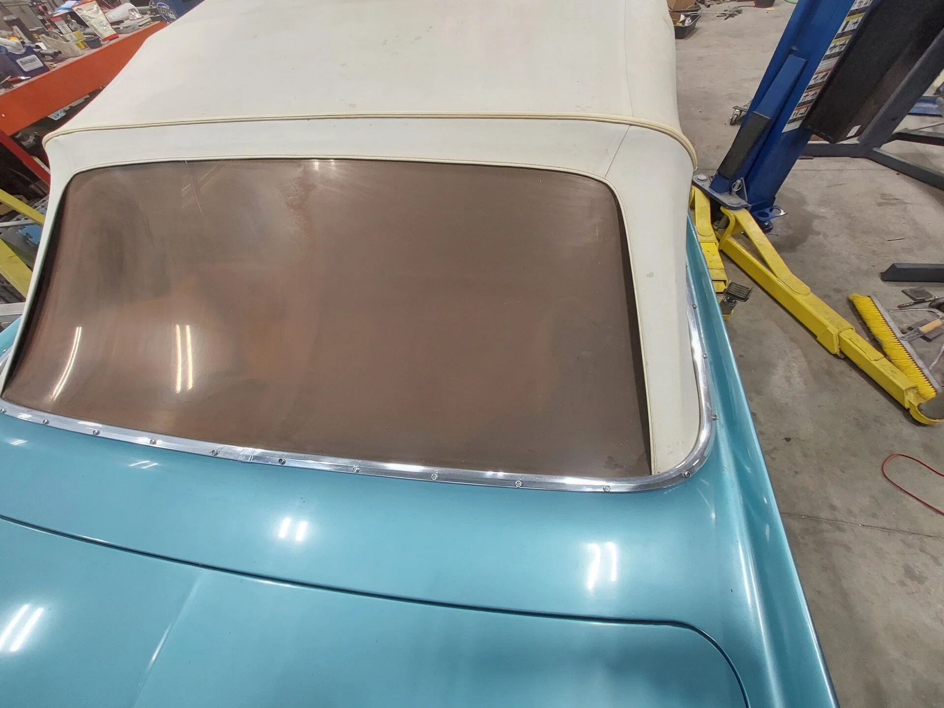

I polished this window inside and out to get it transparent again, if you go up to the photo when I backed it out of the shop for the first time it looks like a piece of cardboard in there, a completely brown opaque rear window. I was asking my upholstery guy about replacing this for me and he said he’s had some success with polishing and if I could save the factory plastic it would add value to this survivor.

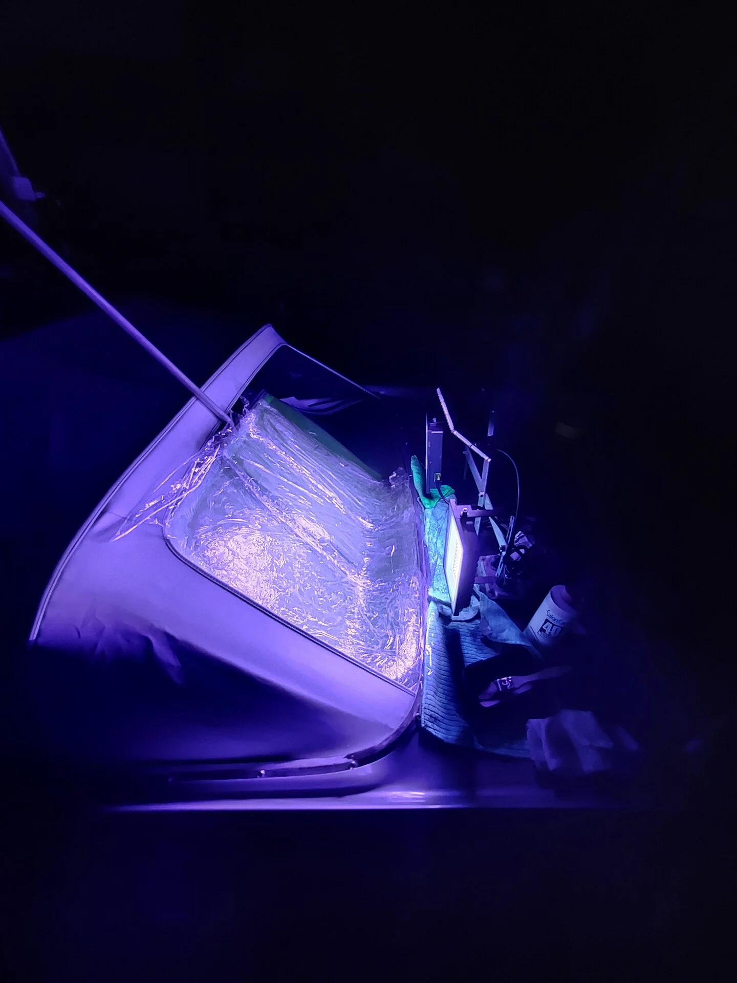

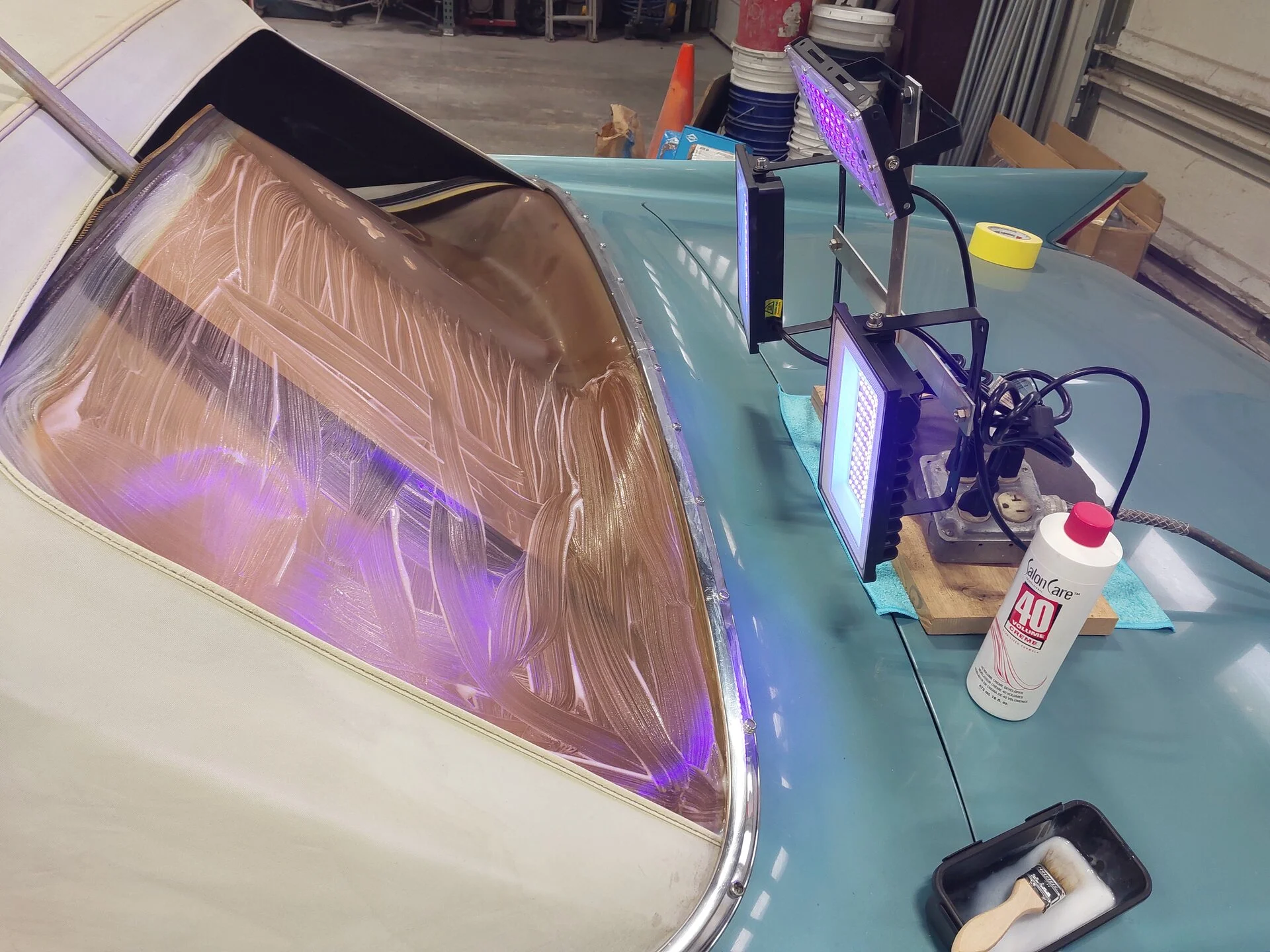

The polishing went really well and exceeded all my expectations but it still has a slight brown/yellow tint that I’m trying to lighten. When looking up “How to lighten yellow plastic” I found a bunch of information on the process called "retr0bright" that the nerds use restore old “retro” computers and game consoles. Some info here: Retrobright - Wikipedia - https://en.wikipedia.org/wiki/Retrobright
If you have followed any of my other builds you’ll know I’m not a stock resto guy and all this seems like a giant waste of time and money that could be better spent cutting the springs out of this car and adding air bags but I’ve had several people approach me and advise to keep this car as original as possible and rebuild vs replace everything that’s not functioning. This car is a time capsule and with the exception of the radiator and fuel tank that were gone by the time I bought this car it still has everything it left the factory with in 1962 so for now I’m going to do my best to restore all these parts and get this car running and looking good.

To get into the meat of the chemistry, the retrobright procedure involves these ingredients per the Wikipedia page:
  • Hydrogen Peroxide Solution (30% is consumer-grade concentration)
  • TAED (1mL per 3L of solution)
  • UV light (380 nm is your textbook sweet-spot wavelength)
  • Xanthan Gum/ Arrowroot for a thickening paste (this is just cellulose basically, save money by buying corn starch)
UV light is the propagater in the formation of radical species. It is what will break down hydrogen peroxide and PAA to its respective radical species. These radical species will then break down the conjugated plastics; bleaching it. TAED, from the 1991 paper, forms PAA in a paired electron process, forming anionic species. This means that by including TAED, you would have now two competing chemical processes: UV-initiated radical chemistry and peroxide initiated, paired electron chemistry.
If we're comparing the production of an acetic radical from PAA, the enthalpy of homolysis is ~45 kcal/mol. The enthalpy of homolysis of the *OH radical from hydrogen peroxide is ~56 kcal/mol. (enthalpy of homolysis is calculated using Hess's Law.) I propose that the PAA would be forming radical species in concurrence with the paired electron species (argumenative to the 1991 paper) and that the production is 10 kcal/mol more favorable than hydrogen peroxide homolysis. Having said that, the amount of TAED added per volume of solution is minuscule ( 0.03% v/v). When it comes to industrial scale peroxide addition to catalyze reactions, you generally add ~1-2% mol/mol. This means that if you followed the above recipe, even though that the TAED would be a favorable addition, it's literally a drop in the bucket on any meaningful chemistry. Increasing the amount of TAED would be favorable, and decrease the time you would need to have a part sit in the irradiation bucket. Alternatively, if we're only concerned about making radical species and breaking down double bonds as cheaply as possible, then forgo the addition of TAED and let the plastic soak longer. A negative side effect is that radicals are not selective to react to only double bonds. They will react with anything piratically. By increasing TAED in a meaningful amount of mass, you could end up with a case where the radicals produced work too good and end up degrading the plastic further. Someone needs to perform experiments on this and see if this is a possibility.
The addition of a coagulant to make a paste is okay in theory, but from an ease of process standpoint, I'd just use the peroxide bucket and UV light setup.
It should also be stated that this process is not permanent, and will eventually return to yellow over the years as the plastic is exposed to oxygen. You'd reform conjugated plastics or entirely break down the polymer bonds, making the plastic brittle and chip.
To circumvent that, I propose one should add a UV coating on top of a brighted shell. I'd recommend benzophenones as the main ingredient we should be looking for. Benzophenone-6 ( 2,2'-Dihydroxy-4,4'-dimethoxybenzophenone) has a max UV-absorbance at 340 nm, our magic radical initiating wavelength, with high absorbance as well in 280 nm. It's also safe to the touch. Unfortunately, in concentrated layers it will give a slight yellow tinge. This should prevent further UV damage in the plastic.
