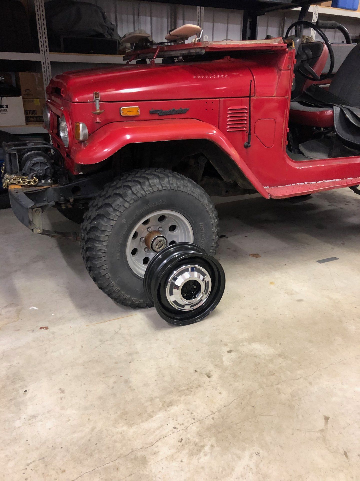

Looking for a little input on running 32/11.5/15 tires on org Toyota 15 inch rims.
1901763
8" wide is probably going to be the recommended rim width. Some will say they are doing it but in the end it will be your choice.
Many here run 10.5s on the 5.5 inch oe wheels...and that is a bit outside recommended wheel sizes...another 1 inch on tire width is likely to be too much.

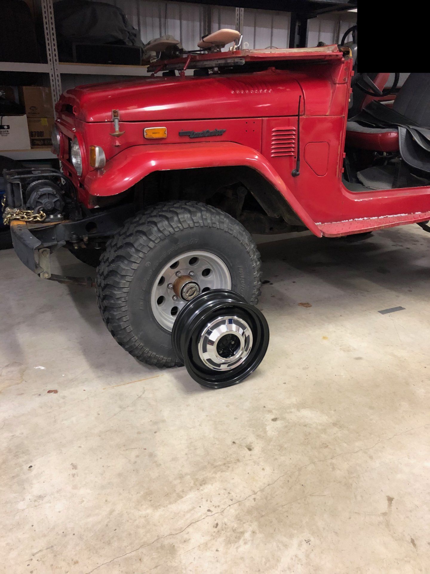

I installed my 32X11.50R15 on a set of OEM rims and had a slight rub on the drag link at a full left turn.....Reinstalled the 32X11.50R15 on my cut & welded OEM 15x9.5 rims, and no issues.
It has 32/11.5 on it now without rubbing. Is that because of the rims?
Yep, all because the rims. Here have a look.
32x11.50R15 on unmodified OEM rims:
1902169
32x11.50R15 on OEM rims widened to 9" with the original backspacing:
1902171

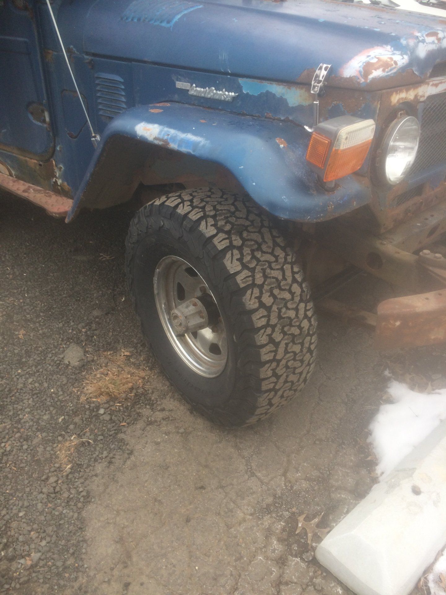

I ran 32/11.50/15 BFG on stock steelies for a couple of years, trails, freeway, every day without any issues. I have a sagged 2.5" lift. I was roundly scolded by some for doing so. After going to 33/10.50/15, it felt like I had power steering.
Thanks so much for the photos! Who know tires were so hard to pick out...... I just order the stock leaf shakes yesterday. Would you go with the same size again? Any rubbing?
I would definitely go with the same size again. I think they are perfect for a stock setup.
