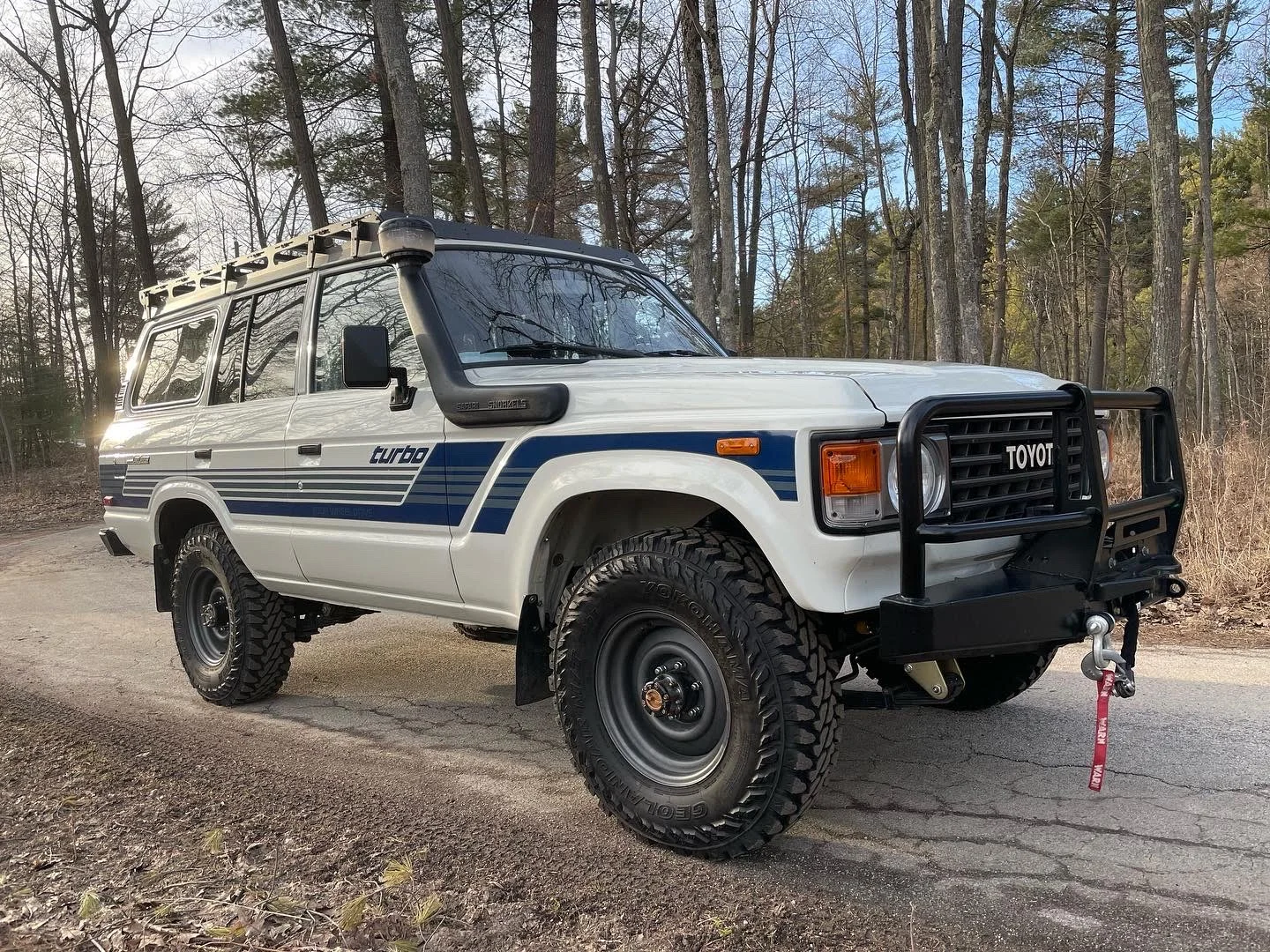

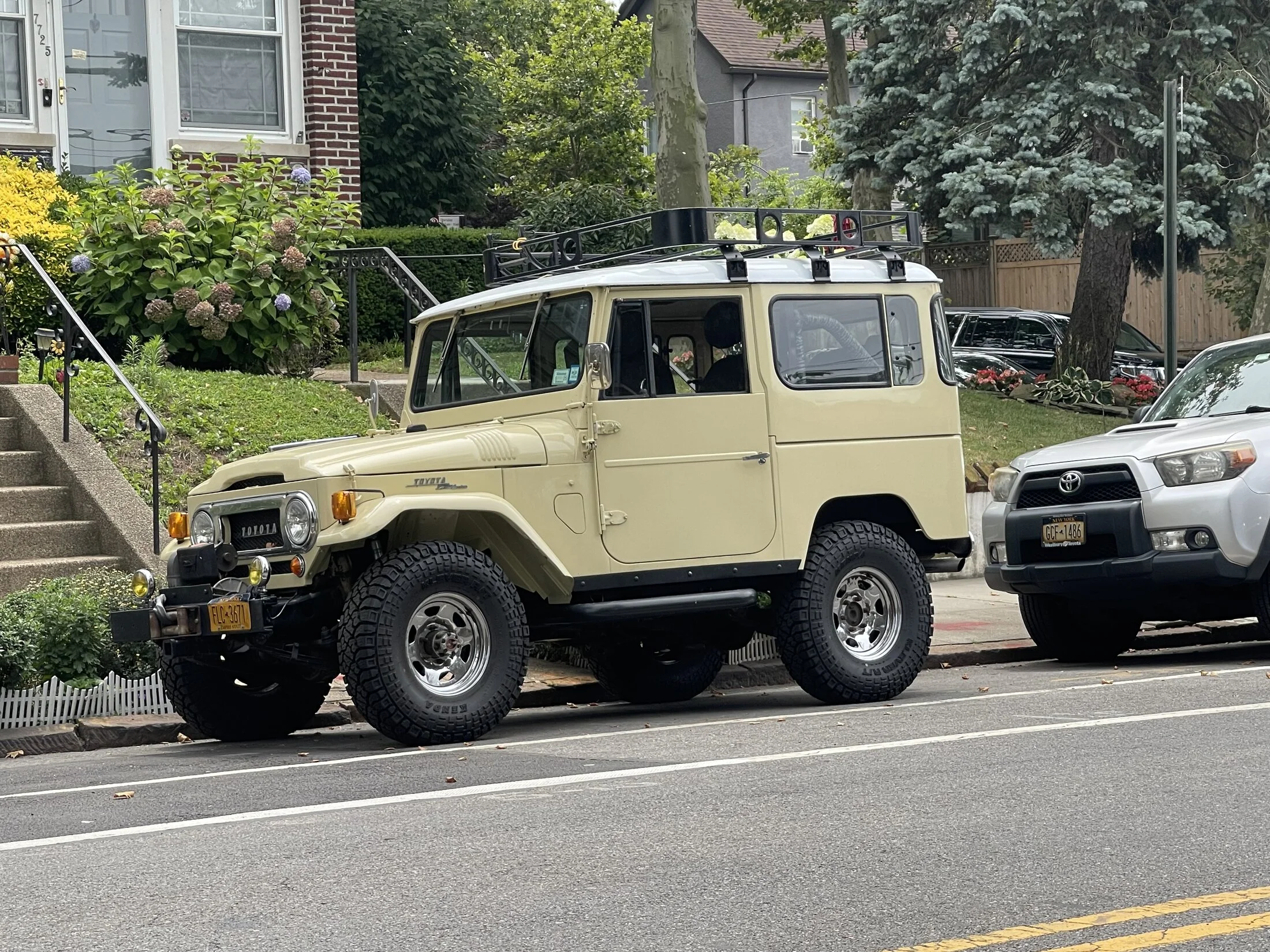

Cost to lightly blast the wheels (no need to remove the chrome) and coat in RAL 9010 - the best match, would probably run around $300 ish. I put 16" 70 series wheels on Jessica's 40 and coated those. Same look with 15" and 33x10.50. I was going for the late 40 series(early 1980's) look.
I can't emphasize enough to be sure to go off white. RAL 9010 is the one. I have done TONS of samples. The brighter whites like RAL 9003 will look right out of the box, but way wrong on your truck. Toyota white is not white. It is off white (yellowed)

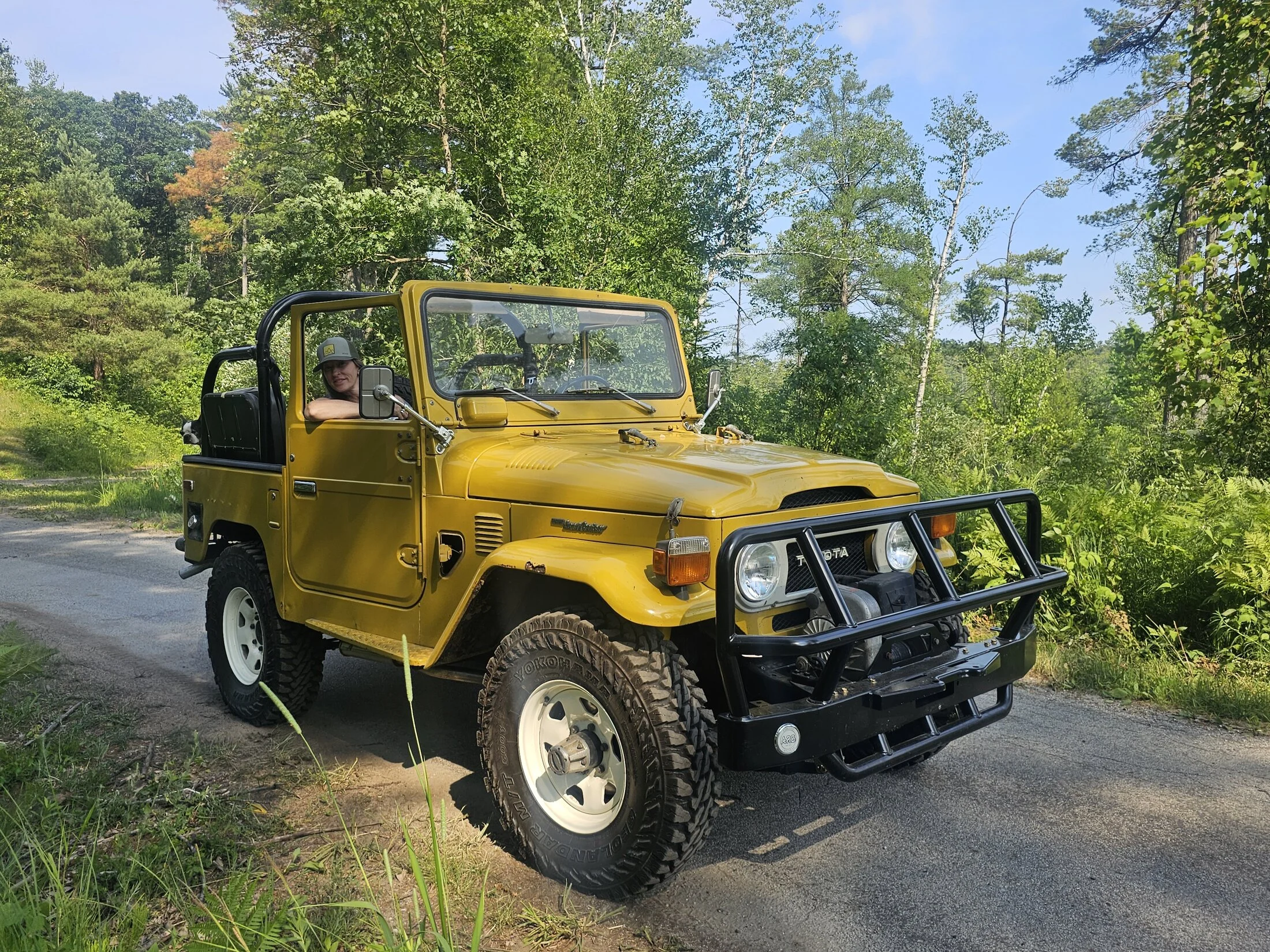

I agree those are very cool. I have them on my 61. If you go that route, buy them from Summit like @RevISK says. The price is the same as direct from Wheel Vintiques, but Summit ships free.
The one caveat- fitting factory hubcaps is nearly (but not totally) impossible
I realize I didn't comment on the CIty Racer wheels, which your thread started out with. I have never owned a set, but I do know that I have purchased a ton of parts and the quality and service has been outstanding. If you want OEM looking steel wheels in a 16" choice that also fits a factory hub cap, these are the only item available. The next closest, and very nice, are wheels from the FJ Company in aluminum. I honestly don't remember how pricing compares.
The one caveat- fitting factory hubcaps is nearly (but not totally) impossible View attachment 3762868
Dang those look great on your truck.
