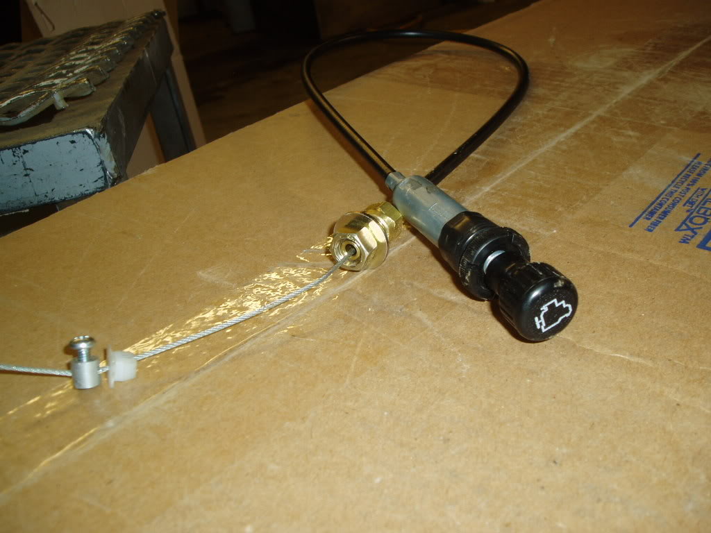

The OEM hand throttle mounts to the hole in the dash below the ignition. No bracket required. Just remove the knockout. The accelerator pedal needs the additional "ear" that the cable connects to. The early US spec FJ80s did not have this.
78120-60080 is the "newer" pedal mechanism with the extra ear for the hand throttle cable. About $35 from our friends in Dubai or about $60 from our friends in Richmond. It is a direct replacement.

Just to clarify, on a 97, do I also need the "ear" for the back of the pedal assembly , or is that just for early years?

Jim, look under the dash there the hand throttle is connected to the gas pedal.
See the 3rd pic down from the thread
you will see the ear that Jonheld is talkin gabout. My 91 did not come with it..

Love my Hand Throttle. Don't need it all that often....but its a blessing when I do.

A hand throttle works wonders in these situations where your road trip comes to a halt due to whatever reason and the road becomes a parking lot or even in slow moving or stop and go traffic. Just stepping the rpm up to double that of idle makes a huge difference.
Just make sure you turn the hand throttle off before putting it into drive. Made that mistake once.
You will have to use your own eyeballs to answer this question. Does your throttle pedal have 2 spots for cables or 1?
