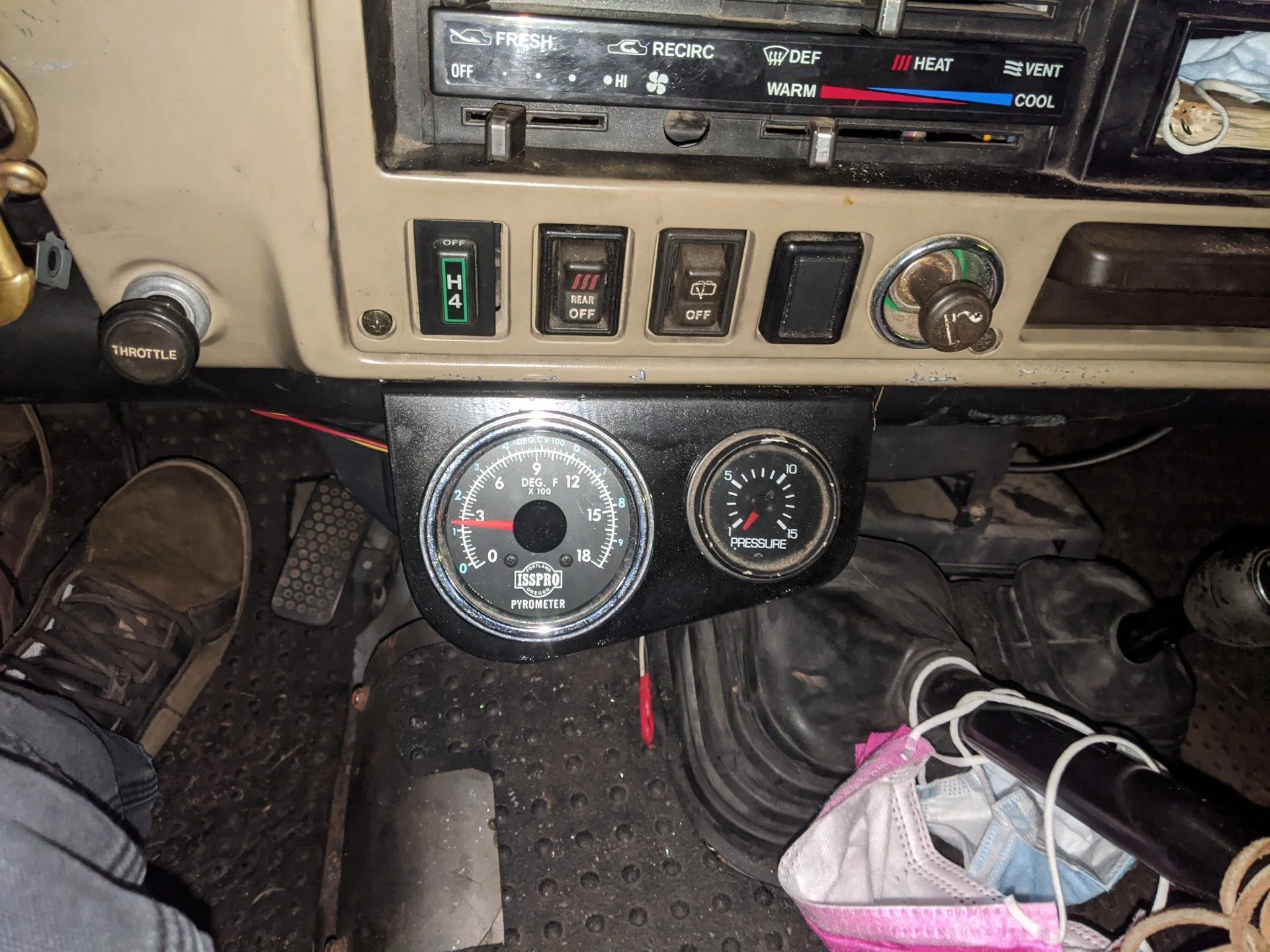

Also did this yesterday. Finally got around to installing some gauges.
Had the isspro for years, self powered so I still have zero 12v draws in the truck. :grinpimp:
Forgot I had that old pressure gauge. Came out of a boat, I had a hard time finding a boost gauge with a lower scale range that wasn't an overpriced autometer piece of crap.

Also did this yesterday. Finally got around to installing some gauges.View attachment 2470808

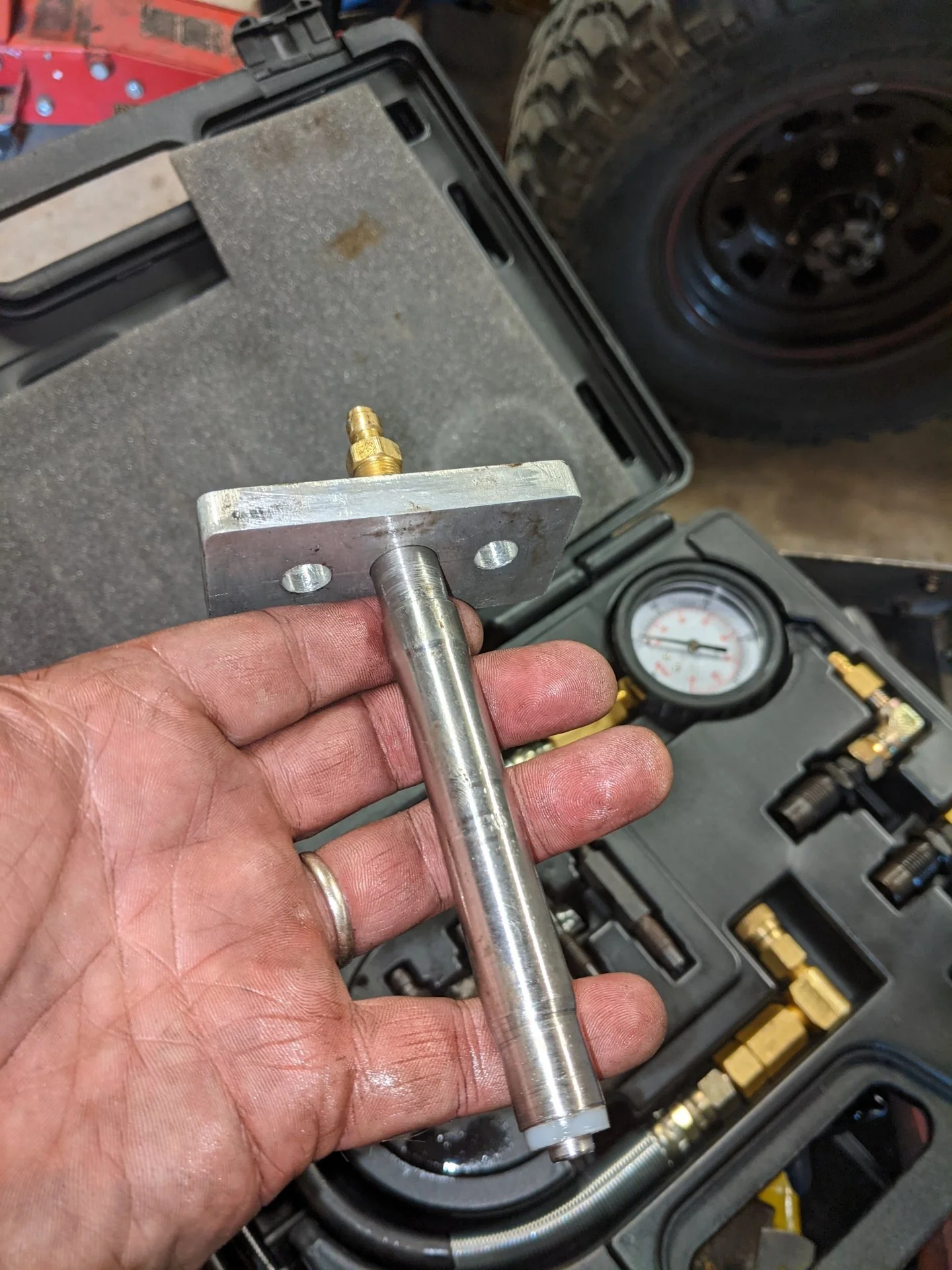

Picked up a full Toyota gasket set from partsouq, and did a compression test.
Had to make a 12ht adapter for the tester first but that was kinda fun.

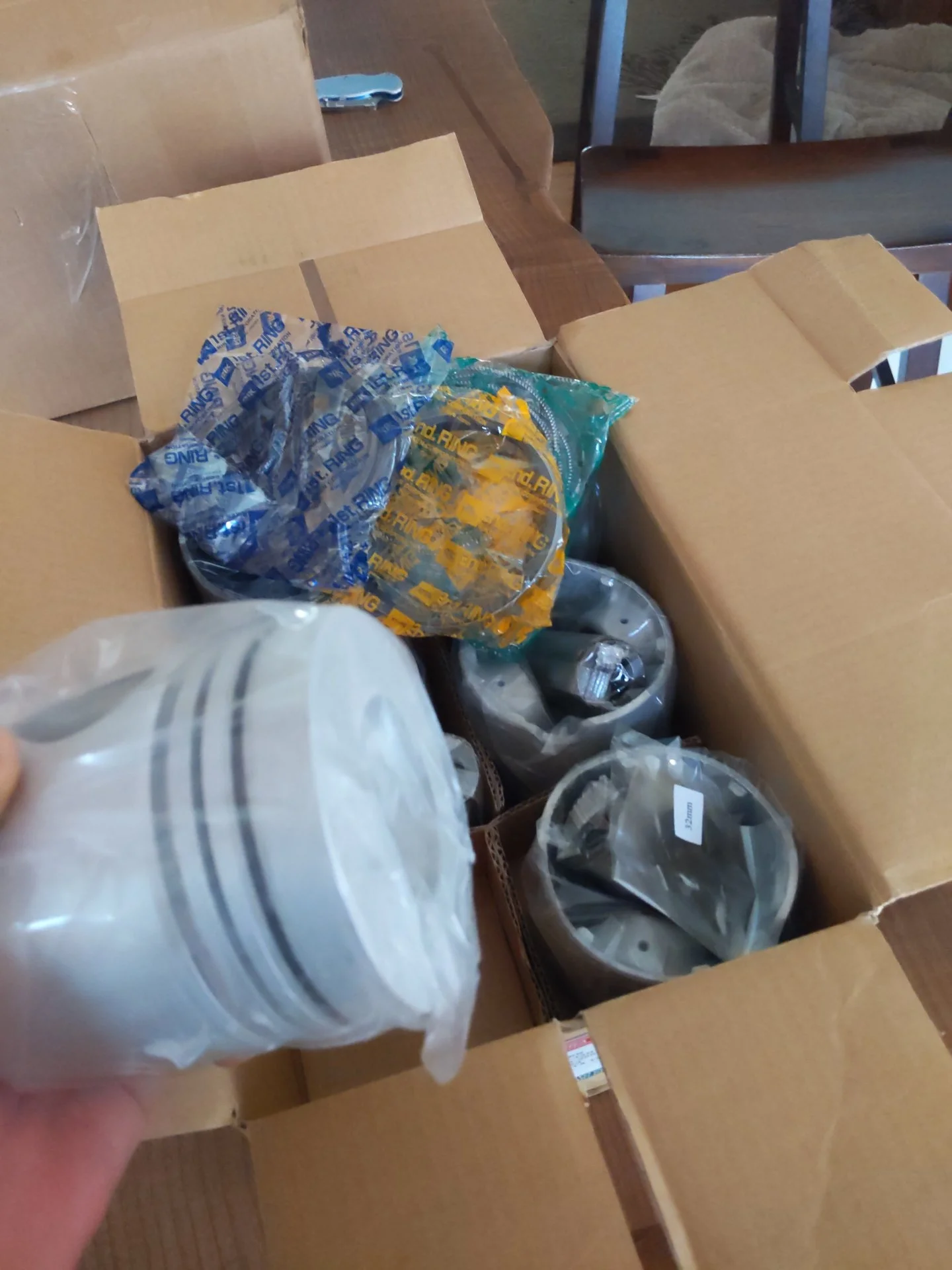

I figured I'd get it apart,see what it's like and decide whether to buy a full rebuild kit or not.
But...I stumbled across a decent deal on some stock sized alfin pistons in the classifieds, and figured it was worth a shot. If the holes are good enough I can bang these in then I'll be well on the way to a pretty decent refresher.
If they're buggered, I can always sell these for what I paid and go for the next size up. Course that's a helluva lot more involved and I'm not sure if really want to go there.

Haha I pretty much have everything other than the crank and cam bearings from a full rebuild kit now for about 1/3 the money. Provided the holes aren't totally ****ed I'm doing ok I think.
Can see another AUS order in my future. A set of new lifters is actually pretty cheap...
