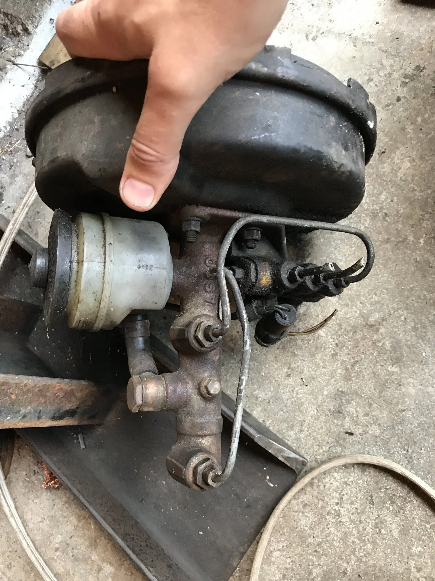

Stock 60 series master that you can have if anyone is driving up there. It worked when I took it out. I'm without wheels for a bit.

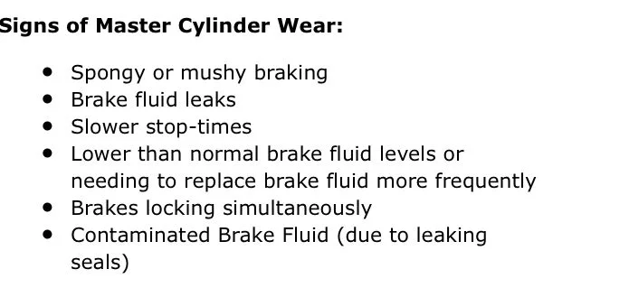

Raybestos doesn’t list no brakes. Glad you’re OK.
bet you’d be happier with any/all of the listed signs.
