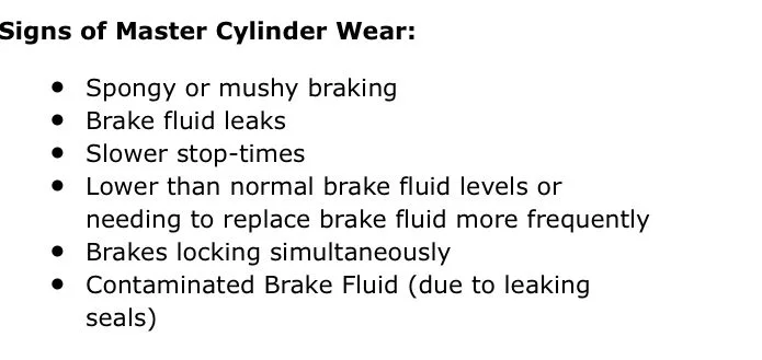

Raybestos doesn’t list no brakes. Glad you’re OK.
bet you’d be happier with any/all of the listed signs.

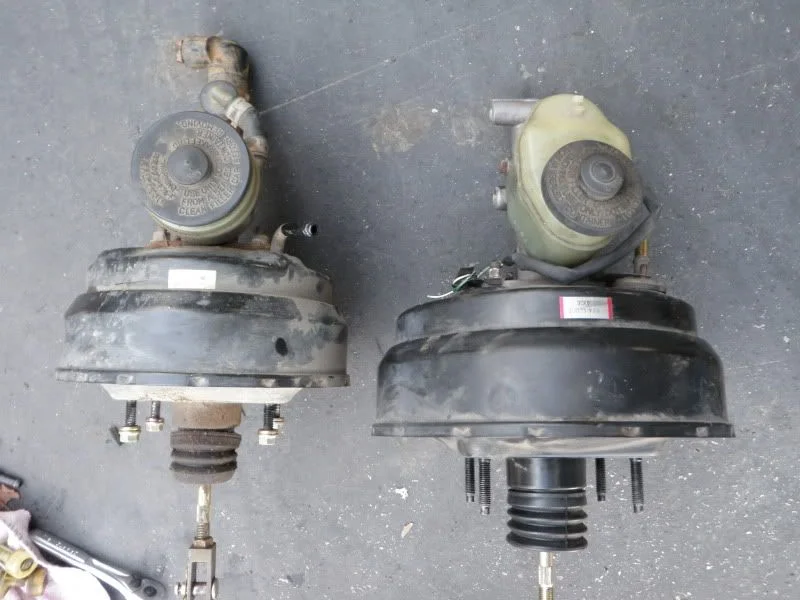

Was reading some debate about the 80 series MC, larger bore equalling less actual pressure at the brakes unless you also have a more powerful booster.
Have to read some more on the subject.
This clearly happened because I sold the Celica last weekend. :lol:
Pair up an 80 booster with 80 master, then you will be good. I’ve needed
mine hard a few times that have impressed me big time.
Yeah, probably what I'll do, although I think the booster makes the bigger difference than the master.
Just trying to decipher if there's a difference between the 80 booster and the t100 etc. They look identical yet the t100 is a quite a bit cheaper which is either the standard LC price gouge or there's actually a difference. ( just going by rock auto)
Found a decent little summary of the parts out there
Found some interesting things on the brakes subject, as I've read more about it than I've ever wanted to.
Turns out 61's and 62's came with a dual diaphragm booster, so I already have that.
Dual diaphragm plus stock size ( ⅞? ) MC explains why the pedal has always felt mushy compared to my 40, no matter how much I bled the system.
Found a pic of a 95 t100 booster next to a 62, considerably larger diameter but how much actual boost you get doesn't seem to be something that has a number value. At least not outside the Toyota engineering lab.
Larger diameter might make a difference, it would make sense, but I think the 1" master will make the 61's feel more like my 40's brakes.
Not sure that'll make it stop any better, but guess we'll see. For now I'm waiting on a Wildwood prop valve, and that alone might make a pretty big difference.
I'll swap out any hoses I haven't gotten to yet while I'm in there. Kinda wanting to be done with brakes.
