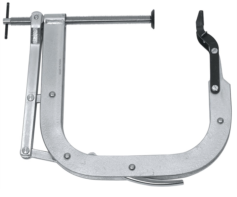

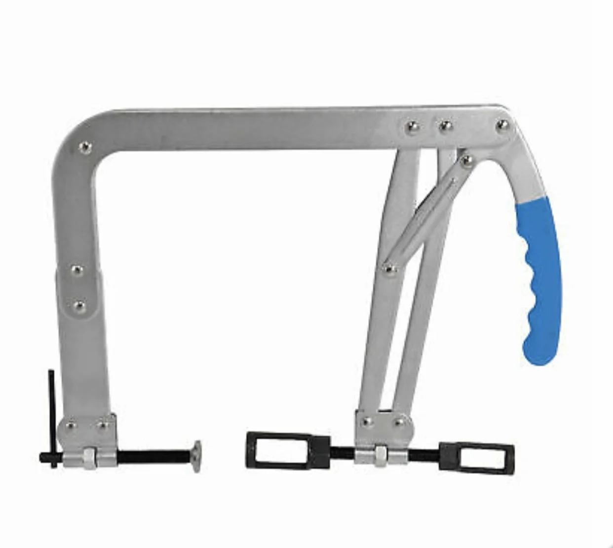

I have used a valve spring bar like this before, you need a post or bolt from the rocker bolt holes for it to work. They are not optimal but do work.
I figured I'd take some measurements today and mess around with it tonight to see what I come up with. Maybe nothing :lol:
I'd be fine with buying one too, just haven't found them listed online. I think Gregg's has a few, but they don't show prices.
I’ve got one like this around. I’ll need a bit to go dig it out… hasn’t been used in 15 years +/-. I know roughly where it was, but the minions… who knows what they may have done to try and hide it.
Last time I did them on an F, I used a pickle fork and some washers… or something. It was in ‘92 so the exact details are a bit foggy.

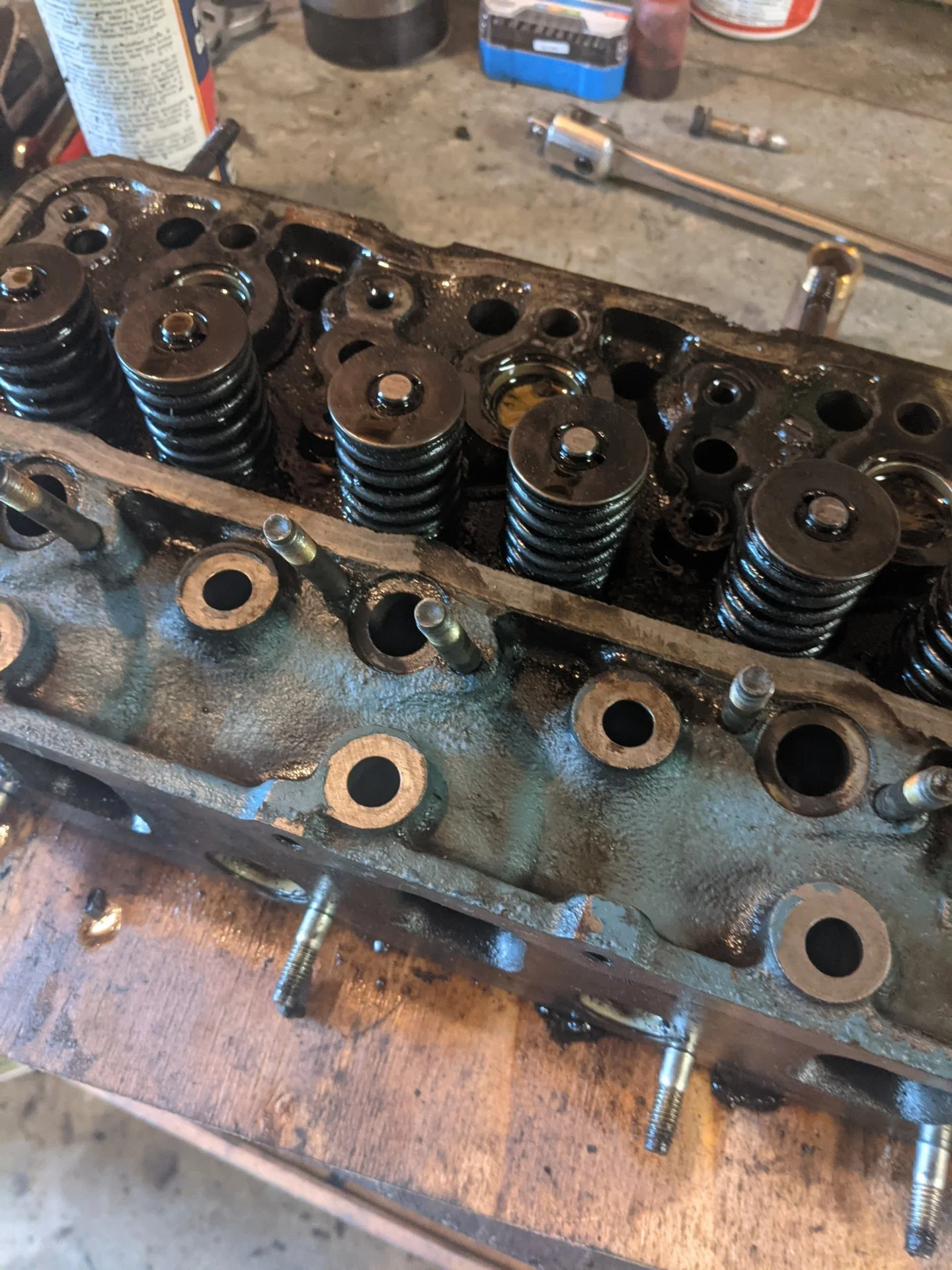

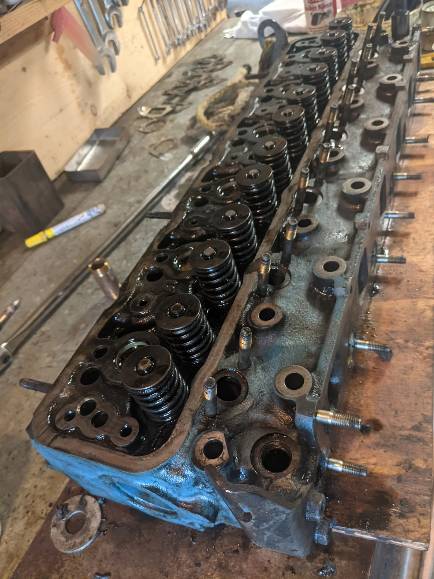

Popped the head off and got it superficially clean. Nowhere near clean enough of course.
Actually some blue paint under the mung :lol:
Can still see the crosshatch in the holes so that's a good sign. Probably hard to see.

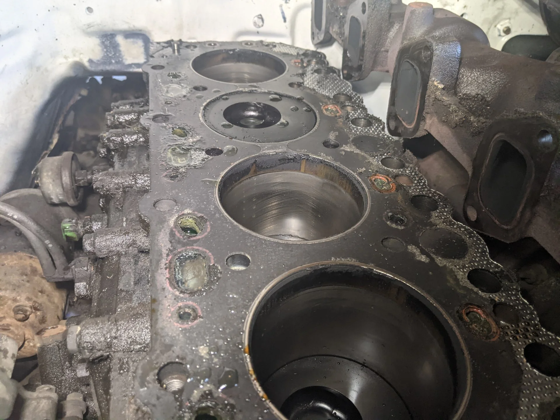

I have zero interest in climbing underneath today. Think I'm gonna raid the cardboard bin tonight so I can cover the floor, and then give the block a good scraping before I take the pan off.
Older Toyota diesel head bolts aren’t torque till yield or anything silly like that. They are fine to reuse if undamaged if a person is worried there’s specs in the manual to check them but I wouldn’t bother.
