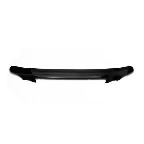

Has anyone else noticed that having a bug shield on the hood reduces the amount of road debris that hits the windshield?
I have a Tacoma that is prone to windshield chips. Since I installed the weather tech bug deflector, I've noticed flying debris seems to miss the windshield.
I'm almost ready to buy one for the LX to see if it makes a difference.

I am not seeing Weather Tech option on their site for a 99 or 2000 Lexus.
