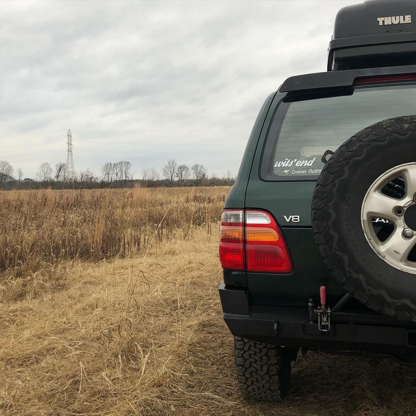

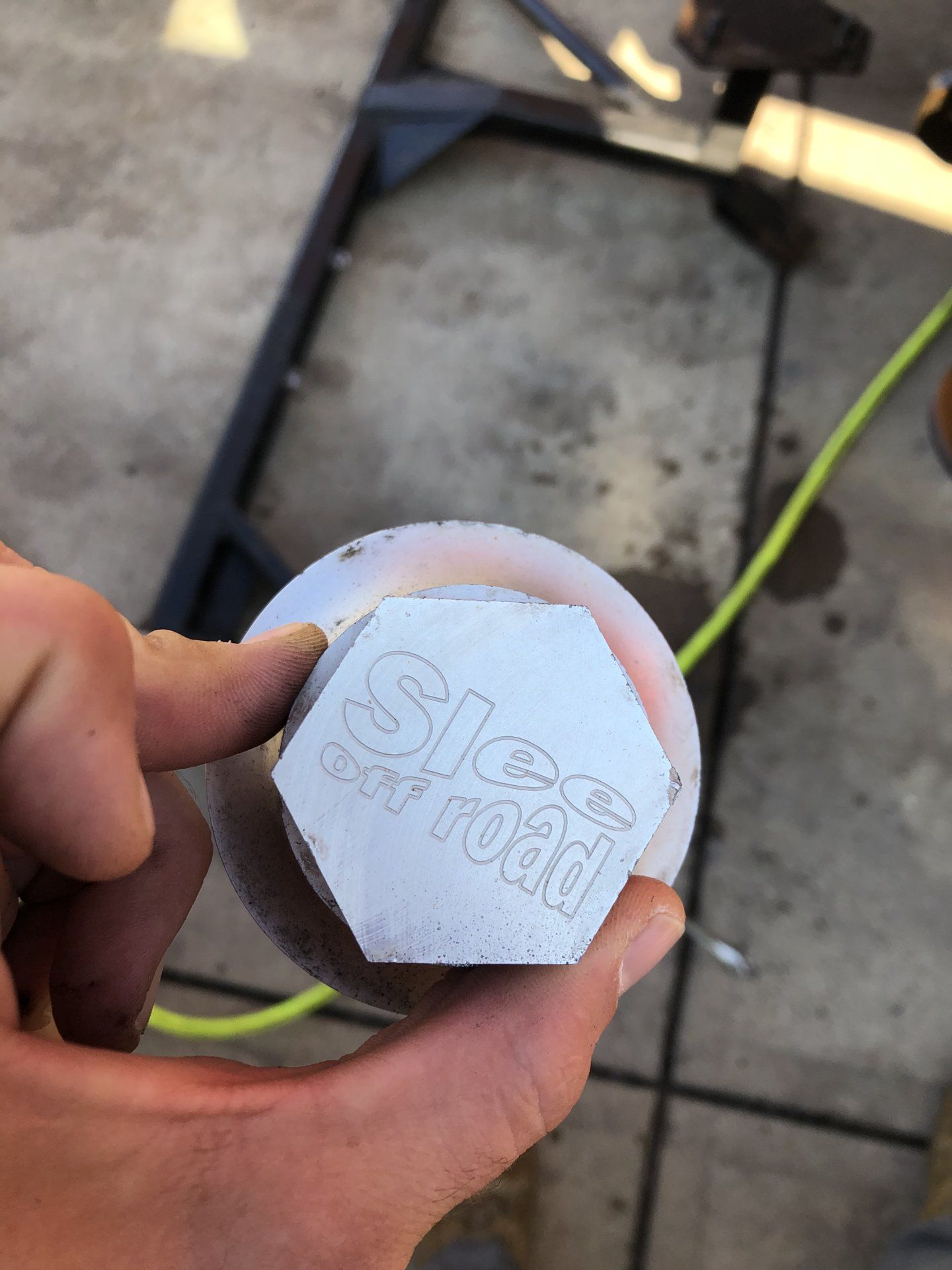

I was told the rear bar was a prototype Slee. It’s not. Spoke with Christo and they have never produced a bar like this. I am luck that whoever made it used a Slee spindle.
The bar was obviously neglected (as was much of the truck).

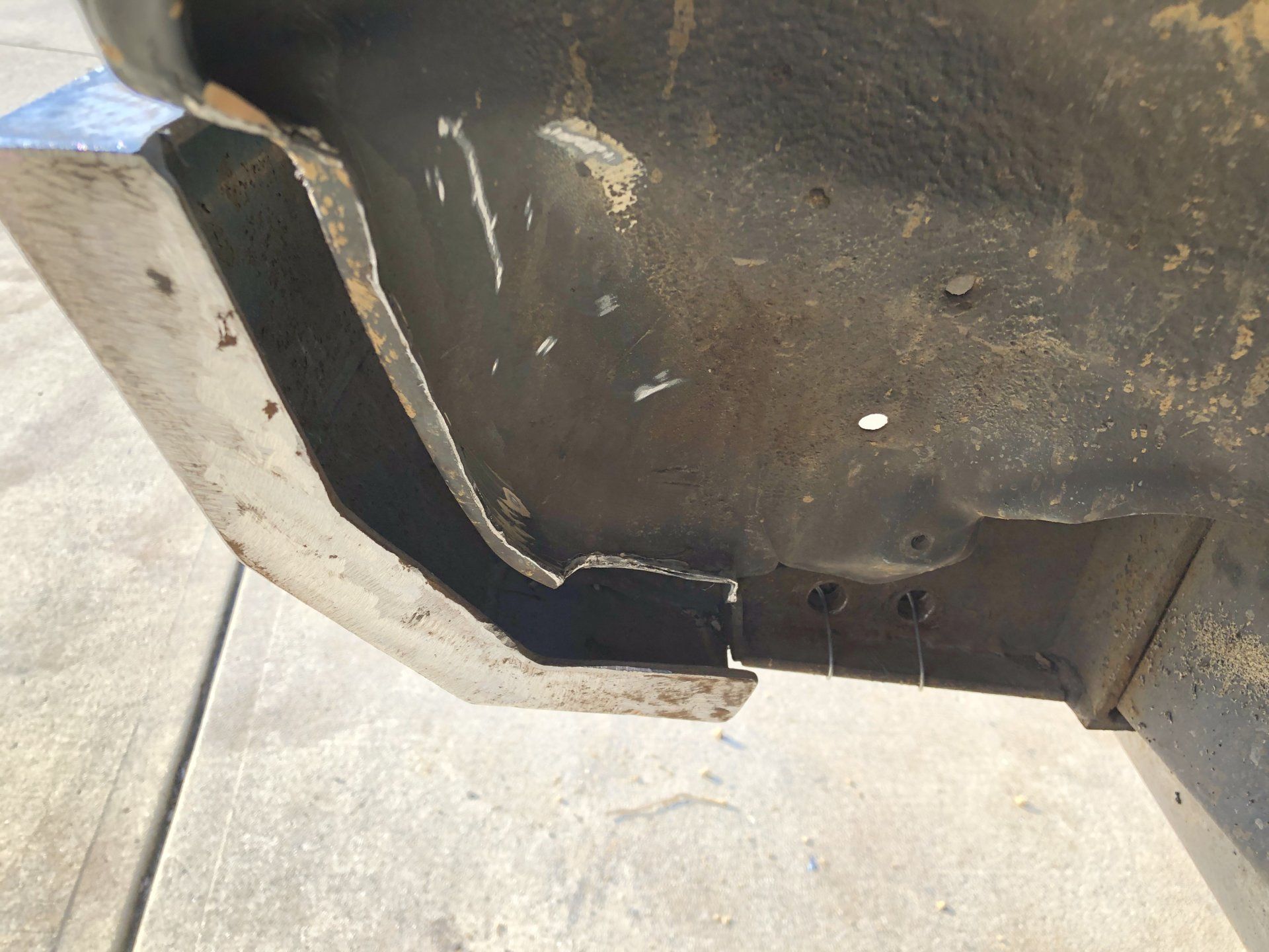

Stripped down the bumper front and back as well as much of the rear frame. A lot of surface rust but no rot. Used a grinding wheel and a dremel with grinding stone implement.
Cut rot out of the pinch welds.

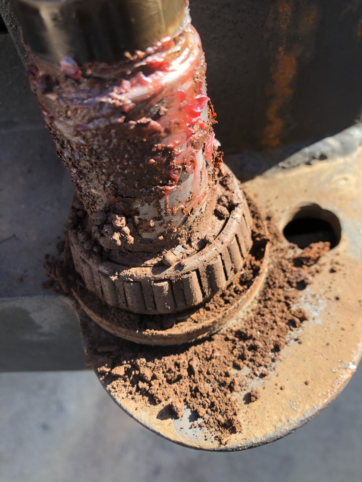

Im trying to get the race off the spindle. It’ll come eventually. Unfortunately my puller won’t fit. Slow moving with old s*** flat-heads I’m grinding back to increase the thickness. I’m expecting it to pop off at any time.

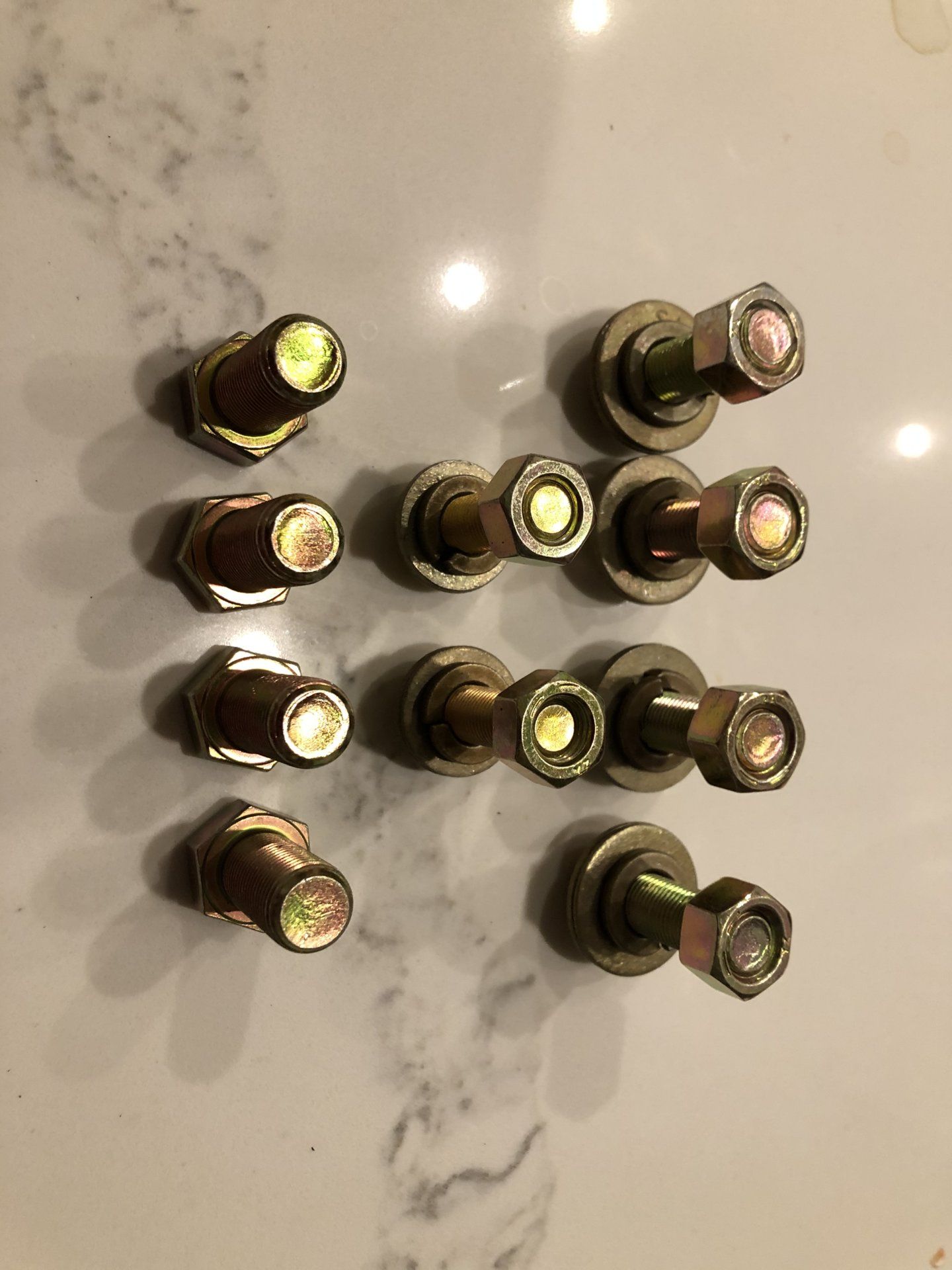

I stopped by fastenel to buy new hardware. Combination of grade 11 and grade 8. Now with matching sizes And all zinc coated.

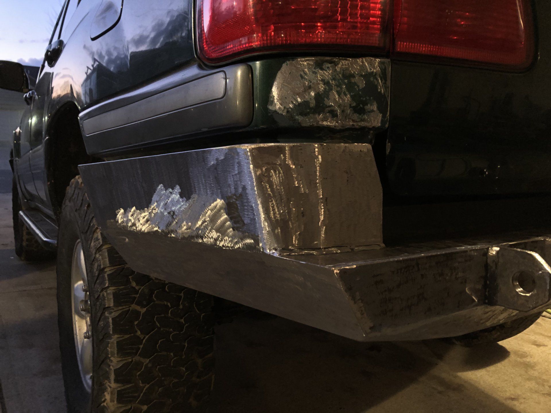

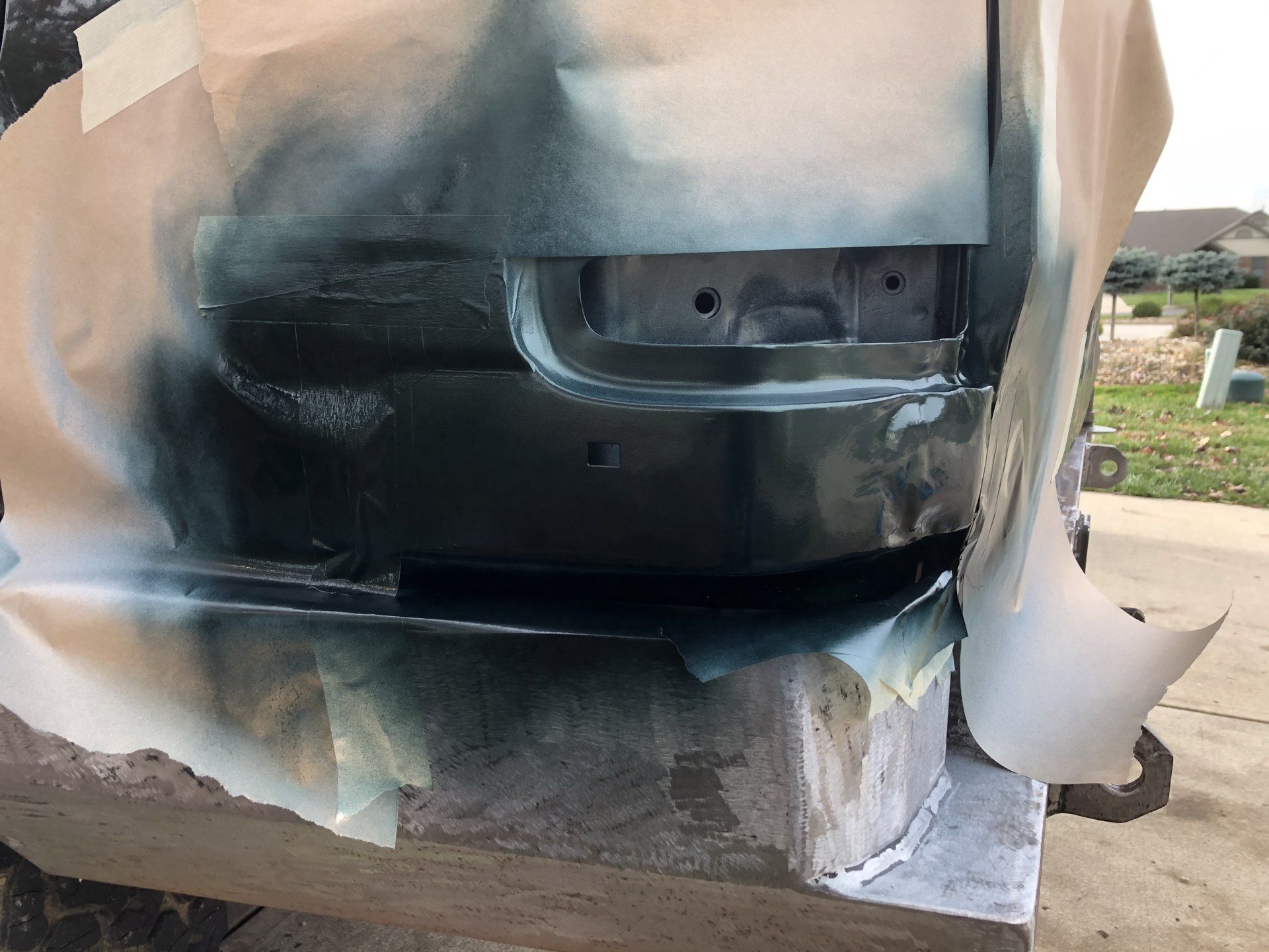

Repairing this body damage properly. It was obvious when I bought the truck the PO used green spray paint to cover the damage (but I couldn’t tell in photos on line).

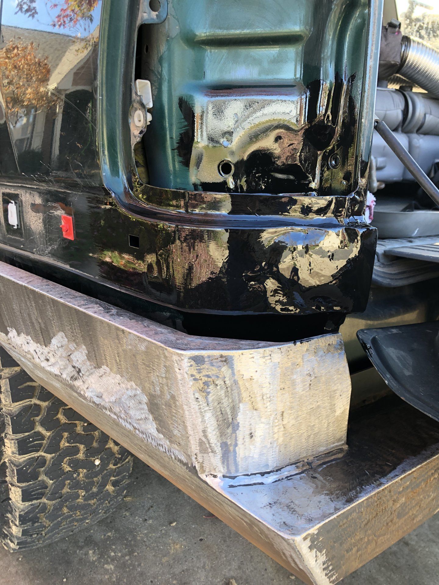

In any case a bit of massaging to get the tailgate and tail light lines even (I just used a brass drift and 5lb hammer). Bit of work to get to bare metal. Several thin coats of por15 on there now. I’ll sand that down with steel wool then hit it with a few coats of 2k primer. Blend it to the good paint. I’ve got Automotive touch up base and clear.
It won’t be perfect, but a whole lot better then before.
Because I’m unable to pull the bumper; I bought One of these to get inside the frame rails and tight corners my grinder and dremel couldn’t reach. I’ve also got a cheap paint gun and wand I’ll use to basically spray the whole back end of the truck with por15. First I’ll hit it with a 80grit sand paper sponge with undiluted simple green, dry with compressed air, and metal prep. It’s the best I can do for now.
No more rusty raisin. Weather is too cold for final wet sanding

Rear bar work continues. I finally gave up on the lower bearing inner rig and cut the little s*** out. No significant mating to the spindle hub.

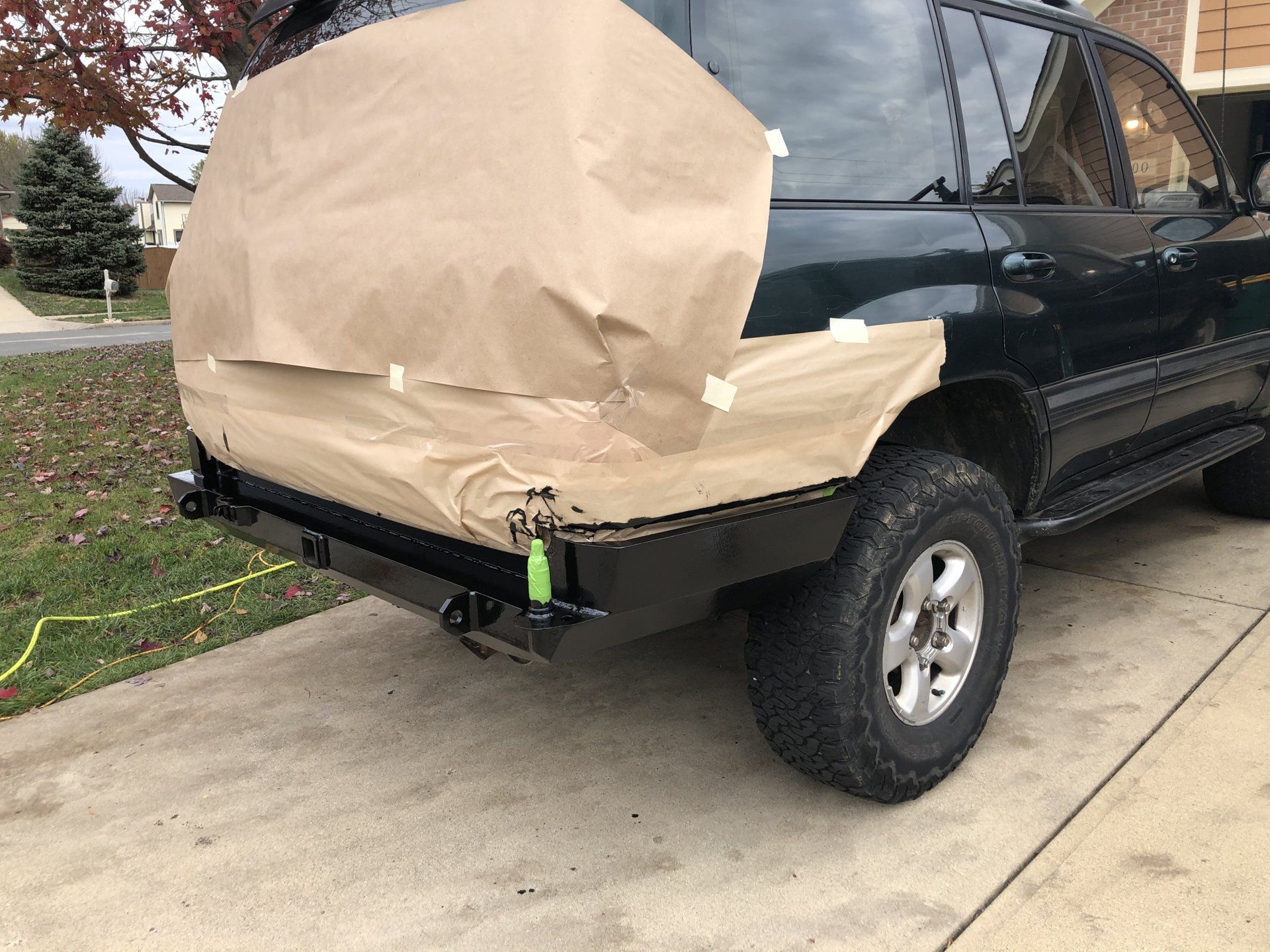

Yup. Same treatment as the front bumper. I’ll hit it with body filler to fill the scaring from the grinder. I also need to rebuild the lock-pin hole for the swing (I’ll use reinforced body filler for that).
after it will get a coat of 2k primer and satin black rattle can with satin clear.

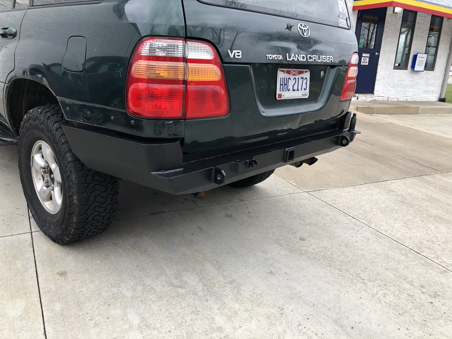

Weather has been cooperating and I’m racing the first salt of the season. I quickly laid down some body filler, sanded, primed and painted. It looks good from 10 feet and on pictures. For now it’s fine. I’ll be refinishing it come spring; after my move to California.

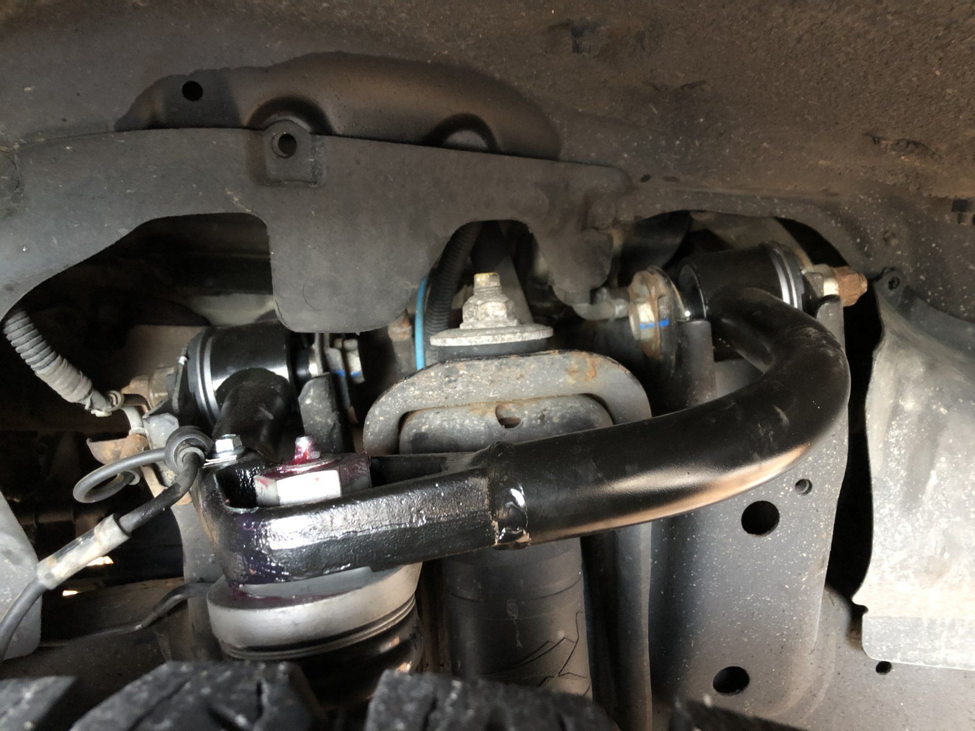

- brakes, pads, rotors, Slee 5-piece line kit and fluid
- SPC UCAs

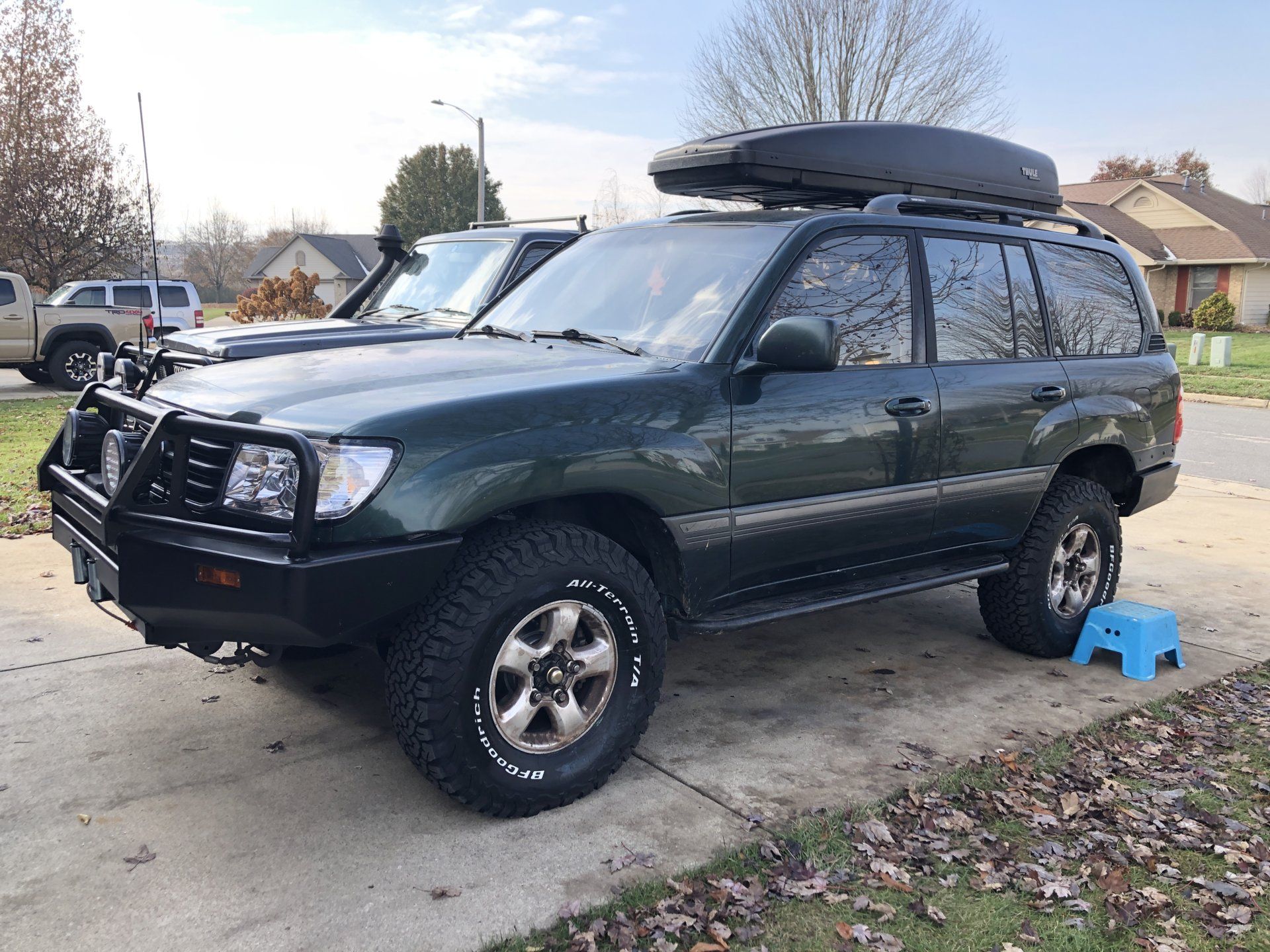

Little things here and there. New shoes, KO2 295/75r16. Carryover from previous tires. Debated jumping to 35’s but felt for my use with the truck the cool factor vs hit to economy wasn’t worth it for me.
found oem load bars and a roof box on marketplace. For my area it was a steal.

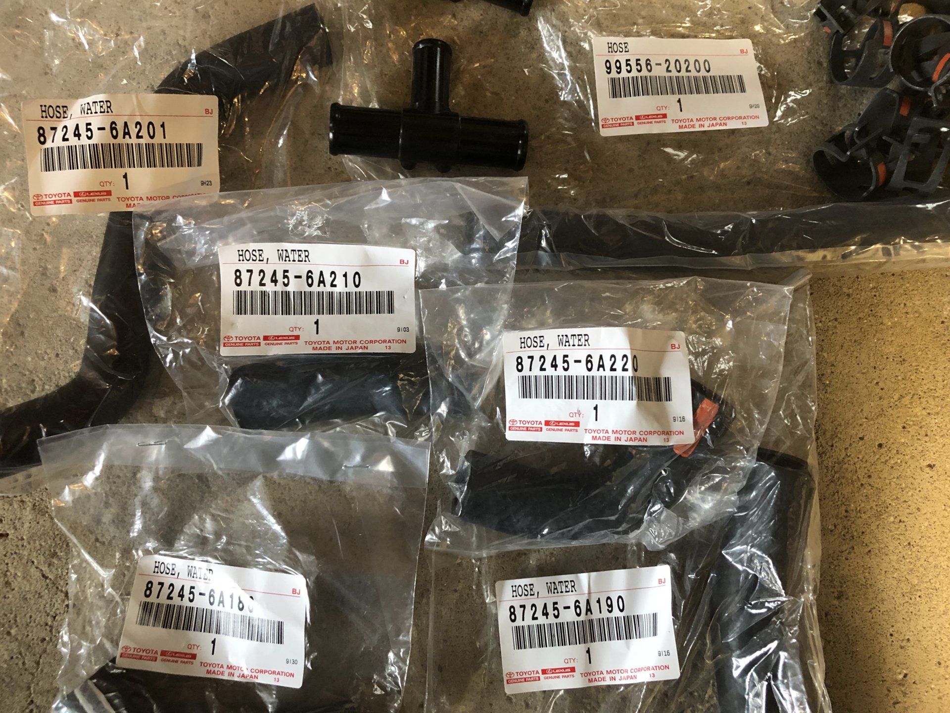

Heater T’s done. PO said they did them, but opted to replace them along with upper/lower rad hoses.
I bought the whole Heater T kit along with the rad hoses and fuel filter from Wit’s End. 10/10 would recommend Joey’s kit.

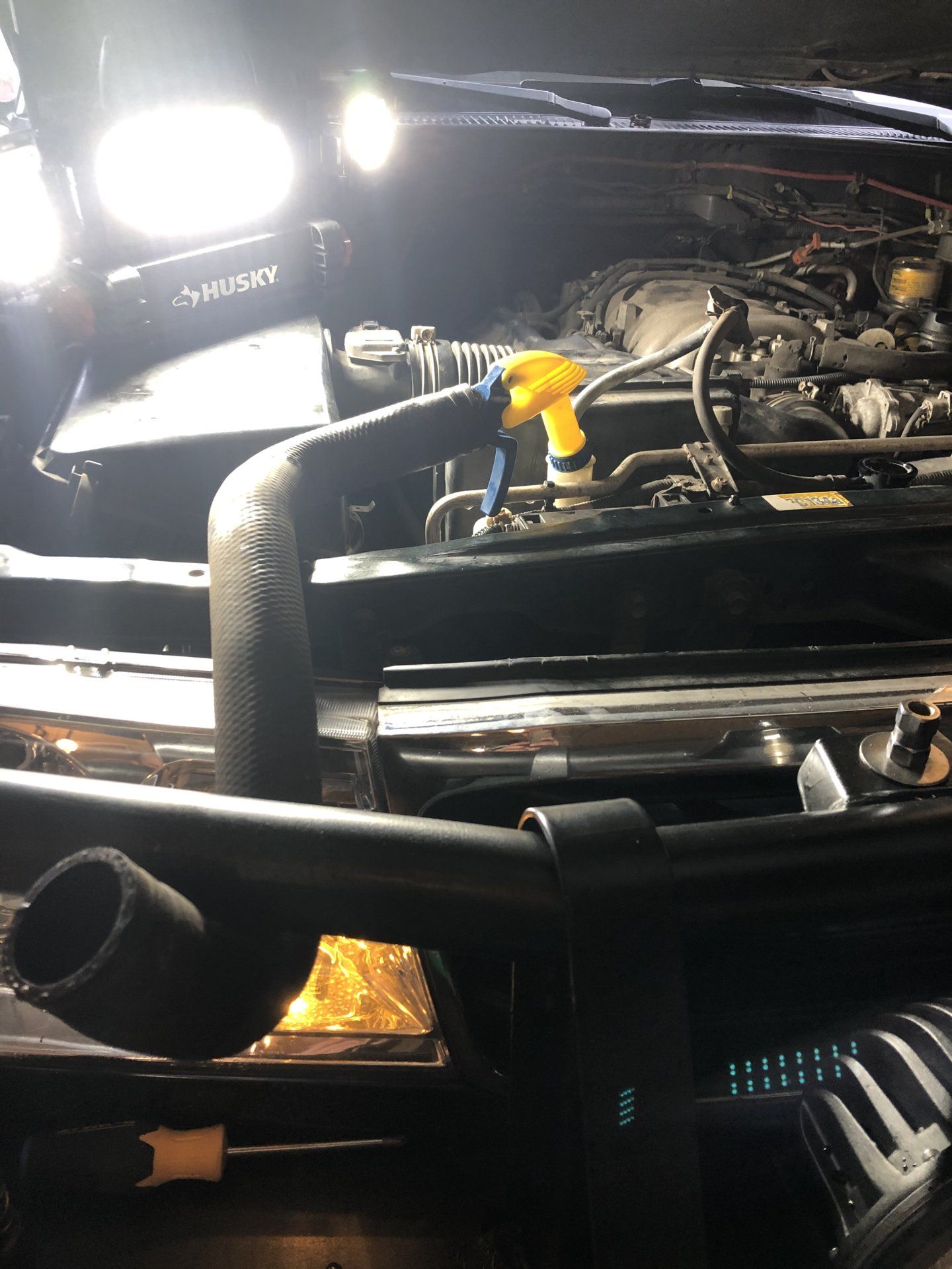

*Side note, I lost about 2 gallons of coolant In the job. Put 1 gallon of Toyota red and 3/4 gallon of distilled water. The remaining 1/4 gallon of water was poured into the reserve tank and used to top off the rad while burping the system. I used a Zep industrial sprayer to remove the excess coolant after the system was bled. The straw is the perfect size to drop below “full” in the expansion tank.
