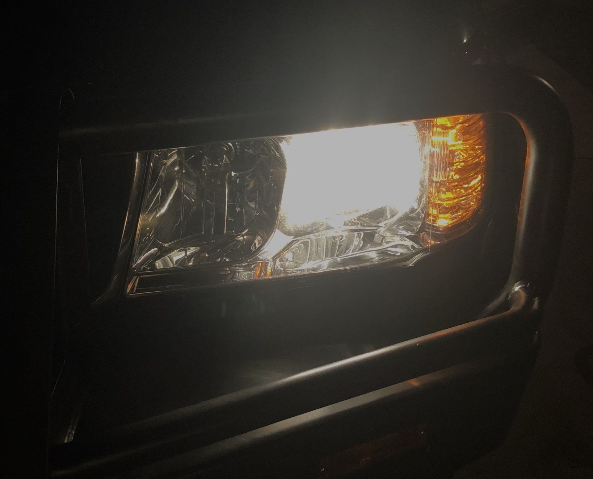

Hikari low beam (temperature is cooler in person):

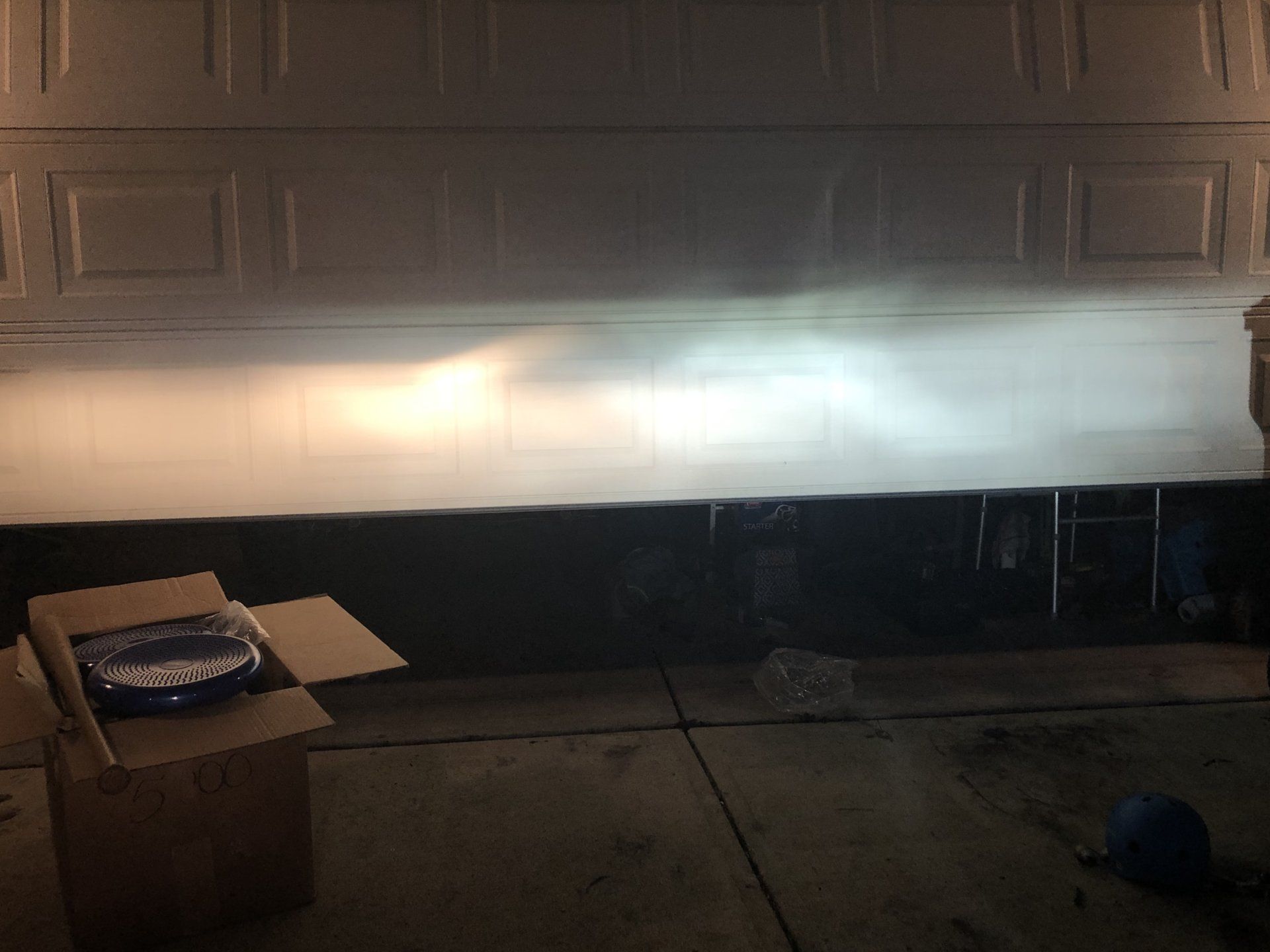

Hikari LED -vs- Philips halogen cutoff and spread (Philips left /Hikari right):
Fine tuning isn’t done. I’m going to play around with the adjustment screws organic to the Depo housing after initial testing. That said, Hikari has a neat system that allows about 60* of rotation to the level/trim the beam pattern. For now it’s accurate enough to compare the performance to traditional halogen bulbs.
