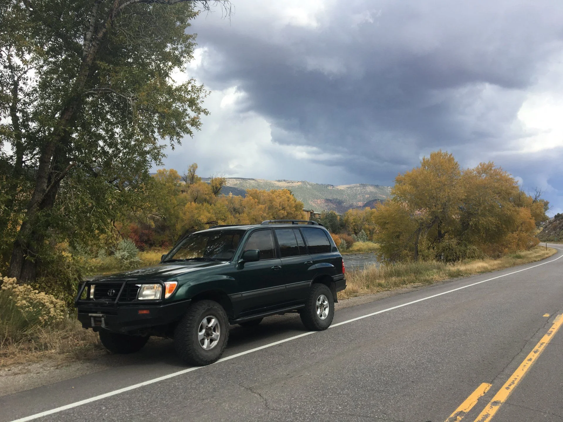

We have decided to add another cruiser to the stable. After debating several platforms we decided a 100 Series would be the best fit.
We purchased the truck from @farinvail on October 6. This is the photo we took the day the truck arrived to its second home.

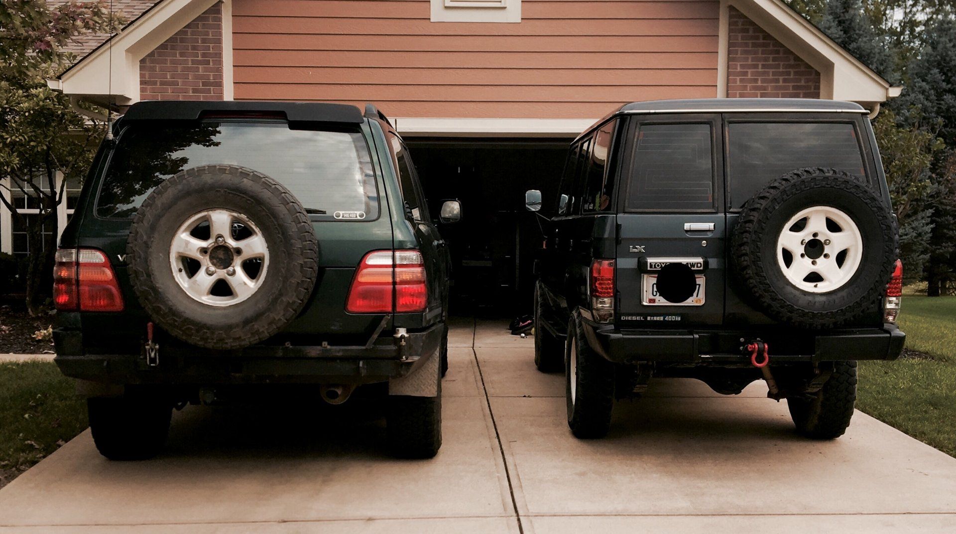

1400 miles, average 16mpg at 70-ish mph and 192oz of coffee later I arrived home. Total trip time (with a few deviations) was 25 hours. Parked the 100 next to the 77 and decided if they are both going to fit, I'm going to need to rearrange the garage.

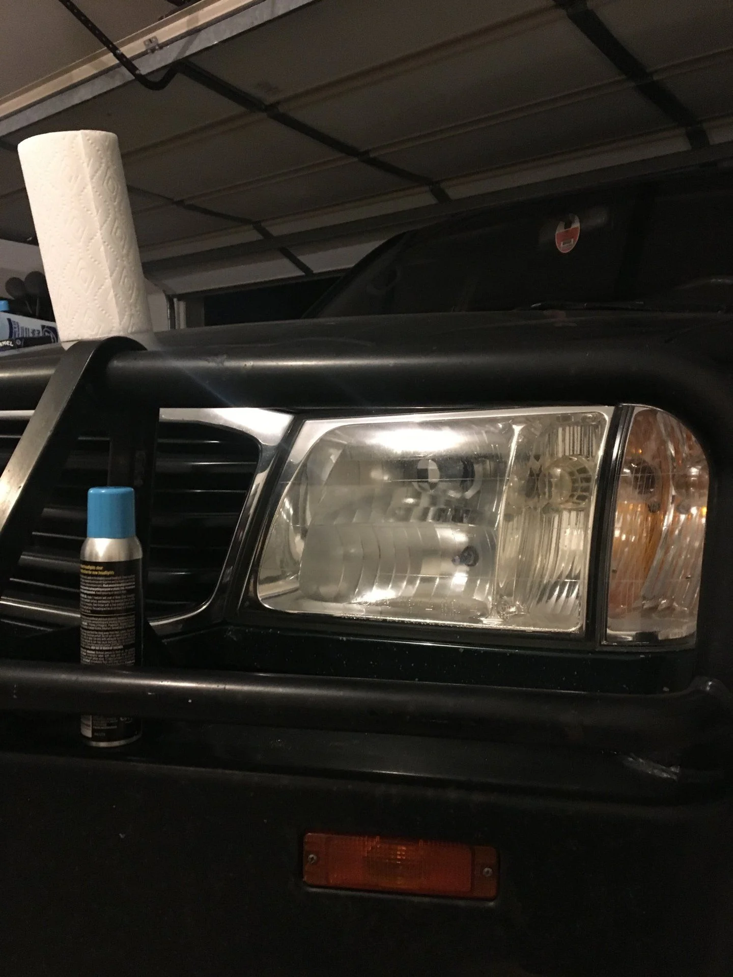

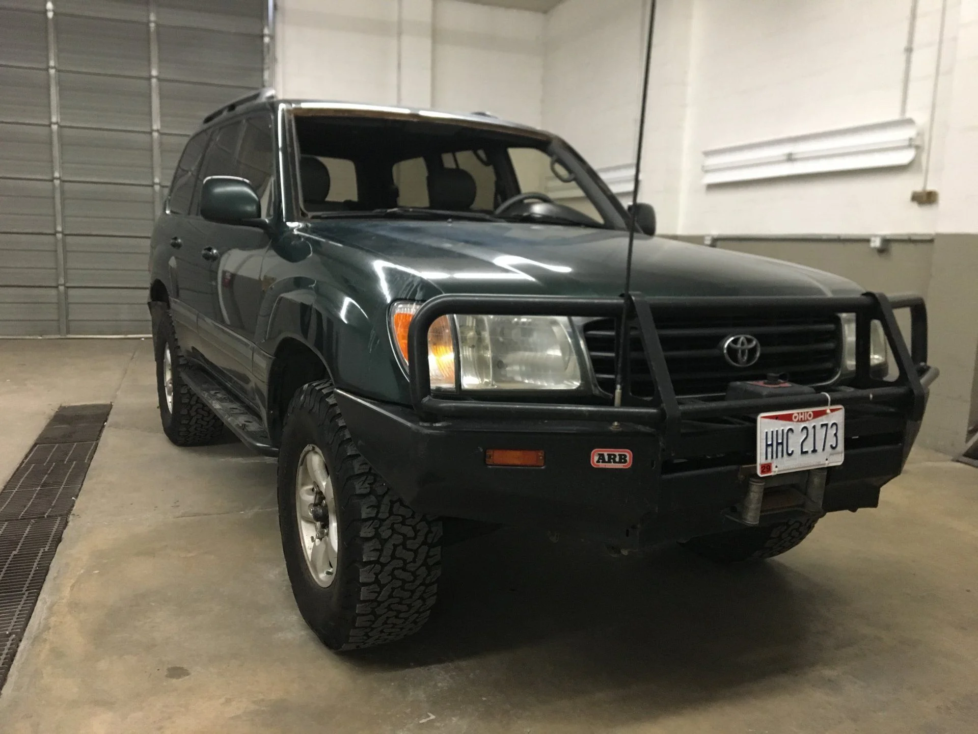

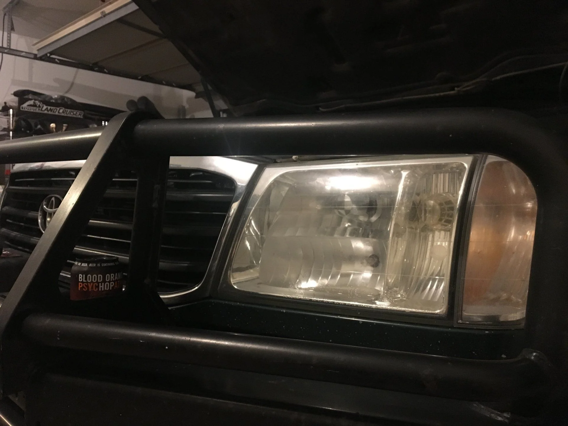

Installed philips crystal vision ultras in the highs, lows, parking, and reverse. Polished lenses.
Still not perfect, but what is.
Good thread youve started.
Not sure what youve used on your headlights, but keep in mind the lenses are glass(unless they are aftermarket replacements) and wont polish up like a plastic lens. Often there is haze built up on the inside of the glass that could be attended to but would require removing the light and going in with a long swab from the back side and cleaning the lens and reflector.
I just used a light polishing compound and brillo pad to get the road grime off. The reflectors are hazed for sure. I'm likely going to order new headlights and rewire the lights at some point. Initial impressions are good with the new bulbs. I won't know for sure until I drive it.

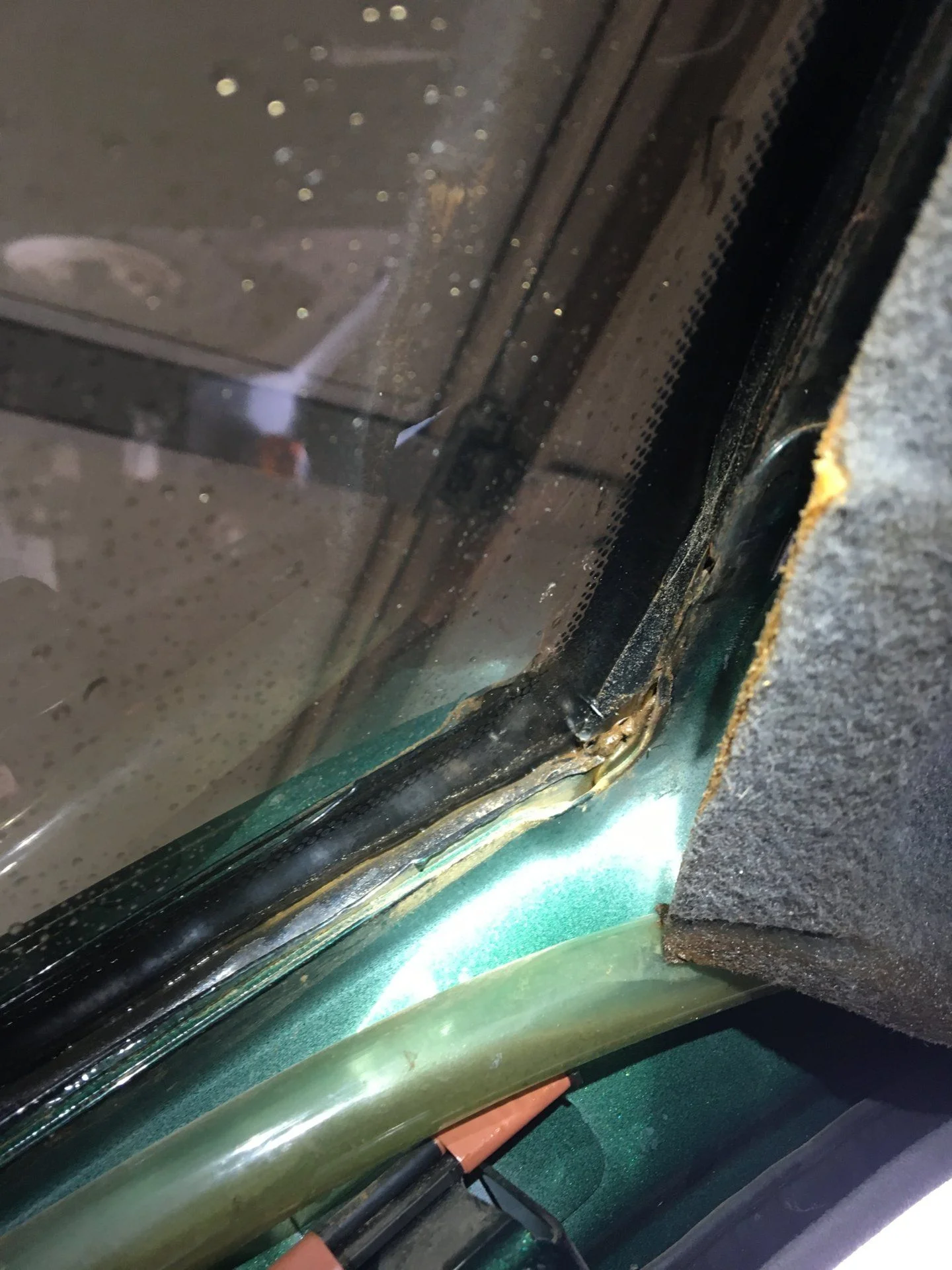

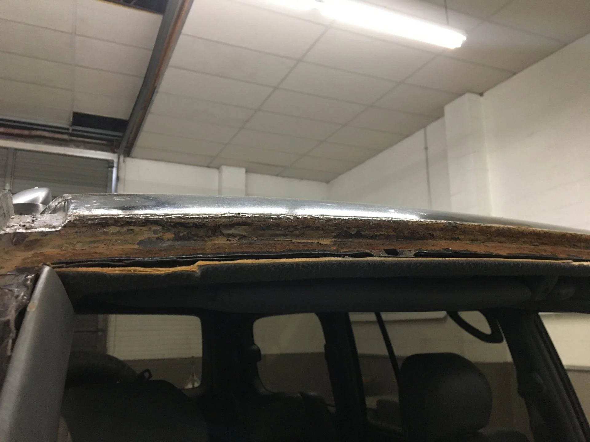

Welp, I came out from lunch earlier this week to a wet headliner and a puddle in the center consol. Instead of getting a hair cut I ended up driving home, pulling the roof liner and passenger side window flashings. I cleaned everything as best as I could and sealed it with silicone. That day I brought it to a recommended body shop. And patiently waited for the call.
The shop discovered some troubling evidence of a lackadaisical previous install. So I'm now left to clean up the mess. After struggling in my head with the associated costs to properly repair I've decided to fully commit to this truck. Historically, a windshield was installed with screws followed by a second windshield with rivets. My body guy believes some seals were inappropriately reused and primer was not used at all. Luckily the rust doesn't seem to have penitrated to the second skin. I won't know until cutting starts. The window frame will be restored and all new hardware/software will be used IAW the FSM.
This lesson serves to prove two things: Do it right, do it once and be prepared to walk away. Which I should have done as soon as I saw the truck. I'm just in too deep at this point.
Bummer to see, but glad you're doing it right this time!
It's a shame that shoddy work almost destroyed the truck. I'm fortunate in one sense that the windscreen was installed so badly that it started leaking before the rust really set in. I was able to speak with the shops glass guy and he told me the only thing holding the windscreen on was the bottom two rivets and the driver's side.

I'll focus on the upside, at least you now know what lurking beneath your windshield trim and you're taking steps to make it right before the damage got worse. Your also starting off with a clean slate which is nice.
Mine had to have the windshield replaced this spring and it was on its way as well. Luckily the rust was just on the surface, although my quick repair has started to discolor so I guess I'm going to have to get at it again very soon
