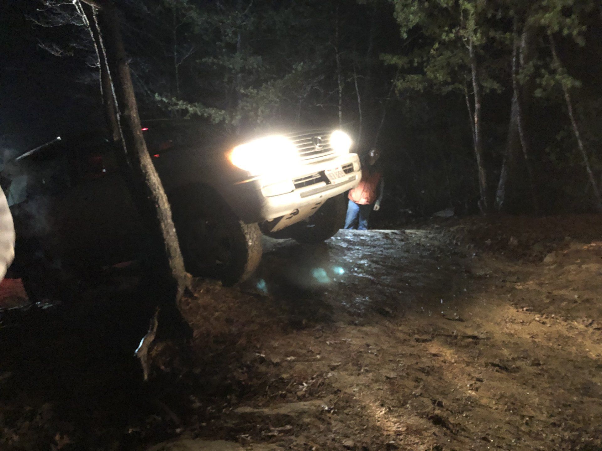

Awesome day of wheeling yesterday. The KYTLCA knows how to host an event. 10/10 would recommend a trip out there. I only wish we could have camped for the weekend.
Totally spaced on the 5 pictures per post. I think the best part of the trip was the complete lack of cell service. My kids and I enjoyed telling knock-knock jokes, searching for dinosaurs and imagining crocodiles in the creek we drove up. We even saw a “robot spider” (oil pump) way out in the middle of no where

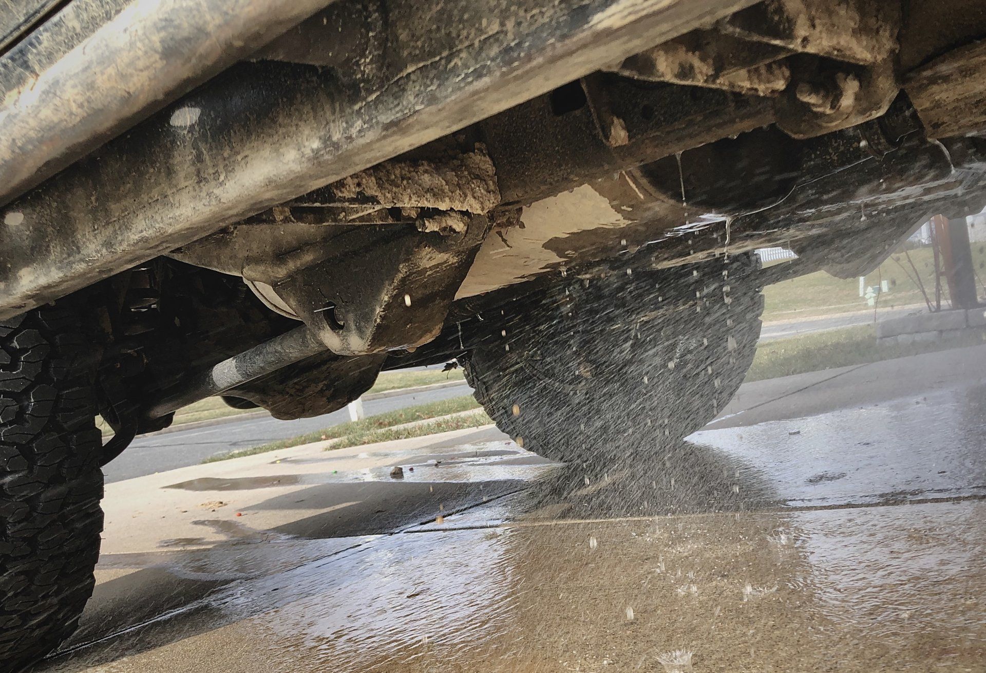

Question for the group, anyone make armor or truss the rear LCA tie-ins? Thinking about getting the TT arms too. Thoughts?
It’s my truck and they are armored based on what I was told. Good to confirm, thank you.
they like to dig in and get hooked on rocks with break-over.
I’m thinking of adding a spine or truss?

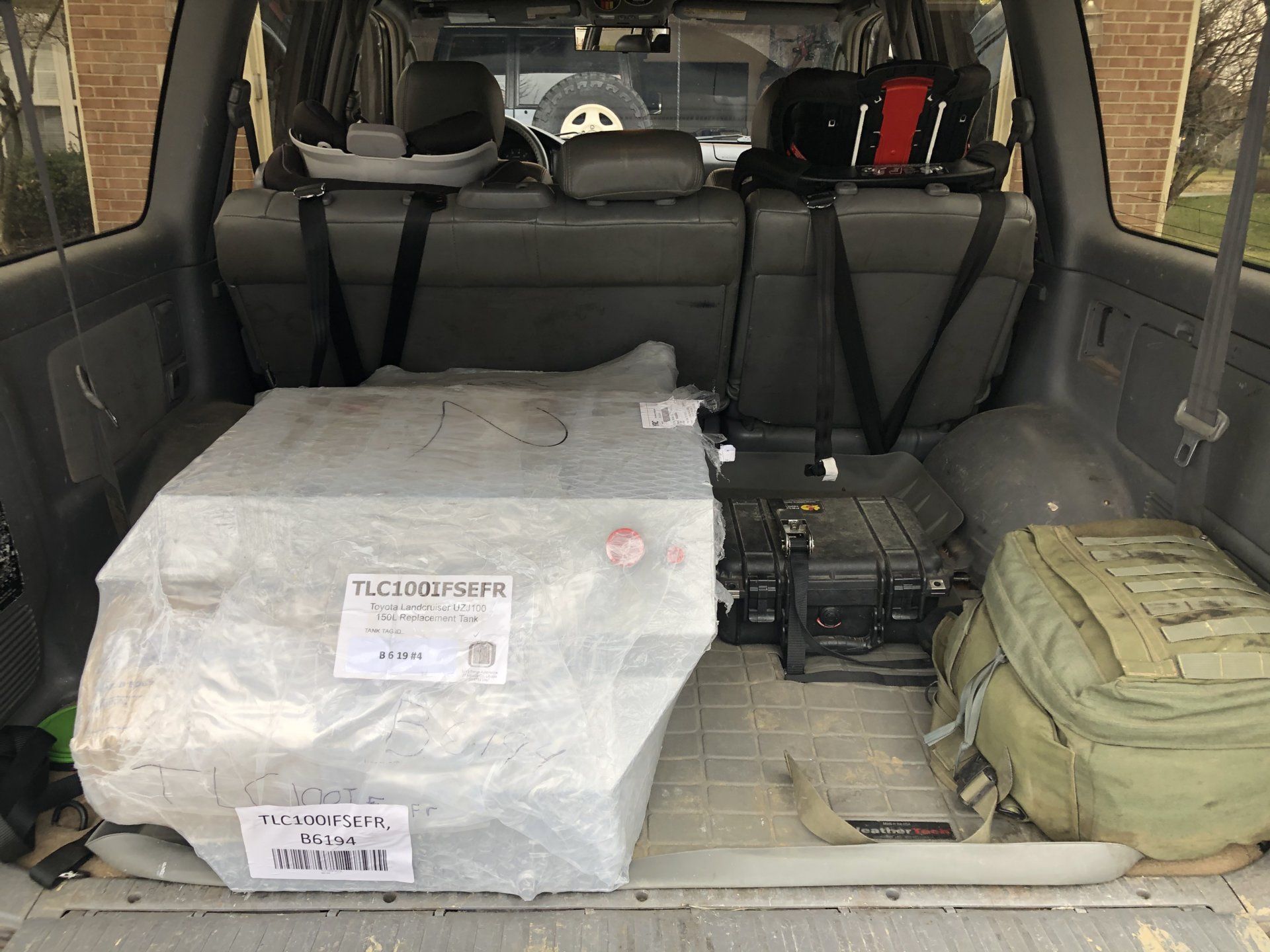

Two options for the 100 are currently available: 25 gal auxiliary tank and/or 40 gal replacement tank. I decided on the replacement. We weren’t 100% sure the aux tank would fit given my rear bar’s design and 3” frame-bob.
This tank will afford 600 highway miles / 400 mixed miles / 360 off-road miles. I see this becoming my favorite mod (But the driver’s seat has seen better days and I have a set of Planted seat bases on the way from @jmlockwood; a set of Sheel-Mann seats may be the next addition).
I’ll get this tank installed as soon as I fix the steering rack, hopefully before my next planned trip at the end of January. Details will be in a stand-alone thread and linked here.
