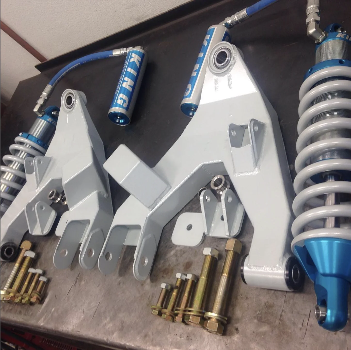

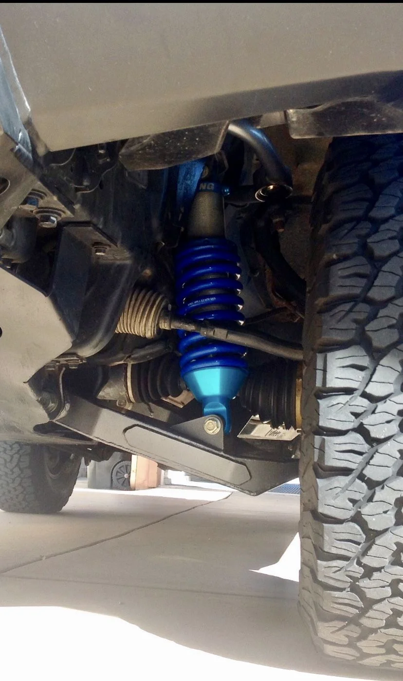

Yes Killer Off Road has a kit out. It is about the normal price for a LT suspension. It does look really well constructed though. I wheeled HIH8 with a guy who had installed it in his 470. It seemed to handle everything easily.
It’s not a long travel kit. They literally matched a factory LCA mount points and then beefed it up for the coil over.
Your cv’s, ubj’s, and lbj’s will still bind at the same point. Any increase in travel is marginal at best.
I screenshot this years ago. Can't find anything on Killer these days and as mentioned above I don't believe it did much to extend travel
