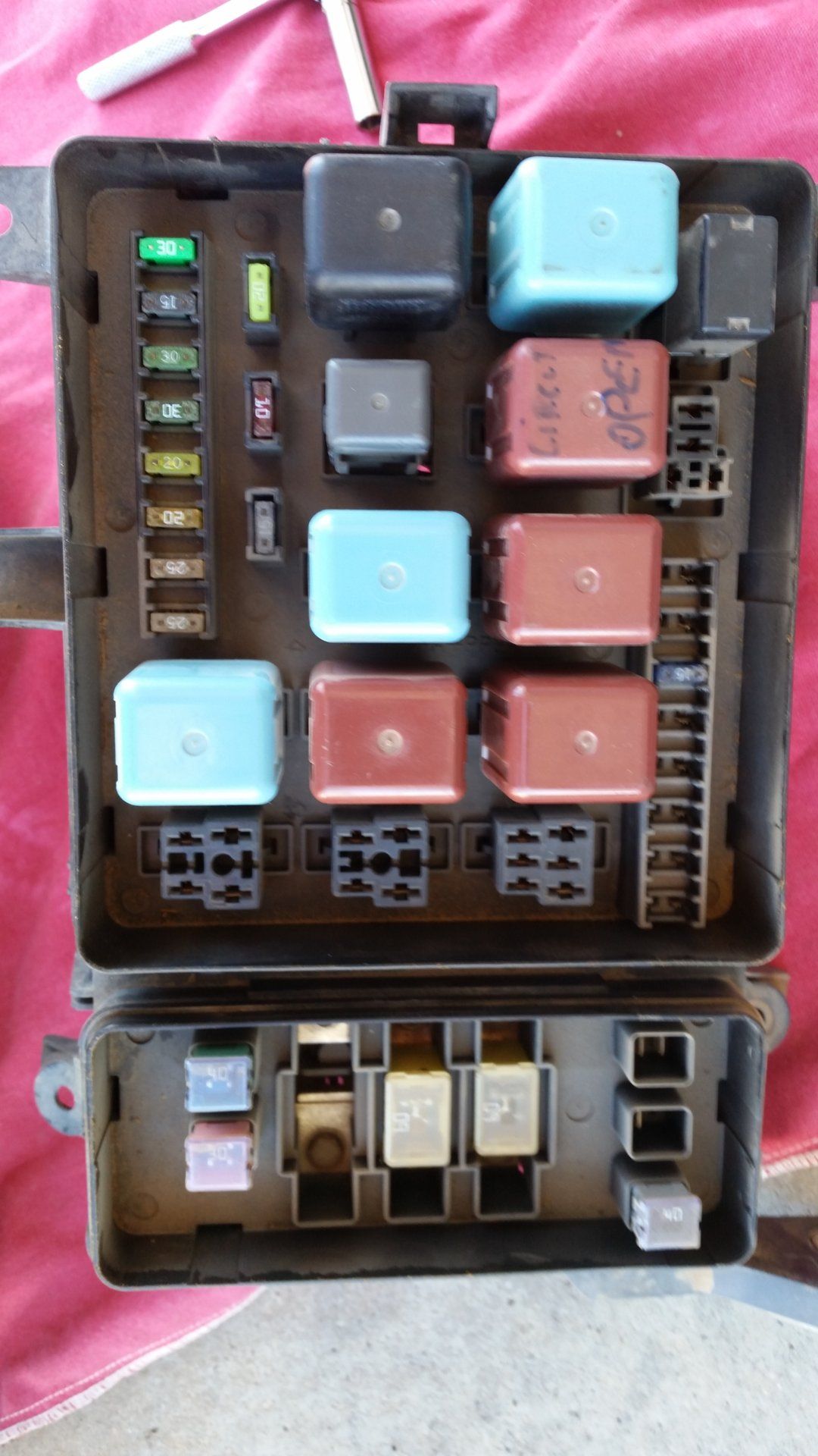

Looks loose, as if it needs to be push in. You should have a tool clip in the lid, which is use for removal & installing all fuses.
Yes, it's loose but the bracket which holds fuse in place and is broken, the fuse of efi looks custom made inorder to fit inside the broken bracket and this is the reason my LC dies while driving, the fuse doesn't fit properly. I don't know what to do about it, can someone please tell me a perm. Solution for this.
A permanent solution is to buy a new fuse box unless you want to put the fuse back and push a couple of pieces of plastic on each side of it to hold it in place but that solution is not permanent.

Looks like a pair of pliers was used in the dark to pull the fuse. That fuse doesn't even look like right one, it should have 20 or 25 printed on it. If it was in all the way while this problem happen, it most likely has a short in the connection inside the fuse box. Replace with new or used fuse box is your best bet. No telling what else someone has broken in it.
First of all thanks for your inputs, I really need to open the whole fuse box in order to see, what else is broken. You guys are right best is to buy a new or used fuse box which will be much easier, anyways I know where to look one at junk yards.

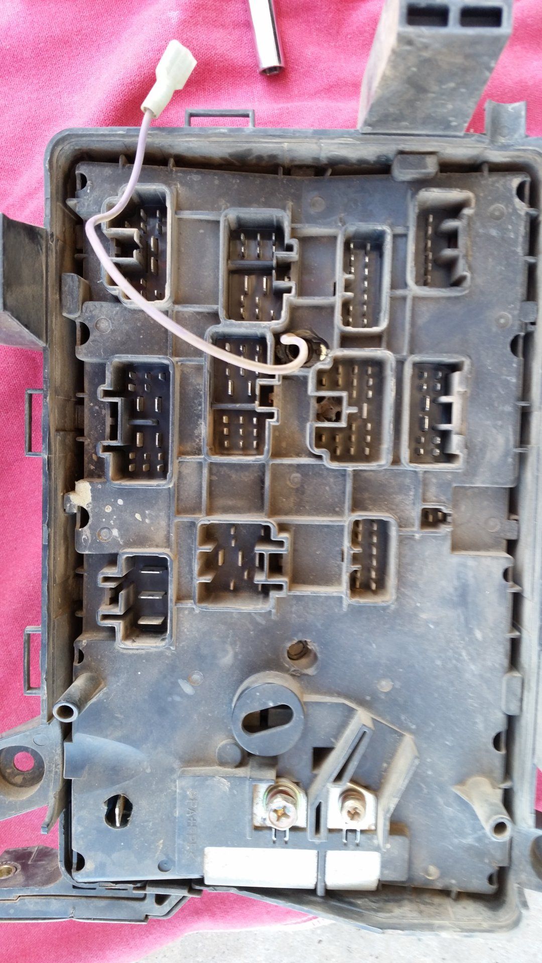

I fixed it with this:
EFI Relay Bypass Kit (Immobilizer Fix) for UZJ100/LX470
My immobilizer fix
Trouble free since. If you're seeing this issue more often, you may want to check this out.
