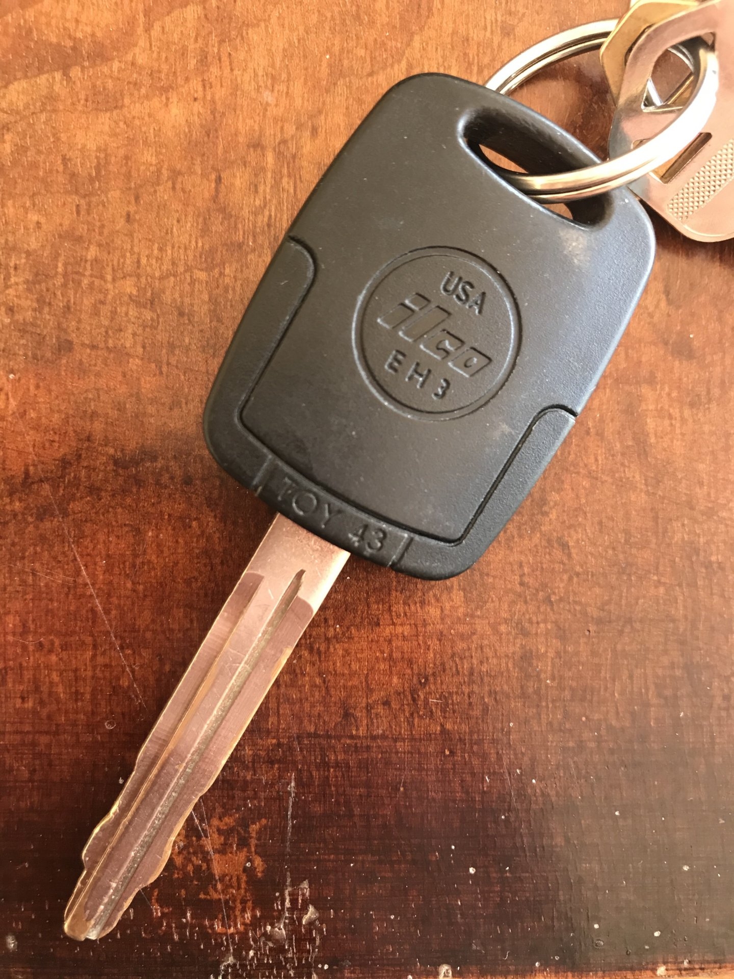

Hi Everyone, something else to try is changing the little battery inside the key.

Further note: In my case I didn't have to crank the car to see if it would start once I learned the sequence of the flashing immobilizer light on the dash. The little light should be flashing all the time when the key is out of the ignition. When you insert your key, the light stays on (stops flashing) for a second and then goes off completely. If the light keeps flashing even after you've inserted your key, don't even bother cranking because it's not going to start.
Nope! Battery is for the door FOB only.
To test this use key without a fab, valet. They have chip in-bedded in the plastic case. Master w/FOB has chip in-bedded in FOB, but still independent of battery powering door FOB.
UPDATE: 3 months later and ZERO recurrences. This was happening all the time before I changed my key fob battery. If you've gotten this far in the thread do yourself a favor and try it.
As much as I want to try this but I have been using a key with no FOB for years.

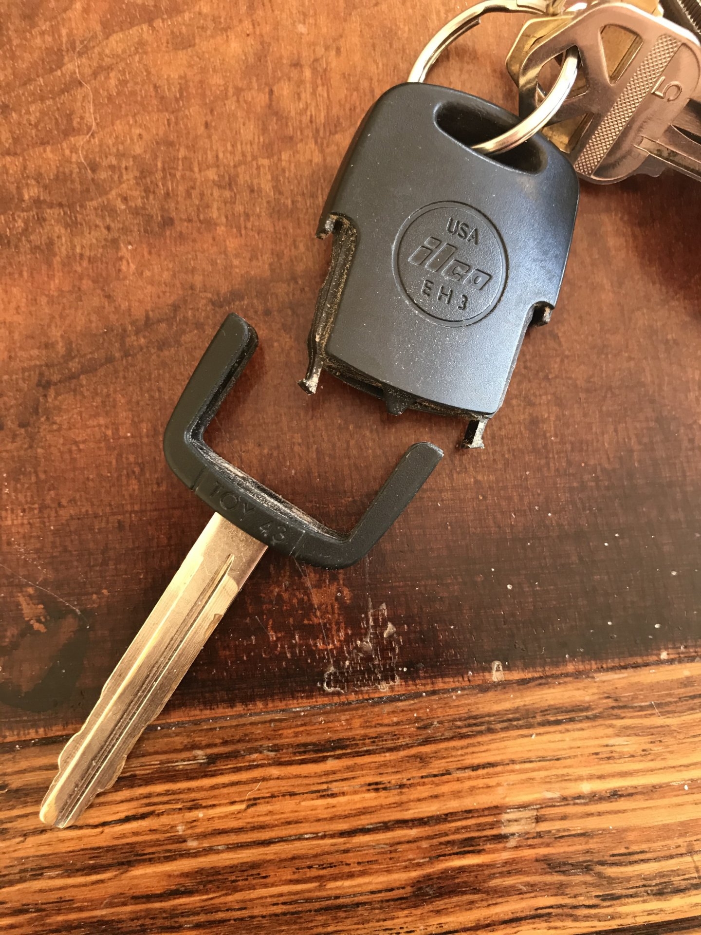

Sorry my description might have been misleading as my key doesn't really have a fob either. There are no buttons on it or anything. But it does contain a battery. I didn't even realize it had a battery at first. Again, mine is aftermarket and I never had the original keys so I'm not sure if this is completely different than the original keys. I'll upload some pics here to show what I have. The key pulls apart and there's a little wristwatch-style battery in there.
I understand this solution may not help everyone here. But for me at least it completely fixed the issue.
Definite no battery in my key.
That key above looks awful and budget. You surely could've gotten a more legit, oem key, from a dealership. I certainly did, for under 40, programmed.
