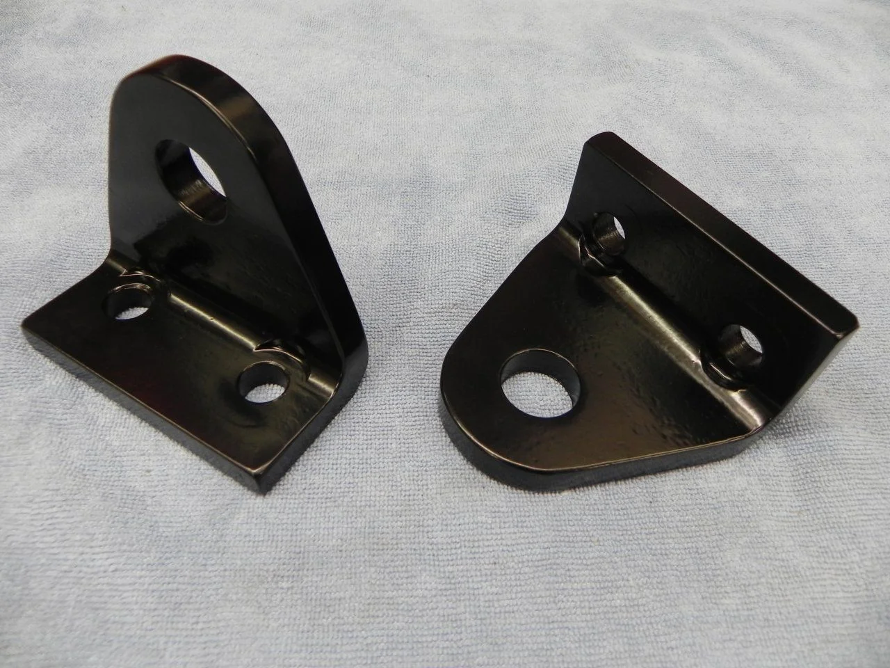

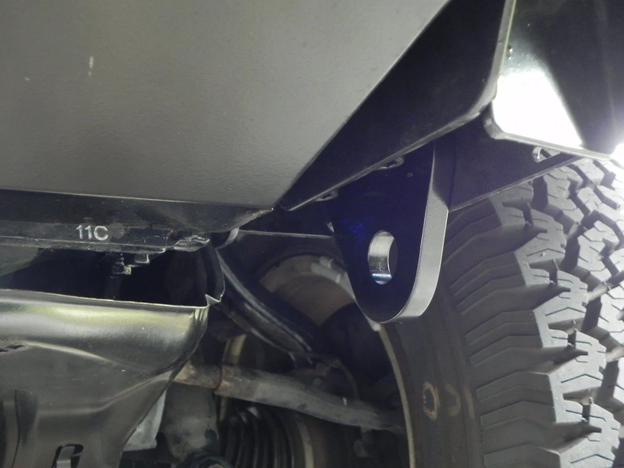

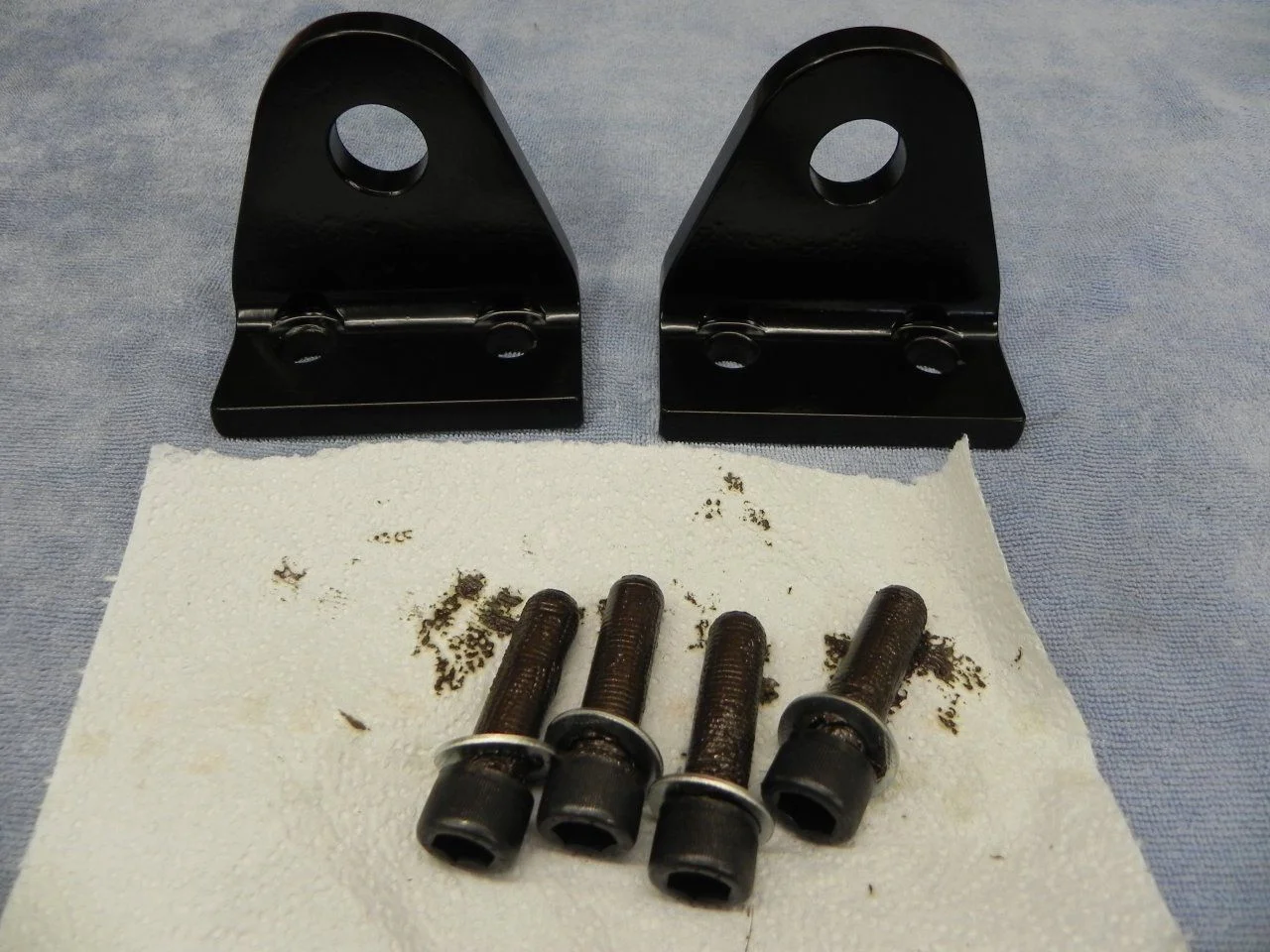

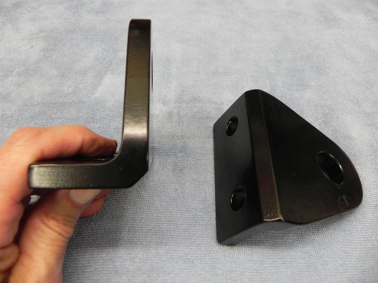

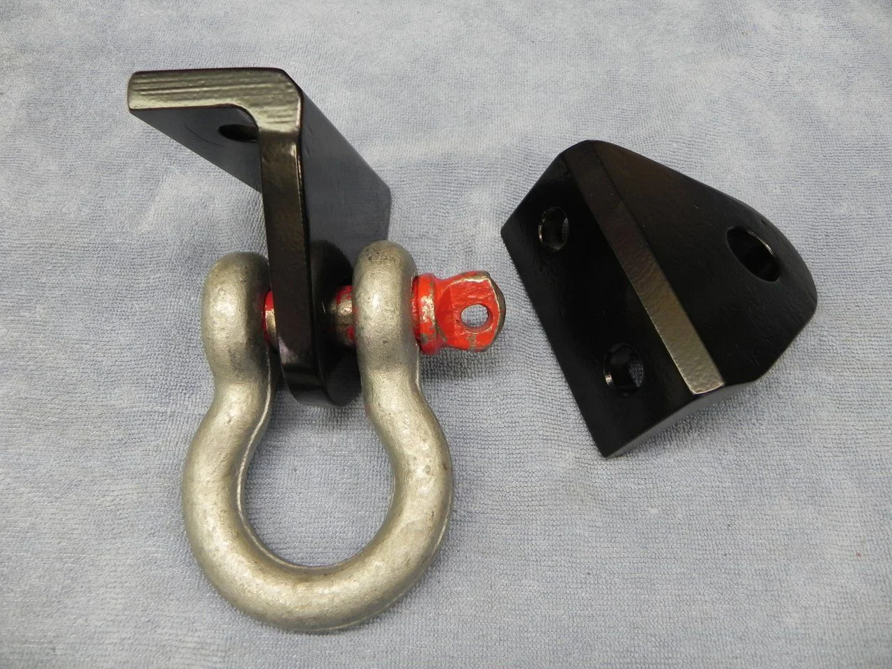

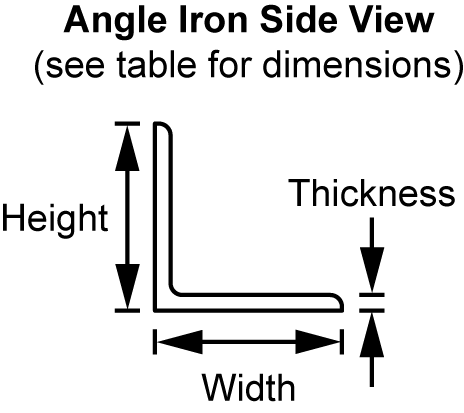

I made these out of 1/2" angle iron for my 100 with an ARB bumper. Very heavy duty.
A few more pictures...........
No recoveries yet but I'm pretty sure they would rip the front of the truck off before they failed.
If you don't have an ARB bumper and are just bolting them directly to the frame they could be much lower in profile (shorter) and therefore apply less leverage to the bolts making the system even stronger!
