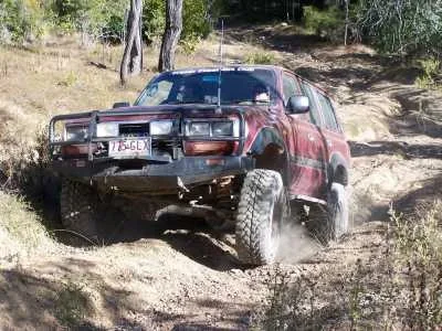

I shattered a front uni once on a hill called Transfer Case Hill. Had to remove the shaft to drive home, plus use the CDL. Apart from no traction to get out of the back country and $#!^^% handling in 2wd I had no problems on my 90 model.
Photo was taken about two seconds before the uni broke. As usual the photo doesn't do the steepness of the hill any justice.
