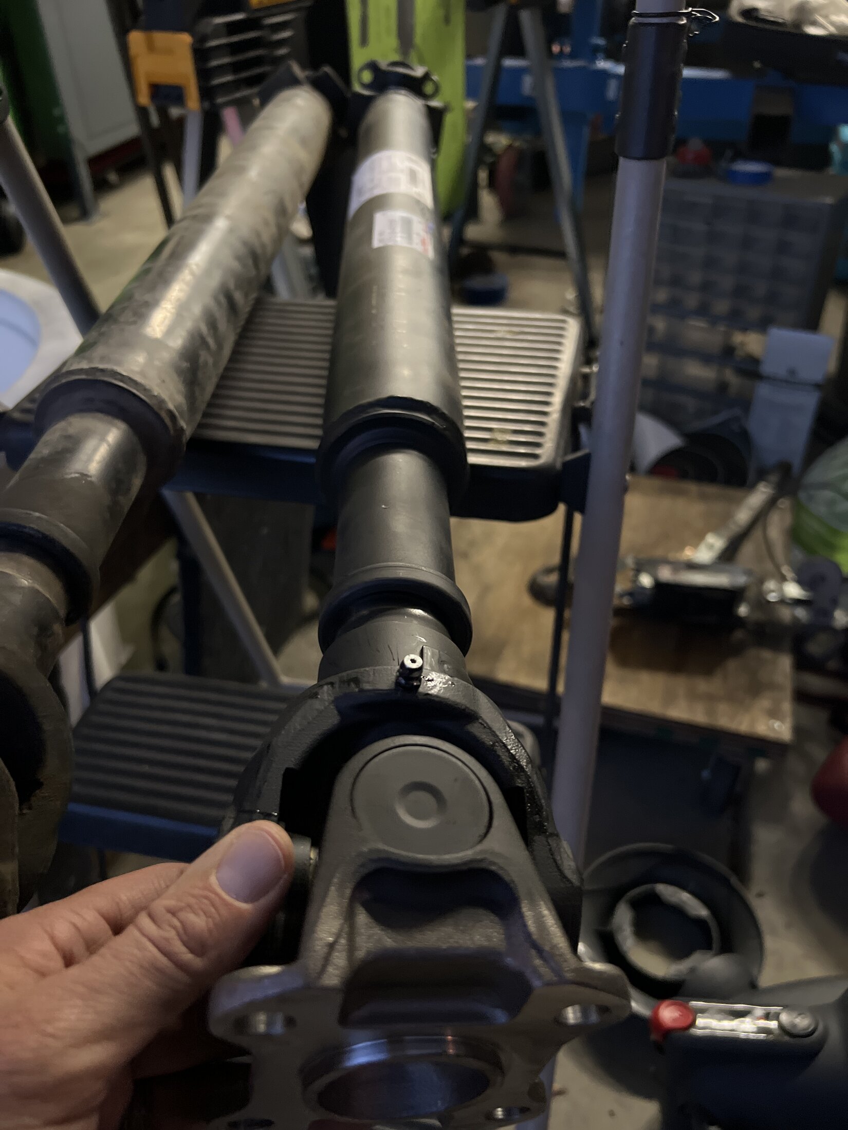

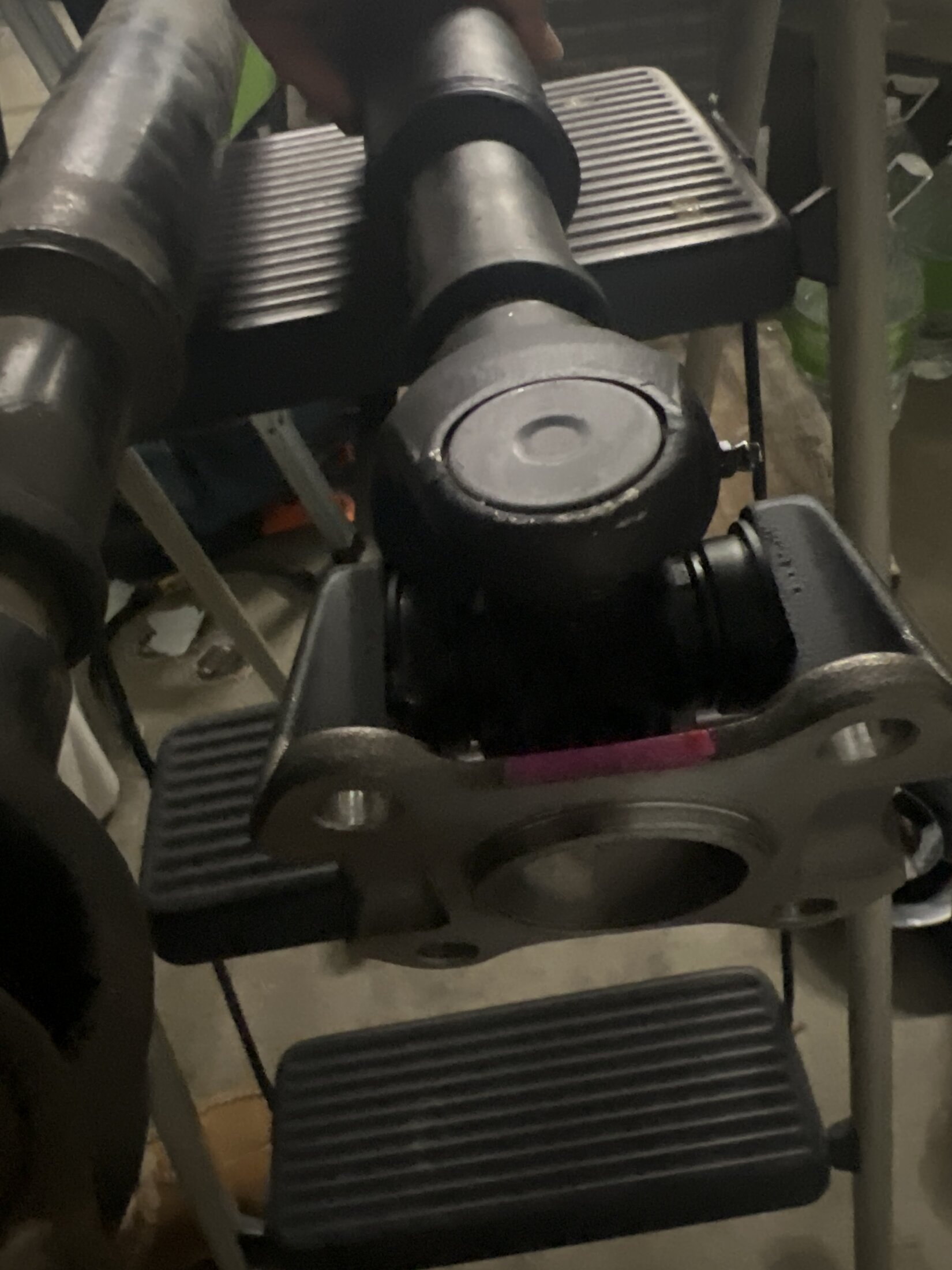

Morning guys, bought a new OEM driveshaft from Toyota Parts Deal and had a question about the phasing.
there is one pink paint marks at each end of the driveshaft but 90 degrees apart. Are those what indicate the phasing and should I line them up or leave as is?

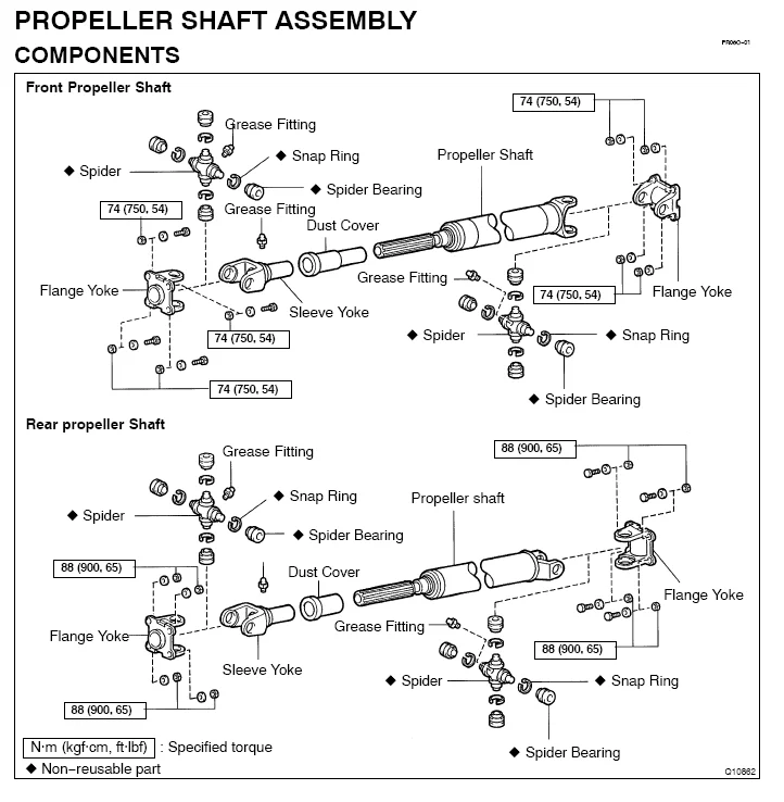

It depends if front or rear, which you didn't say. Front out of phase, rear in phase. Older FSM showed that the front is supposed to be in phase, but was later corrected in a supplement according to CruiserDan

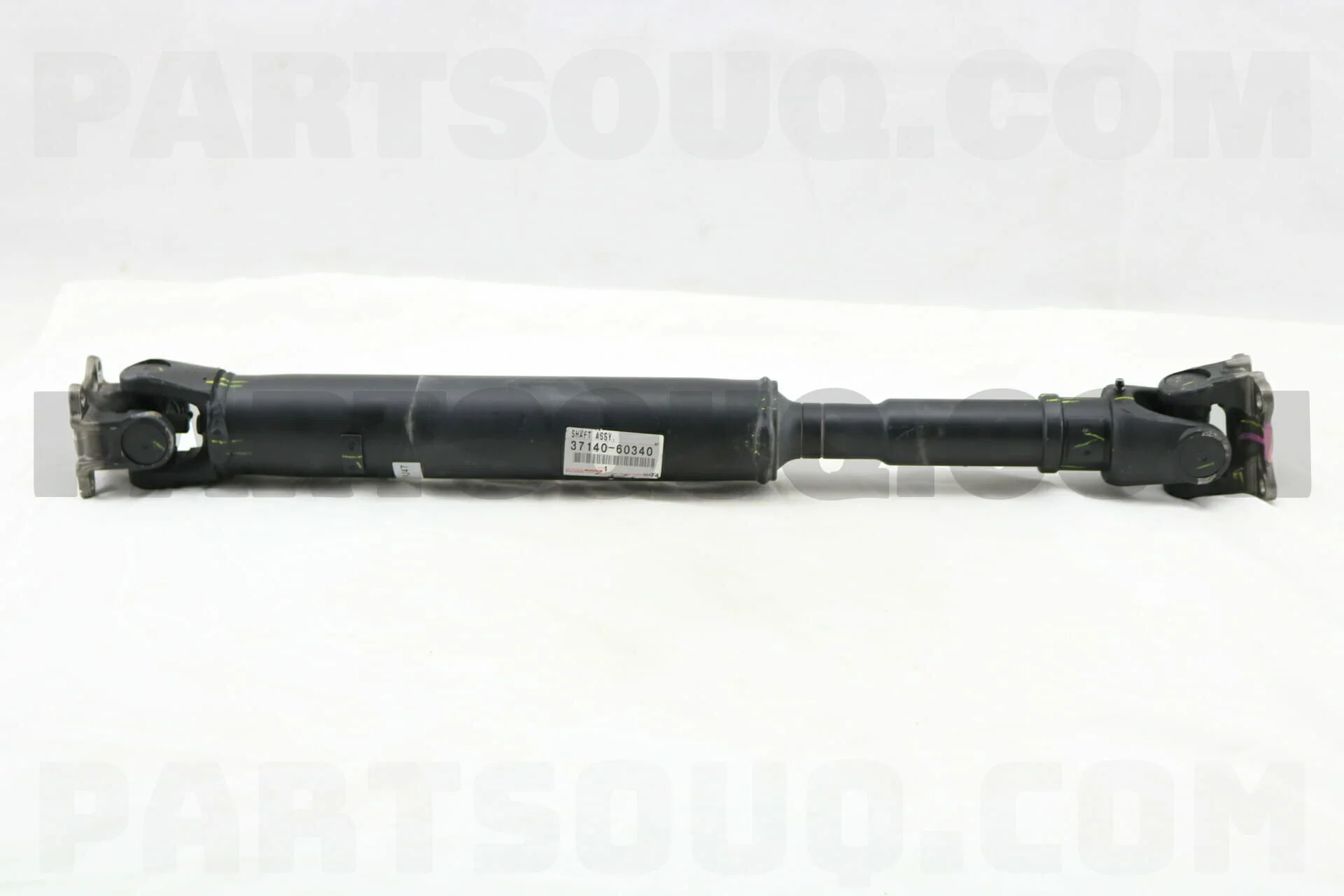

Photo shows a front Toyota Driveshaft (Propeller): 37140-60340
@dsmud4u : does this look like what you have (note the orientation of the U-joints)?

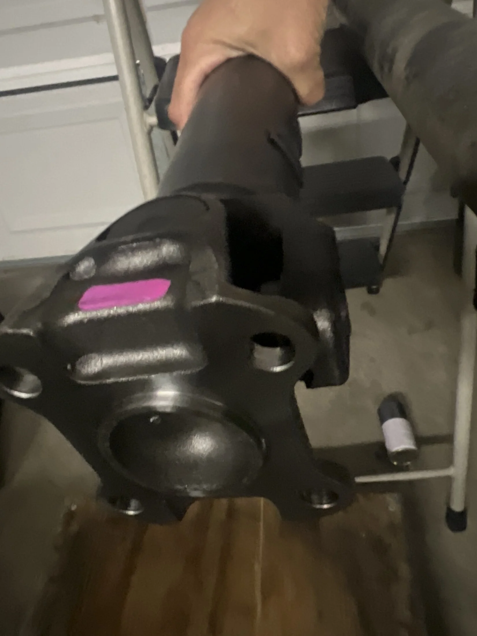

I bought a rear. The front has a DC from Landtank a few years back. Here’s a pic of what I was talking about. They are 90 degrees apart.
Like others have said if you haven’t pulled the slip yoke out then just install it like it came from Toyota.
If you have taken it apart just put it back together in-phase (since it’s a rear shaft) and be sure the grease zerks are all on the same side of the shaft. Then install.

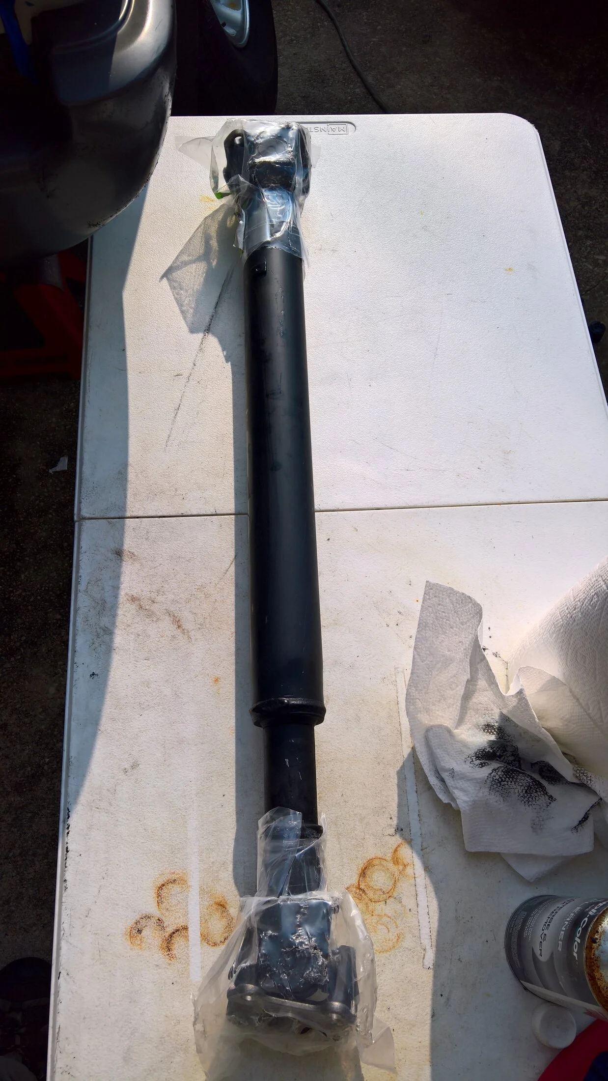

@dsmud4u : compare the orientation of your driveshaft to the photos below which I took of
a new FZJ80 Toyota Rear Drive (Propeller) Shaft-Land Cruiser with ABS (37110-60520) before painting:
First photo is how I received it from my local dealer (plastic bags on the ends, rubber bands removed):

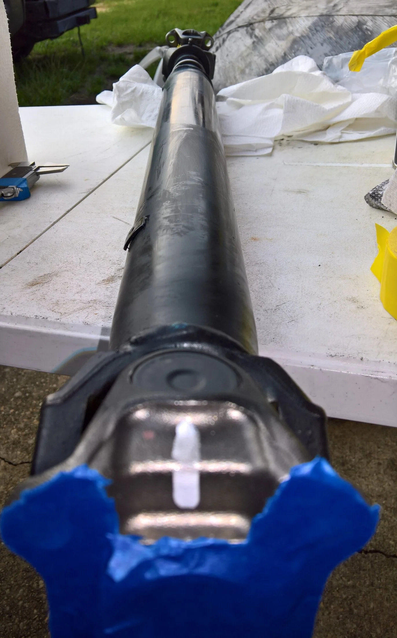

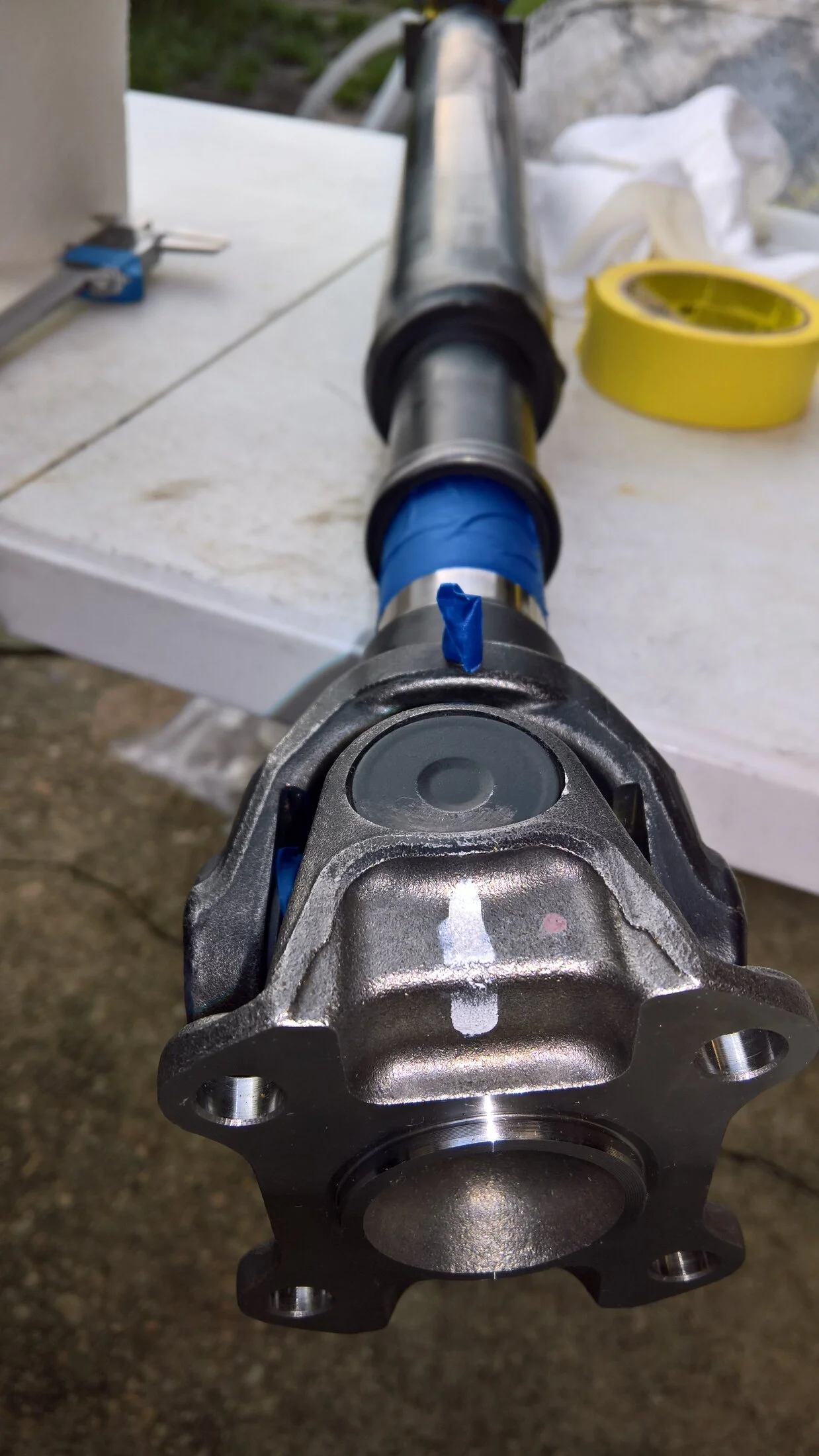

Next photo shows the slip yolk end getting ready to paint, zerk (grease fitting) covered in blue painters tape at 12 O'clock (pointing upward) with the factory purple/pink dot and white stripe markings in line with the zerk. (IIRC I extended the white stripe with marking paint so it would be visible from the side):
Bottom photo shows the other end of the rear drive (propeller) shaft looking toward the slip yolk. Note the factory applied Purple/pink dot and white stripe are also at 12 O'clock (upright) as is the zerk fitting on the slip yolk at the other end.
Also note the orientation of the flange yolks, they're the same on both ends (In Phase). See diagram Rear Propeller Shaft, post #2 above:

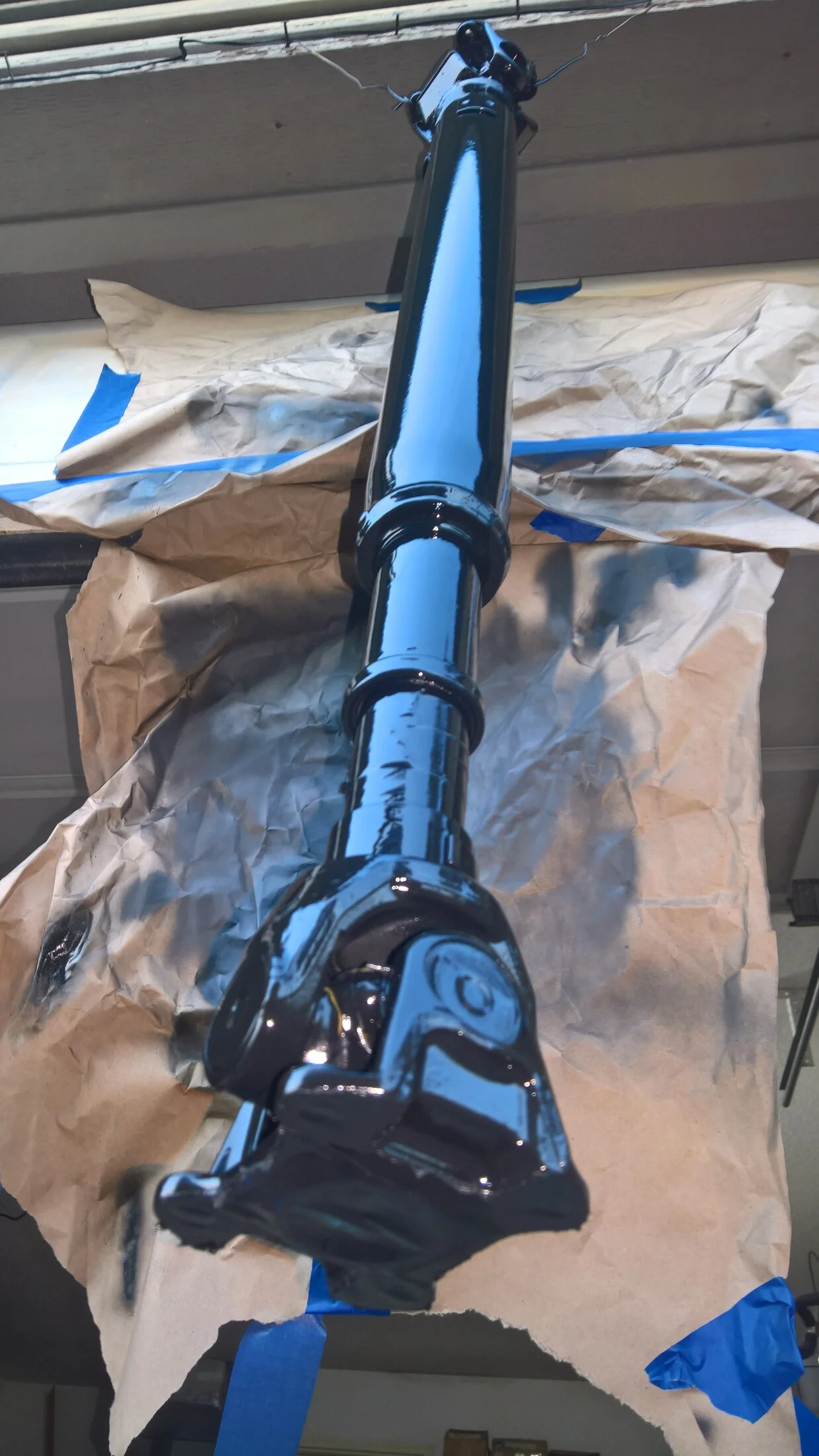

Hanging to dry after light sanding, degreasing, taping, and painting (SprayMax 2k Epoxy primer and topcoat)
Note again orientation of the Flange yolks on either end:

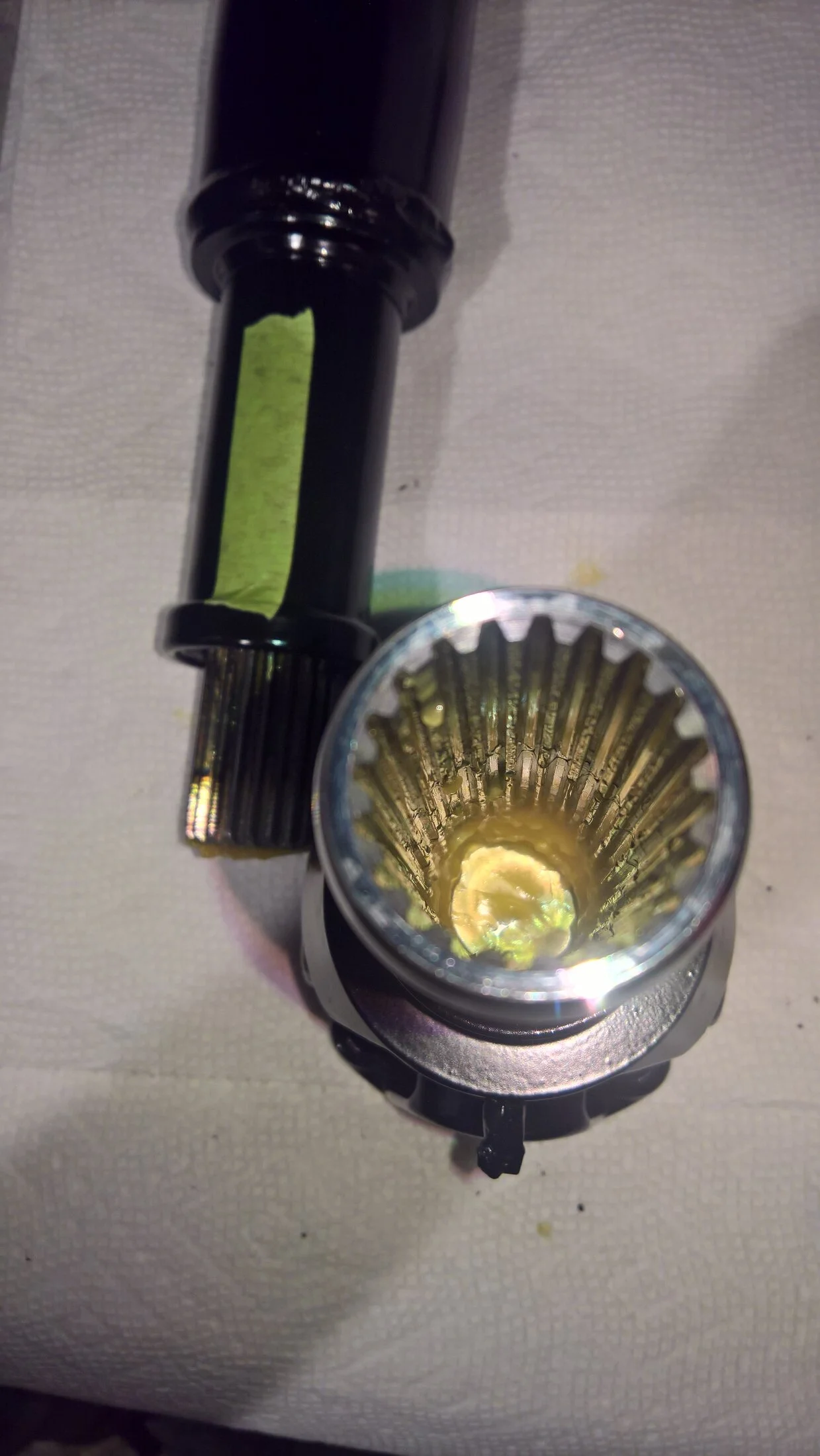

Couple of photos showing a new slip yolk pulled out of the driveshaft.
Note the small amount of yellow assembly grease (I clean that out if applying Dry Moly coatings FWIW):

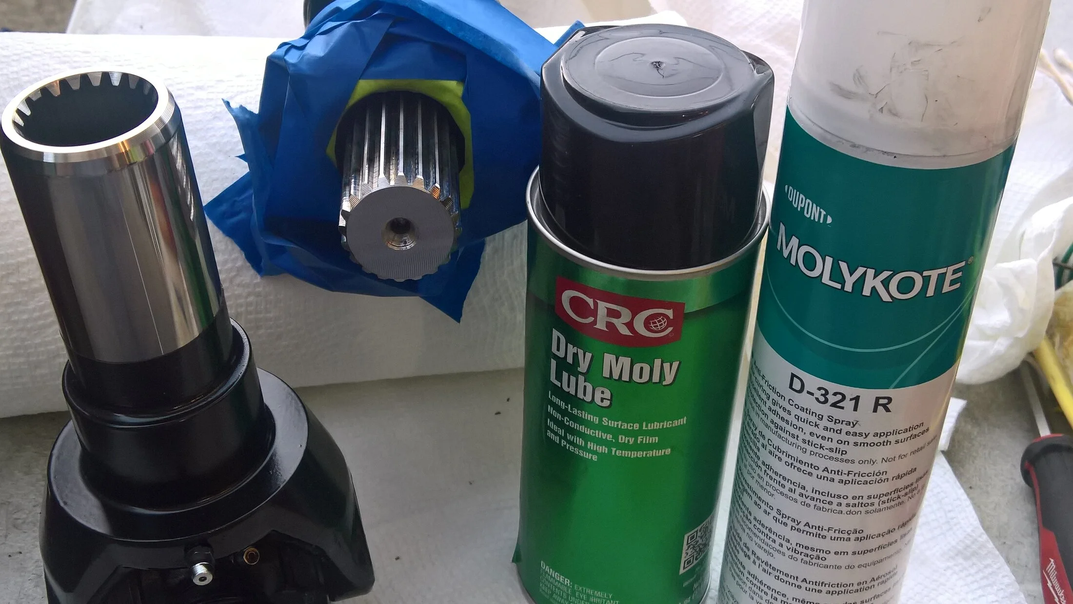

Shaft/slip yolk separated, splines cleaned/degreased prior to applying a dry Moly coating. Both the CRC Dry Moly and the Molykote D-321R (after they first dry at ambient temperature) can be cured using a heat gun set on low before adding grease and reassembling. The D-321R is the better dry coating (has a binding resin, Molybdenum, and Graphite) but also is much more expensive ($60+). Of the choices below the Moly Paste (LB 8012) in addition to grease is the better product in this application IMO.
Neither of the the Dry Moly coatings or the LB 8012 Moly paste in this example should be used by themselves ie: be sure to also grease the slip yolk if either are applied to the splines. Also note that none of these coatings are required by the FSM, just one (personal) method to boost the protection for a shaft that may not come apart again for a few hundred thousand miles.

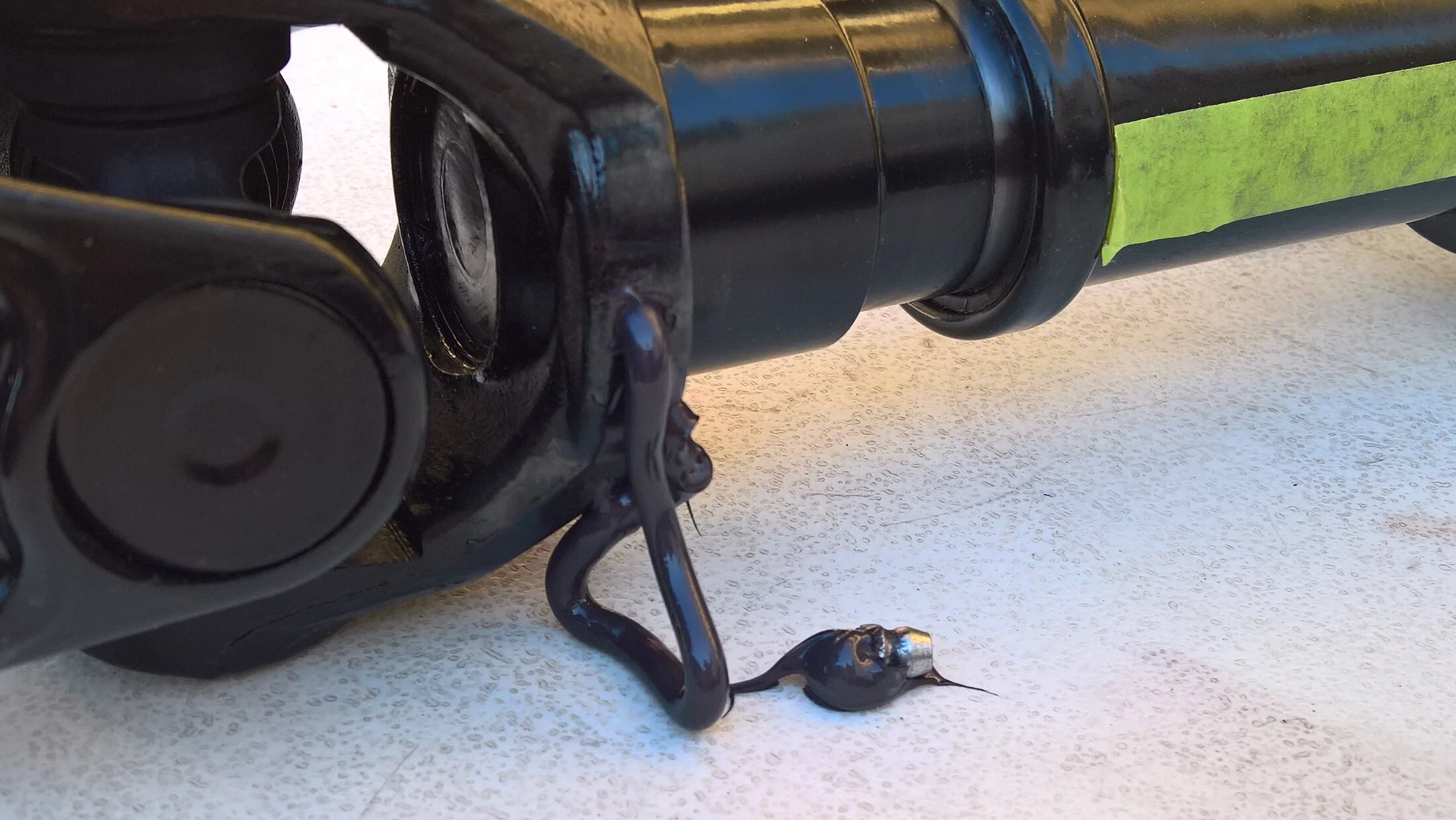

Excess grease coming out of the zerk fitting hole after reassembly:
Tip: 7mm deep socket used to remove/install zerk
