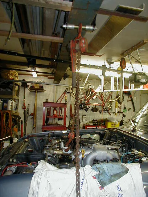

- remove hood and mark where the brackets went (only if you're using an overhead hoist to pull up on the engine)
- remove the radiator cooling fan from the water pump and push it aside
- raise the engine as much as possible. Keep a close eye on the radiator fan and radiator shroud coming into contact with each other. An overhead hoist stays out of your work area the best.

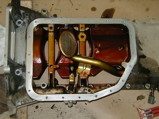

- work the large oil pan out while paying close attention to the oil pickup screen. Edit: 5/26/25
- Place the large oil pan such that the oil pickup screen isn't disturbed. Edit: 5/26/25

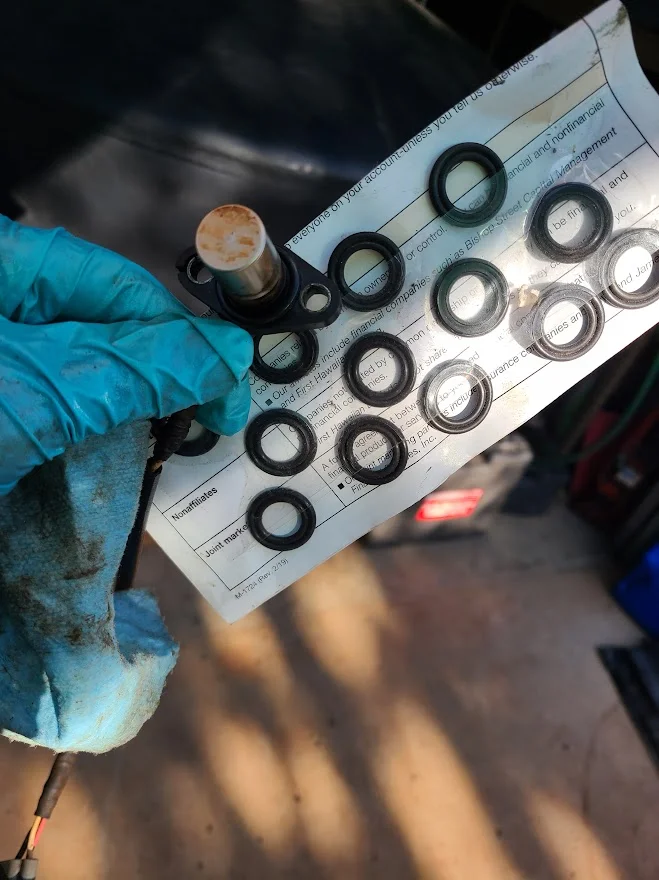

Now would be the time to replace the following seals: Crankshaft position sensor O ring, oil level sensor O rings (yes, there are two), square seal under timing cover, and engine oil level dipstick O ring (why the F*&^k not!). Do it, DO IT NOW. Everything will be brittle and may need to be cut off.

-Protect the oil pickup screen. If you reinstall the lower oil pan before removal of the upper oil pan, this will protect the pickup screen. Edit: 5/26/25

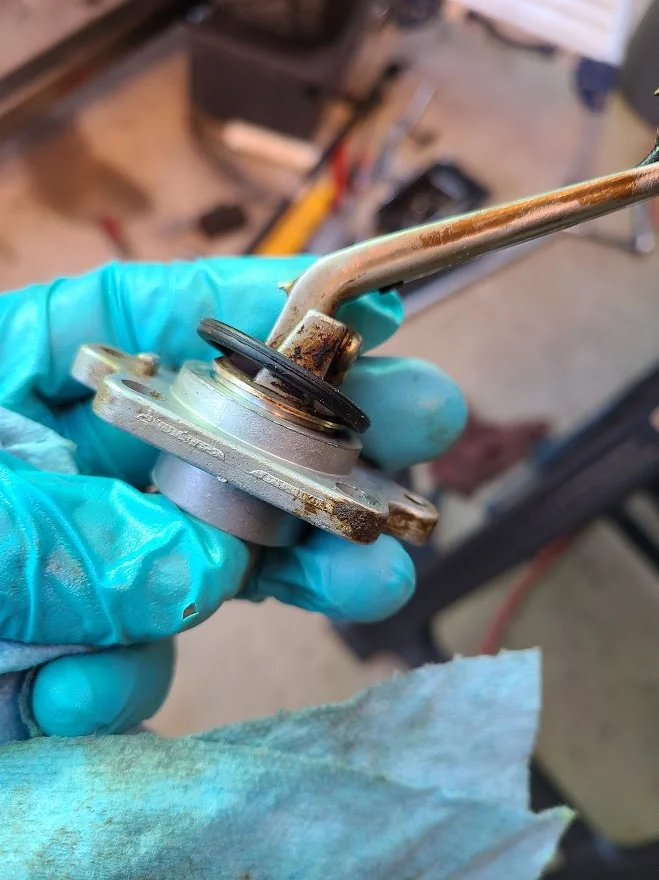

Oil level sensor O ring. Be very mindful of the orientation of this seal, it has a lip on one side.
Crankshaft position sensor O ring x 2 (PM me and I'll send you a set). These are NLA from Toyota.

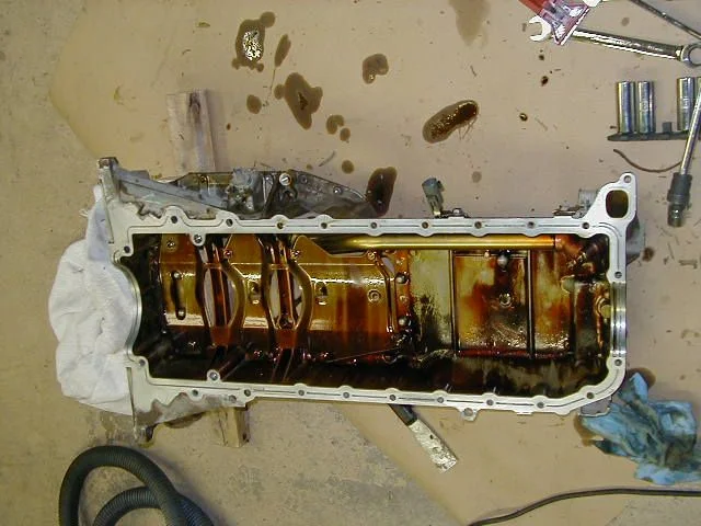

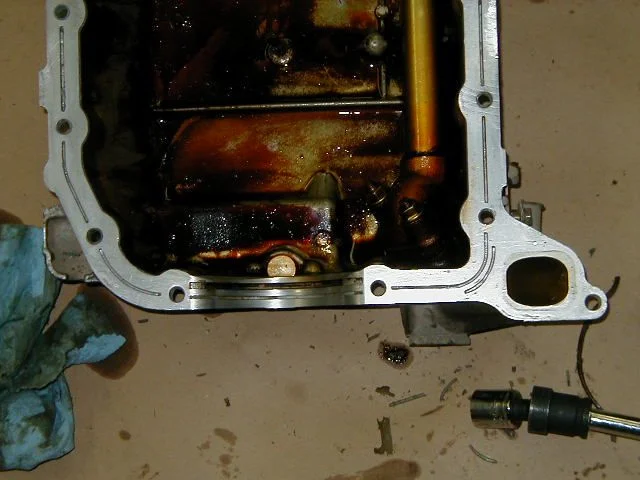

Close up views of the leaky areas of the pan.
Notice how I'm resting the foreward end of the oil pan on 2x4s to protect the oil pickup screen.
