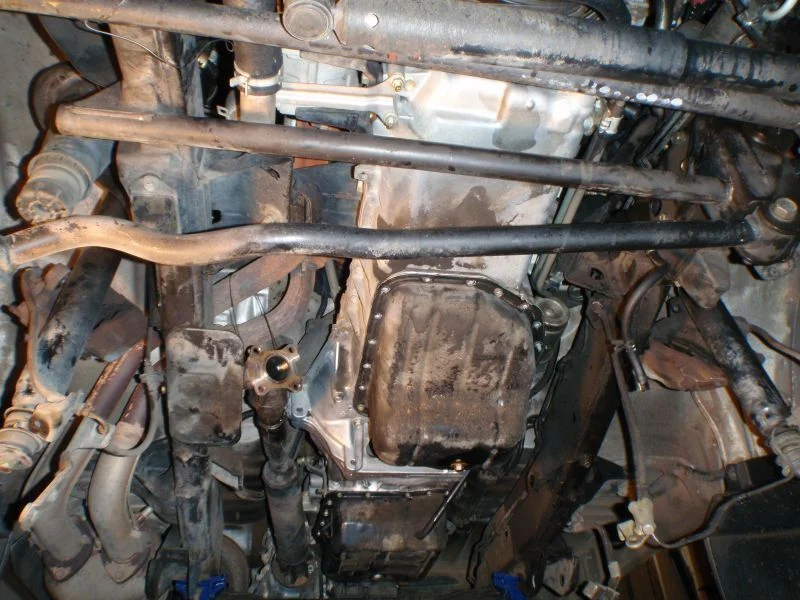

just did the pan over the last few days while I had the front axle out for cleaning/ service the knuckles. taking the axle out made the job so much easier. here are a few more pictures for reference: the pesky support bar and the air conditioner bracket that bolts into the oil pan. I ended up removing the radiator fan just for safety and also unbolted the exhaust hanger bracket just after the cats. I unbolted the engine mounts from below (2 bolts) and used my engine hoist to lift the engine (left the hood on).
