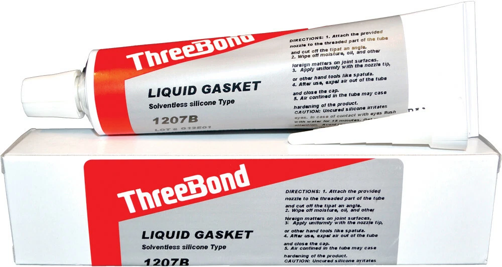

I am about to take the oil pans off but before i do that i wanted to make sure i have the parts/gaskets in my hands. I dont see them available anywhere at the OEM parts source. Any ideas?
Toyota FIPG: 00295-00103. Your dealer has it in stock.
Three Bond 1207B
Also, 00295-01281 is for the transmission oil pan.
Oddly, 00295-00103 is listed as discontinued on several online Lexus and Toyota dealer pages. I just spoke with the local dealership here, and they told me they not only have 9 in stock, but have 13 more currently on order. It ships directly from the manufacturer, in a Toyota labeled box and tube.
The manual lists Three Bond as equivalent.

After cleaning the bulk of the grime, grease, oil, and old sealant off both mating surfaces last step is to use pure Acetone on a clean/new cloth rag or paper towels, then repeat, before applying the sealant (study the FSM for how much and where to place it).

It may cost a bit more but @nashqadri , you can walk into your local Toyota dealer (parts dept) to buy a tube of the factory recommended Toyota Seal Packing 103 (check the expiration date). Or if you prefer go into any Honda dealer for Hondabond HT or Yamaha Dealer for Yamabond 4. There may be some differences between the formulations (all made by Three Bond). Some people prefer Permatex UltraBlack or The Right Stuff, everyone has their own favorite.
