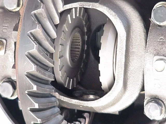

O-k, got her done - so here is more info about installing an Aussie Locker (compare to other auto lockers) in your Cruiser...
First, the components:

Some pics of the side gears and the thick Toyota thrust washer (fattest ones they make)
Thick Toyota thrust washer p/n: 41361-60041 from http://www.ih8mud.com/techtrivia.php
Using this thrust washer allowed me to get the proper specified clearance
Install your side gears.
Then slide drivers side axle in, install C clip, and pull axle out. Use some grease and then stick the DS cam gear and spacer in.
Now it starts getting a little trickier. You need to get the passenger side cam gear and spacer in. This is not a huge deal. But you need to set your pins in the cam gears with a little grease so they are ready for the rest of the install. Make sure to place the nipple out so it will seat the spring
Before I put in the springs and pins, I use the "old butter knife trick" to get the PS C clip in. I learned this trick from Rising Sun's Jeff Zepp. You use a little duct tape to tape the C clip to the knife. Line up the gap to reach in between cam gear and side gear. Then push the PS cam gear away from the side gear. Reach in with your knife, hook the C clip down, have a helper pull the PS axle out.
Then your pinion shaft (or cross pin) goes in to keep the spacers from falling out. Then the lock bolt (be careful not to over torque this little dude). Be careful when rotating the carrier assembly to get the cross pin in that you do not drop your C clips.
Getting the springs in took some patience for me! They will fit in the gap on the cam gear. I used a combination of dental pick, needle nose, and screw driver to get them in. Twice a compressed spring went flying and I was sure it was gone. It turned out they were in the diff housing - nice! Push them all the way against the pin and seat them all the way in the cam gear.
