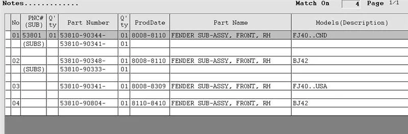

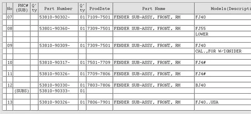

if you have the epc you should find a ton of #'s depending on year and model ,heres some for the right hand side . just have to find a parts guy with some time and patience to check the warehouse stock . the new epc they use may already be able to tell them without a phone call . these #'s are taken from the 2007 EPC for U.S. should be good

Left-- 53820-90348 / right-- 53810-90341 work for me.... CCOT fenders suck!
