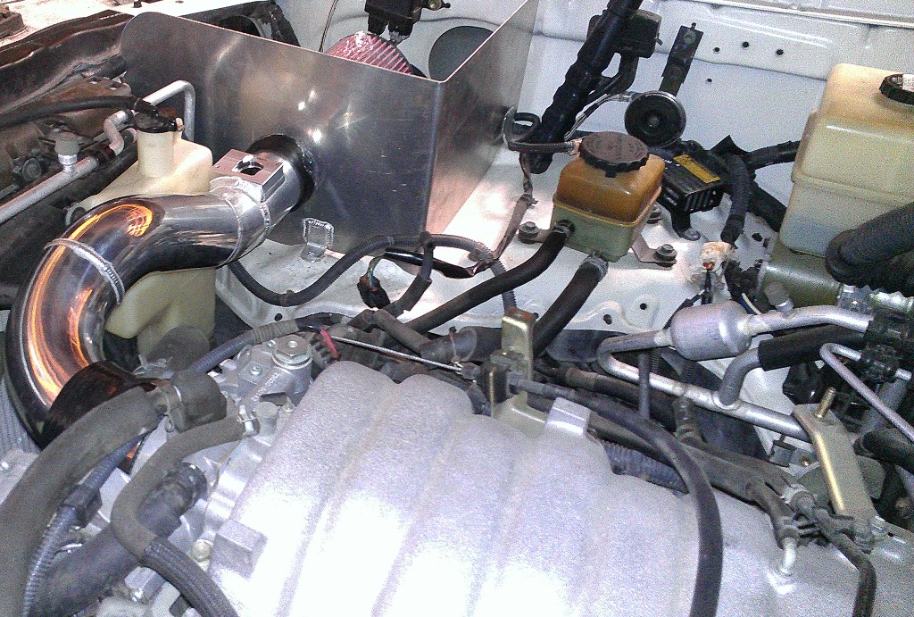

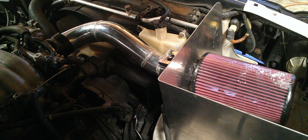

We just finished up a long week of development work on some new goodies for the 100-series Land Cruiser and LX470. We've finished up our headers and also a new performance intake system that we will have available for you guys soon.
Here are some teaser photos of the intake system we have built for you guys. Please excuse the bad photos. These were just some quick photos during our prototyping work last week.
The intake system will include all 4 ports to connect OEM vacuum lines to new intake, silicone couplers, 4 new high temp silicone vacuum lines to replace the 4 that normally go to the stock intake, stainless steel clamps, high flow dual inverted velocity stack custom filter, "air box", all mounting hardware, detailed installation instructions, and our usual lifetime warranty that comes with our other intake systems.

Is that a dry element?

The one in the photo is an 8 layer oiled filter (similar to K&N). We will have both oiled and dry filter options for you guys once they're ready for sale.
Can you explain what might be the differences / advantages of dry vs. oiled filters?
Generally, like for like, a good oiled filter will out flow a dry filter and perform better. These are all lifetime filters that are cleanable and reusable that we use. When you are ready to clean and reuse a dry filter you just rinse it off with the appropriate washing fluid, let it dry and reinstall. With an oiled filter you rinse it off with the appropriate washing fluid, apply fresh oil to the filter and reinstall. The problem with oiled filters is that the end user will sometimes put way too much oil on the filter after cleaning, and then the extra oil gets sucked through the MAF and causes problems. If an oiled filter is cleaned and re-oiled properly then they function extremely well.
All in all, a high performance dry filter and a high performance oiled filter will both work great on the 100 series. We will offer both so that you guys have a choice of which you want to go with on an intake system for your truck.
Will you plumb the intake to reconnect all those hoses that are on the stock intake box?
Yes, all 4 vacuum hoses that normally go to the stock intake go to the new EMSPowered intake pipe. Included will also be 4 new high temp silicone vacuum hoses in the proper sizes and lengths to go from the factory location to the new intake pipe.

I'd buy one if it's snorkel compatible :)
This intake is not snorkel compatible. If there's enough interest for at least 10 kits we can build a snorkel compatible version for you guys as well.
